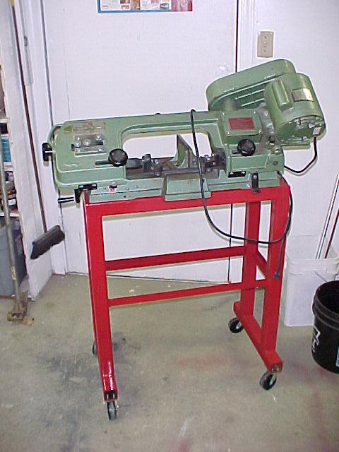

New Stand for the H/V saw
I finally decided to improve the working height of my H/V Bandsaw. At 24" it was a pain in the back to work with it. It had always been a problem with long stock to keep it level with the cutting surface. After this mod I will be able to use one of my roller work stands. Much better...
I had picked up 30 sticks of used 2 x 2 x 1/8th wall x 100"lg. sq. tubing so I made the new table out of a stick and a half of that. I know it's a little overkill for something like this but, at 7 bucks a stick, I can justify the 10 dollar material cost. :)
