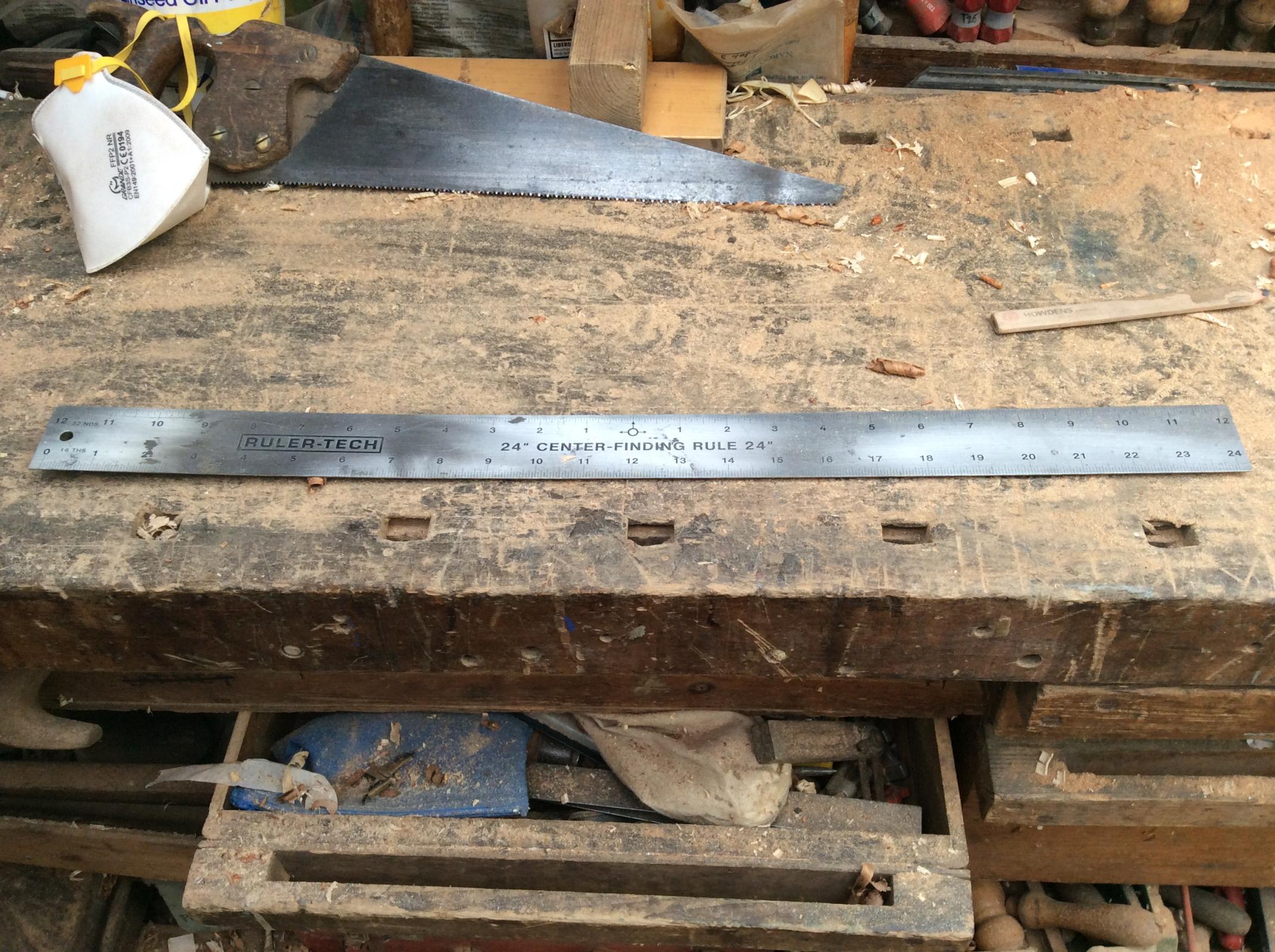

Attachment 36588

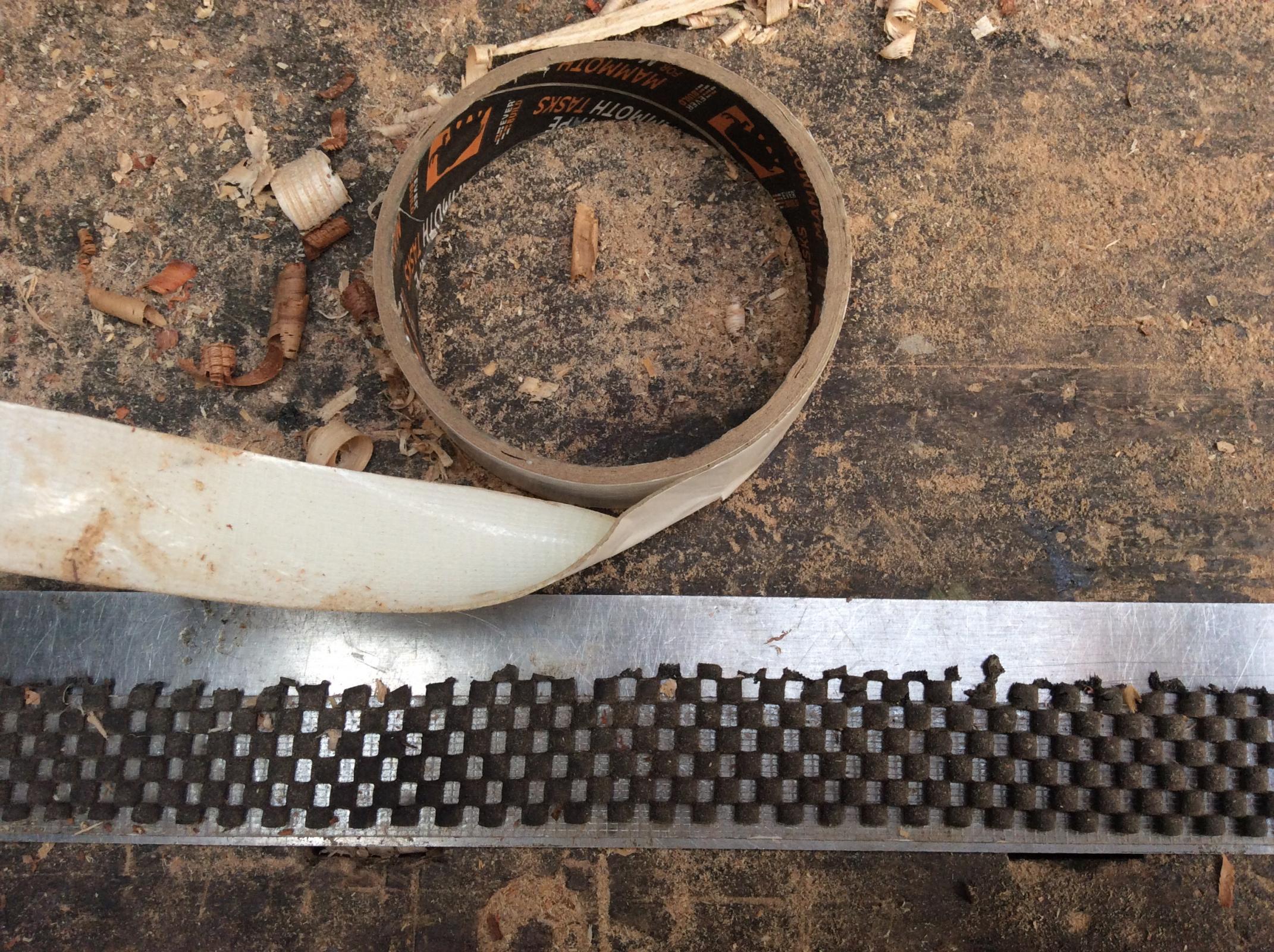

Got fed up with ruler slipping as I try to draw a line (particularly on profiled material, or even a wall). Not sure how effective this will be, but using doubled sided tape and non-slip rubbery material (don’t know its commercial name), hope you will also find this helpful.
Attachment 36589

Nice useful tip I have some adhesive foam strip to try. BTW they are correct in calling it a rule, I think in this case you are the ruler in many ways.
Thin (~1 mm) cork sheeting works well too.
