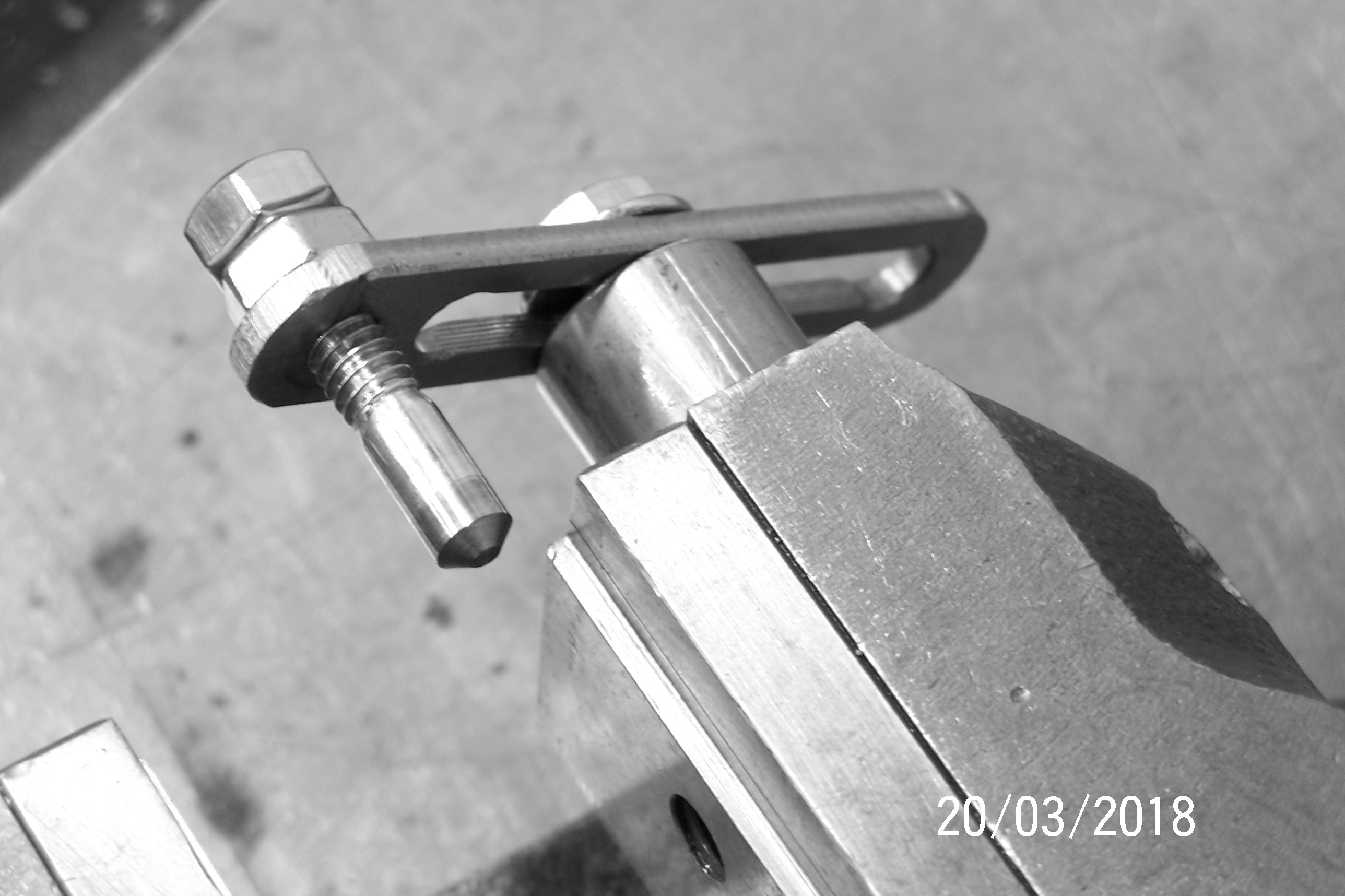

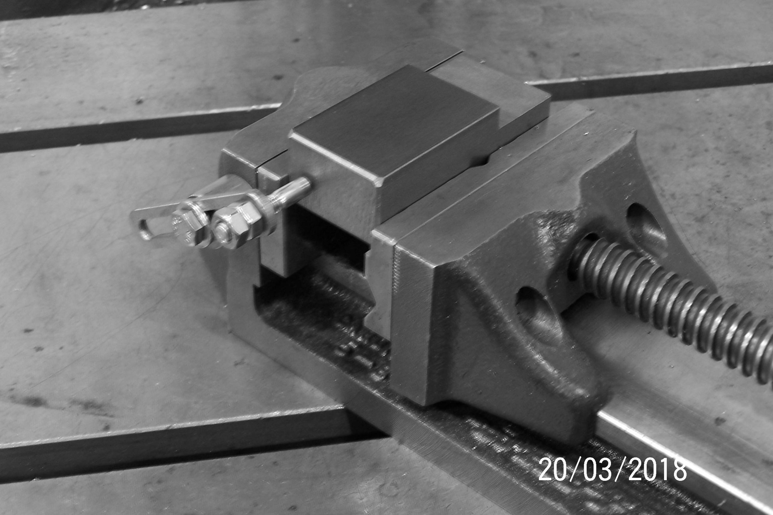

My latest gang of parts are small stainless. After deburr of barstock, I mark a corner related to the drawing [datum] with paint stick. That's same corner the vise stop engages. Using mill, it's stop and DRO, center drilled all 7 holes in 1 piece of twenty. Already built a stop for quick-action drilling vise. Using center drilled "sample", clamped vise in place for each hole in succession. Several intersect, mostly tapped for setscrews on shafts. Drilled and tapped all, before reaming shaft hole, that size admits bushing for keyway broach...Stainless steel parts, a lot less trouble under flood coolant and .200mm per rev power feed.
Bingbangboom done deal. Hot job done that'll ship 3 days early.
Stop is a simple slotted strip, a couple screws, and tapping both stationary sides of ANY vise. Hole tapped 1/4-20 holds a variety of stop pins...I tend to point or bevel stops, minimizing part to part variation, and use stainless for non-magnetic properties. Adhering chips will mis-locate parts.
Attachment 22850 Attachment 22851
As drilling is not always clamped to table, the spacer kept drill locations within the vise footprint for stability.
