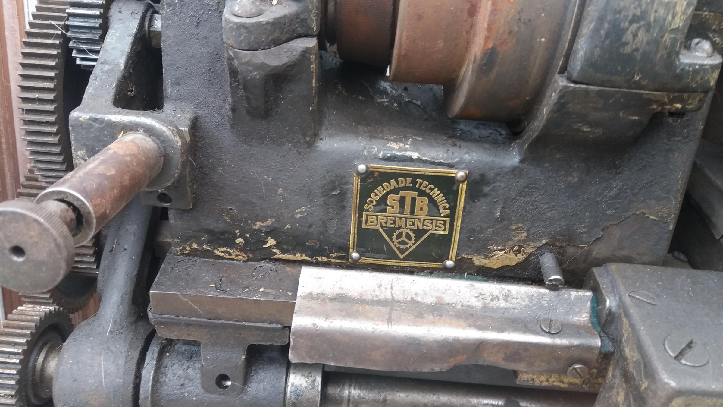

Hello, my name is Celso and I'm from Brazil. I bought a lathe to reform and I don't know its brand and type. Can anyone help me with this information?
Attached photos
thankful

I don't know, but the metal badge riveted to it seems to carry the Mercedes logo. Perhaps that's a good place to start.

It appears it has an ST:B on the badge. From what I can find, Storebro is a lathe manufacturer and the initials seem to point that way. While I have not been able to find one quite like that one or a another picture of the badge, I do know that they have been in business since the early 1900's and they are actually in the town of Storebro, Sweden. I only had a few minutes to search but there may be much more info if you can find related information about the lathe. I am from the South Bend, IN area and had the opportunity to bid on items from the factory almost a decade ago. A lot of old lathes (such as South Bend) used to stamp the model numbers on the far right end on the bed. Maybe there is more information there? The fact that there doesn't appear to be much information on that particular lathe is a good indication you might have a real gem! Hopefully this helps you a little.

the nameplate that appears refers to an importer of machinery, which closed shortly after WWII. I believe it is a European-made lathe made for this importer. Other than the nameplate I found no other markings, not even serial numbers. I believe it must be from the 1930s, and be a south bend clone, with some modifications. The handles are different and the covers tooAttachment 31983

It appears you have a Brazilian lathe actually made by a company called Sociedade Technica Bremensis. I found an actual reference from a book called "Brazil In The Making" published in 1943. They reference them as a machinery manufacturer. (https://archive.org/stream/brazilinm...0jobi_djvu.txt) Again, given that there is so little information about the company or the lathe, you probably have, if not a great piece, perhaps a museum piece from the Brazilian Industrial Revolution. As far as being a South Bend Lathe copy, there were many similarities in lathes of the time as nearly half (47%) of the lathes in the United States and at one time were made by the South Bend Lathe Company. They started in 1906. Our company has a lathe from between 1921 and 1931, judging by the number only serial number 33807 (see pictures). To me, the drive belt tension system seems quite different but like I said in an earlier post, it could be a "Frankenlathe" built from different machines or different designs. Anyway, You might have an historical piece of machinery! Hopefully you can confirm some facts to be sure.
