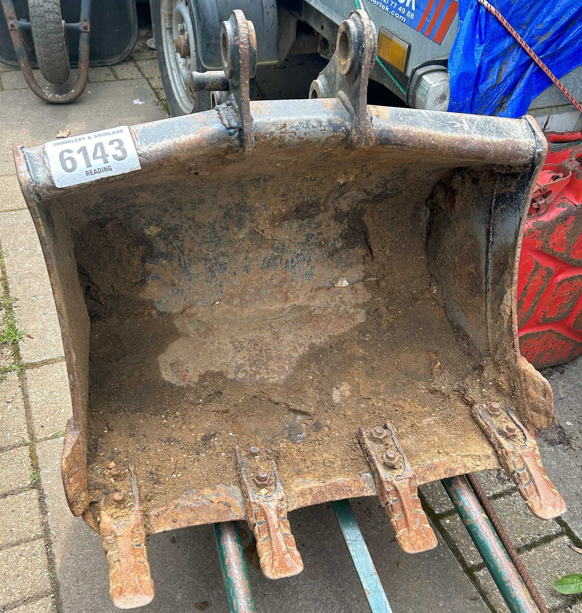

Attachment 45624
Original bucket

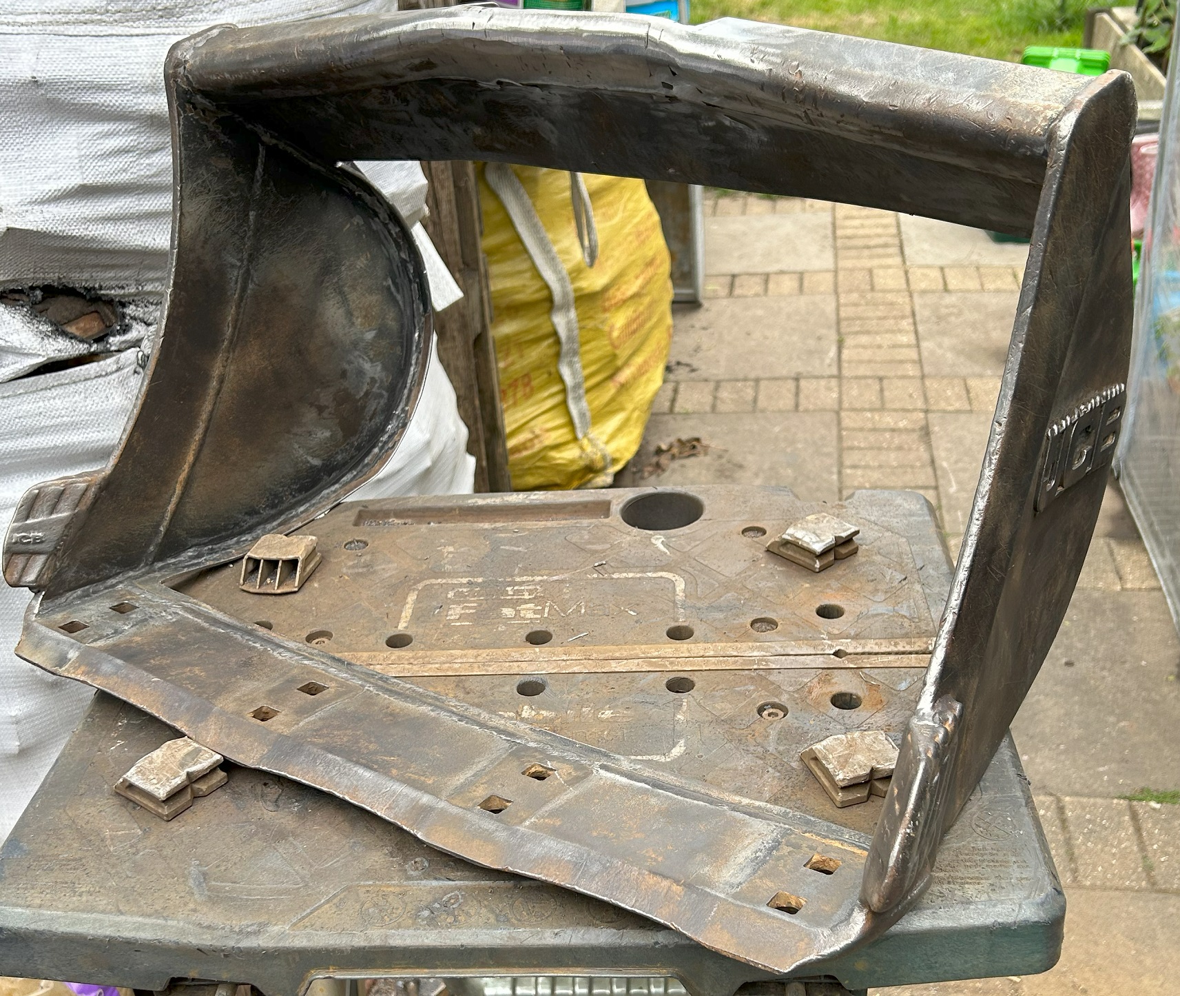

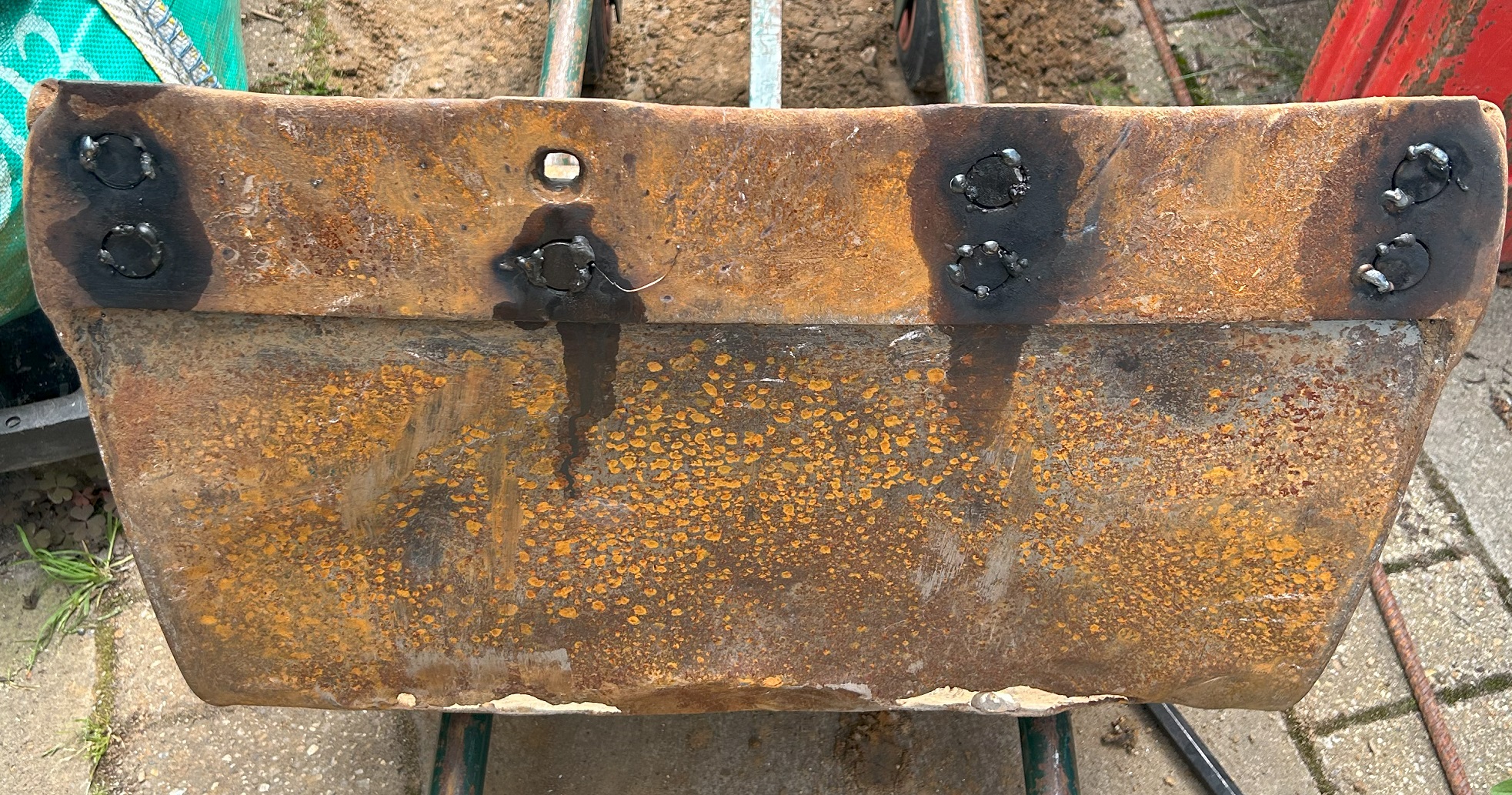

Attachment 45625
Taking the teeth off. Had to weld bolt in place to remove nuts

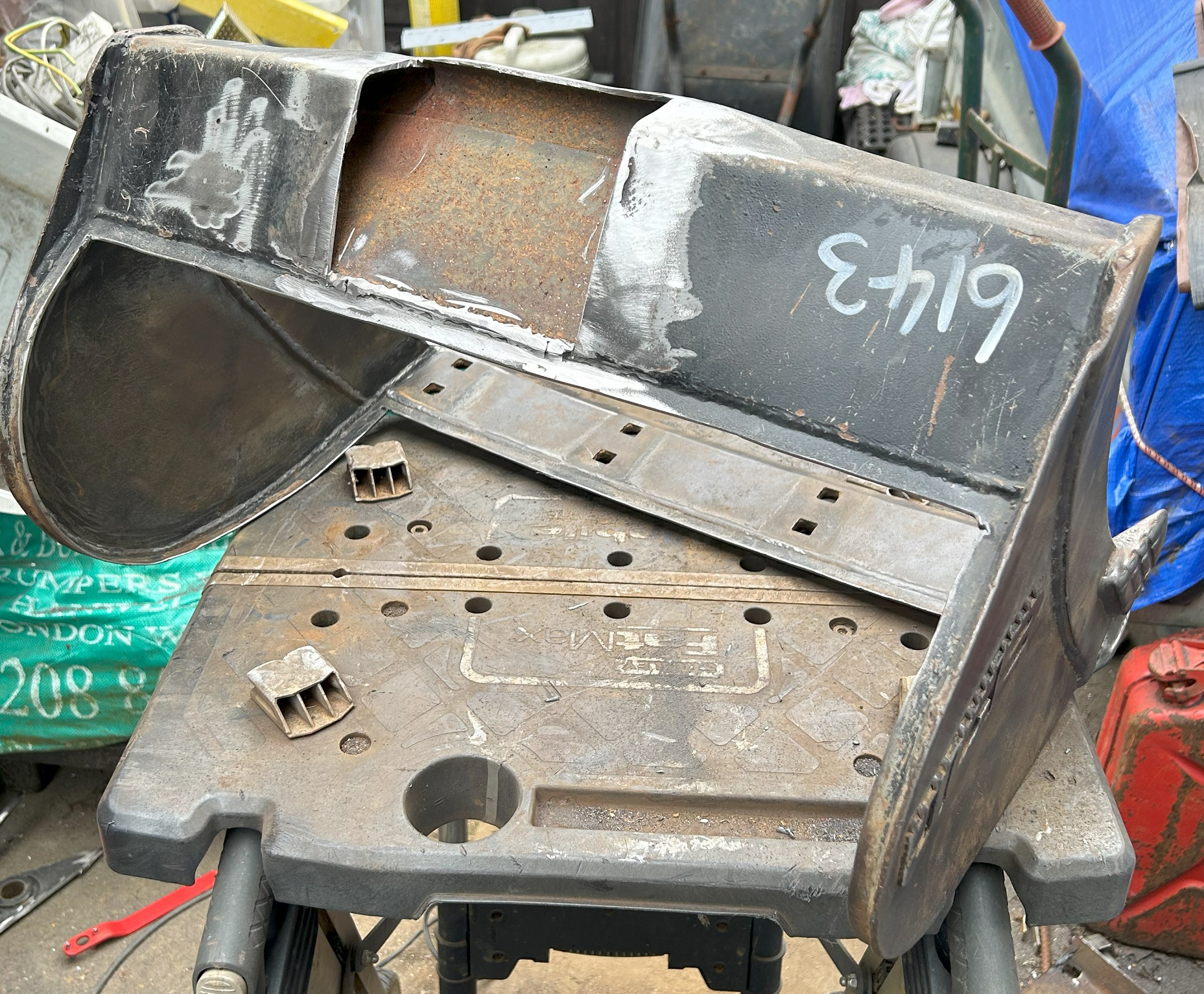

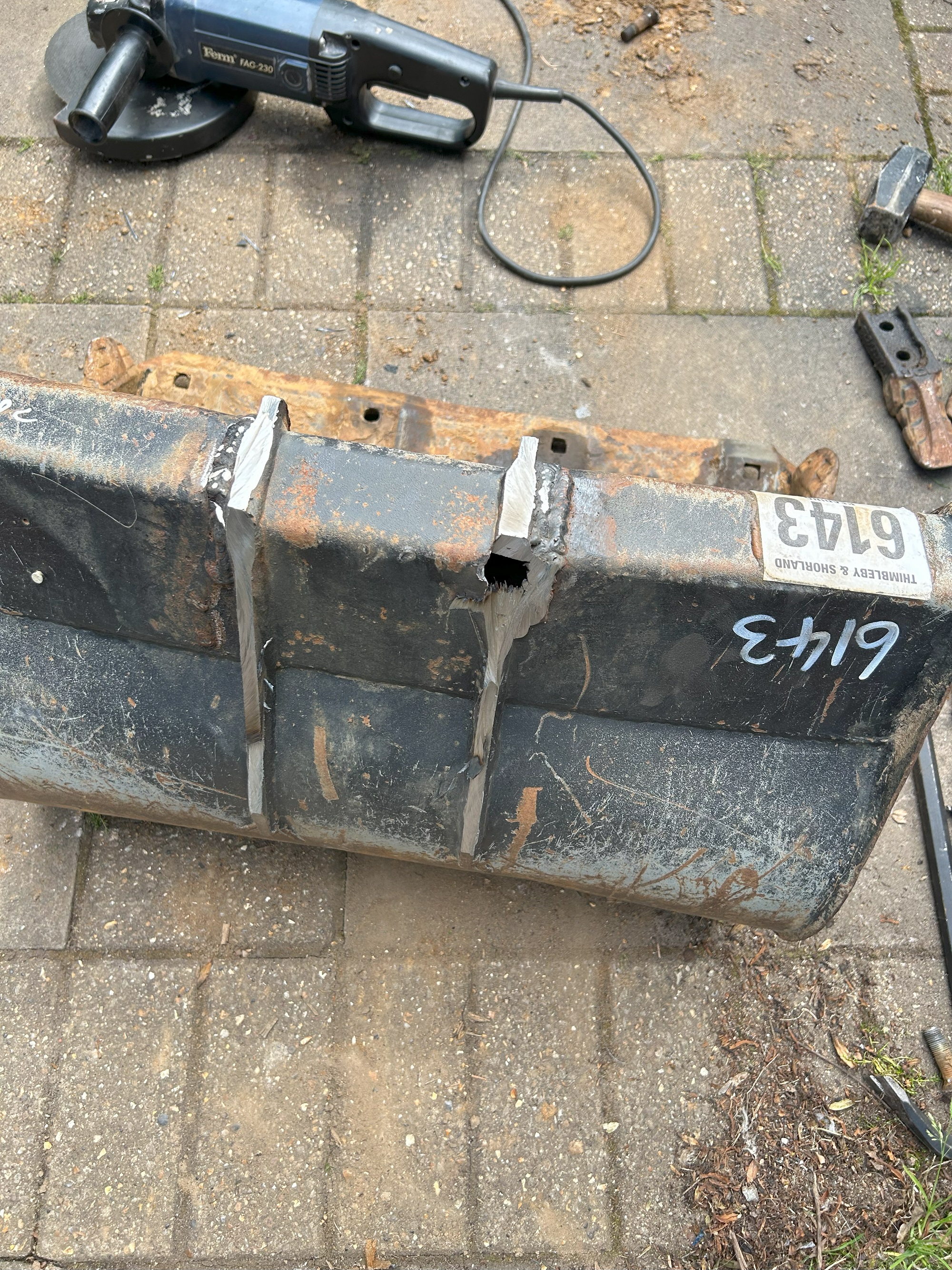

Attachment 45627
Damaged and cracked bucket back, plasma cut out.

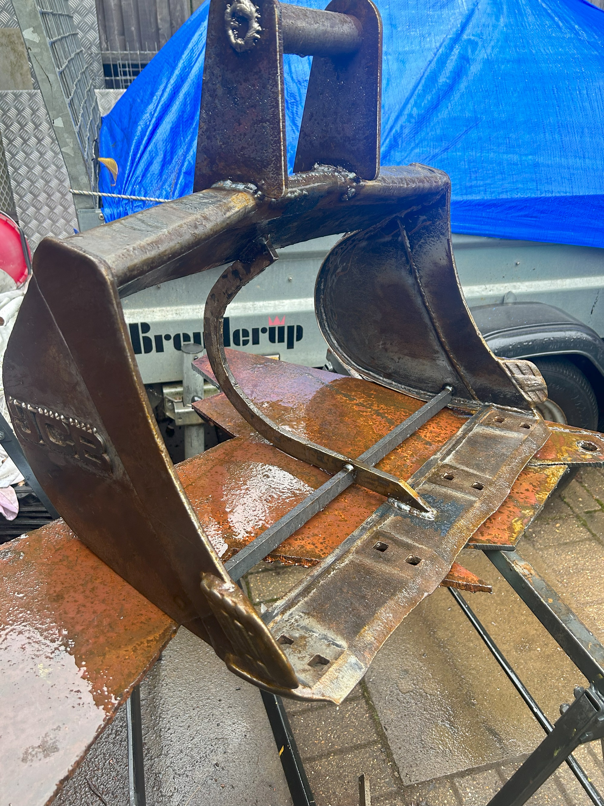

Attachment 45628
Hitch back of the bucket was repaired badly in the past so this section was also cut out.
Attachment 45629
A Harford hitch was fabricated from plate and welded to the bucket and a piece of 1" by 1/2" was formed on my hydraulic press to the radius of the back of the bucket to create a spine.

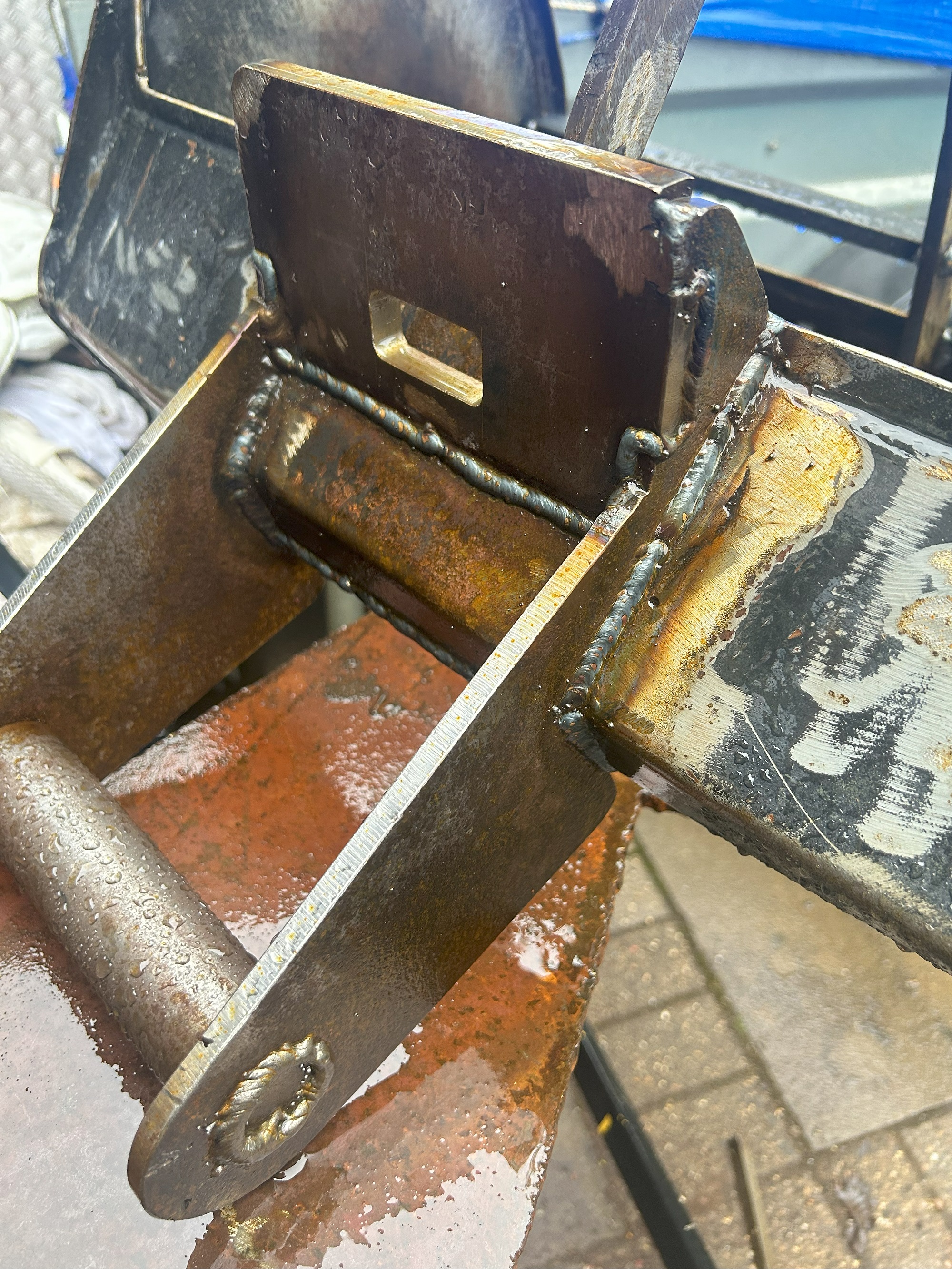

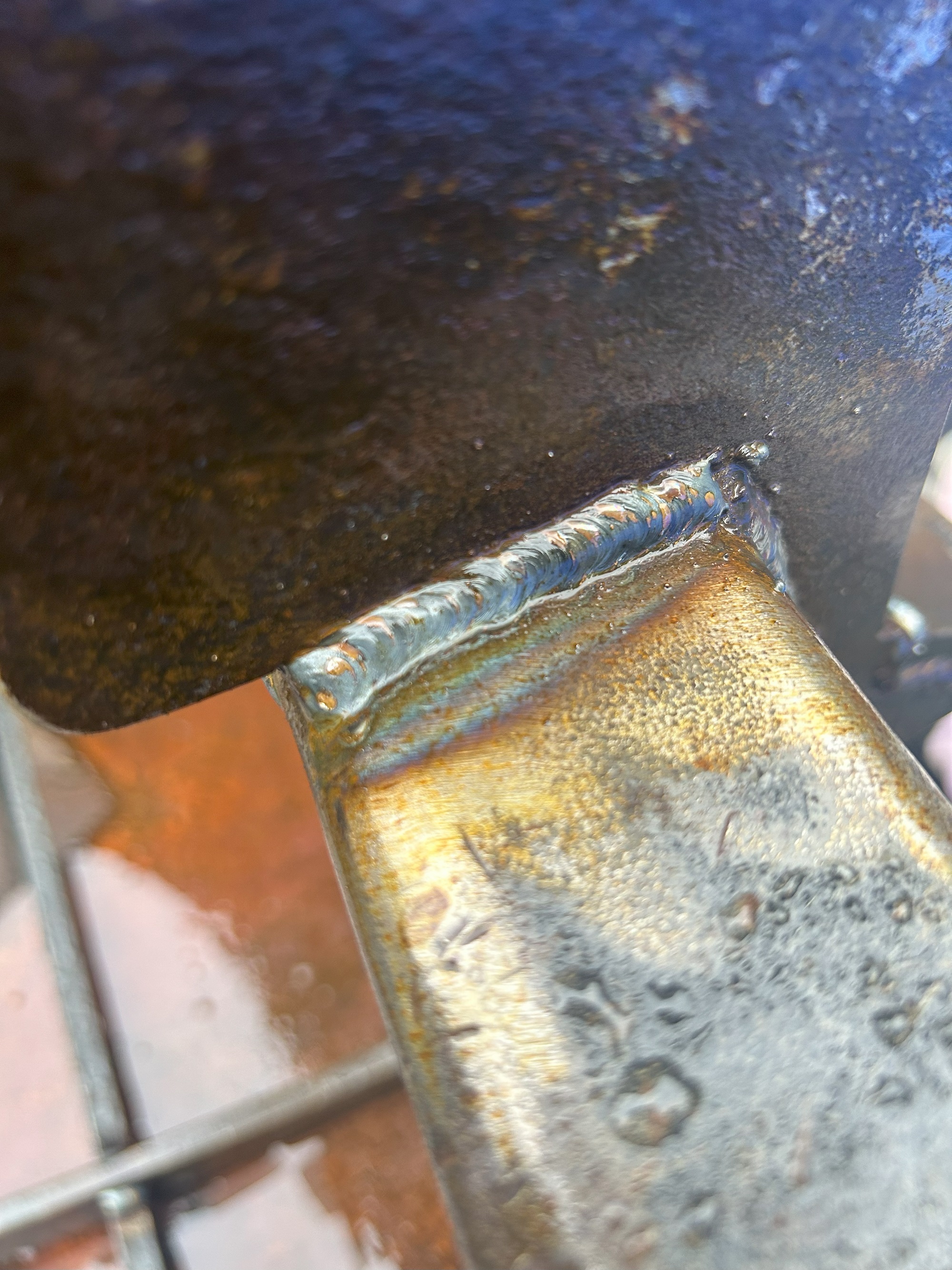

Attachment 45630
The new Harford Hitch welded to bucket, hopefully my welding will be strong enough.
Attachment 45634
New fabricated hitch fully welded in place

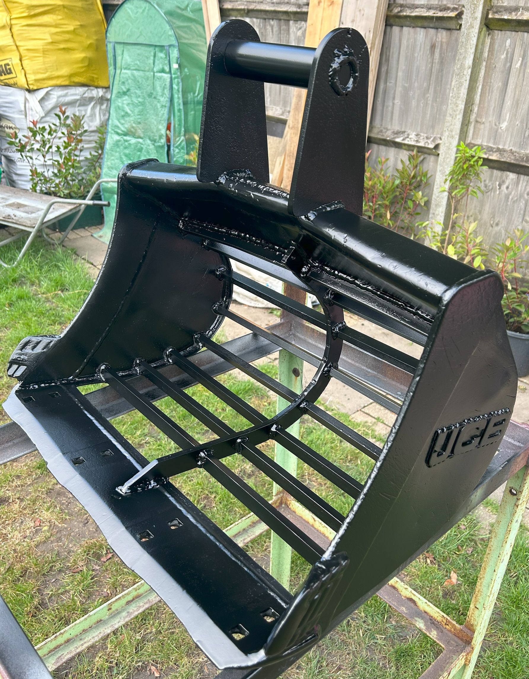

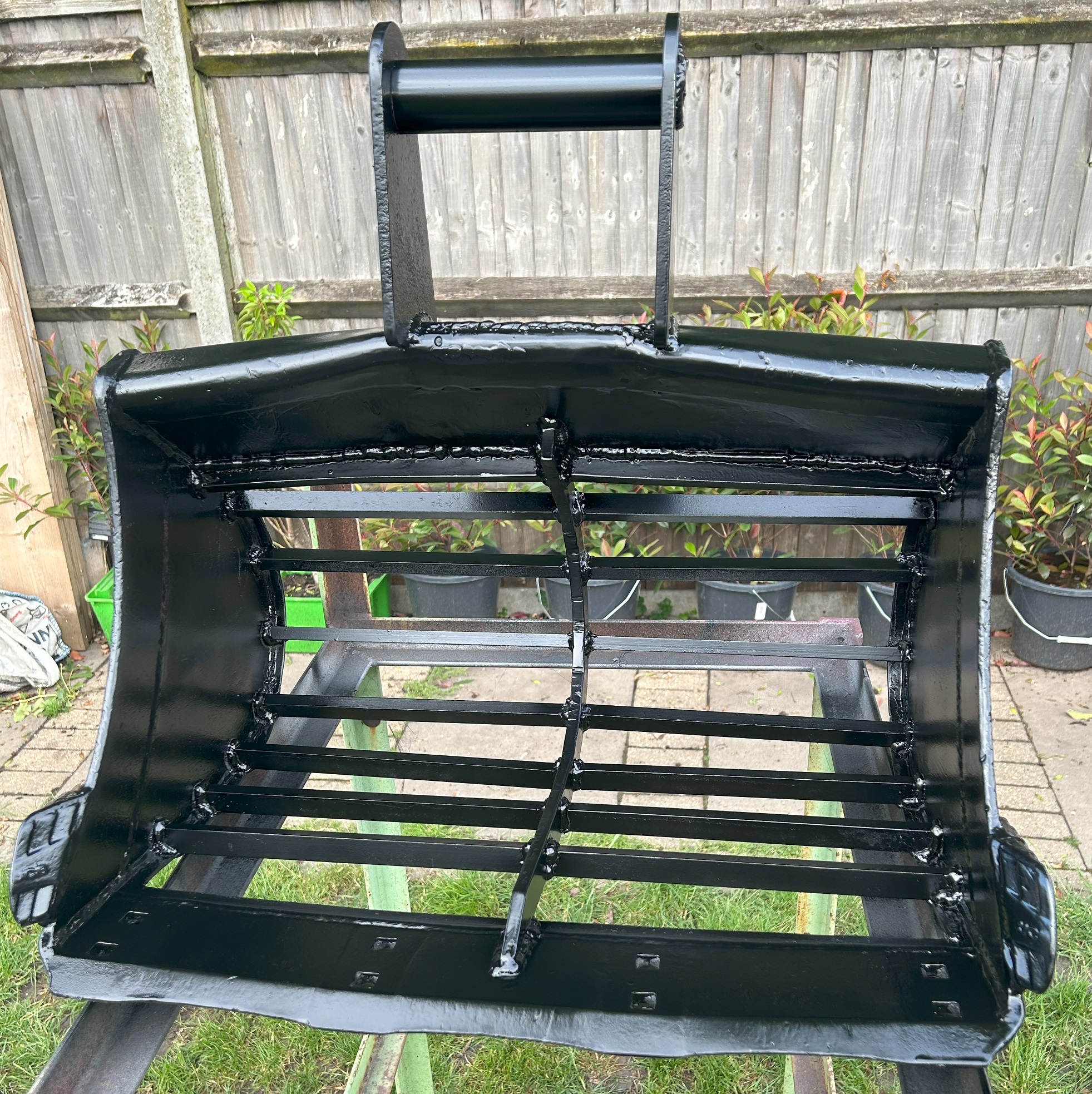

Attachment 45631
Bucket all finished and welded up, with all the 3/4" x 1/2" riddle bars, spaced at 2" centres
Attachment 45632
Bucket waiting for bucket teeth to be refitted.

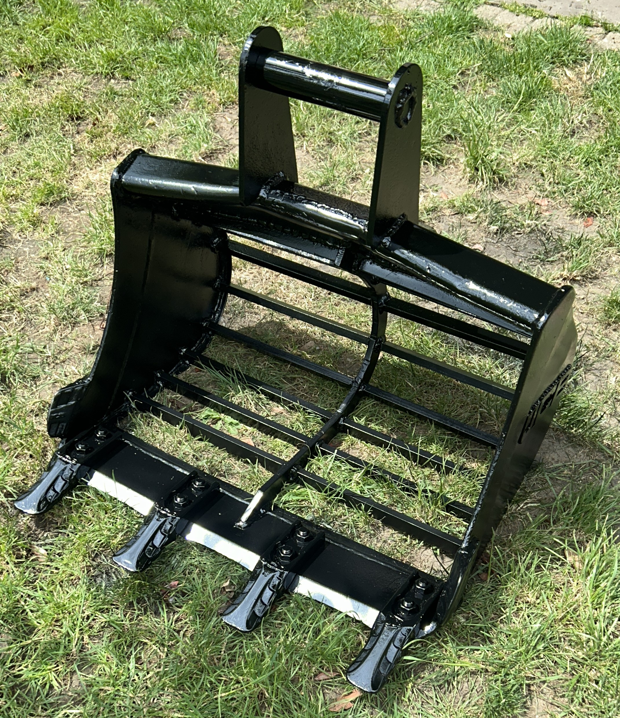

Attachment 45633
Completed bucket which took 3 Days to modify and materials coming in at just under £100 including the bucket, welding gas, 4.8m-3/4"x 1/2" black steel, paint etc. So it might have been more cost effective and cheaper to buy a new. But my time is free and I still have £766 in my pocket and a new'ish' riddle bucket.
