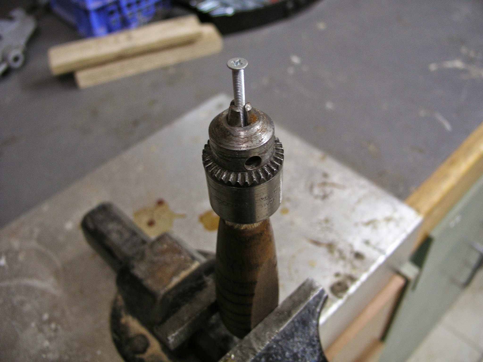

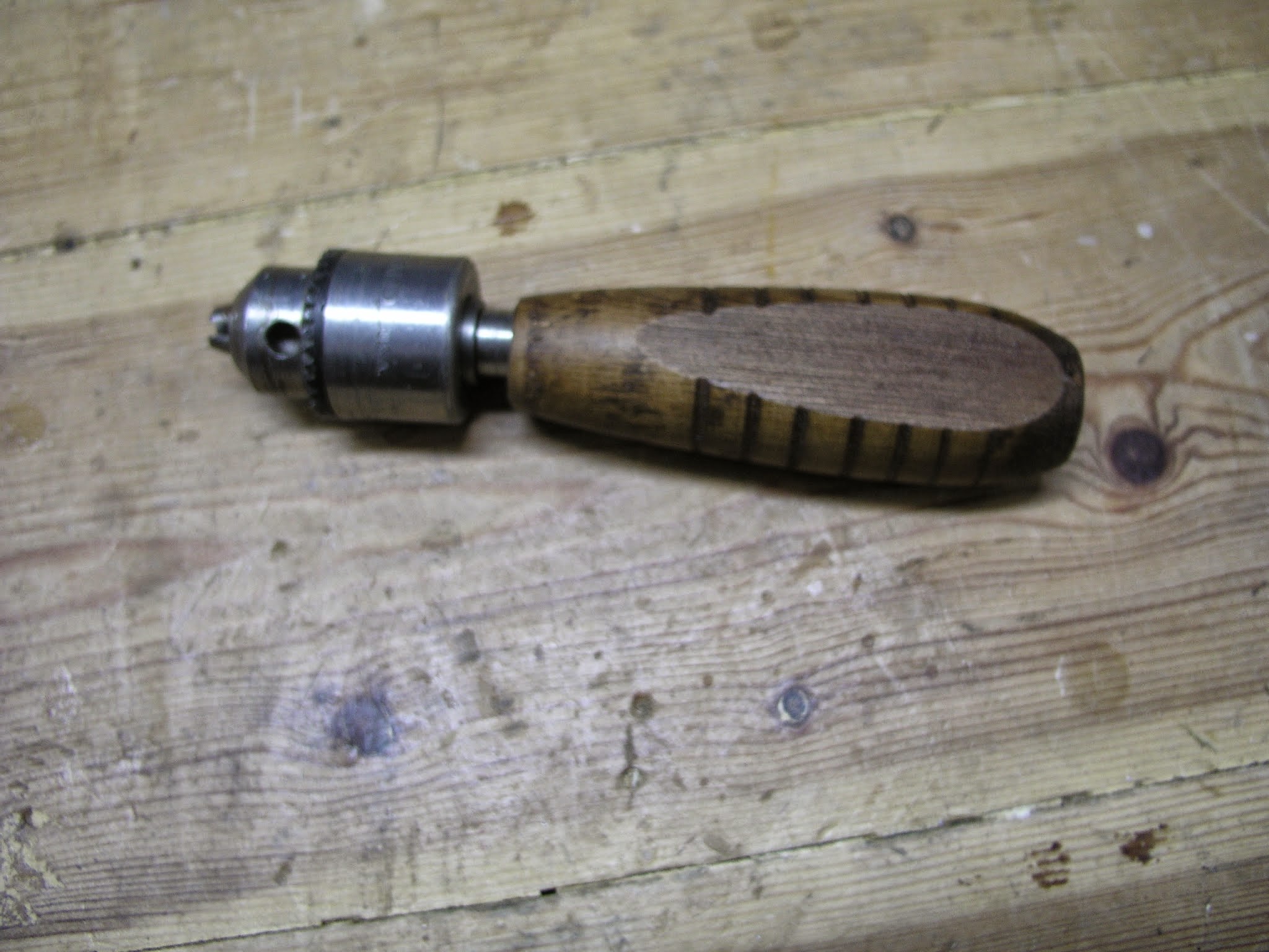

tranform the old drill chuck to a usefull tool
Attachment 3720
hold on a vise
Attachment 3719

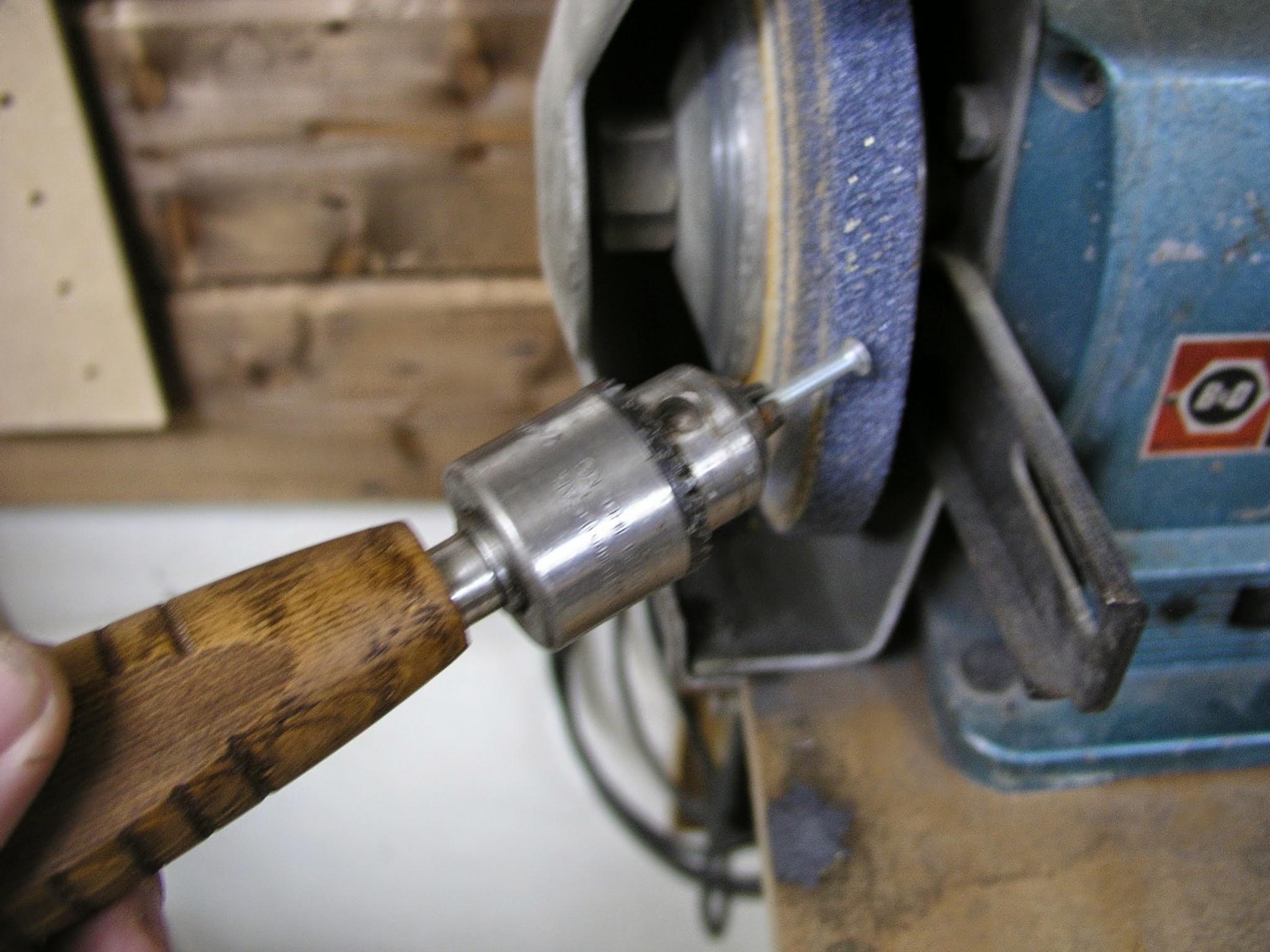

grinding small parts
Attachment 3721

Cool idea, using a chuck as a holding tool. In the absence of a spare chuck, one could just buy a cheap one and replicate this tool.
love it going to make one today
Brilliant, and well-timed for me. I just replaced the keyless chuck on my drill press this week with a keyed chuck and was wondering what to do with the keyless one.
Thank you. Tighting by hand i think is ok
Excellent idea! I have a drawer full of old chucks. Now I know what to do with a few of them.
Thanks!
Mark
Ended the time I burn my fingers :lol:
Thanks for sharing ..:hattip:
