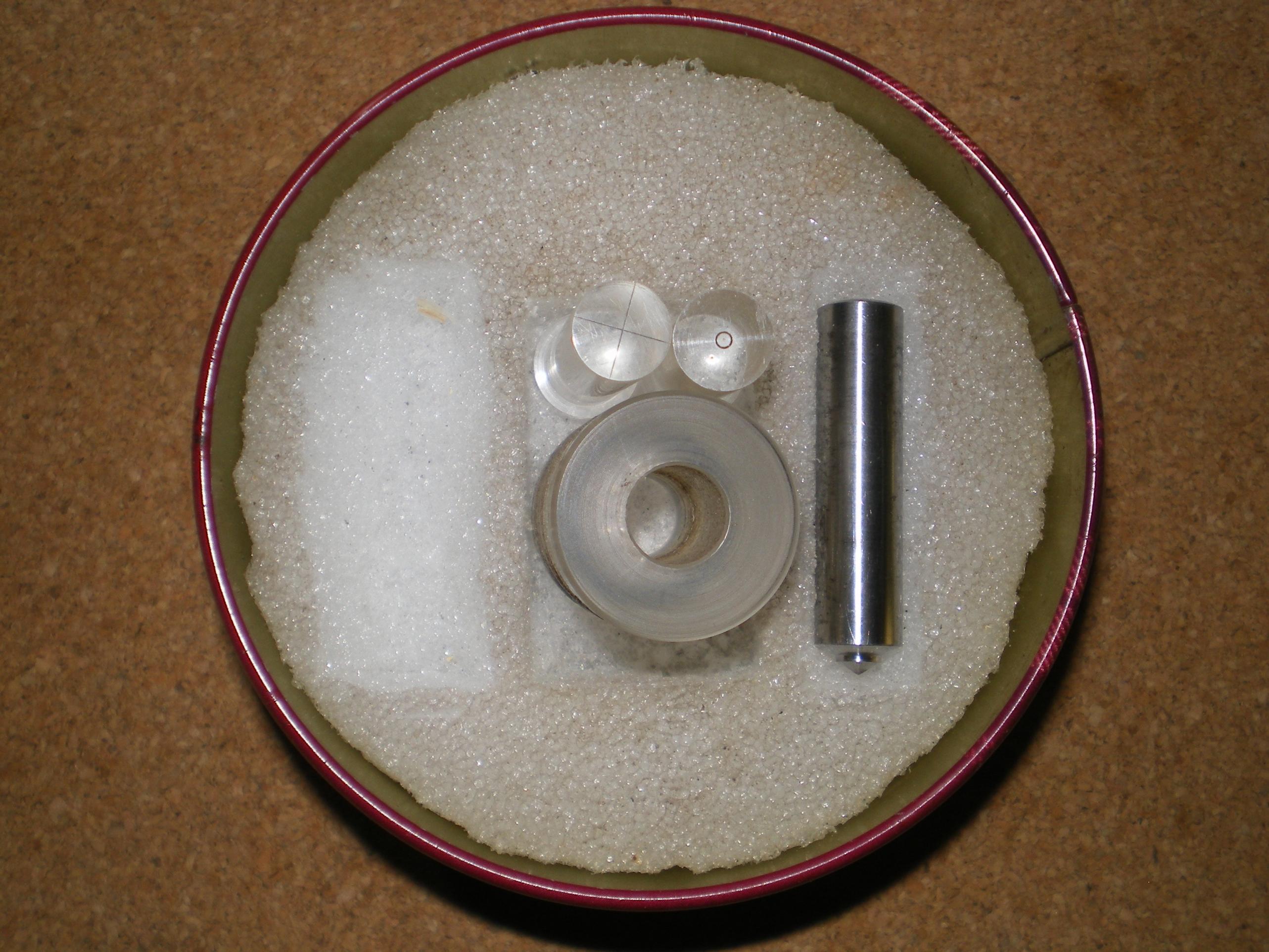

Knoba, Like I said I just love this thing and will be making one soon but realized you had a 17.8885mm spherical radius for your optics...how on earth did you determine that let a lone make it? I'll have to hunt for a tin though! :lol:

The radius of the optic was set to allow for some manual adjustment, later by trial and error, on the lathe. The actual radius ended up somewhere near 9/16th. The optic was gradually altered until it appeared to give a good magnification without too much distortion. Only the top surface of the curvature of the optic needs modifying as needs require.
Sometimes I get stuck knowing where to start with a project (like with my welding turn table). My answer, to myself, is just to start it, anywhere, somewhere, the answers will define the questions that need to be asked.

**Have updated the cad file and changed the optic to a 14mm radius.
Thanks Knoba, I get it about "just start" and that it would be a hunt and peck for optimum clarity and magnification...especially with trifocals. :lol: Don't have a ball turner for my lathe yet but pretty good with a graver. Thanks for a good starting radius and no worries about the foam...have a bunch! Need to look at your turntable again...but have to say, you are one Prolific builder!!

I found your optical punch design on your website before joining HMT. I copied it right away and it has been my go to marking punch ever since. I have used a HSS punch and all acrylic for the rest and made two optics, one with crosshairs and one with a bullseye (this is my favourite) I even copied the storage tin. Many thanks for the idea and everyone should make one, it never misses the mark.

Agree with olderdan, but can somone explain how to polish the acrylic lens ?
OK thanks, I think I had bad experience in the past, maybe I was too fast on the polishing disk, will try by hand next time.

My optical center punch is commercially made, it's a long time 'friend'. I have no clue about the optic radius, actual magnification or focal length, but it must be relatively high.
I'm near-sighted yet cannot use it without eyeglasses, that would make the focal length at least 18". It's not crosshairs but a .003 dot, slightly wider than a fine scribe line. It will locate centers within .002 all day.
There is no reason to suspect knoba's is any less accurate, therefore a worthwhile project.
