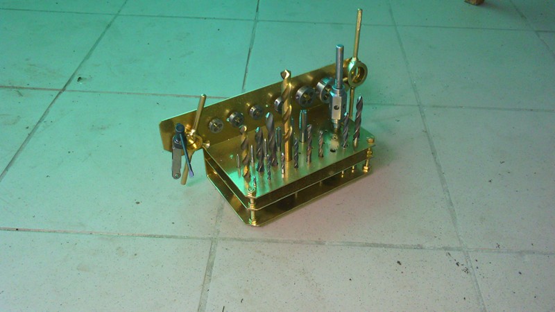

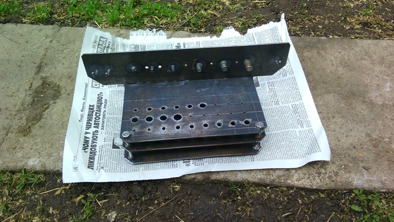

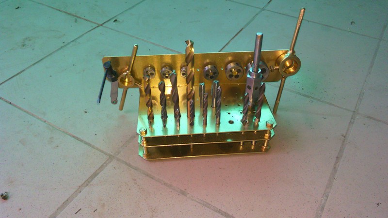

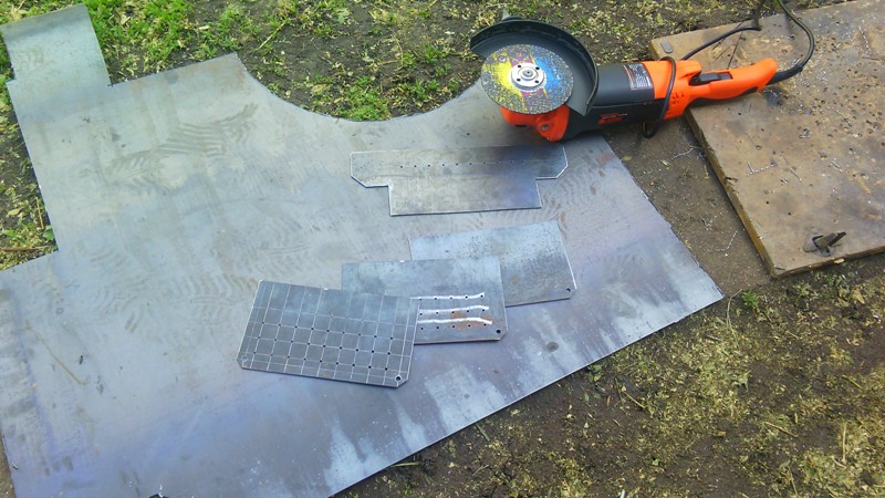

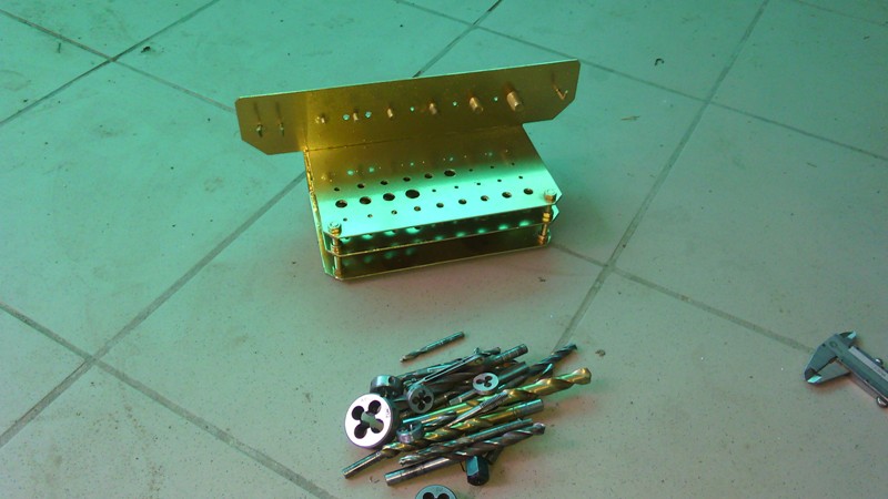

Homemade organizer for drills and threading tools. Sheet metal 2mm.
Attachment 18111 Attachment 18112 Attachment 18113 Attachment 18114Attachment 18115

Very nice work, how did you get the brass finish it looks great.

I don't see that in the pic they show for the stand. is the tap right next to the "thread" drill? and then beside the thread drill, a clearance drill too? It looks in the picture as though the taps are on the outside, and the drills on the inside...... I do have a TON of taps and drills for them I use a lot that be GREAT to have a rack for the ones I use the most.....
Good idea for keeping often-used drill bits, taps, dies/holders together. I'll make mine out of wood, however. It's much faster...time is not on my side!
I'm not certain about the one pictured in the URL; I only used that to demonstrate what I was talking about.
Mine, and all the others I've seen first hand, are arranged as follows, reading left to right...
NC tap
NC tap drill
NC/NF clearance drill
NF tap drill
NF tap
Mine accommodates taps in the range between #2 and 1/2". Taps smaller than #2 are so delicate that I made a small dedicated holder for them and their tap/clearance drills.

This is exactly what I was referring too! -I had to ask as the way you typed it out makes the most sense in how the holder would work on your bench or in a cabinet built for suck type holders.... (which one day will be my plan!)
-I'm not an old guy, really, BUT I'm on a TON of meds myself, and those pill vials in the standard sizes I get are saved for such tasks! I put all my "supply" in them, and only keep one of each item (drills and taps) out on the bench! Till it either A. wears out, or B. I break it..... LOL I plan to make a rotary rack to have each lid fastened to a board, on a octagon center, to spin with the same size bottles on every board around the octagon!
