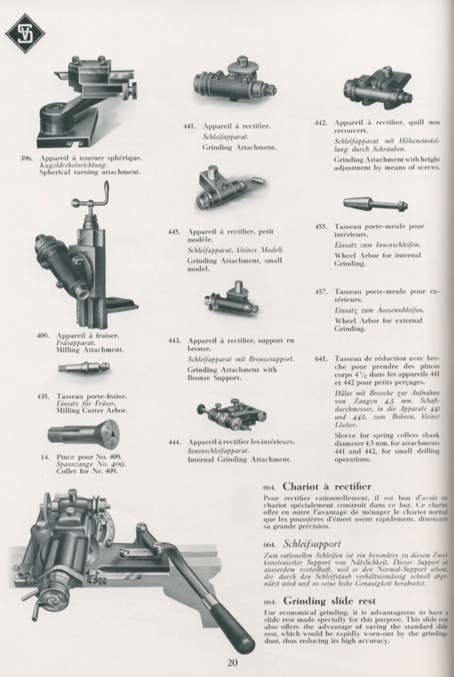

As I scan a part of an original documentation, that can give you some ideas for future diy tools, now you can just found them on the second market place and in good condition they stay expensive.
If somebody is looking for a Schaublin acessory, I can make a scan of the page, when I have time it's interessing to copy the integrality but it takes a lot of time…:confused:
