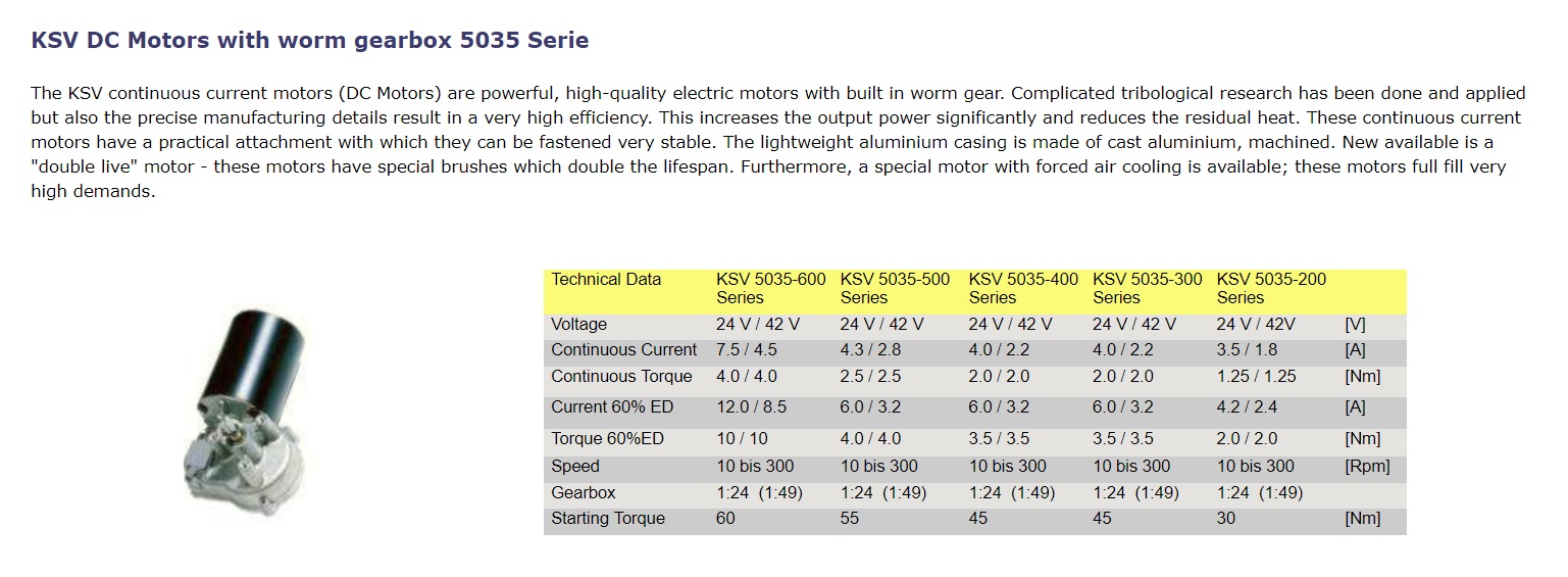

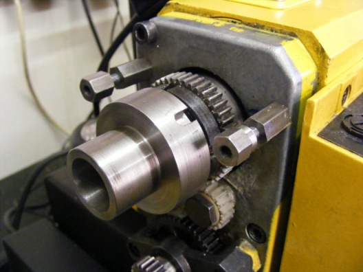

While soon fixing a threaded spindle spider to the headstock (for stock stick-out support),

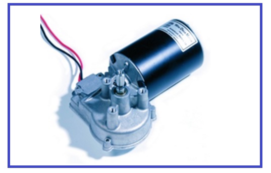

I thought: -Why not "just add" one of those < 500 W, <75 Nm torque, <200 rpm worm gear PMDC drives lying around?
Mounting that worm drive rigidly and non-intrusively to the left end of the headstock,
working thru some dog clutch directly at the spider,
I could get all the no-hostage torque for threading I'd ever need,
instead of farting around with my manual handle
(as I've already found that my winding introduces some to and fro warp to the bed for each turn).
A side benefit would be that the "pure torque" will then only be applied axially to the spindle,
and the resulting counterforces would be taken up by the headstock housing directly and entirely,
NOT by some gear, chain or belt that could bend and offset the spindle axis relative to the bed.
A 1 kW, 50 VDC max PWM cheap motor control will provide all the juice necessary
(fed by an E-bike LiPo power pack & charger I got (for FREE!) from a work buddy that had his E-bike stolen).
