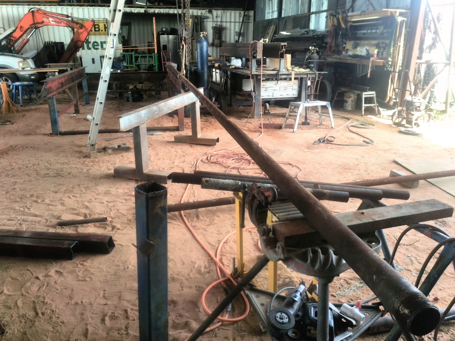

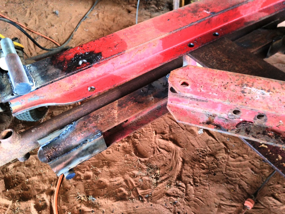

Many people are familiar with the way some roller-coaster tracks are mad out of pipe All they need is to support the rails more closely than a beam rail style the wheels are profiled to fit the OD of the pipe. My trusses as strong enough to serve as the supports so instead of needing beams for the crane to hang from or ride on top of square rails I used 2 7/8" oilfield pipes as the rails.
Attachment 46059
The pipe rails are welded to the top of the bottom truss member every 2 feet Via 1/2By 3 flat bar with gusset support on the pipe to prevent rollover stresses

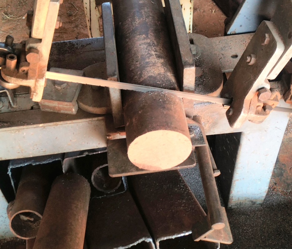

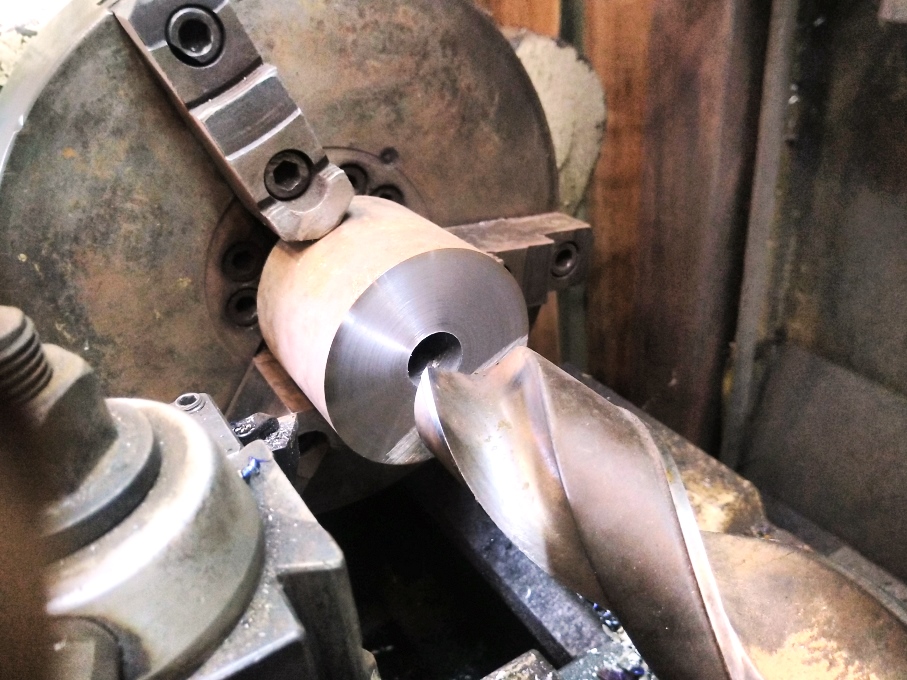

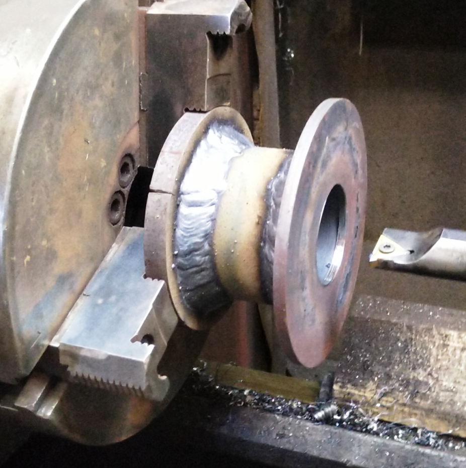

The beginning of the rollers is a length of 3 1/2" round bar
Attachment 46061
A 2" hole was bored through it
Attachment 46062
Then flanges welded to it to allow for the profile machining of the roller
Attachment 46063
Machining the bearing locations for 6306 bearings 30 Bore x72 OD x19 mm wide
Attachment 46064

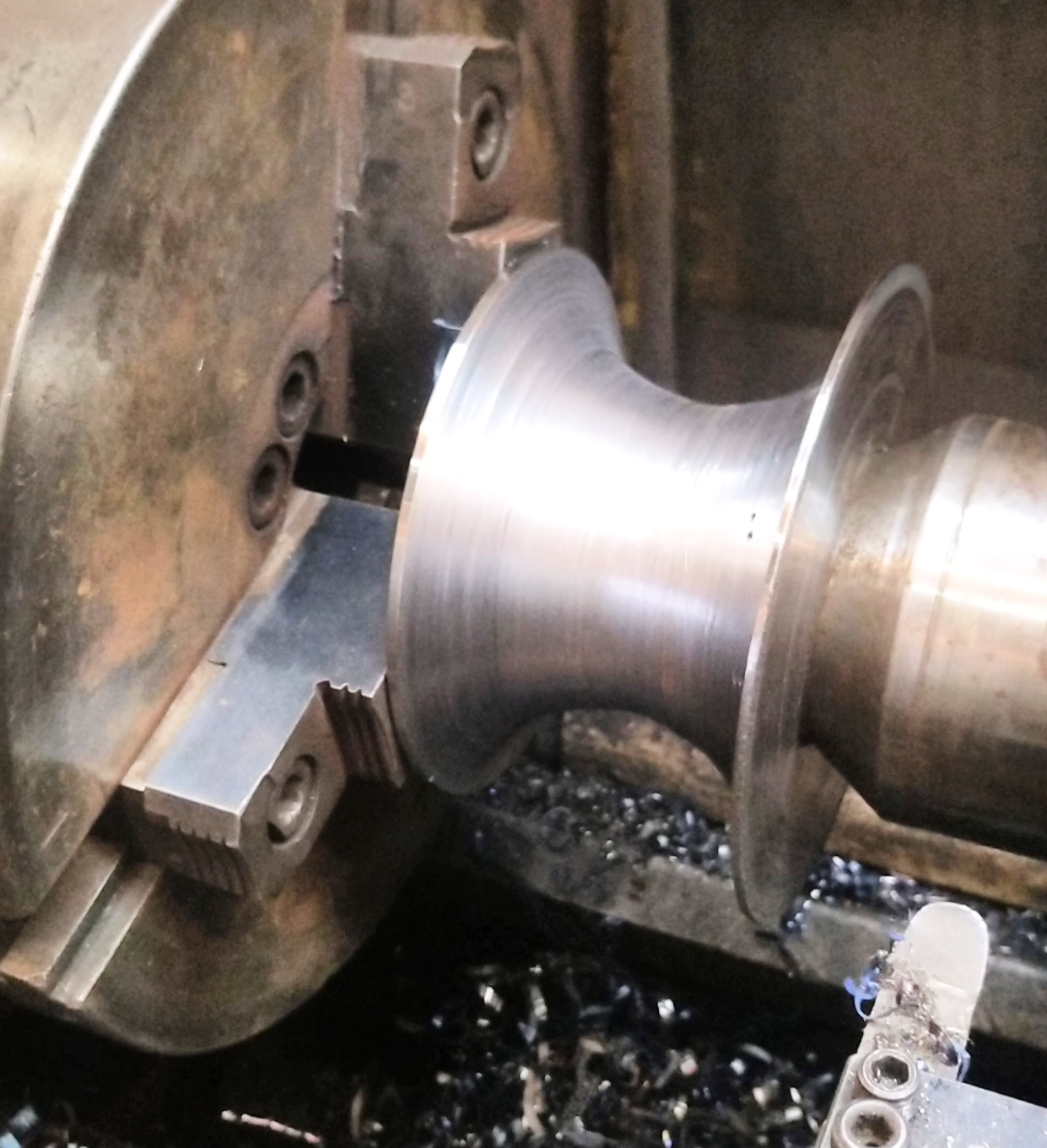

Machining the profile
Attachment 46065

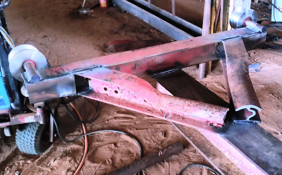

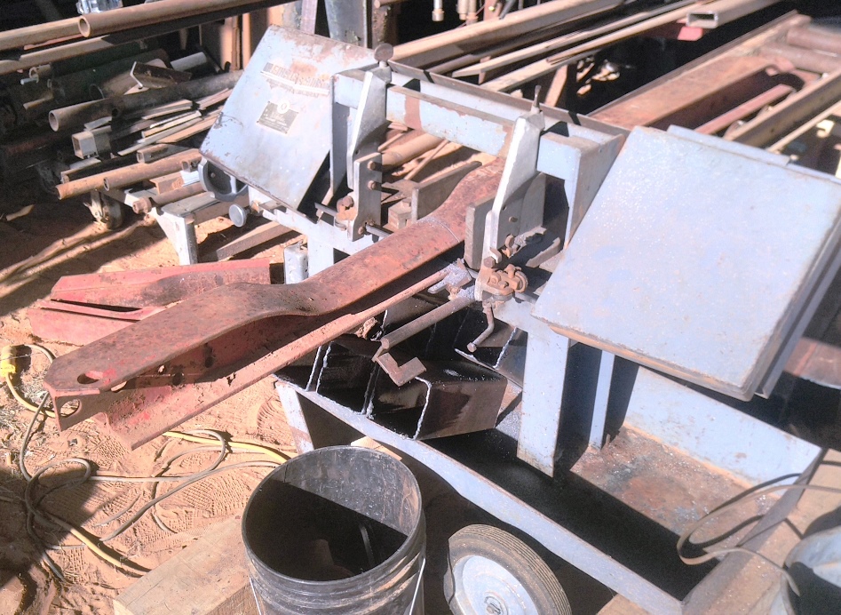

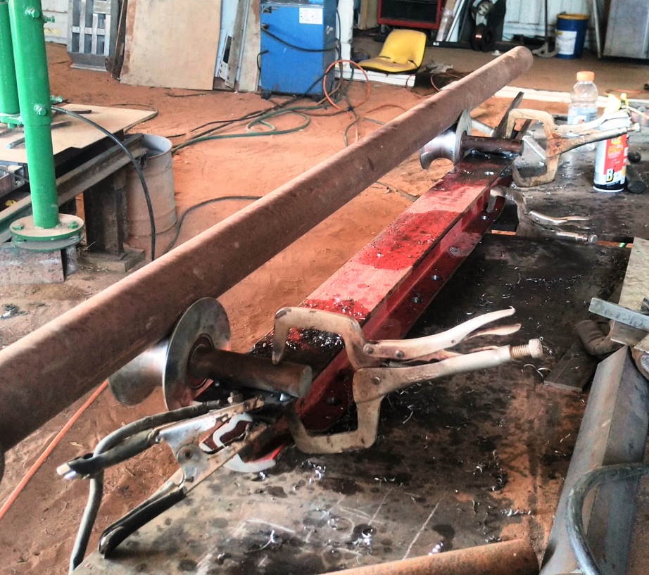

I had a pair of cross rails from an old Globe 8000lb 4 post lift that I used for the end trucks and bracing of the bridge
Attachment 46066

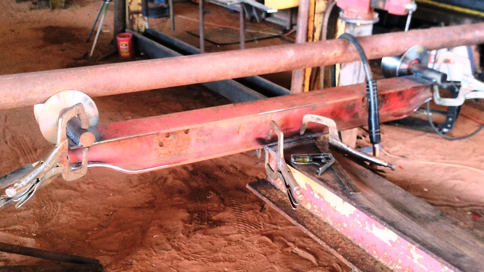

View of 1 end truck assembly using a length of pipe for aligning
Attachment 46067

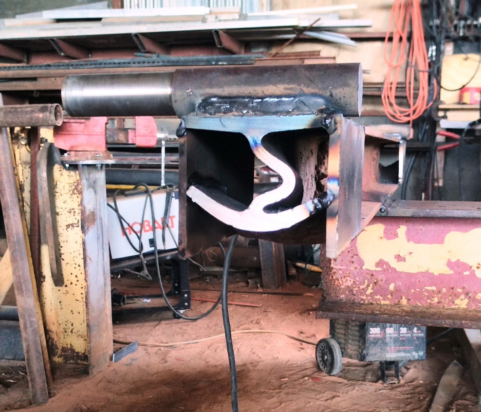

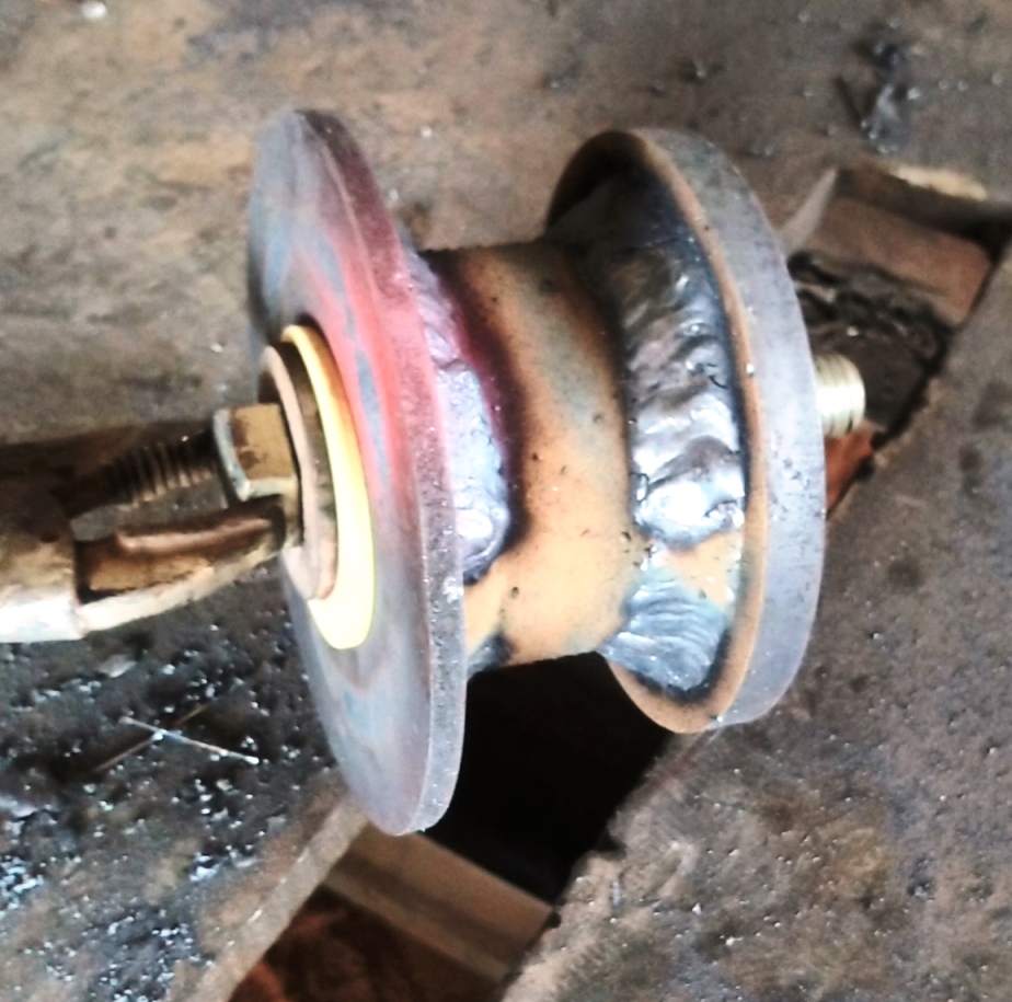

View of the end of the end truck with spindle welded in place note the compressed state of the end of the cross rail beam I used this proved to be beneficial in my design.
Attachment 46068
Aligning the spindles for welding
Attachment 46069

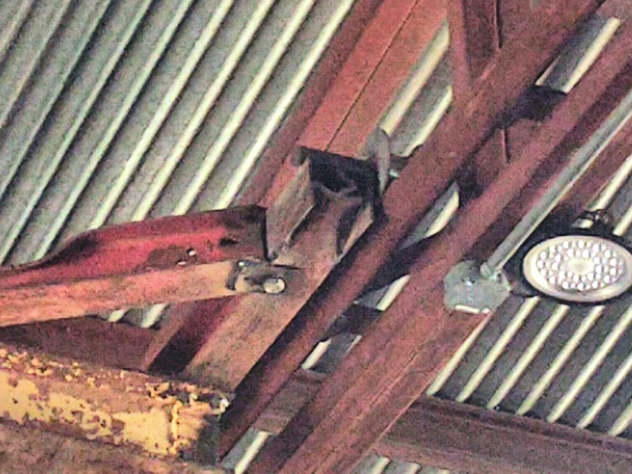

One end is bolted to the top of the bridge while the other end truck is welded this was done so the bridge could be installed. Note how the compressed beam pieces cut off from the ends of the cross rails worked out for bracing
Attachment 46070
Attachment 46071

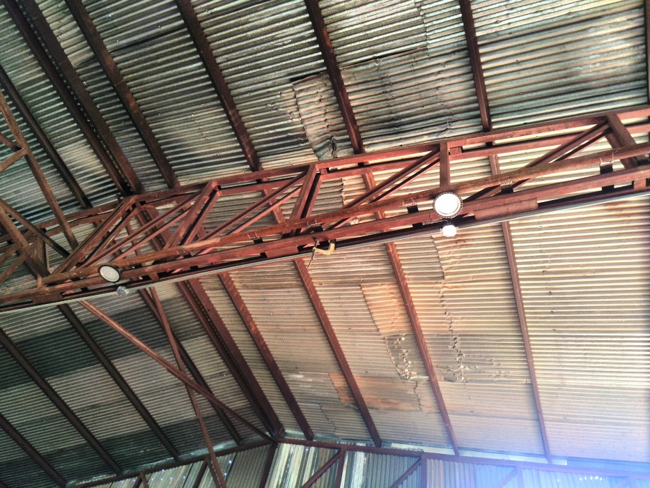

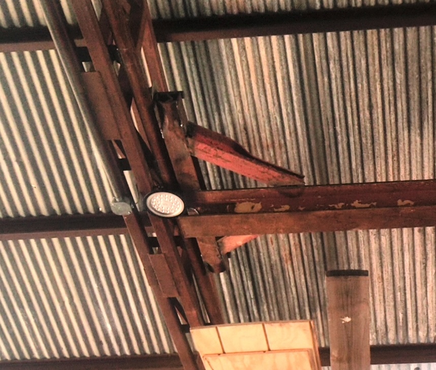

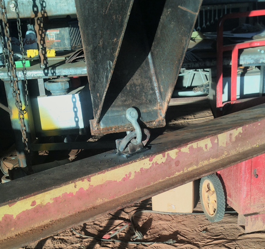

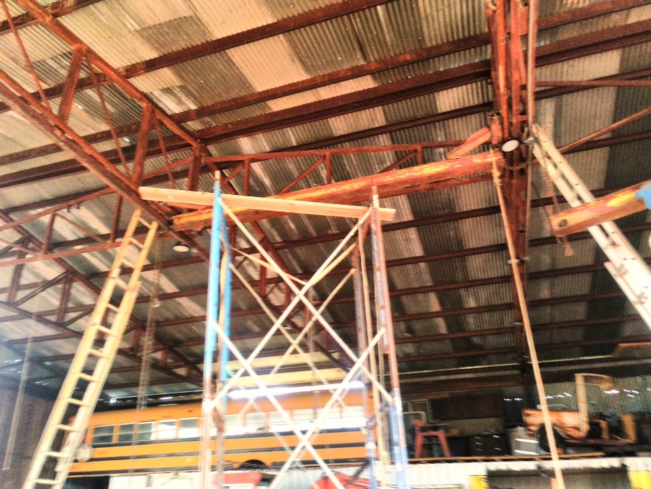

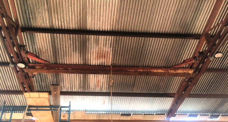

Hanging the bridge
Attachment 46072
Attachment 46073
Attachment 46074
Only thing left is to come up with a hoist for it then testing.
Truss calculations show the trusses can support a 10k load at the center of the 68ft span, the 14 ft bridge is good for 3 tons center of span but I am only looing to install a 1-ton hoist,
