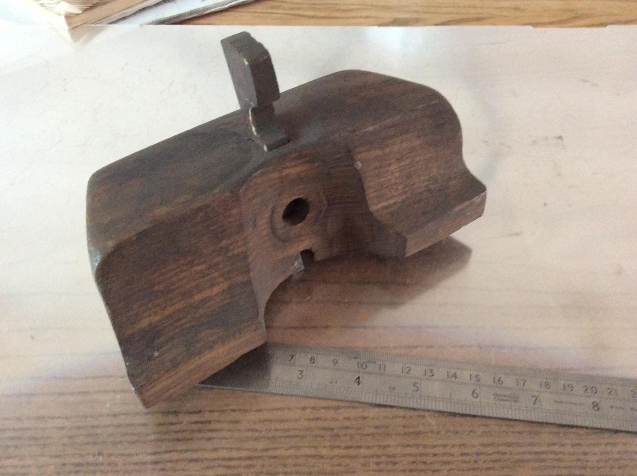

Properly, it is a router, to finish a recess, or housing.
It makes a chattering noise as you pass it forwards and back across the grain.Attachment 35642
I made it over 30 years ago. The body is formed from the foot of a piece of gymnasium equipment. There was another foot, which I also used for an OWT.

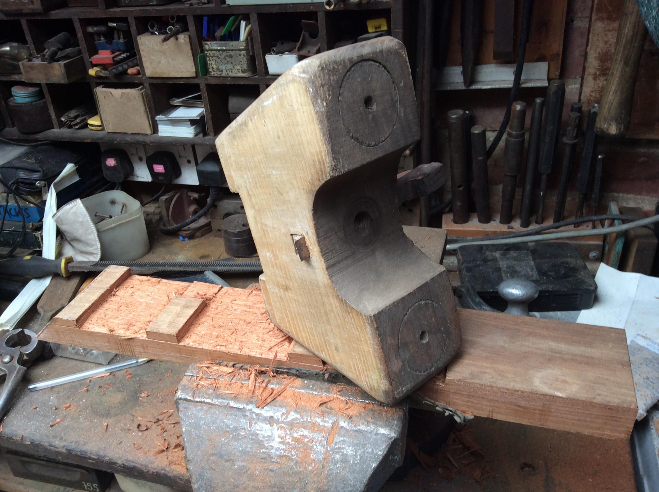

Attachment 35643
The view from beneath shows the iron is a 4-square file. The wedge is rosewood.

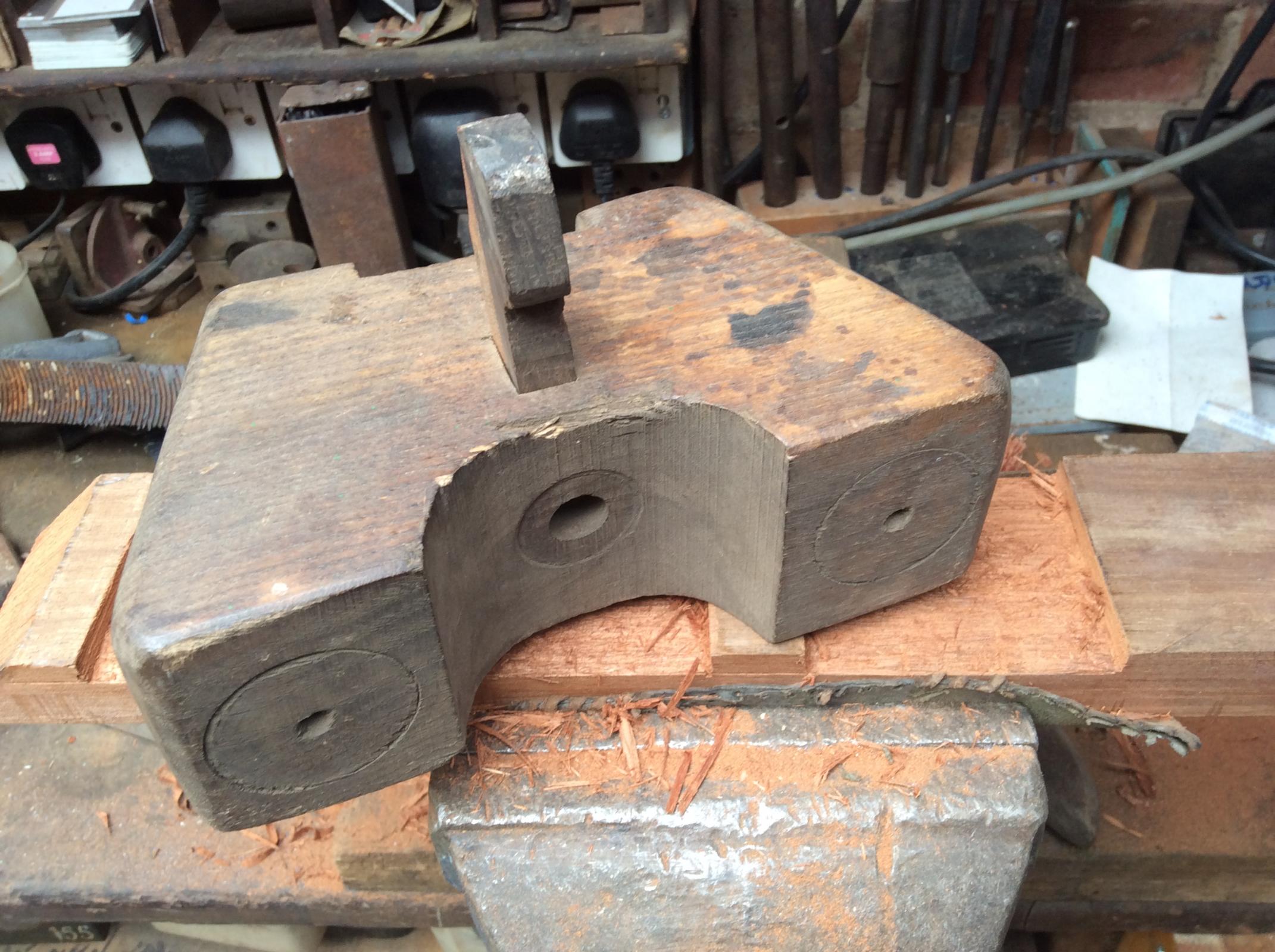

Attachment 35644
This is the other one I made, more like the usual shape.
I prefer to use this to using a machine router for just a small job, no need to bother with PPE, extraction, dust everywhere. Noise.
It does not give a very good finish, so.....

So basically a scratch stock. Instead of shearing the grain you abrade it. I have done fairly complex moulding reproductions in a similar fashion with older HSS saw blades ground and sharpened up ion the appropriate profile. I agree with the no dust or noise. If it is not to make money and you want to enjoy yourself why not!
