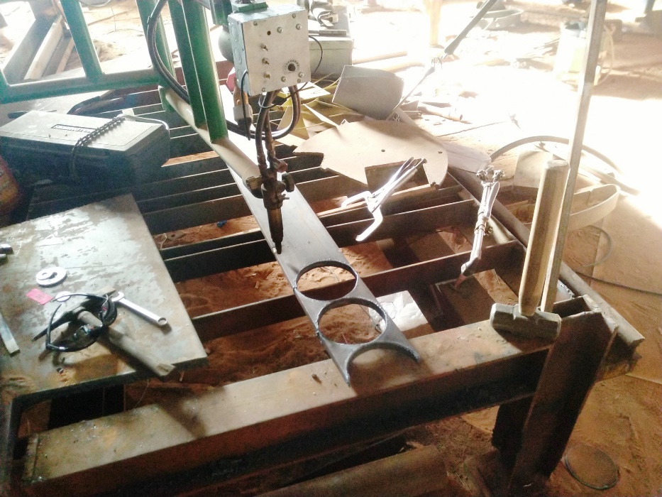

Currently I am building a cutting table for it which will have a gantry for the torch to mount on this way an entire 4x8 sheet can be cut up without having to move the sheet of steel

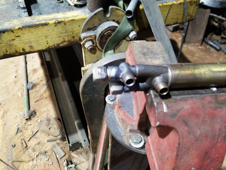

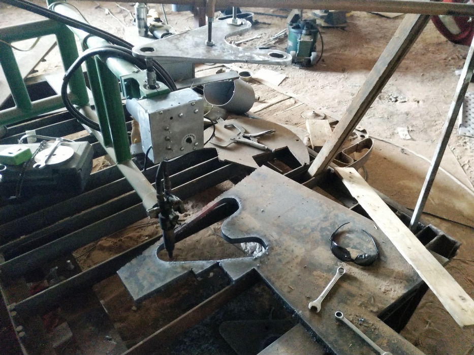

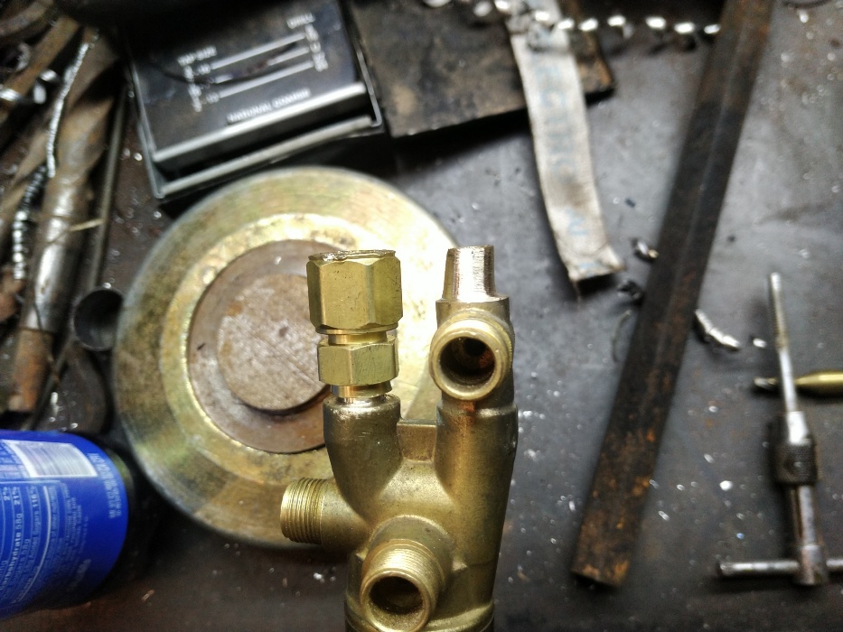

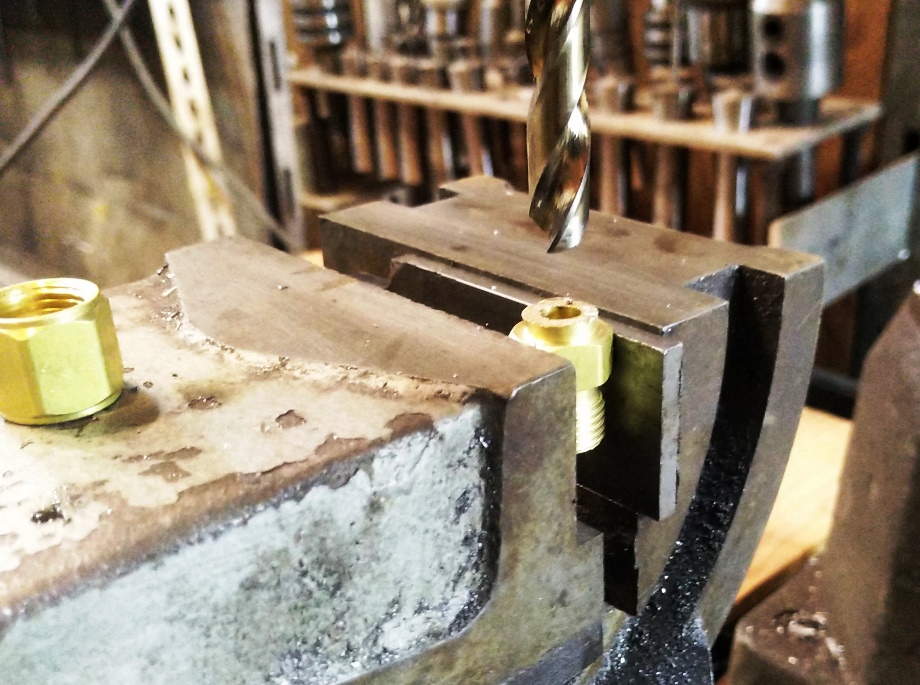

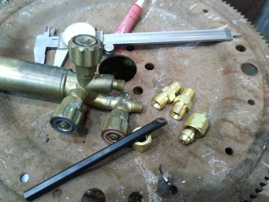

At long last I finally got fed up with having the Pantagraph torch taking up space and not being reliably useable. I started building this thing back in 2015 a couple years ago a built a burn table for it last year I made the drive motor this week I really needed to finish it. I made the controller for it complete with on off Sw forward reverse Jog and speed control. Thinking everything was good to go the stylist shaft with the neo magnet in it turned out not to be straight and it didn't have a good grip on the magnet between the bottom of the shaft and the top of the shaft so it slipped half the time I made a new shaft to fix that then having bought a machine torch a long time ago, from who knows where, turned out not to have either of the 2 US standard oxy fuel hose fittings Every welding supply I talked to said the same thing it either has the A size or small one or the B size larger one those are the only 2 sizes there are. Ha-ha-ha, fat lot any of those guys know. The threads on this torch were larger than the A actually they were of all things 12 mm but 20 threads per imperial inch What the heck kind of fitting is that? Sounded like something a very confused person would come up with, I filed the threads of to as round as reasonable then cut off 1 end of the standard hose splice couplings drilled them out and silver brazed them to the torch Problem solved Take that MR confused person.

It works just fine you can see the controller at the top under the pattern

Out of idle curiosity, I spent 10 minutes looking at pipe thread tables. Both ISO & BSP have 19 tpi at that size, but I think the latter would be over13mm
