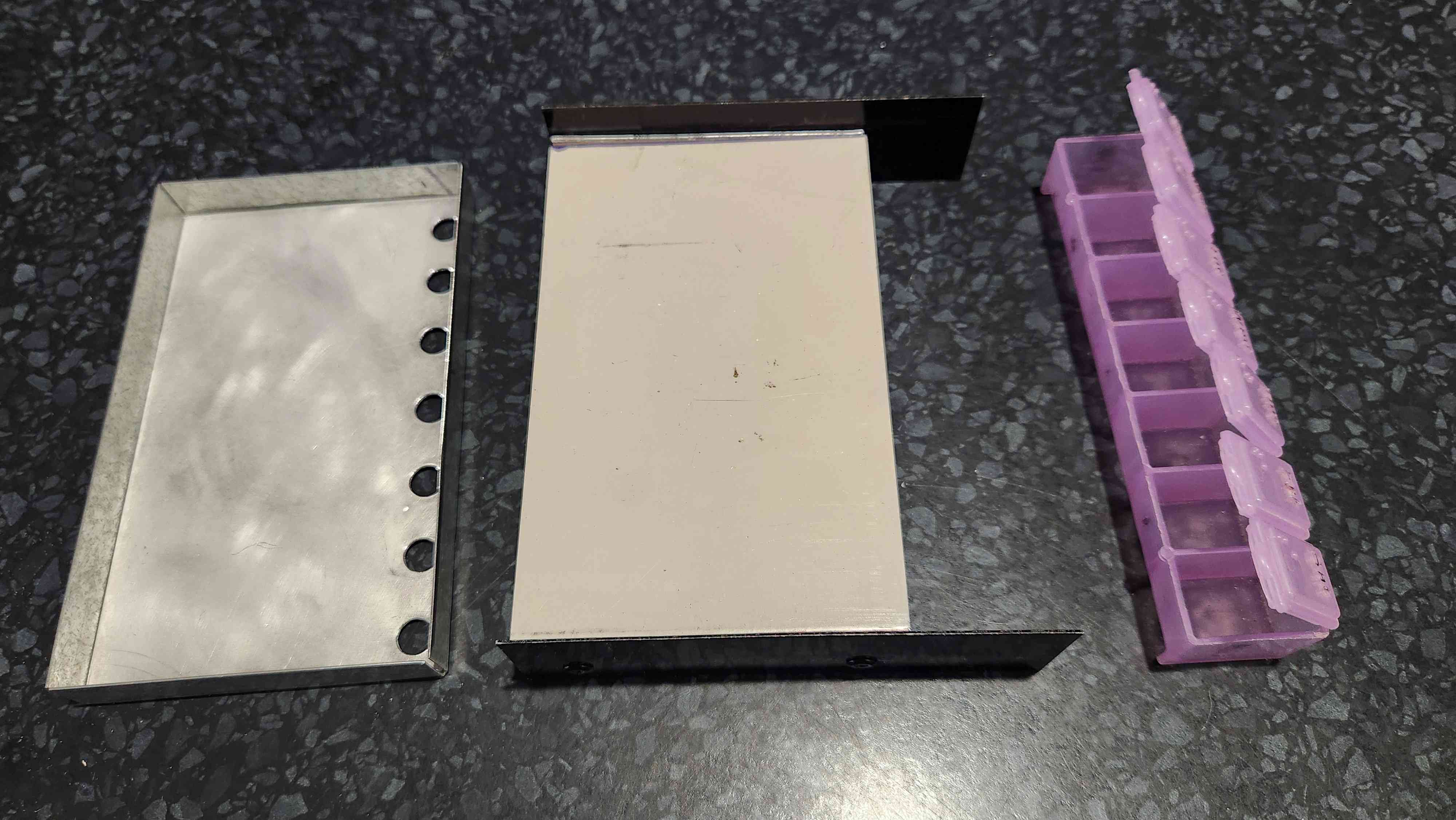

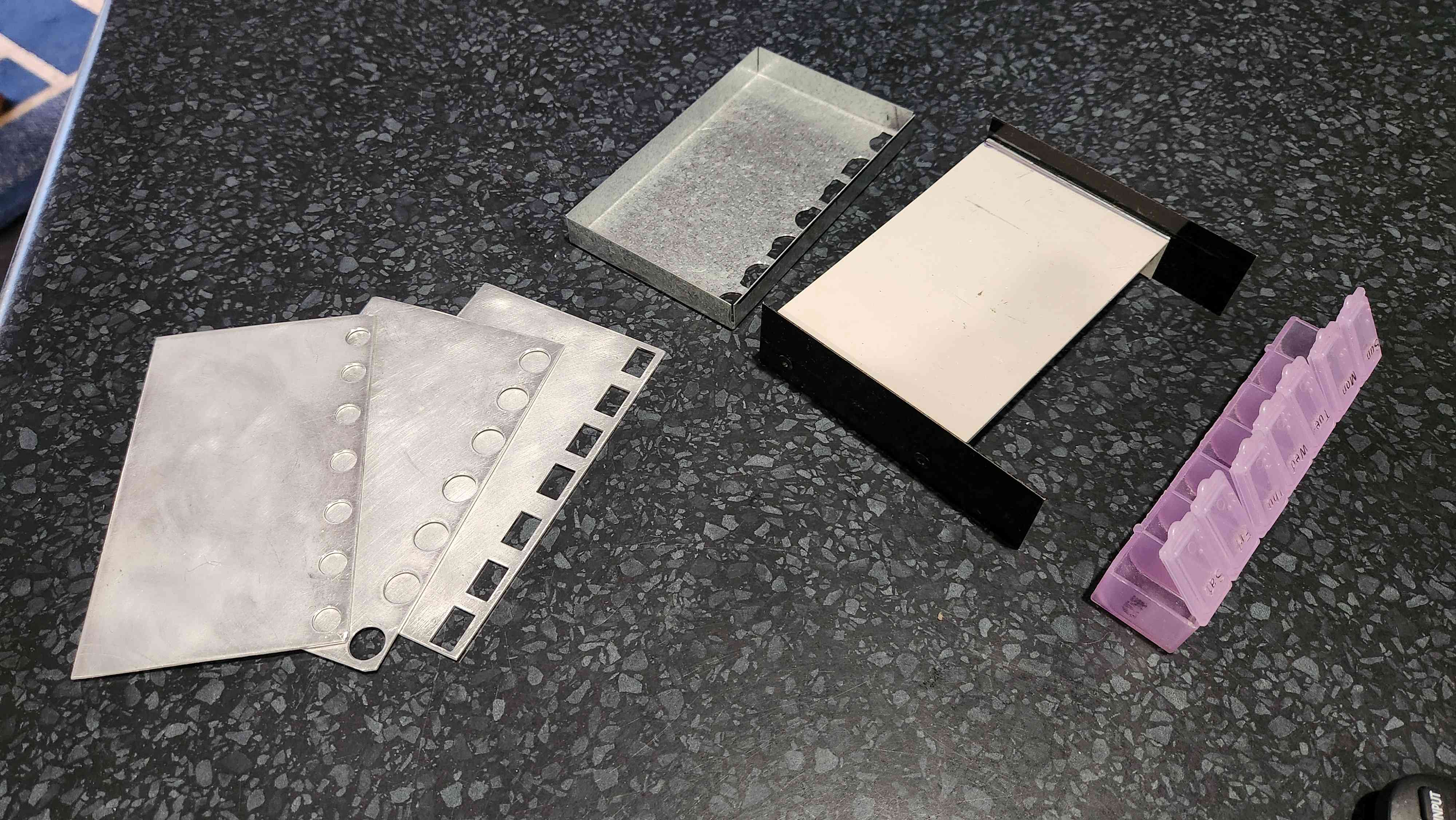

THE COMPONENTS
Attachment 50772
From the left, 3 sorting tray inserts to suit different sized and shaped pills, the dispensing tray (note the 7 holes for pills to drop through), the tray holder which sits at a height to overlap the pill box compartments, and the pill box.

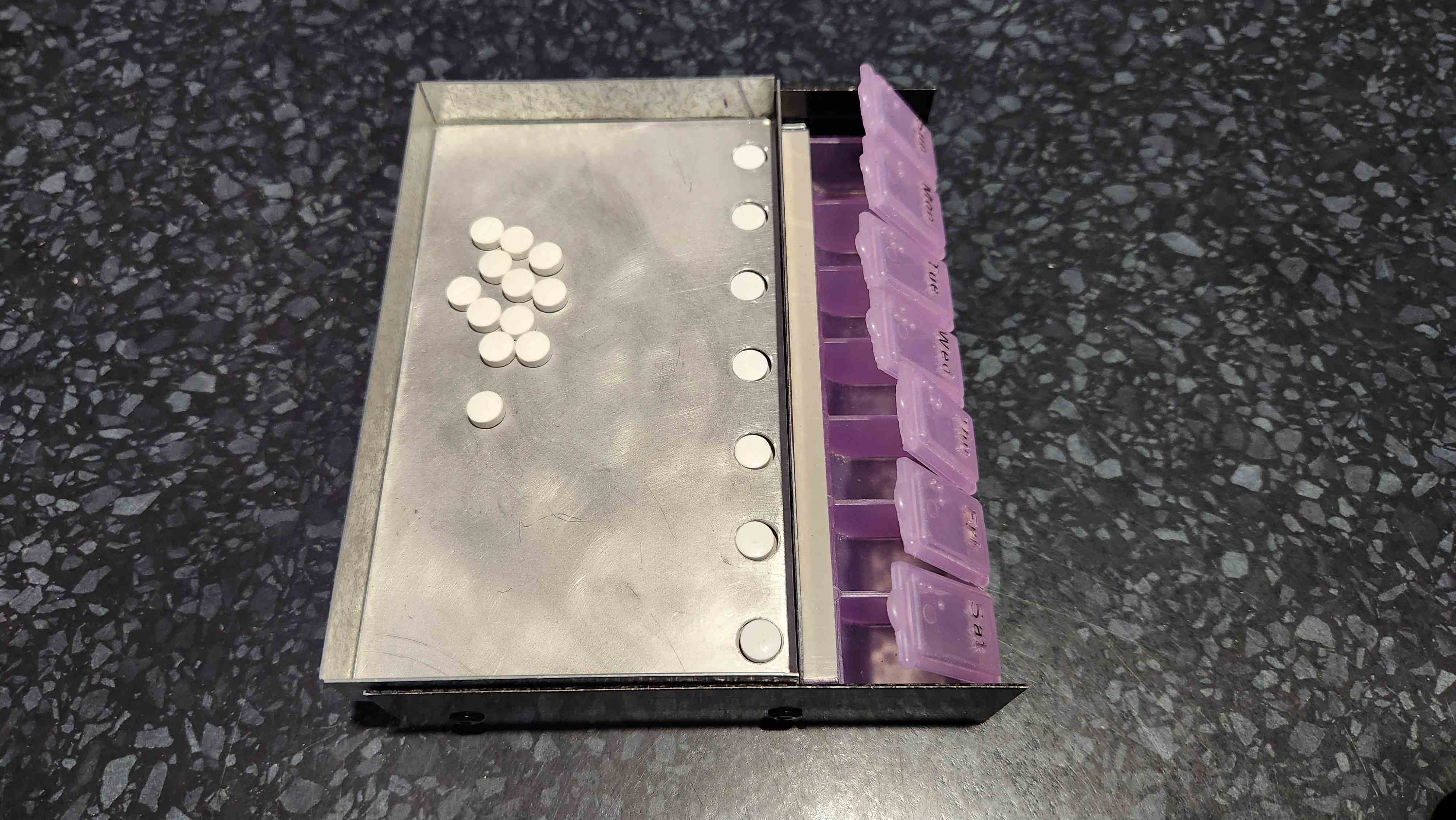

INSERT LOADED WITH PILLS
Attachment 50773

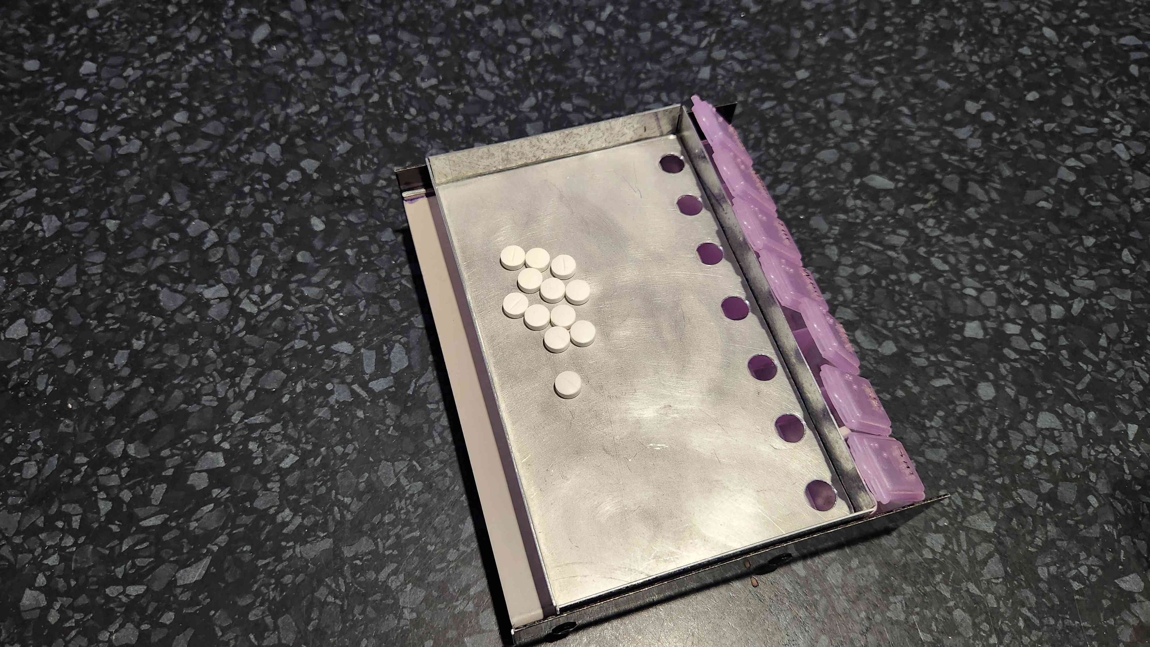

TRAY IS AGITATED GENTLY TO FILL SORTING TRAY HOLES
Attachment 50774
SLIDE TRAY TO RIGHT TO ALLOW PILLS TO DROP INTO BOX
Attachment 50775
