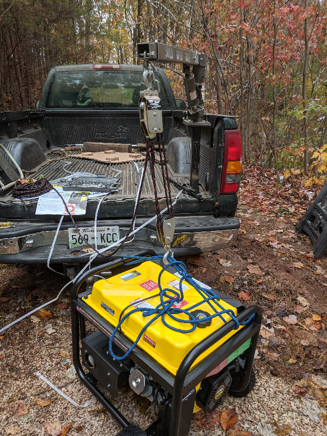

Okay, resizing to a max of 900 seems to work. I agree that taking your time to decide how to accessorize is good. In the photo I'm using a block and tackle from Tractor Supply that has a jam mechanism for the rope so you don't have to tie the rope off. But I'd like to add a 12V winch, one of those $49 jobs from Harbor Freight. I just need to spend some time figuring out how to attach it so it doesn't get in the way of rotating the crane arm. Normally the crane sits lower because I keep a top on the bed. Down low is where the problem of rotation freedom shows up.

I would like to see pics. I have been wanting to mount one outside the box connected to the hitch and probably frame, with a drop leg for when in use. I don't mind taking it off and only installing it when going to collect something. I think a mounting plate that I could use as a step to get into the box would be a great bonus. I presume it is not illegal as hitches stick out the back, would have to watch interference when turning sharply with a trailer.

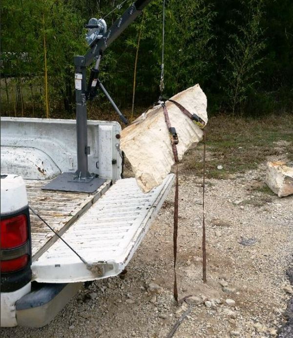

And Bob's yer uncle. I finished the bed mount yesterday and tested it today with a 500# rock and it was easy peasy. I didn't hear any metal straining during the lift and I don't see any new bending of the bed afterwards so I think my mount is probably OK up to the hoist's rated capacity of 1000#. The base plate is an 18" square of 3/8" plate bolted to a frame rail and the rear cross support, and the hoist is bolted to the plate (all grade 8 bolts).
Progress marches on and my back thanks me for it. Thanks to all for your input which guided my decision to buy and install this bad boy. It'll be a game changer for me.
