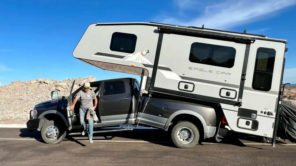

There was a recent kerfuffle involving a new Ram truck. It was a crew cab 4x4 3500 dually, IIRC. He picked the model because it has a load rating of 7500-ish pounds. He owner installed a slide-in camper that weighed 6500lb fully loaded, then took it on a 25,000 road trip through mountains and "unimproved" roads in Mexico, where the truck frame snapped between the bed and cab. The guy insisted MFR defect. It turned out that the defect was the nut behind the wheel. The load rating he calculated was for the standard cab longbed 2wd. The correct rating for his truck was 5500ish, and 2/3 of the camper's weight was over or behind the rear axle, making it a giant counterweight.
The fact that it lasted as long as it did is either a miracle or a testament to the engineering, depending upon how you roll.

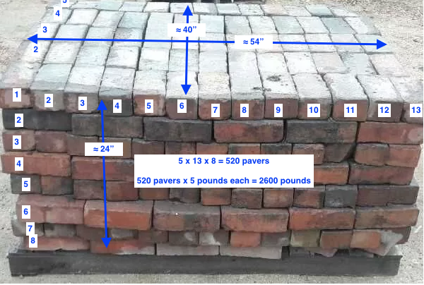

My 2005 extended cab Tacoma has a max payload of 1400 pounds. With passengers, fuel, and some tools that brings the "load capacity" down to under 1000, maybe 900 pounds. It has a 6 foot bed, with about 3 1/2 feet between the fender wells. A pallet of used paving bricks is about 24" high, 40" wide, 54" long and weighs about 2500 pounds. It would easily fit in the bed of my truck.
Or if I want to haul a steel stamping die that size it would weigh about 14,700 pounds!
Making a truck strong enough to carry anything someone might want to put in a truck is not feasible.
I do not want to pay for all of that extra capacity, pay for the extra fuel to haul that extra weight around, endure the rough ride when the springs are not flexed at all when I am just hauling tools, a couple of sheets of plywood, some bags of fertilizer, or a few cans of fuel for my tractor.
