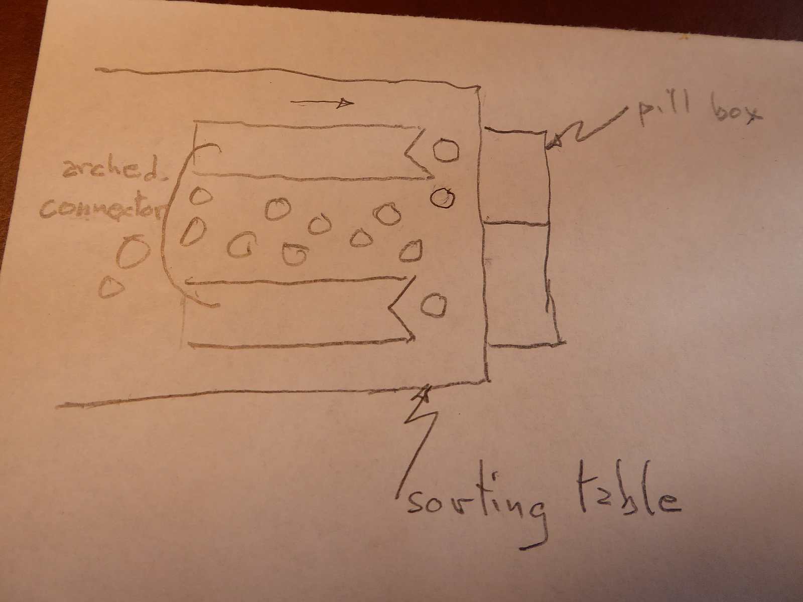

You sucked me in again, Rick. I found myself, sponge in hand, standing still in the shower thinking about this. At 85, I also have a seven day pill container to fill every week. I'll offer what I envisioned, not intending as an improvement to your method but rather another way to approach the problem.
Imagine a flat comb-like structure made of seven, evenly spaced, strips of flat material (wood, plastic, cardboard) held together with arches so that pills not caught on the V-shaped ends of these strips can pass between the strips as the strip "comb" sweeps through a cluster of pills scattered on a smooth, flat surface.
The edge of the flat surface lies over the open pill box. As the comb reaches the edge, the pills drop into the seven containers.
The other edges of the surface have low walls arranged into a funnel-like configuration so that, once the pill box is loaded, the surface can be tilted to funnel the remaining pills back into the container from which they came.

Close but not quite what I had in mind.
The tines of the comb in my vision are narrow with parallel sides (picture a popsicle stick). At one end of each of these tines is a small V which captures a single pill. Seven of these are fastened into a comb in a way that allows any pill not captured in the V to remain in place. Once each V is filled, the comb is pushed over the edge of the plate and the pills drop out of the V's into the open pill boxes held just below the plate.
Maybe the attached crude sketch will help.
Attachment 50743

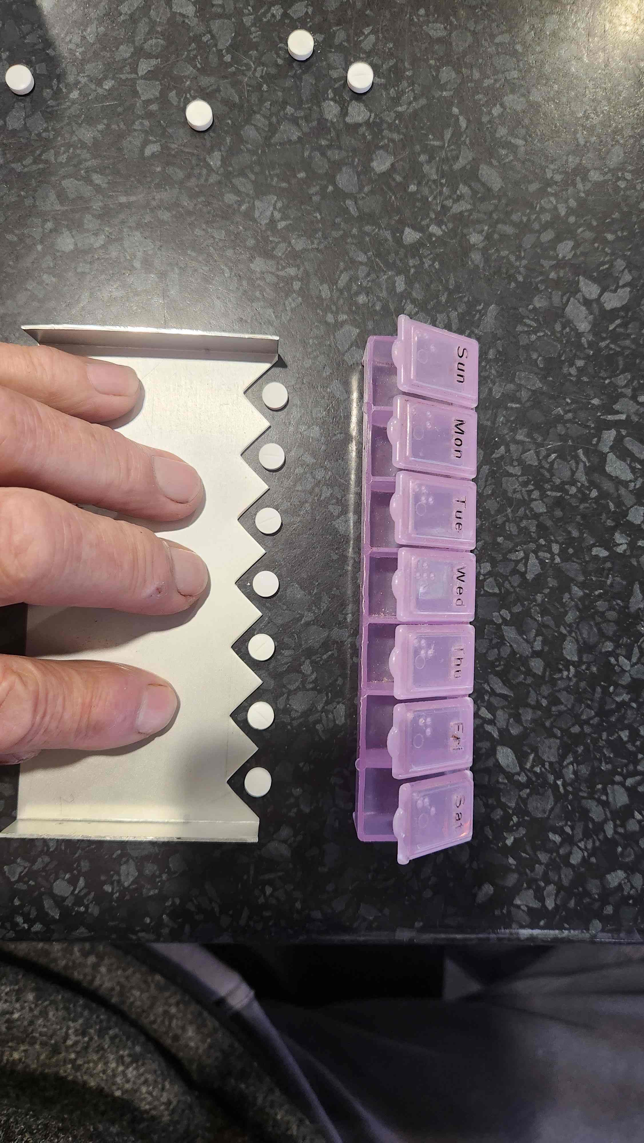

This is what I've come up with, it's very good for collecting together 7 pills and has been made to neatly fit and fill the days of a weekly pill box. After 7 pills have been collected the remaining ones are simply brushed aside, and the 7 can then be swiped into the pill box. I would like to add a simple mechanism for automatically collecting just 7 pills and discarding the rest, but that hasn't emerged from the depths of my mind yet. Maybe tonight.
Thanks for your ideas Rick & Marv.
Attachment 50745
I add that it's a simple tray made from aluminium sheet with V notches cut out. A useful addition which I will shortly make is another tray that this one slides on top of and that fits around the ends of the pill box so that a swipe of the top tray dispenses the pills accurately into their respective days without spillage.

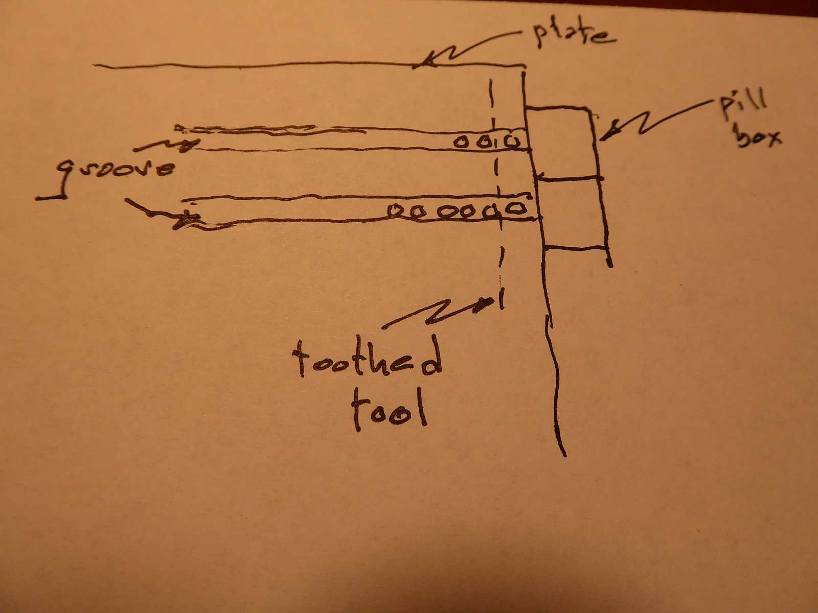

Asymmetric pill shapes (e.g., elliptical, capsule) cry out for a means of aligning them.
Think about providing some suitable grooves in the flat surface on which the pills are initially placed. Throw the pills on randomly, provide a little agitation and, voila, the pills are aligned with their major axis parallel to the groove.
The number of pills in each groove is not the same so a simple push with a comb won't work. I haven't gotten beyond this point yet so I'm just describing the grooved plate idea so others can run with it.
Scenario: Seven straight "grooves" in a plate, each with a different number of pills aligned in the groove.
Block all the grooves at one edge of the plate and agitate until pills are touching the block.
Make a separate tool with seven teeth spaced to match the groove spacing. When this tool is inserted between the pill touching the block and its immediate neighbor, all seven pills can be swept into the waiting pill box.
Again, one of my crude sketches may help visualization.
Attachment 50747
