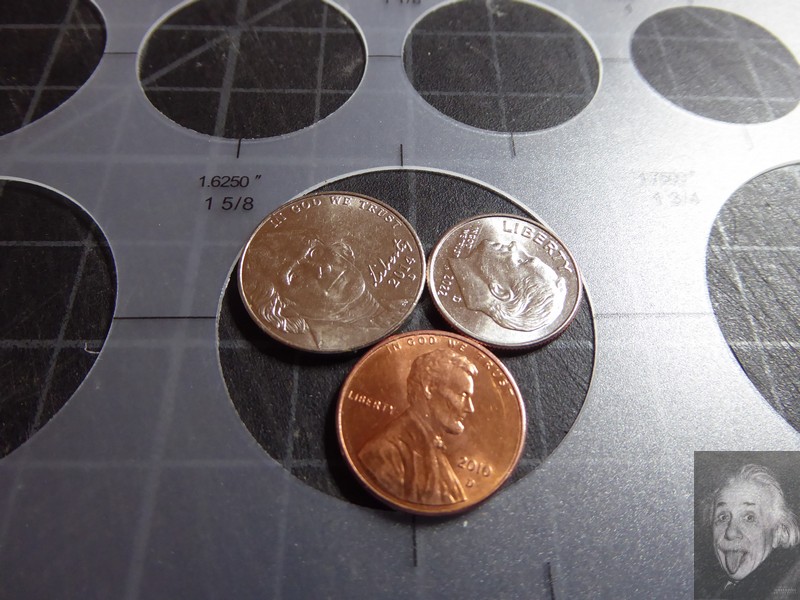

Shops that need to make precision measurements of small holes usually use pin gauges. These tools eliminate the need for the user to develop a refined "feel" as is the case with split ball and telescoping gauges.
But what do you do if the hole has a diameter a bit bigger that your biggest pin gauge?
Here again mathematics comes to the aid of the machinist. If you have three circles of differing diameters with each tangent to the other two, it's possible to draw a circle around them that is tangent to all three. Mathematicians refer to this outer circle as the outer Soddy circle (yes, there's an inner Soddy circle). This means that, if we can snugly fit three pin gauges into the hole, we can calculate the diameter of the hole using the formula for the Soddy diameter, which is:
S = d1*d2*d3/{d2*d3+d1*(d2+d3)-2.*sqrt[d1*d2*d3*(d1+d2+d3)]}
where d1, d2, d3 are the diameters of the three pin gauges.
A visual may aid understanding... I measured the diameter of three coins...
penny: d1 = 0.748
nickle: d2 = 0.833
dime: d3 = 0.703
and calculated the resulting Soddy diameter
S = 1.647...
then laid these three coins tangent to each other on a 1.625 circle template...
Attachment 45121
Look carefully and you will see that the penny just slightly overhangs the edge of the hole. I'll bet the three coins would fit exactly into the circle if it were, say, oh, 1.647 in diameter.
