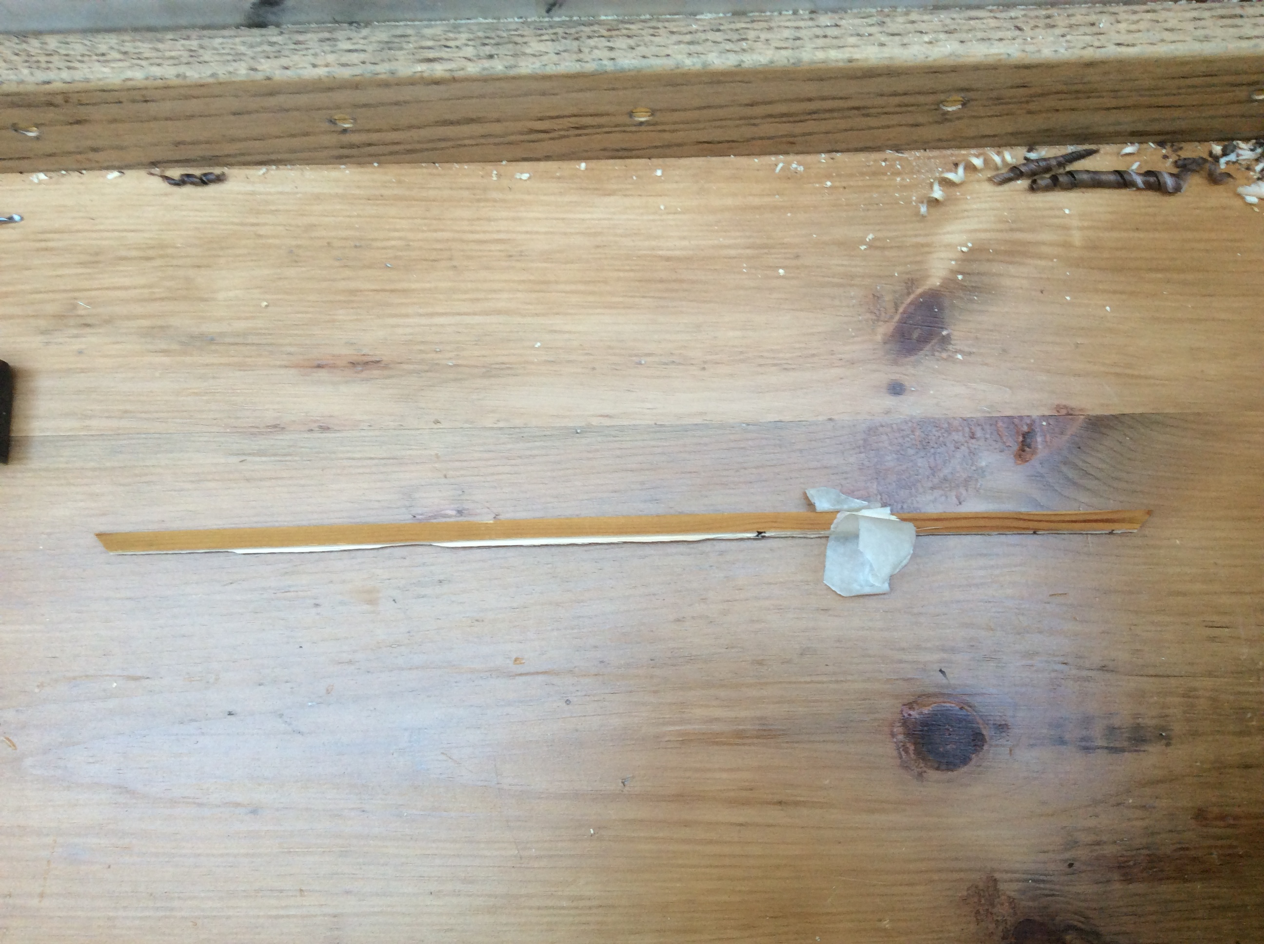

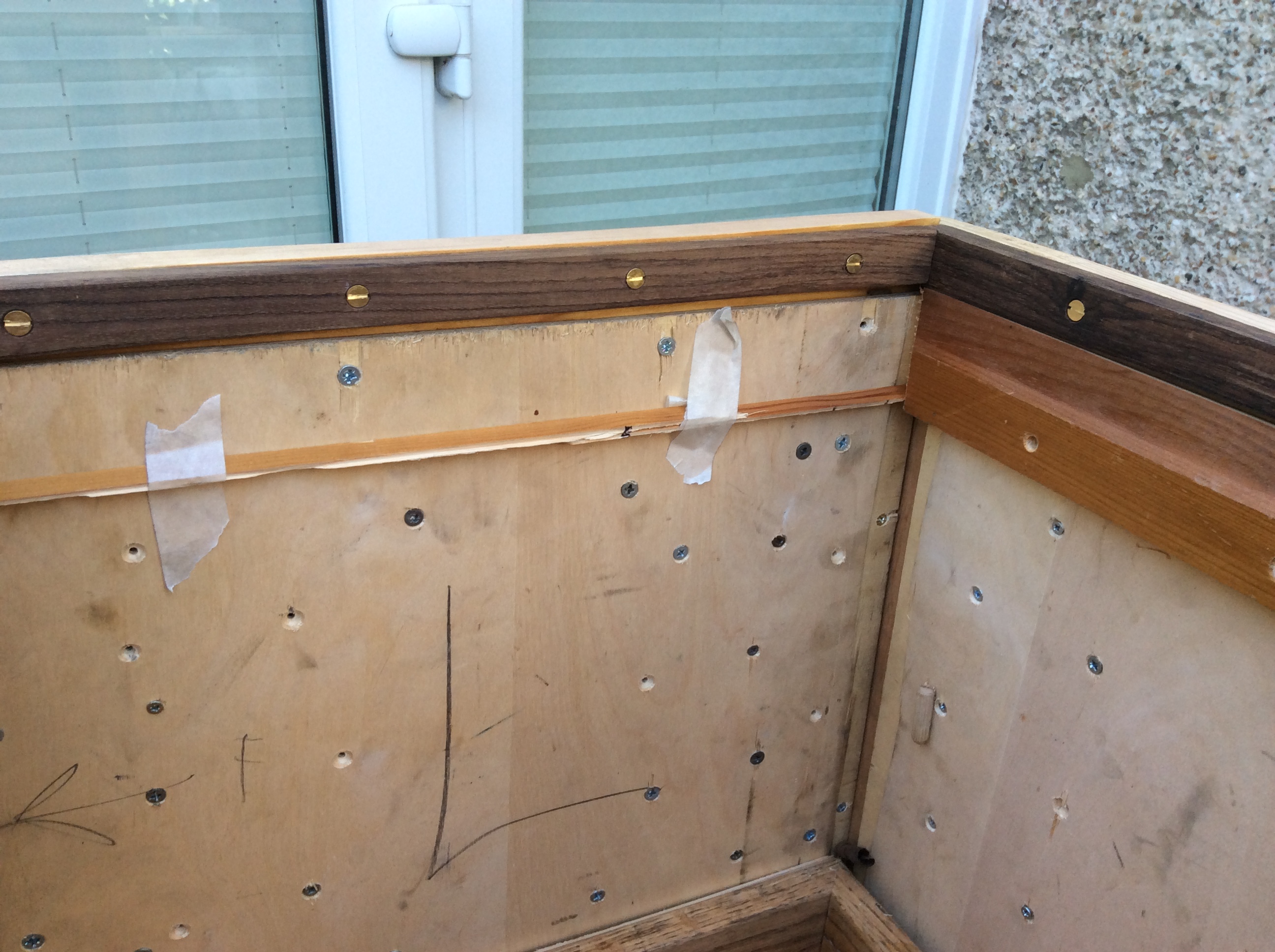

I am lining the inside of a hope chest. The external panels are screwed from ply on the inside and the unsightly mess will be covered with tongue and groove boards. I have taped the rods to the ply to take a picture. Can you see the mark across the two rods?
I do not know how to measure the internal dimensions accurately except by using pinch rods. These are just thin laths ( from the T & G) pointed to get inside the corners.

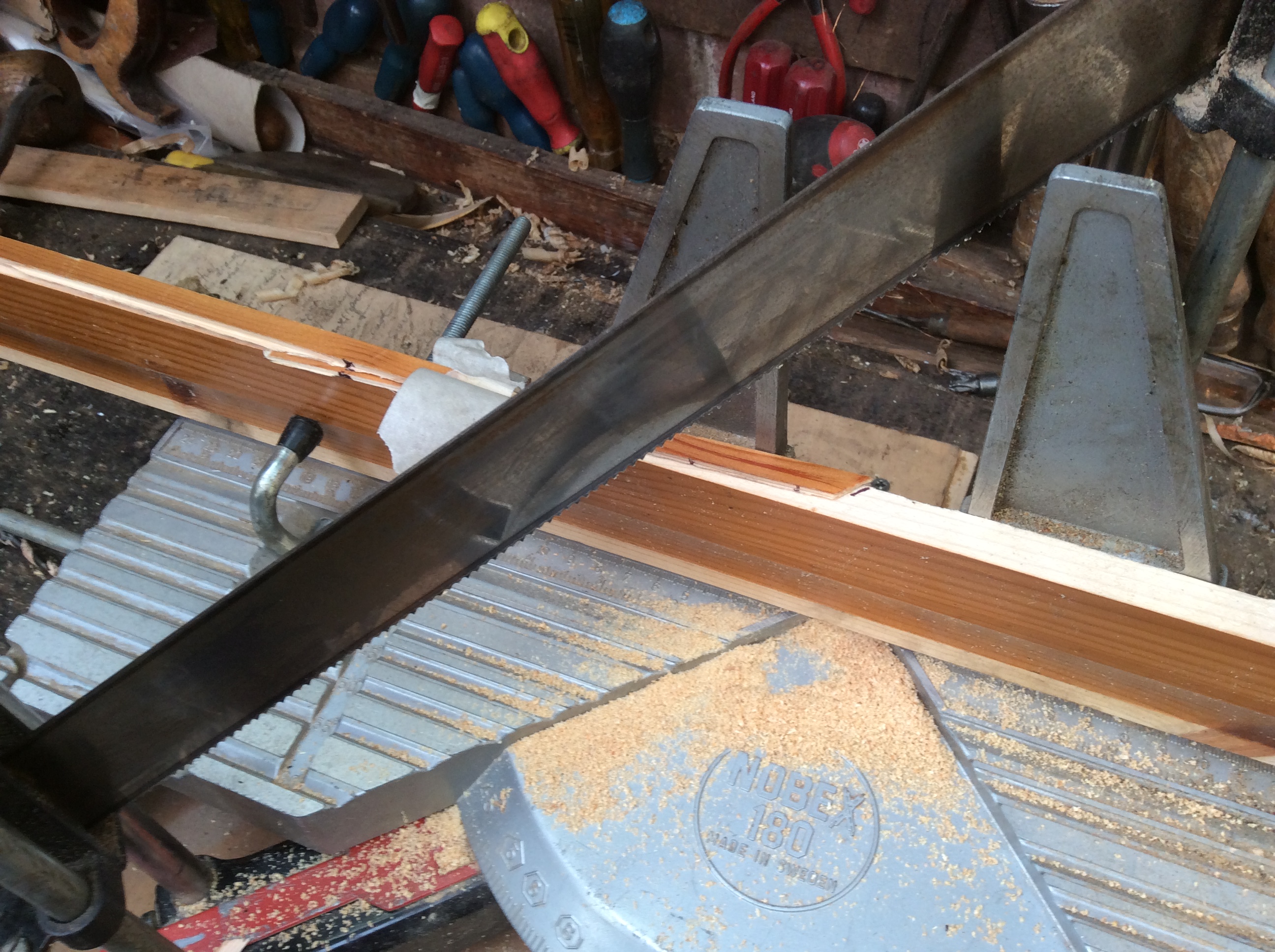

Then the rods are transferred to the mitre saw.
Attachment 40374

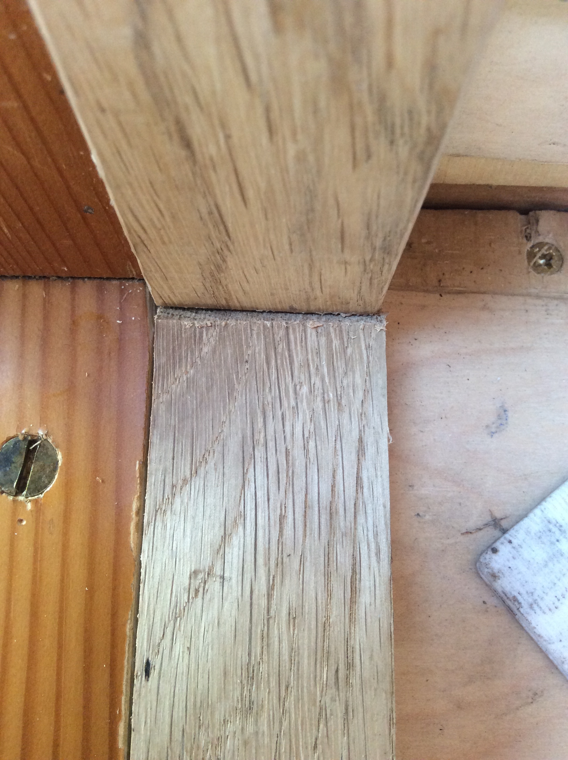

Internal mitres are usually scribed which is more difficult and this will be quite satisfactory.
