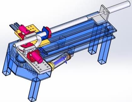

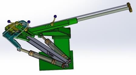

Here are a couple of my bender designs in progress
one is to be capable of 4" OD tubing or pipe the other to be 1 1/2 " OD tubing
Attachment 8512
Attachment 8513
