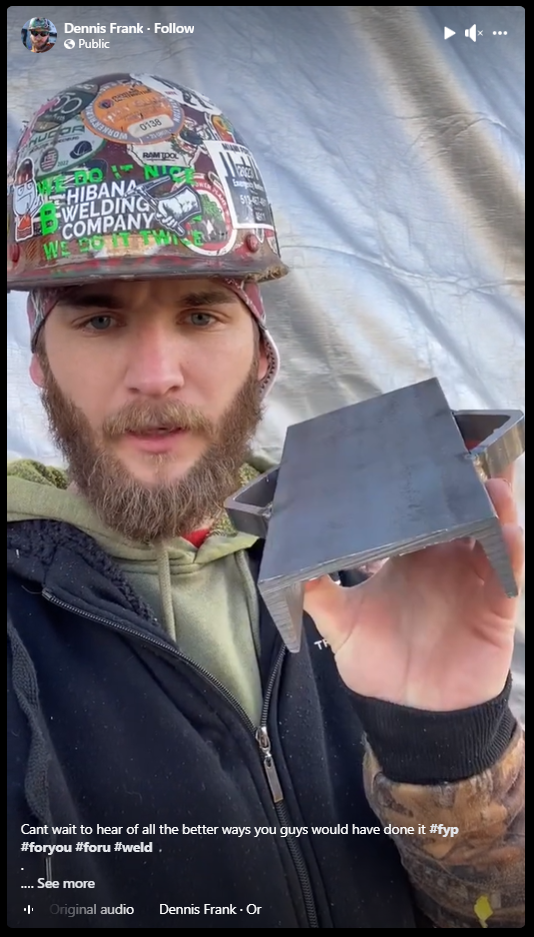

Over on facebook I saw this and thought y'all might like it. Original source: https://www.facebook.com/reel/439310185569386
It's a base welded up from U channel and a couple of pieces of angle iron. You can ratchet strap it onto pipe to give your mag drill a solid base where it won't rock.
Attachment 47628
