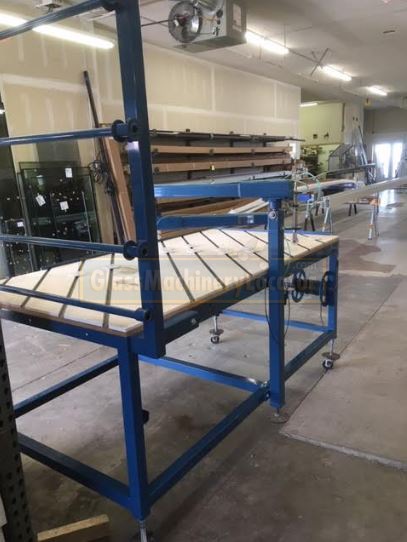

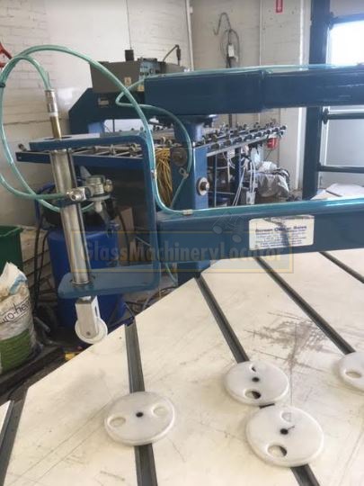

Pivot hinge with fine adjustment for vertical on the pin.
I am building a fly screen spline inserting machine.
Its consists of a bench with an articulated 2 piece arm that pivots around a vertical column [ 100 x 100mm] at the back of the bench.
The pivots at the column top and between the arms consist of flat plummer blocks through which a 30mm shaft passes through and pokes into the RHS column. [ in the case of the first joint]
That pivot point has two bolts at right angles that penetrate the rhs on two axis and allows to shaft to be adjusted so it is vertical and the arm does not swing to a 'low point'
How would it be done?
I have seen an image where two bolts with lock nuts on both X /Y axis penetrate the column about 125mm apart vertically and seem to be used for adjustment, but how?
