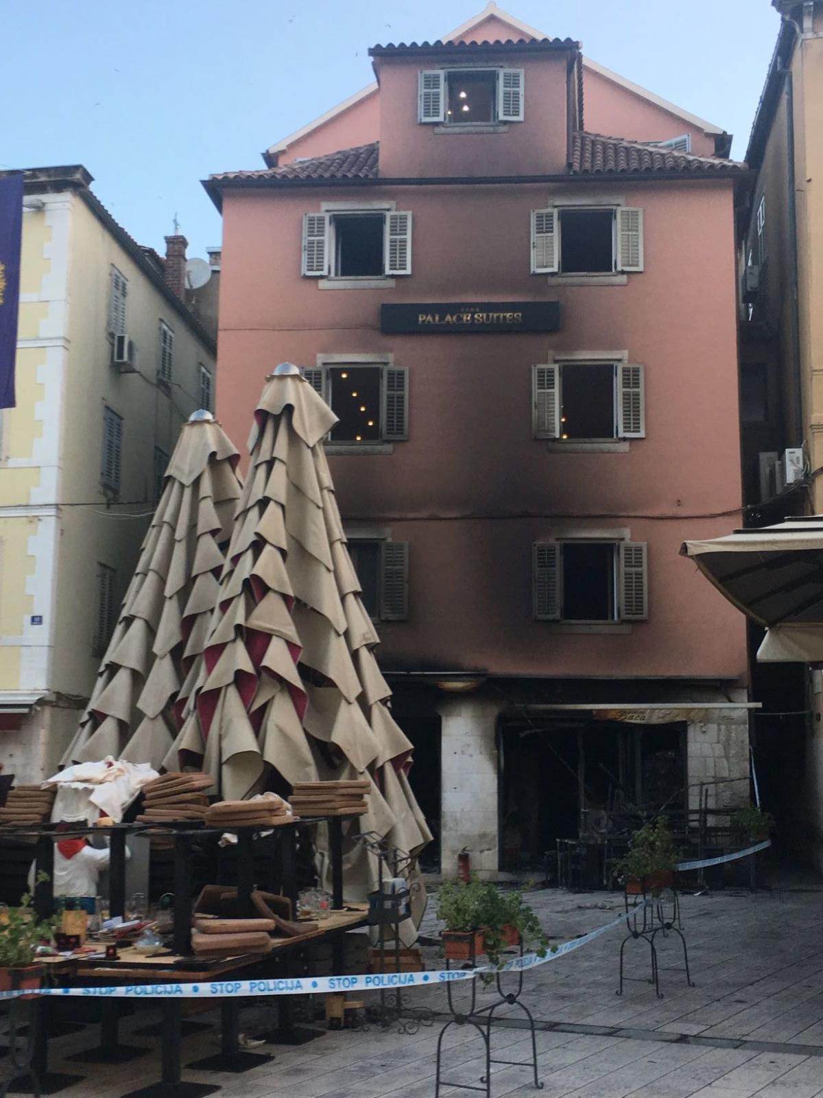

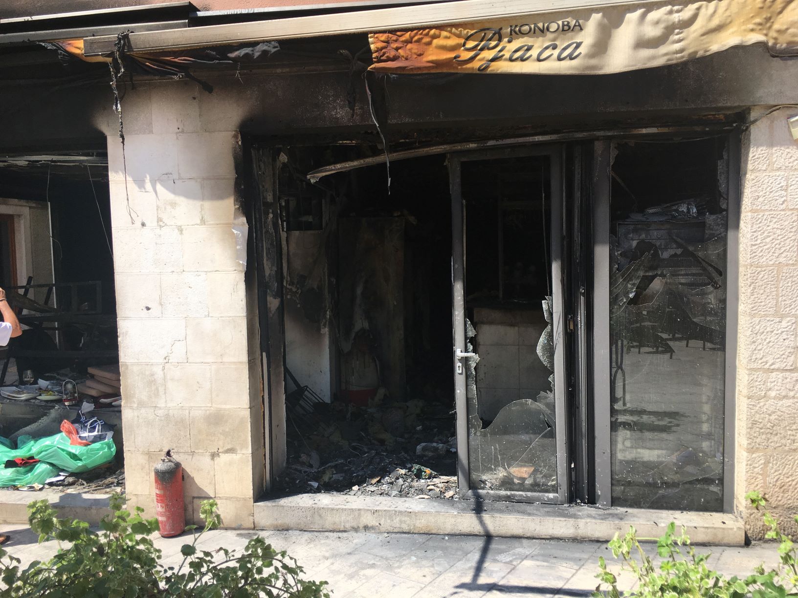

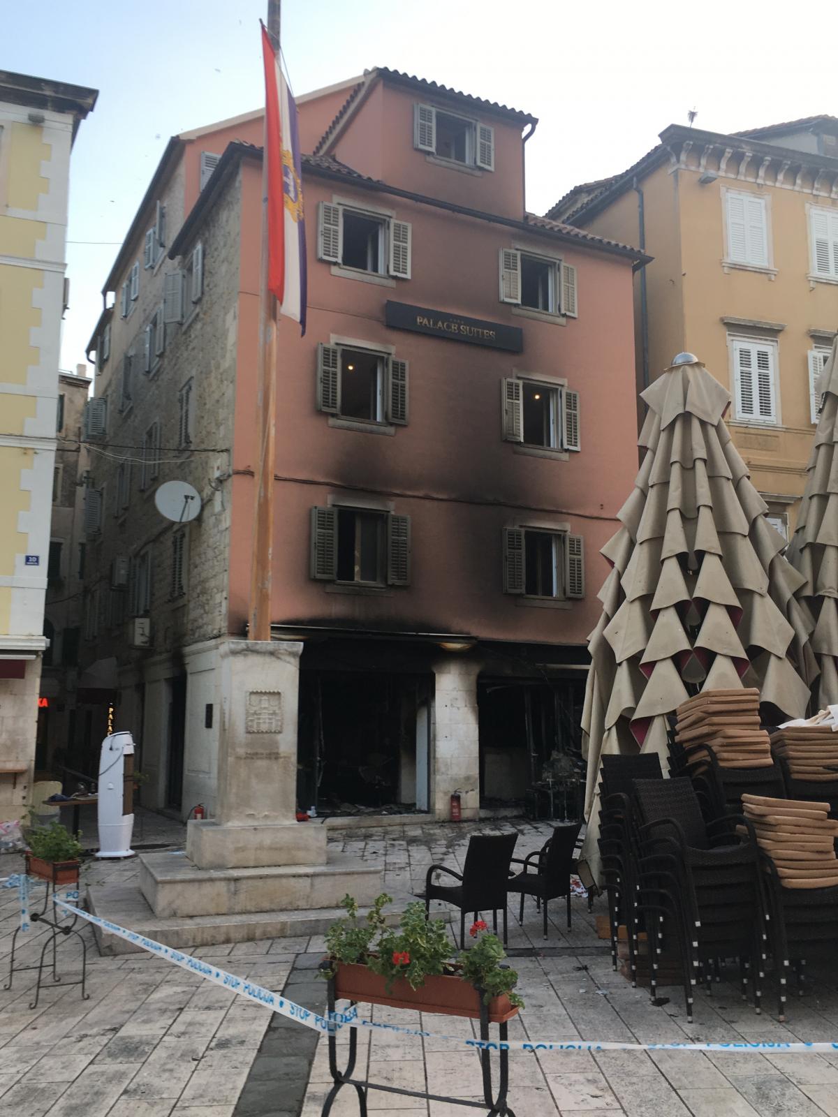

At approximately 9 p m friday night, sirens all over town, Fire within the Old Town:
(pics by yours truly from the morning after, at 5 to 6)
Attachment 30529 Attachment 30531
Word on the street says nobody was hurt, though the resturant and the hotel above will be outta business for this season.

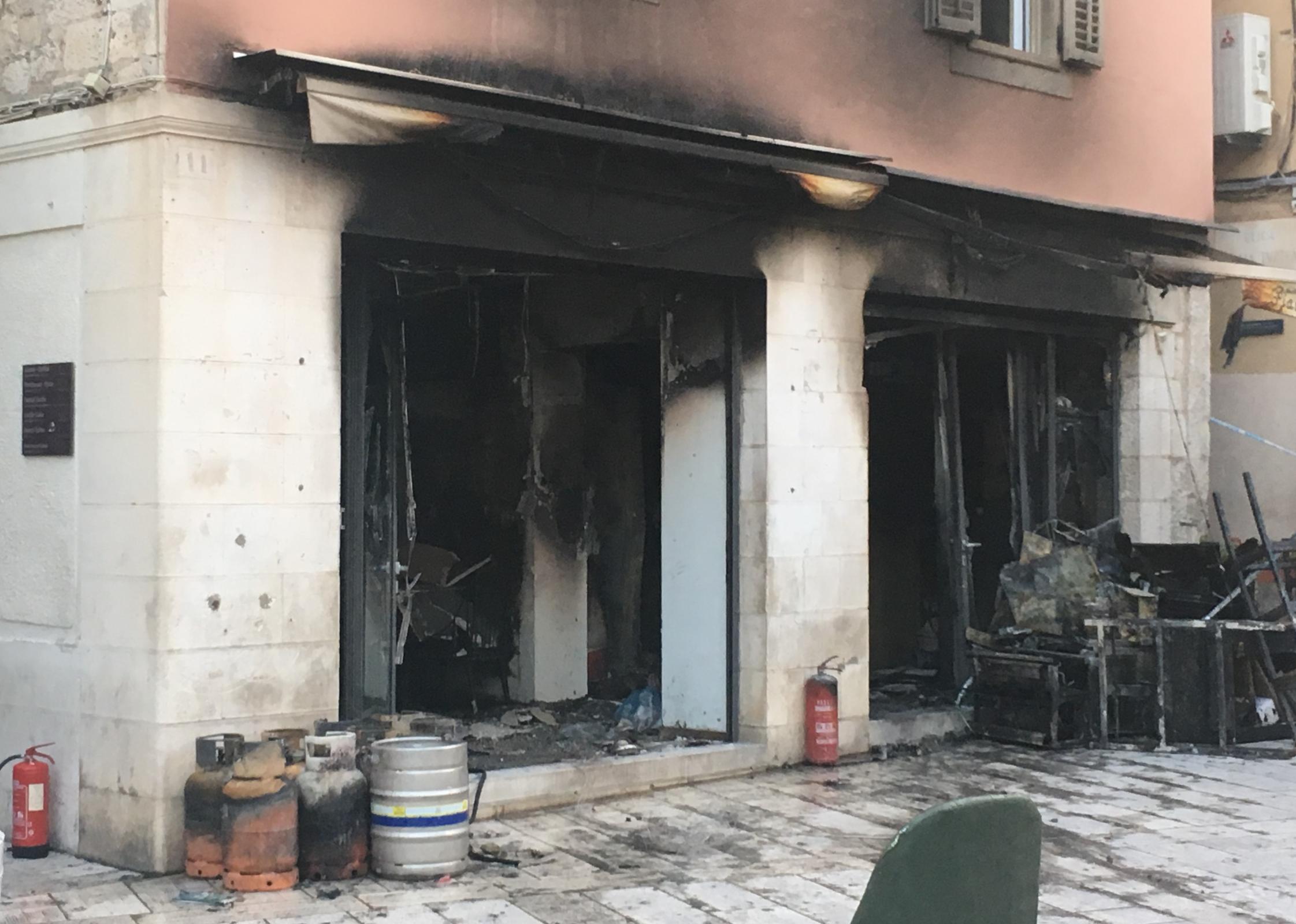

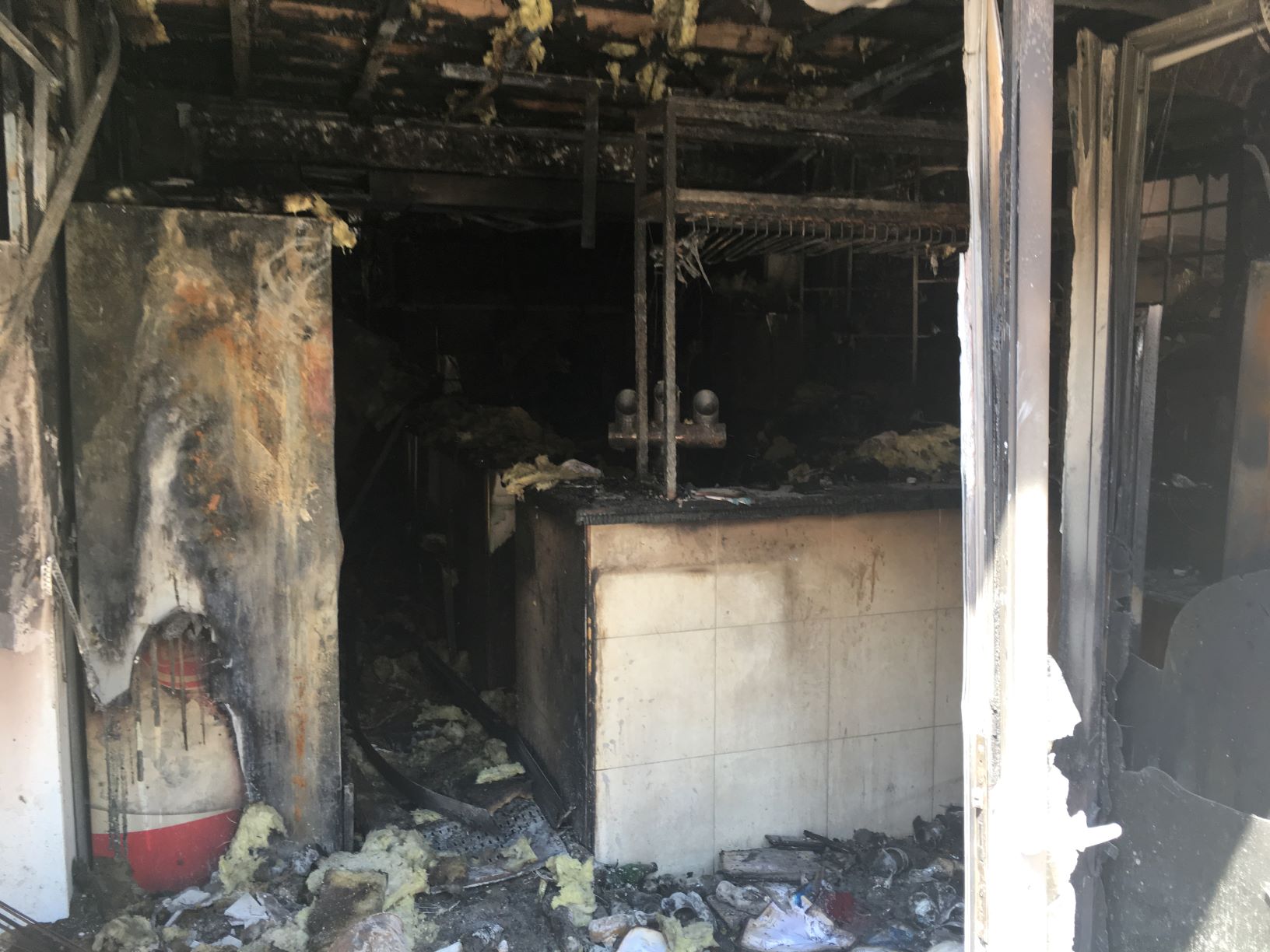

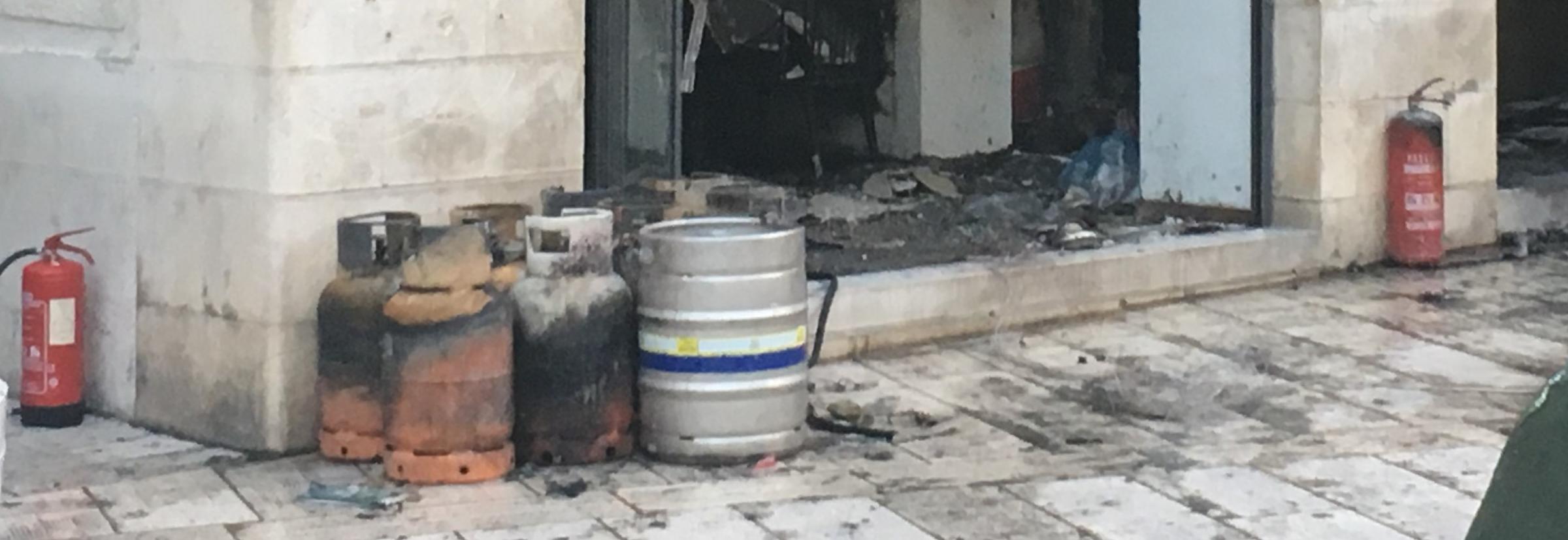

Attachment 30530
Attachment 30535
Note that the left extinguisher is used and empty, but the right one is burned and probably full.
Sadly, unused and full extinguishers are fairly common finds still hanging on the walls after a fire.

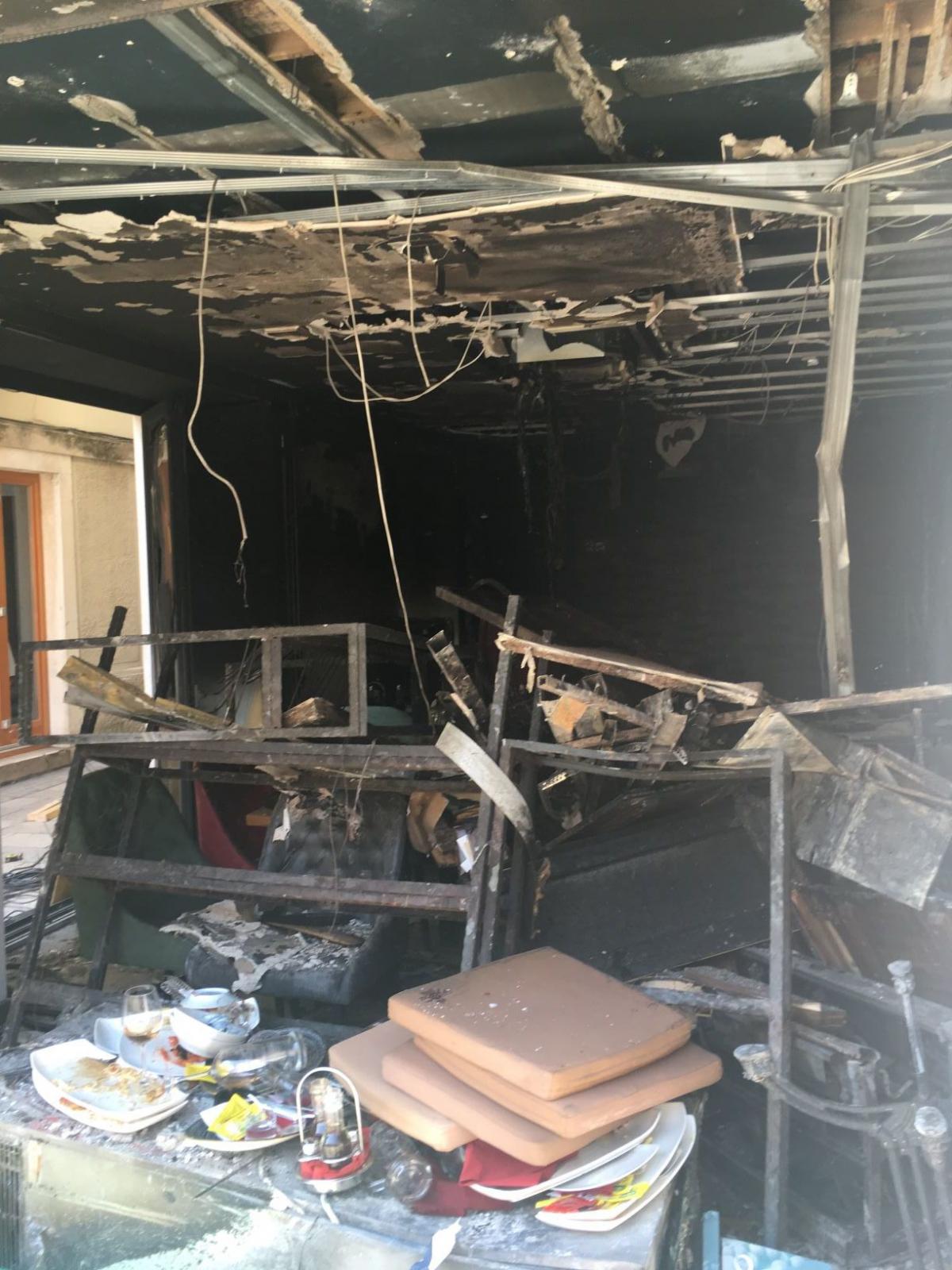

4 LPG bottles at max 16 kg looking pretty sorrow after their safety valves blew,
and their contents pitching in making the place a total write-off:
(Revisit in the afternoon)
Attachment 30532 Attachment 30533 Attachment 30534
Cause for the fire hasn't been established yet - but my (semi-informed) guess is gas tube leak,
no fire resistant glove around (for turning the bottle valve off), and inadequate fire emergency routines.
