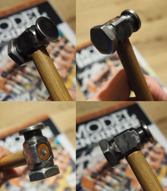

Had a search and could not find a thread on planishing hammers and so thought I would start one and add an image of a hammer I've just made.
Attachment 25892
4oz head - ok, not forged, but machined from mild steel with case hardened faces.

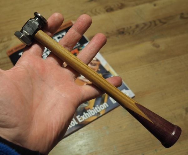

4 oz is a good weight I like the shape and length of the handle. Seems to be about right for resting the end of the handle in the palm while gripping the handle with thumb and forefinger so you can simply rotate your wrist allowing the bounce of the hammer do most of the work
Beautiful handle work Nigel and like the shape! Seems a good weight and head shapes for most small work. Nice Job!
