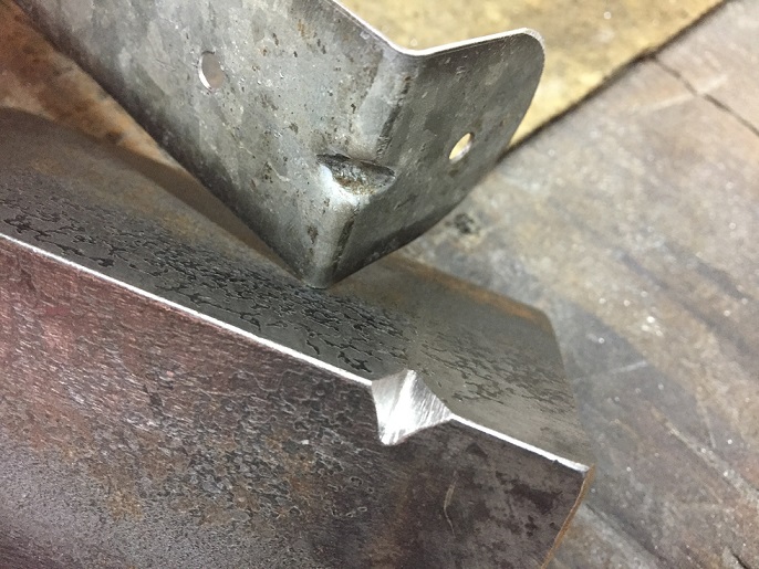

I have seen these little simple tools, just a nice big "V" in a solid block of steel. Once the plate brkt about 1 to 1.2mm sheet steel is bent, you simply take a chisel and create a dent into the "V" right on the corner of the bracket. It gives it a lot of stiffens.
Attachment 21309
