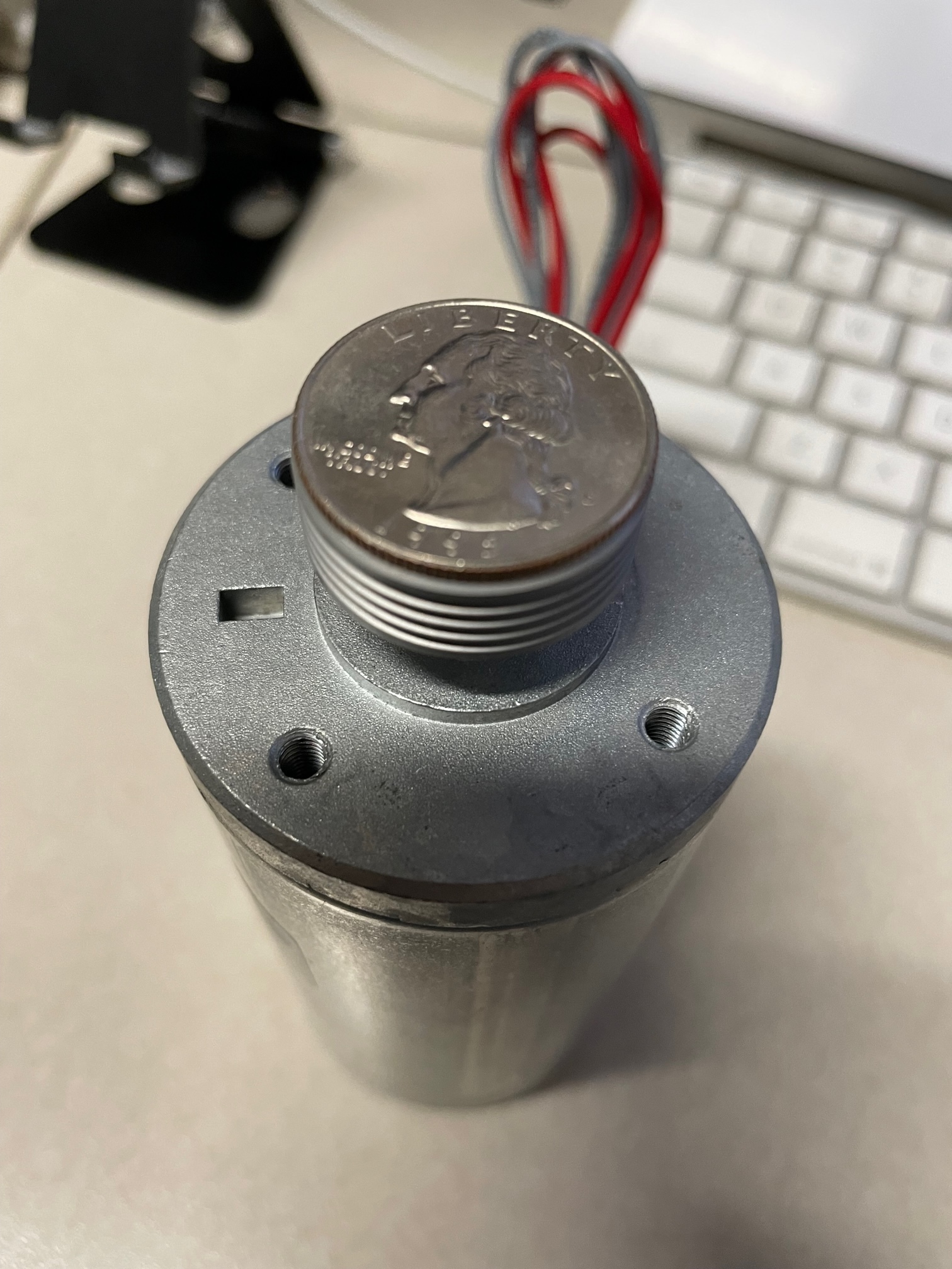

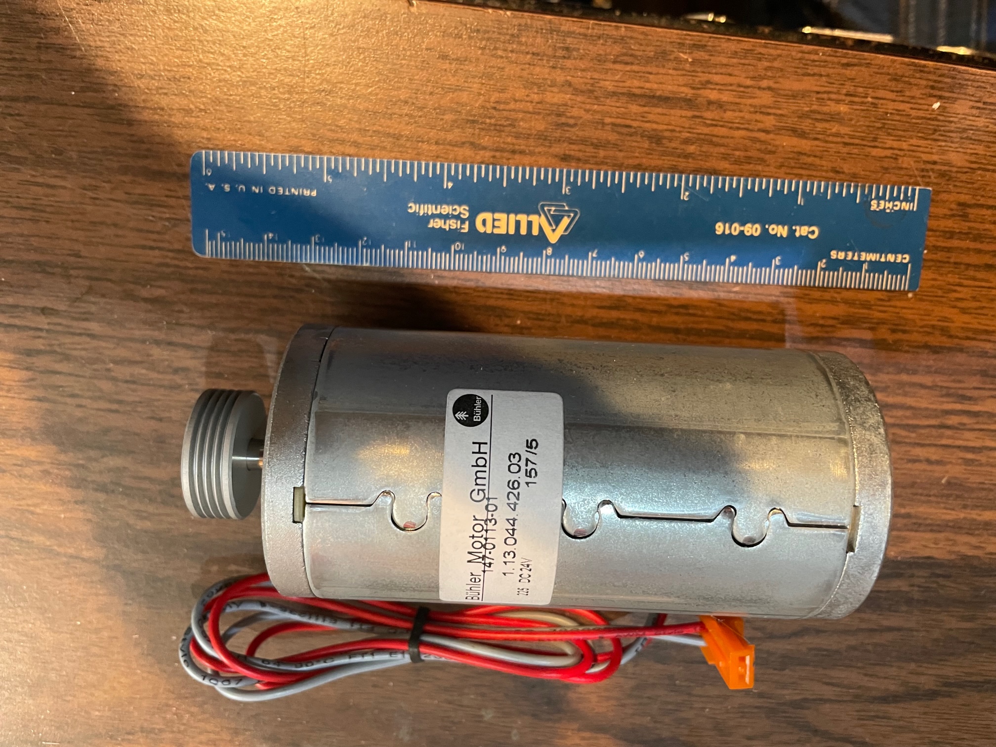

Does anyone know how these v-belts are specified? I have a small DC motor with a pulley like one of these that I would like to use for a projects; but have been unable to find how these belts are specified...when I went searching for poly-v belts all I found were things like belts for automotive engines and such. Basically I need to reverse-engineer the belt specification from the pulley.
Attachment 43185 Attachment 43186
Okay, I've been here myself. After close to a year, I could not find any data on the subject. But due to lack of information, I don't know what you think you are asking. Percentage of power transmission will be modified by the tension in the pulleys. The belt needs to fit the pulleys. The pulley sizes determine what is effectively the gear ratio, which determines your RPMs. So your torque could be quite a few values.
However, if you are trying to reverse-engineer the belts and just want data, I recommend checking out McMaster-Carr's website or app. You will find some good data there that may apply.
Look up Optibelt flat ribbed belt. Gates also have info. I’ve converted my band saw, 2x72 belt grinder, and in the process of converting my 1236 lathe to a 10 rib flat belt. I’m using the “K” series belts.
I’ve made most of the pullies to fit my application.
Thanks! Optibelt's tech manual got me started on figuring it out.
