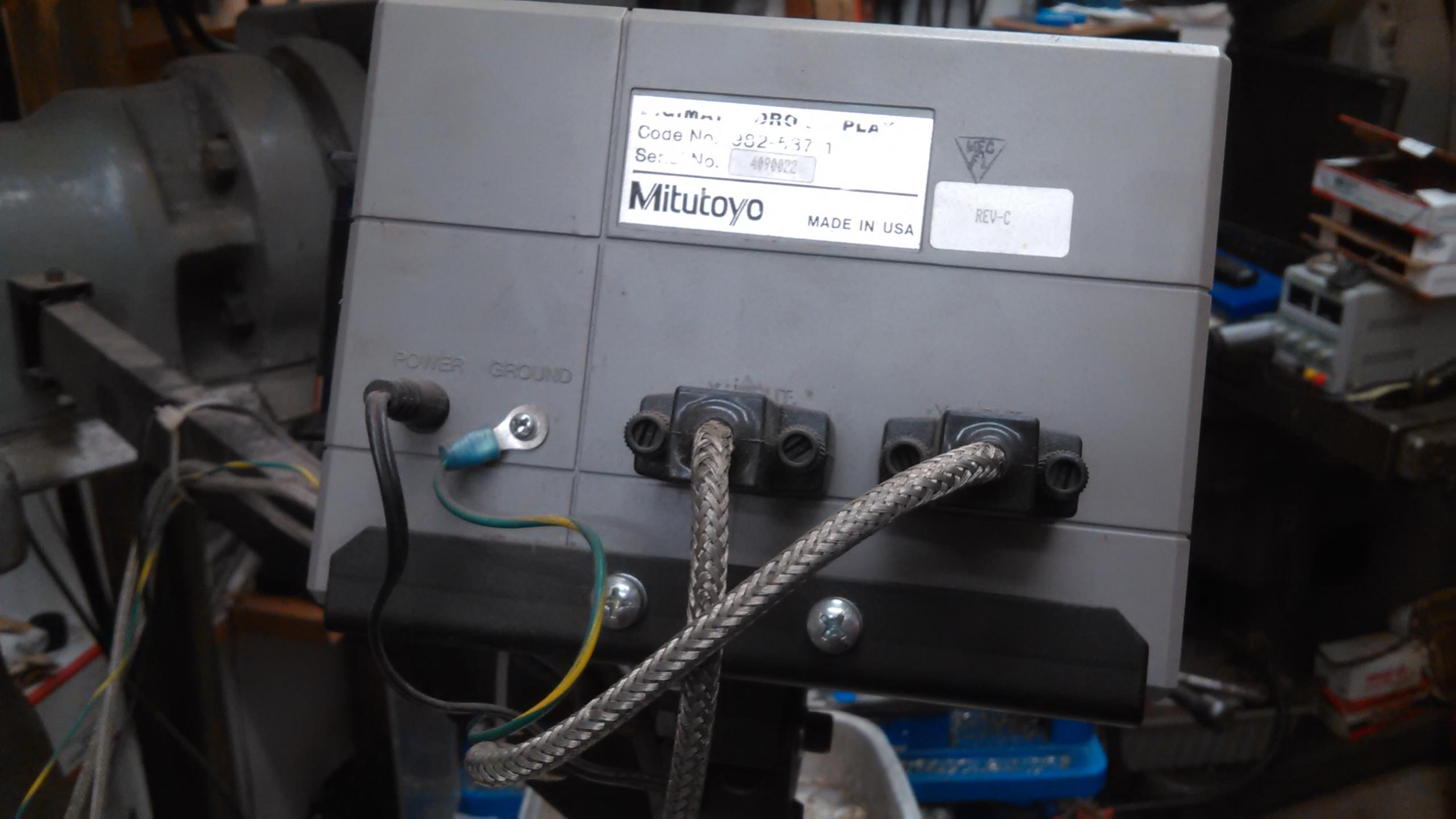

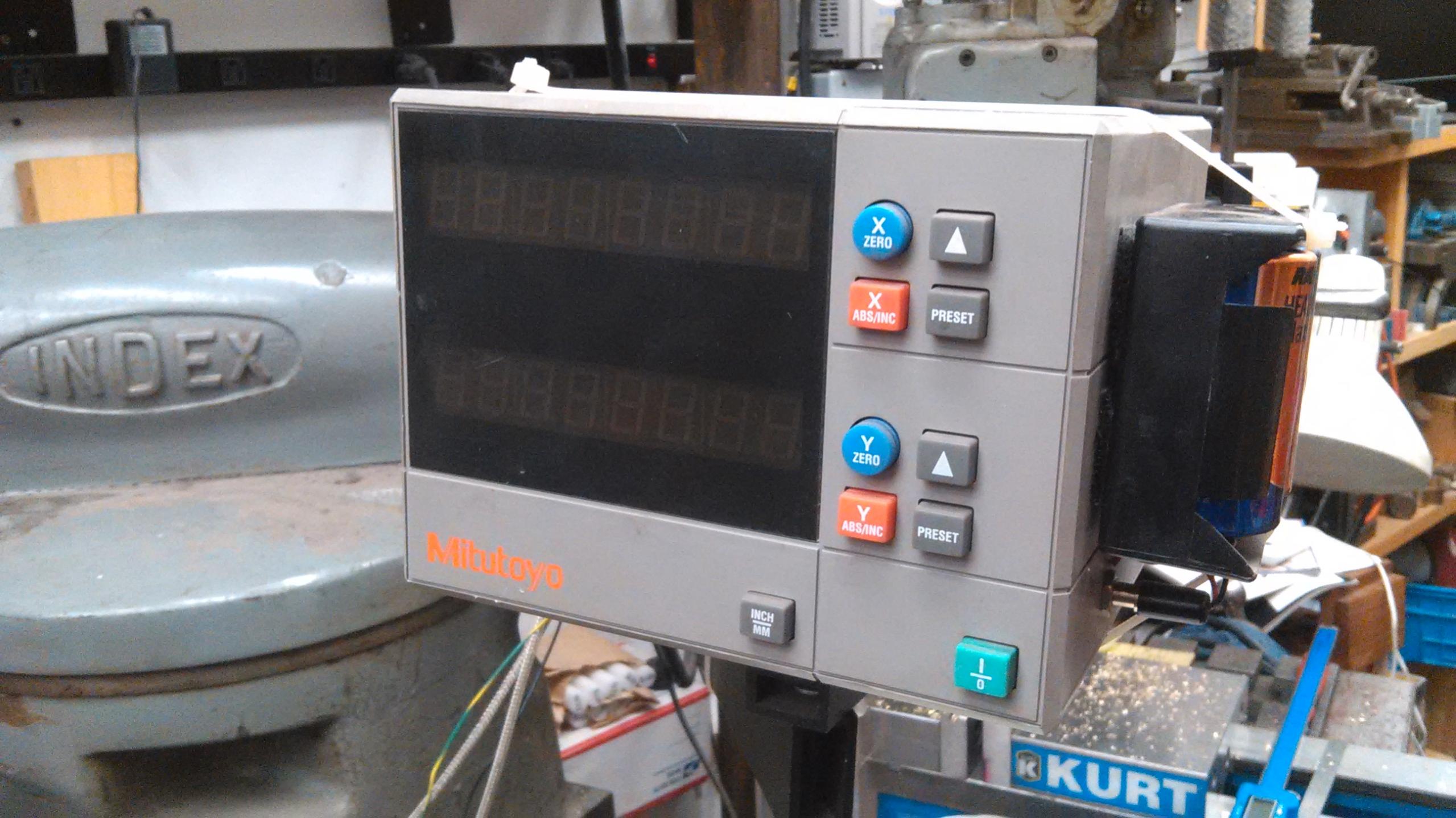

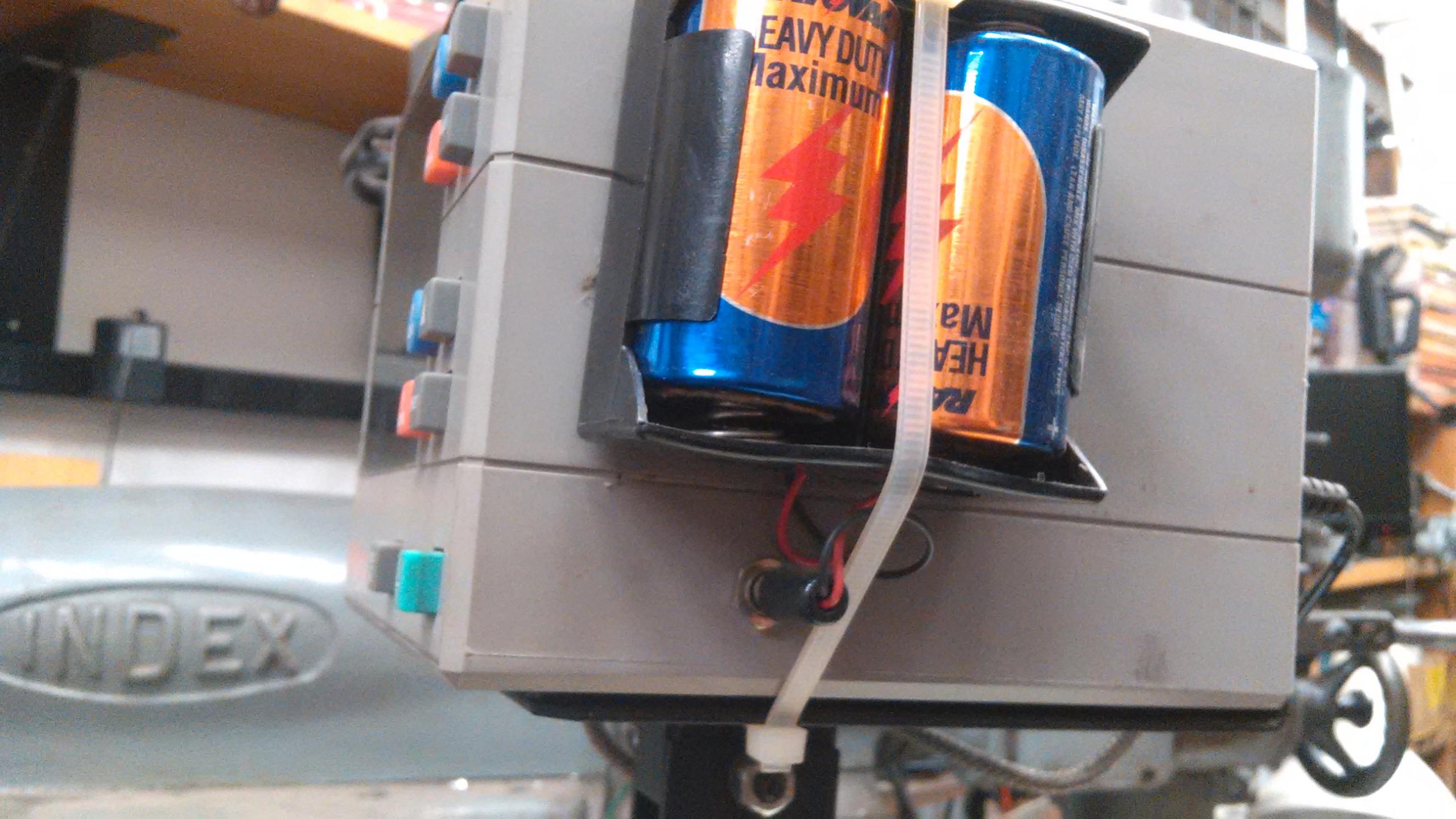

I found a similar problem with a DRO, but compounded was the Mitutoyo was darn hard to change the batteries in, as considerable disassembly was required to access them. So my fix was to install and external battery pack. I just happened to find D size battery holder at a Radio Shack (when they still had electronic components). I installed a power connector on the case of the DRO display and then used a mating connector to inject the external battery power.
Attachment 17309Attachment 17310Attachment 17311
I used double sticky foam tape, but the weight of the batteries resulted in the zip tie fix. The rear view shows 2 screws that have to be removed to take the display head off the mount tray, then I believe the bottom is removed to access the internal batteries. I also found the life of the AA to be short in this unit.
