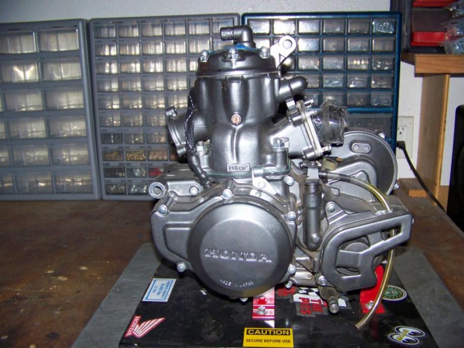

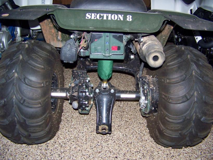

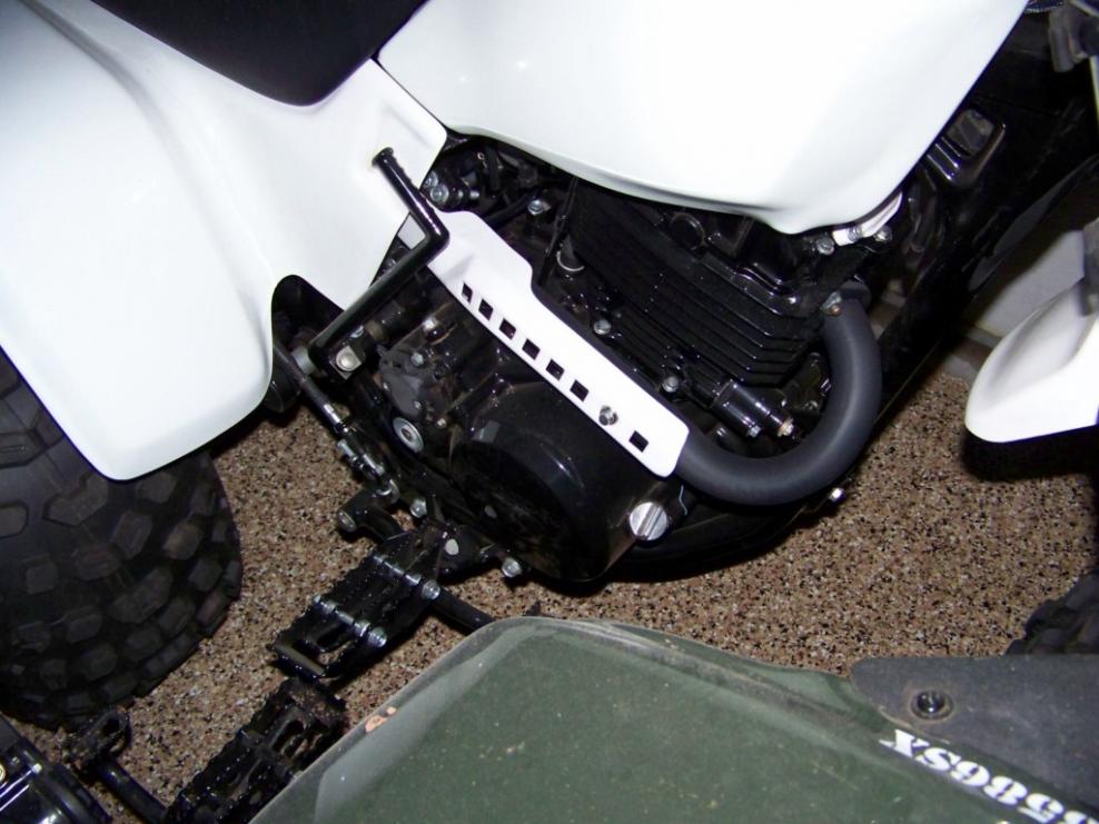

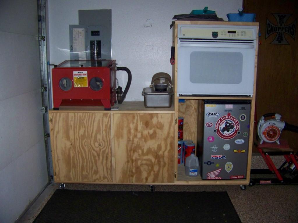

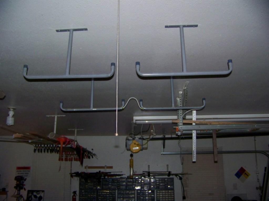

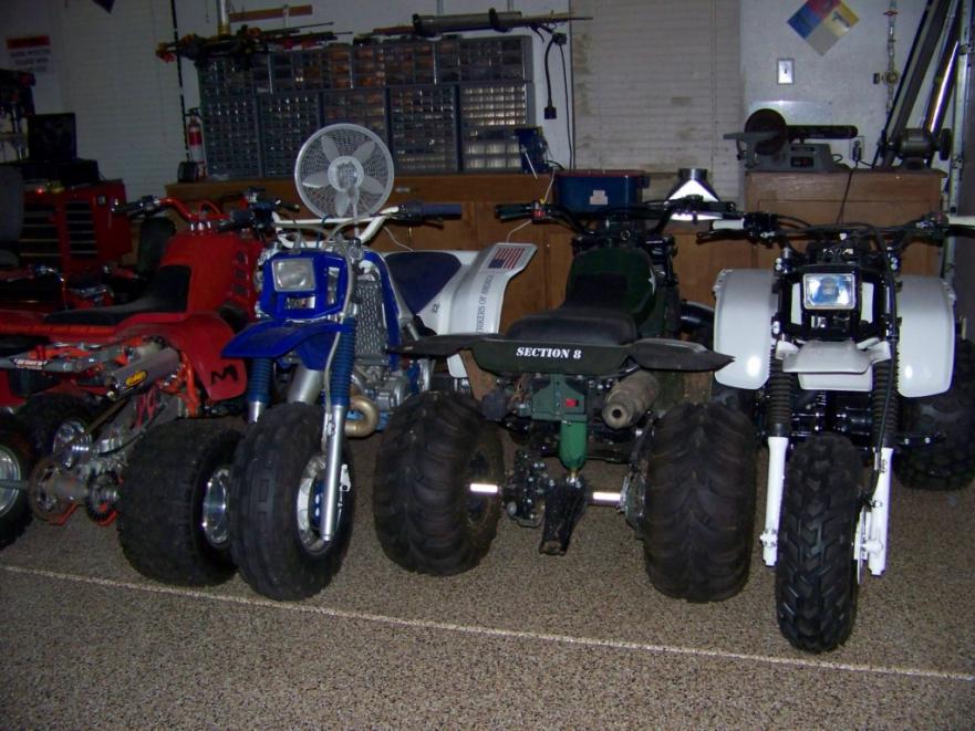

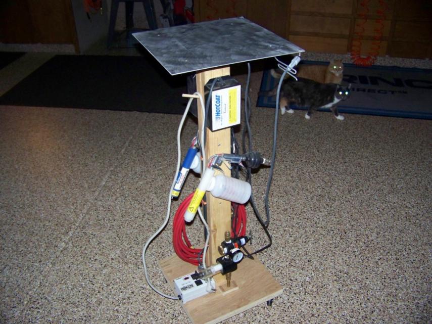

    Here's my contribution to the PC thread. This is my portable PC station. My wife insists on parking in the garage so everything needs to be mobile. I have ceiling mounted racks grounded to earth ground. I connect the ground wire to either the portable PC station or the ceiling racks depending on what I'm doing I have a small tabletop oven for small stuff and a re-purposed wall oven for baking. My main PC staple is old Honda 3wheelers. I completely teardown the trikes and every last nut and bolt is removed, every assembly is torn down and refurbished or replaced. The hardware gets sent to the plater for white Zinc plating. The frames are too big for me to handle so those are sent out but everything else is done my me. The rest of the pics is a few of the things I've PCd.
    Attached Thumbnails Attached Thumbnails Powder Coating-100_0307-%5B1024x768%5D.jpg   Powder Coating-100_0308-%5B1024x768%5D.jpg   Powder Coating-100_0309-%5B1024x768%5D.jpg   Powder Coating-100_0312-%5B1024x768%5D.jpg   Powder Coating-100_0311-%5B1024x768%5D.jpg
    Powder Coating-100_0315-%5B1024x768%5D.jpg   Powder Coating-100_0316-%5B1024x768%5D.jpg

    Fantastic finish from that homebrew setup, Ogre. Thank you for sharing.
    That portable setup gives me a few ideas too, FlyingW.
