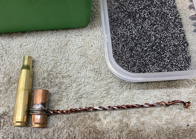

With the LockDown, I am also stocking up on ammo for the hunting season.
This time I managed to break the little plastic measuring spoon one get when you buy the scale.
Solution, Cut down a cracked brass case, and then keep trimming it down till 2 measures is just about 100% the correct load.
I weigh every load so final adjustment is made with a tweezers.
Attachment 34708
Once it is the correct length, solder some copper wire to it to create a handle. The nice thing is you can optimize the angle as the powder in the tin goes down.
The plastic measure was always 2 and a bit scoops and too short a handle when the tin was just about empty. :rocker:
