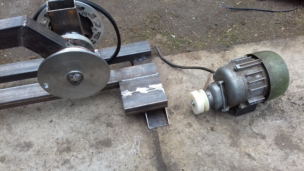

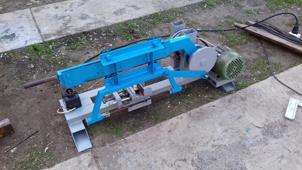

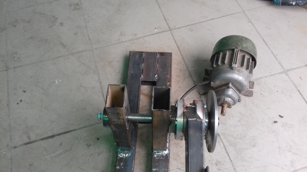

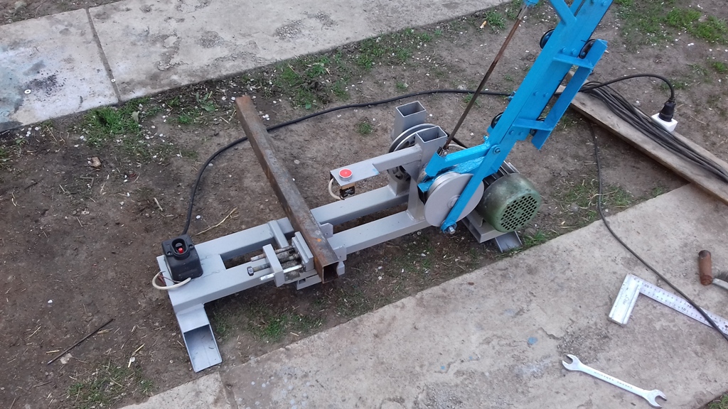

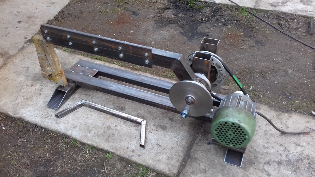

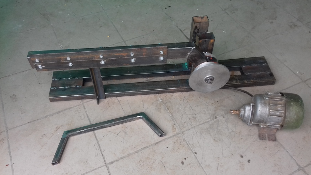

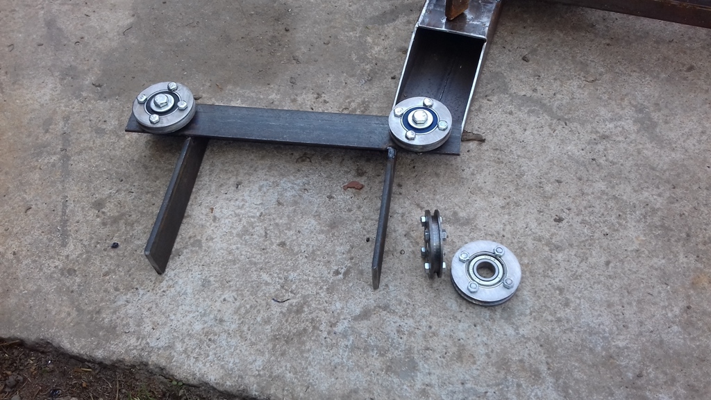

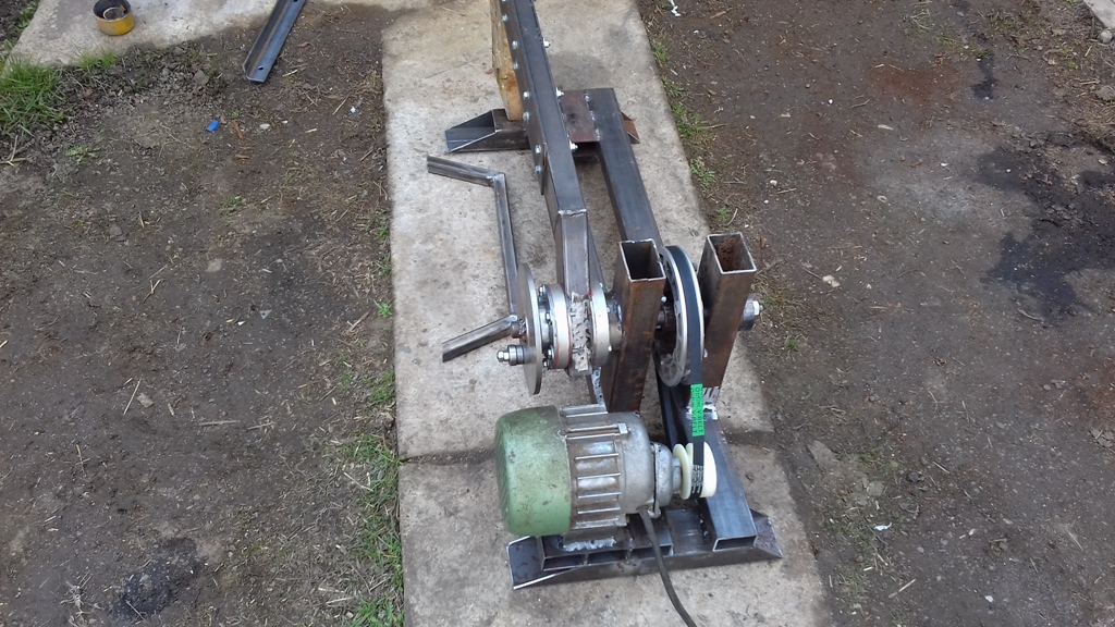

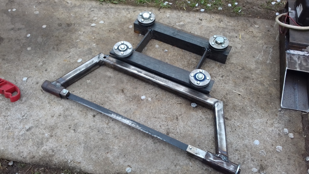

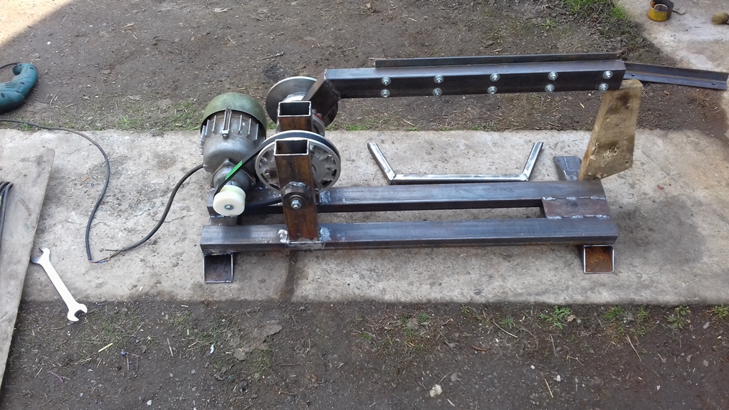

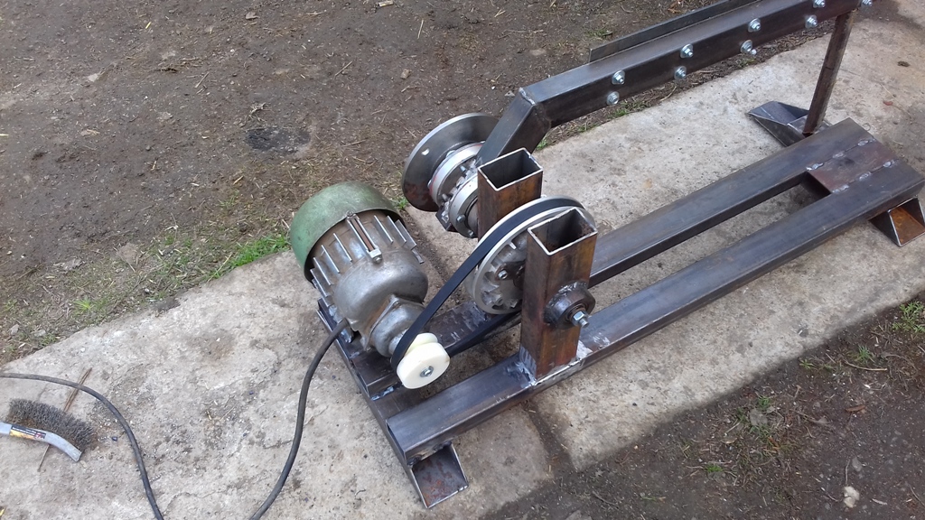

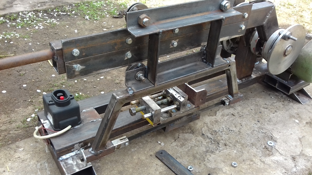

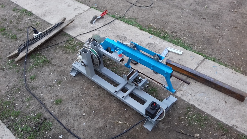

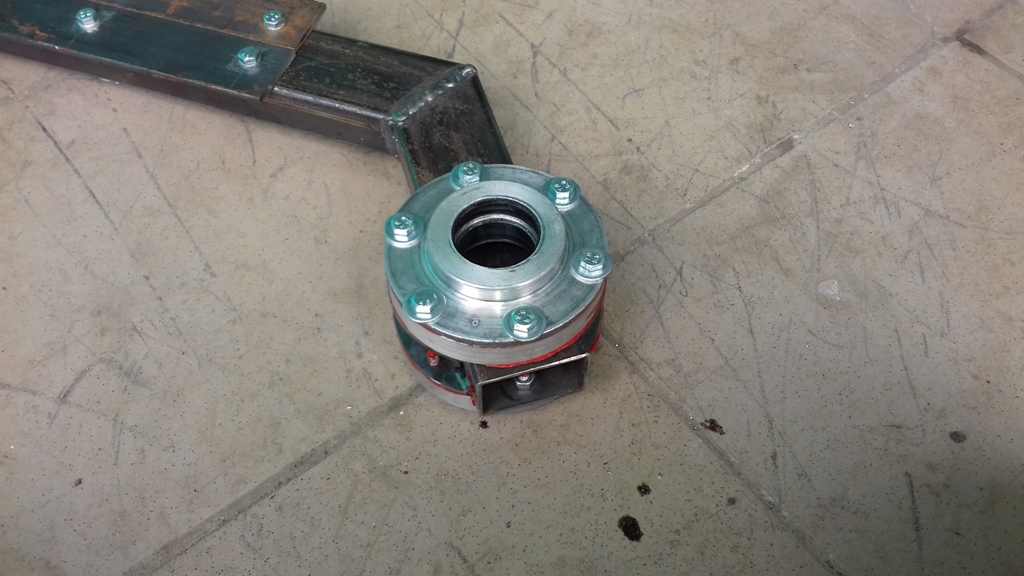

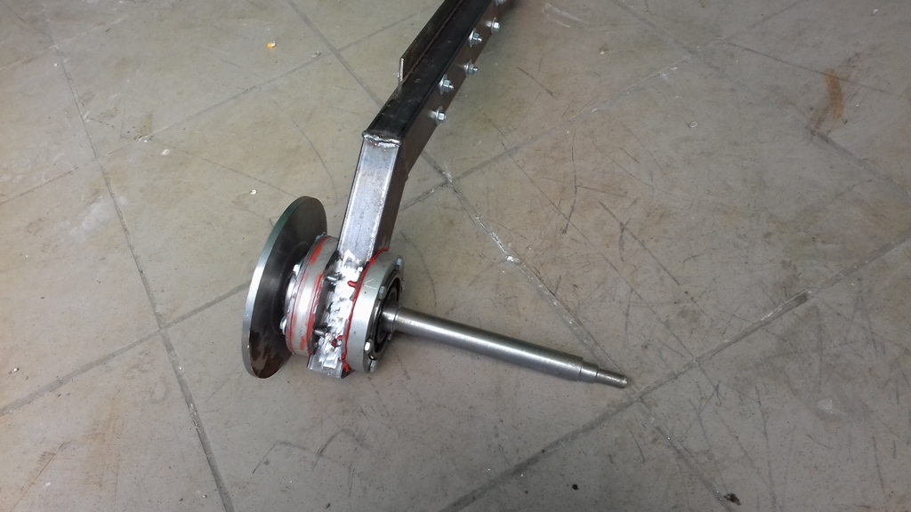

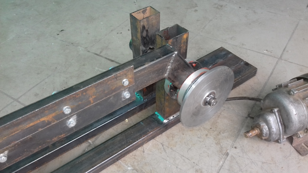

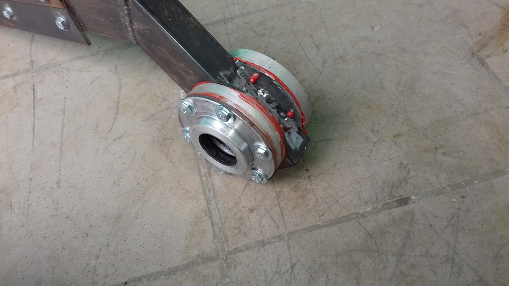

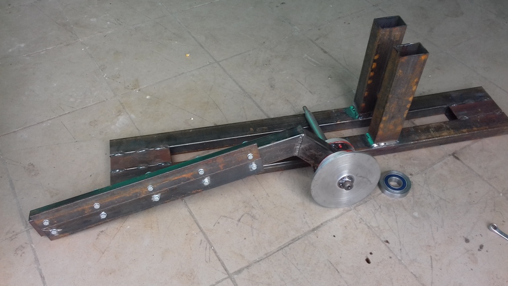

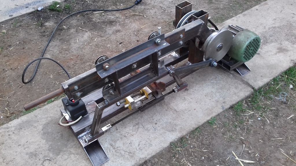

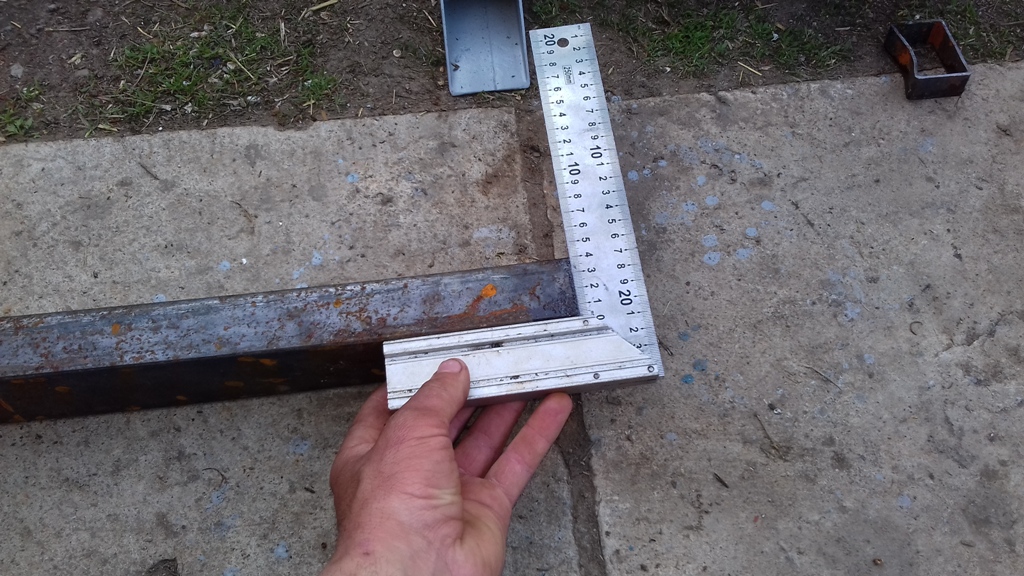

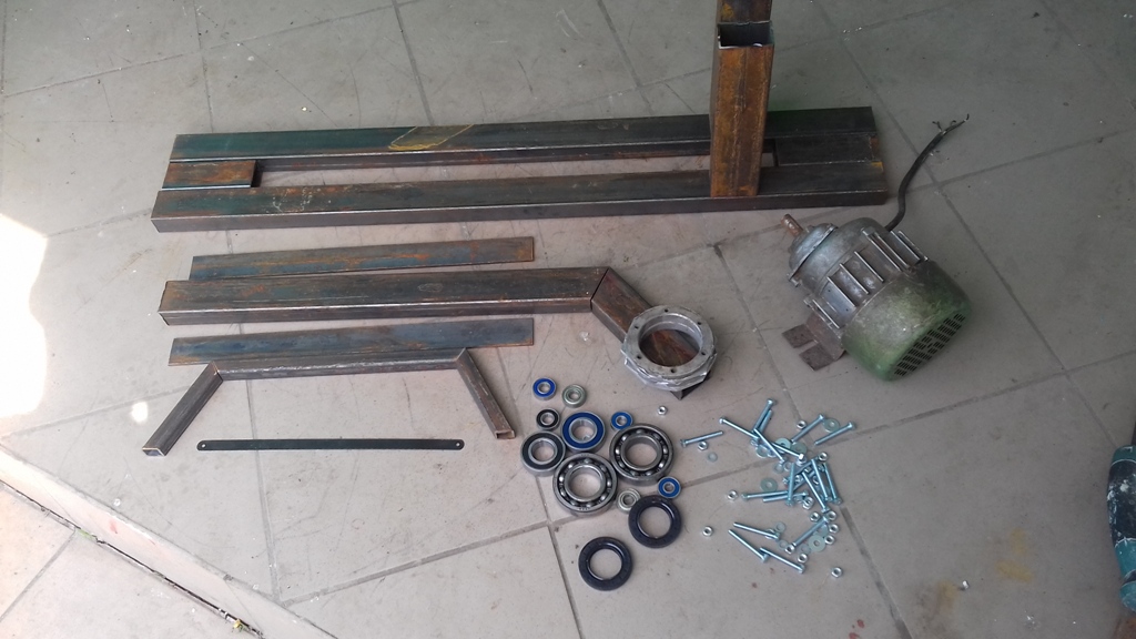

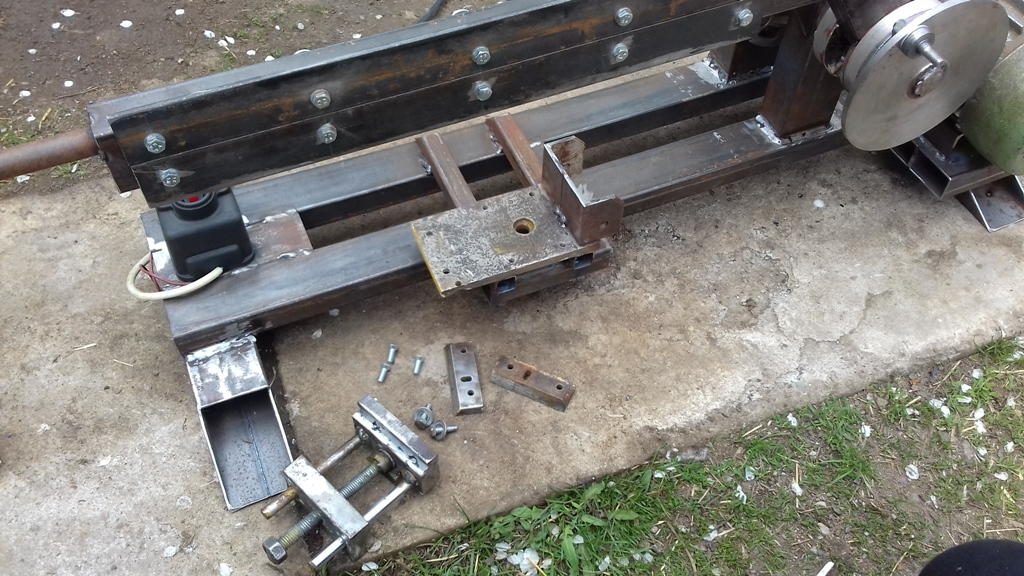

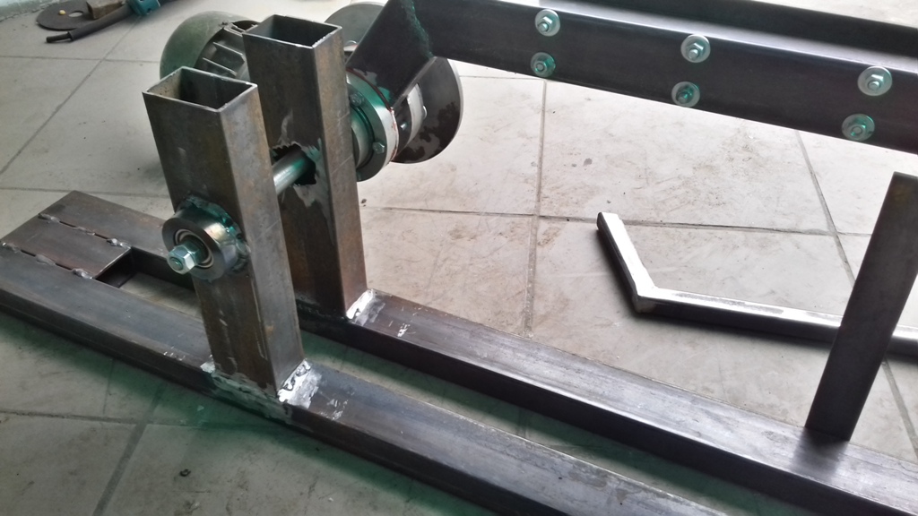

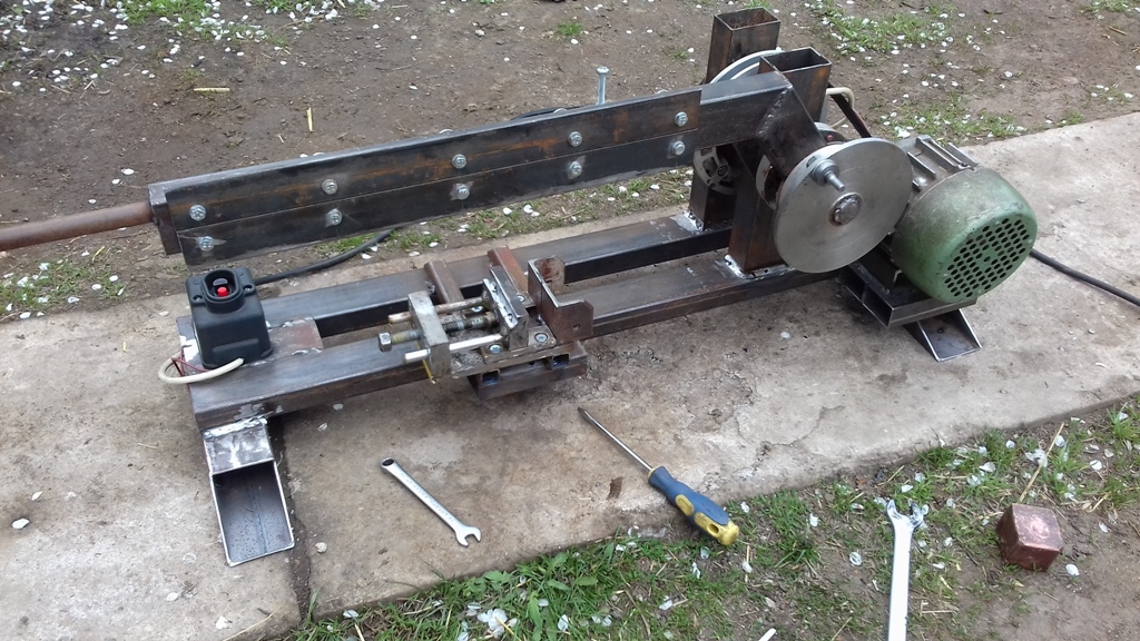

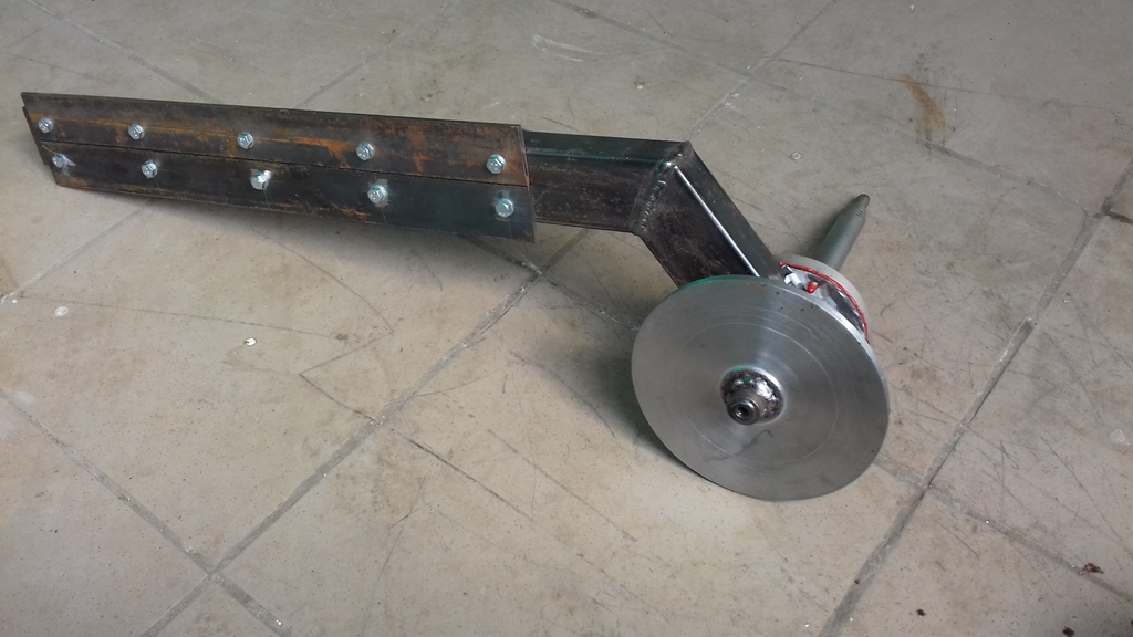

    Hello. Sometimes I'm angry with the angle grinder, a lot of noise of dust and sparks. So I decided to build a Power Hacksaw. It works very quietly, and while it cutting you can do other things, hacksaw is automatically shut off.
    Power Hacksaw-20190410_132857.jpg Power Hacksaw-20190415_123915.jpg Power Hacksaw-20190415_140958.jpg Power Hacksaw-20190415_141005.jpg Power Hacksaw-20190415_141019.jpg Power Hacksaw-20190415_141119.jpg Power Hacksaw-20190415_141152.jpg Power Hacksaw-20190415_141159.jpg

    Nice build Vyacheslav,
    I made one some years ago and have used it a lot its on my builders page.
    A suggestion if you dont mind is you could fit a No Volt Release switch, it is easy to forget that the machine is still live if you have if you have been doing something else while it is cutting. I retro fitted one to mine for that reason.
    Regards
    Olderdan
