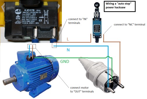

To do: Metal base, mount swivel vice, and wire the machine properly with NVR and auto shutoff switches.

1 Attachment(s)
This is how I wired it
Attachment 326
