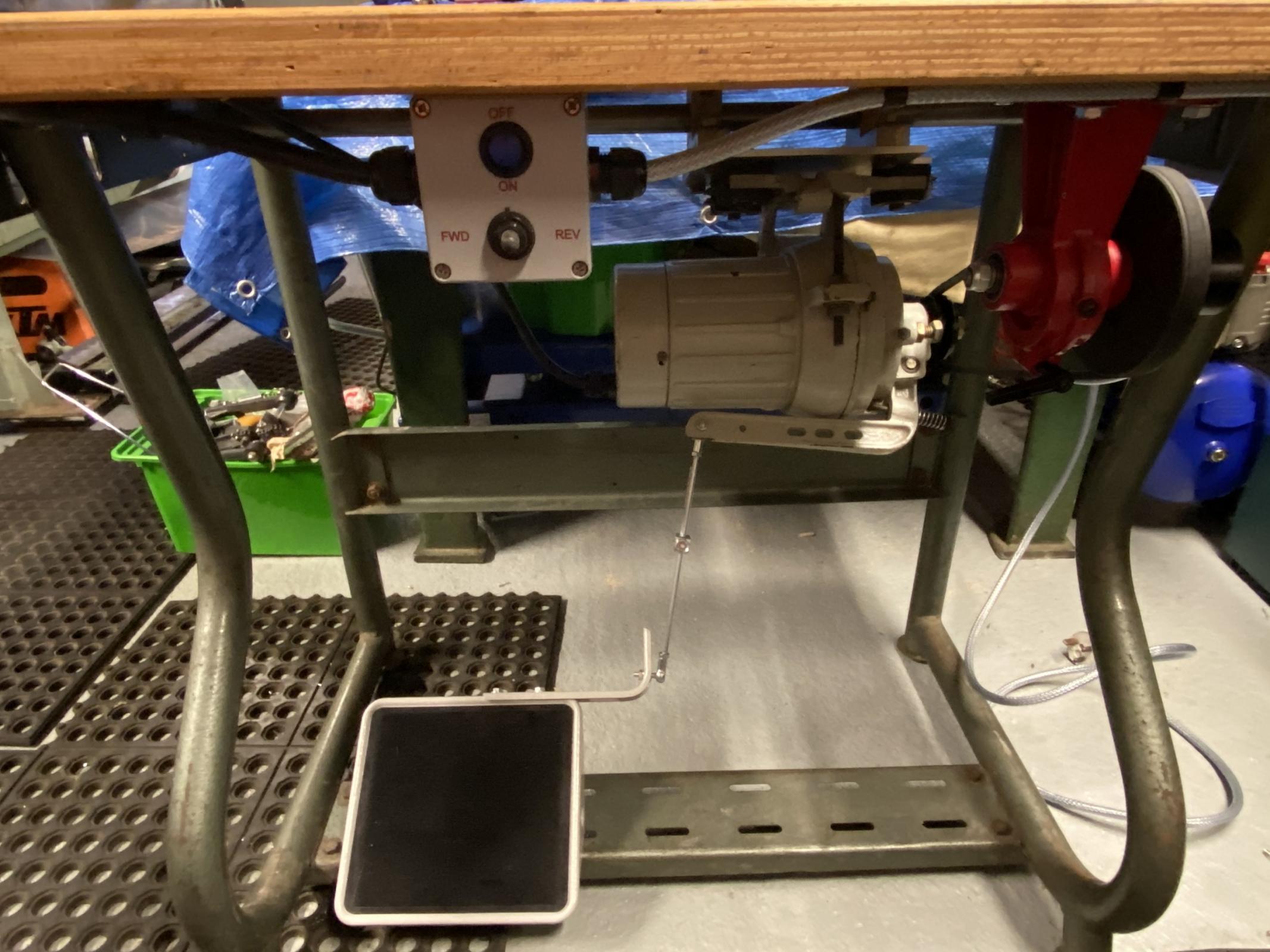

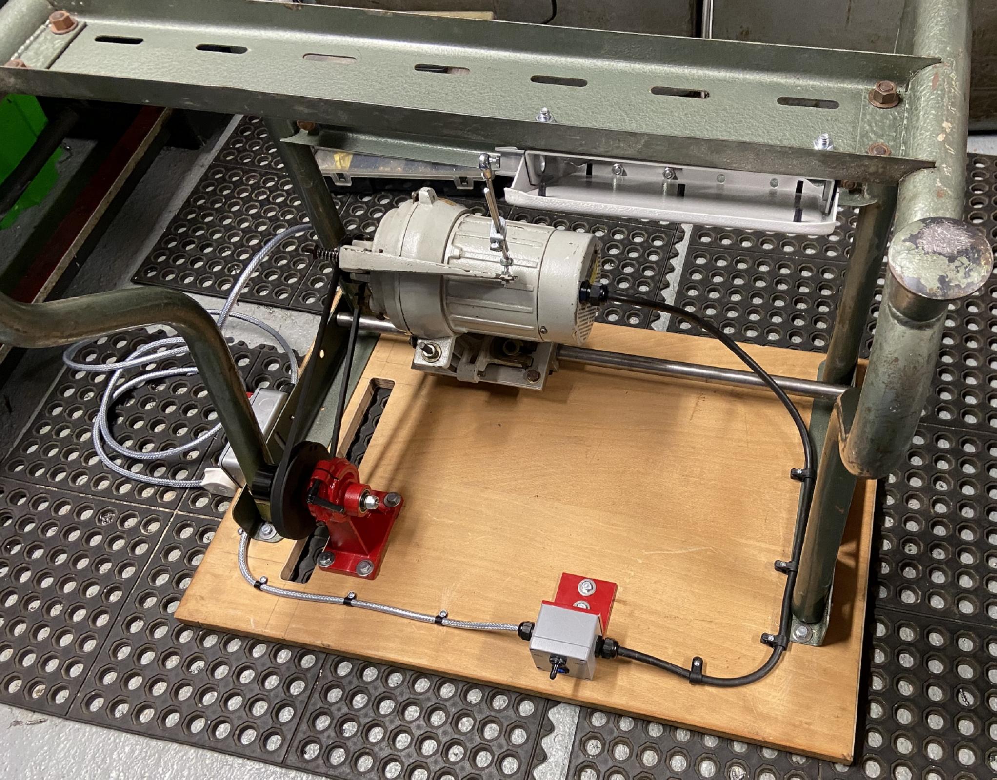

The idea is to have a interchangeable system so I can simply bolt the tool required tool to the table slip a vee-belt on the pulley and use it under controlled speed (rpm) hands free to guide the workpiece.
So the photos below show the table build to table top where the tools will be bolted in place. I have ordered the vee-belts so will wait to drill the top until I am happy all works and lines up as expected.
There are a couple of extra thing I need to think about 1st a skid so it can be moved around the workshop as I also intend to bolt the homemade box folder to the same work surface. 2nd is a automatic belt tensioner as the ring roller drive is on the moving part of the machine so each adjustment will loosen the tension on the vee belt. Also the other two machines might need slight tension although the pulley block can be adjusted as the centre is of set by 10mm giving 20mm total adjustment. The motor also can be easily adjusted to take up any tension.

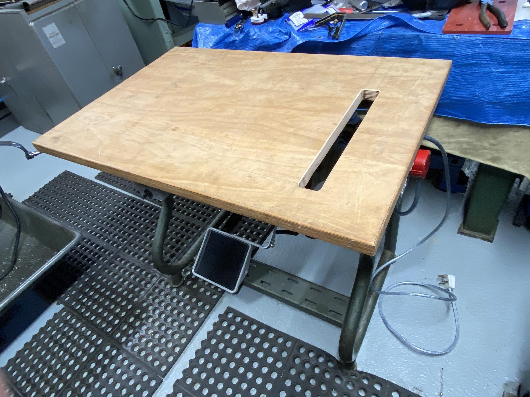

Attachment 33145
Table ready for tooling to be bolted to work top. The slot allows the vee belt to drive the machine from the bottom drive
Attachment 33146
Underside of the table showing motor, switch, pulley block and main metal frame.

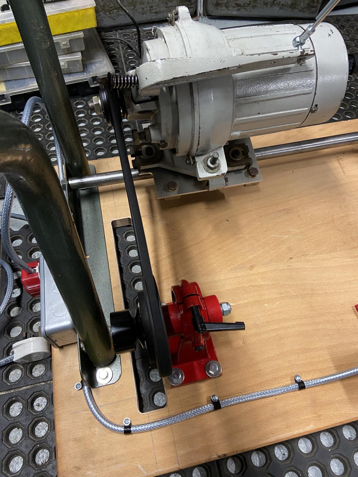

Attachment 33147

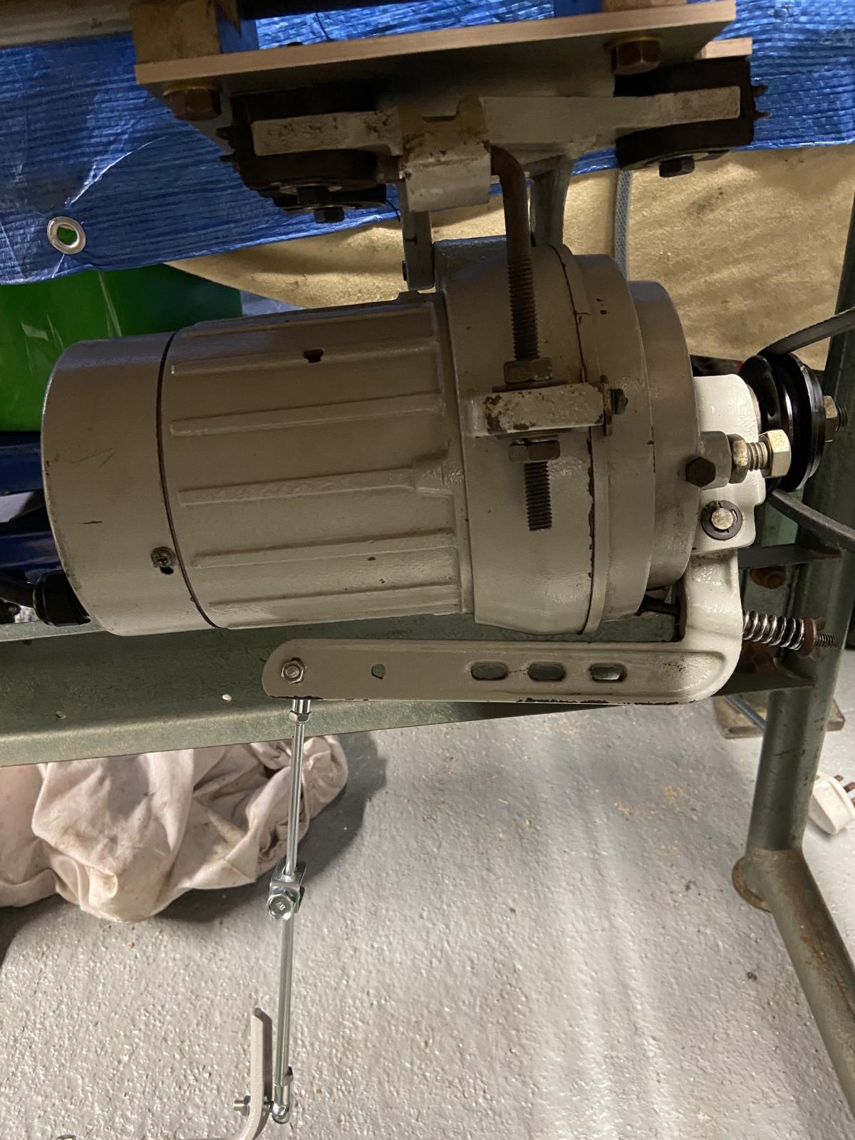

Clutched motor. The belt is off set for a reason, when the clutch is operated it moves the drive pulley towards the motor so the two pulleys are in line when fully engaged.

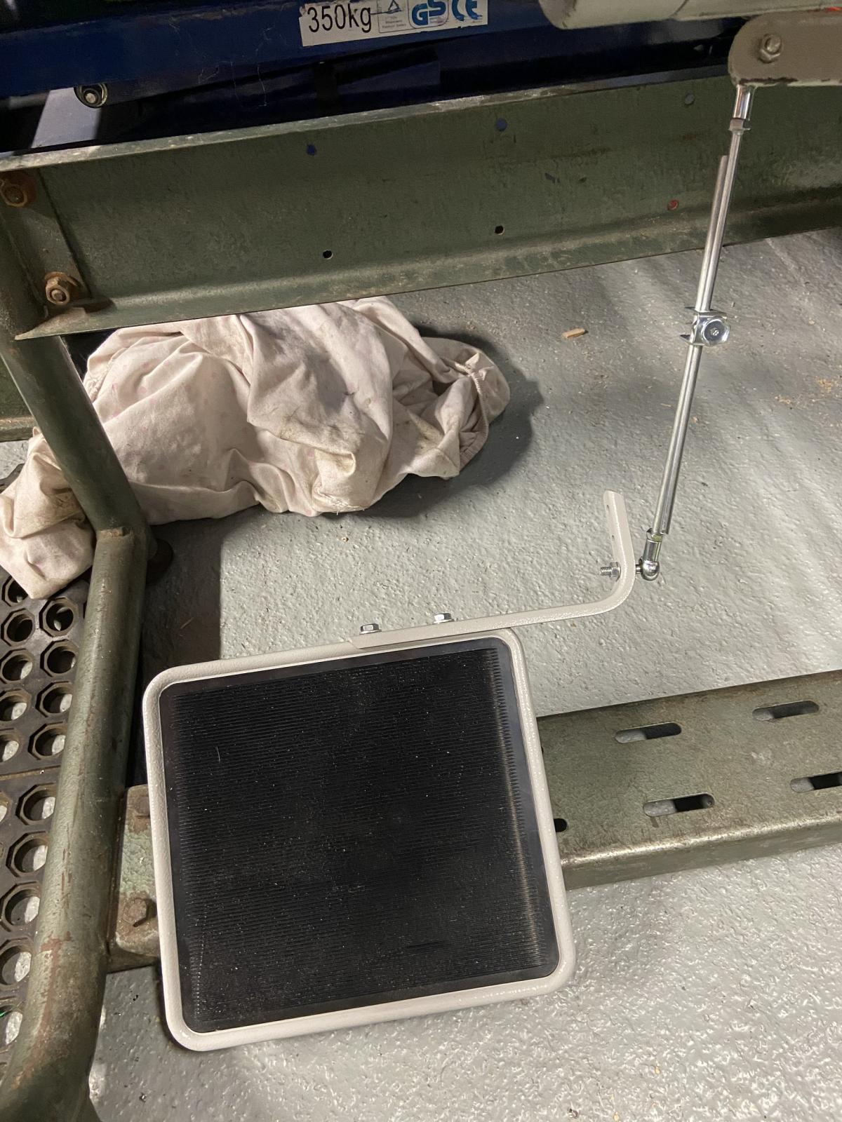

Attachment 33148
Foot pedal linkage to clutched motor. The linkage is called a Pitman Rod.
Attachment 33149
Foot pedal.

Industrial clutched sewing machine motor

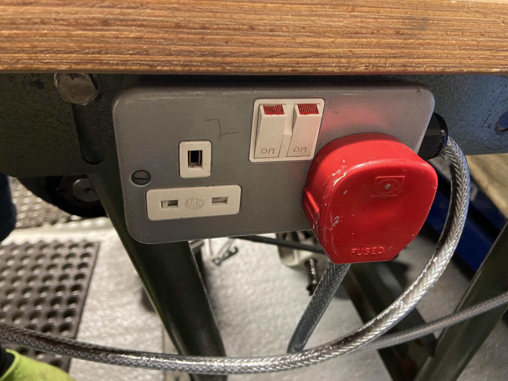

Attachment 33151
I have added a double socket so a light can be used from the second outlet.

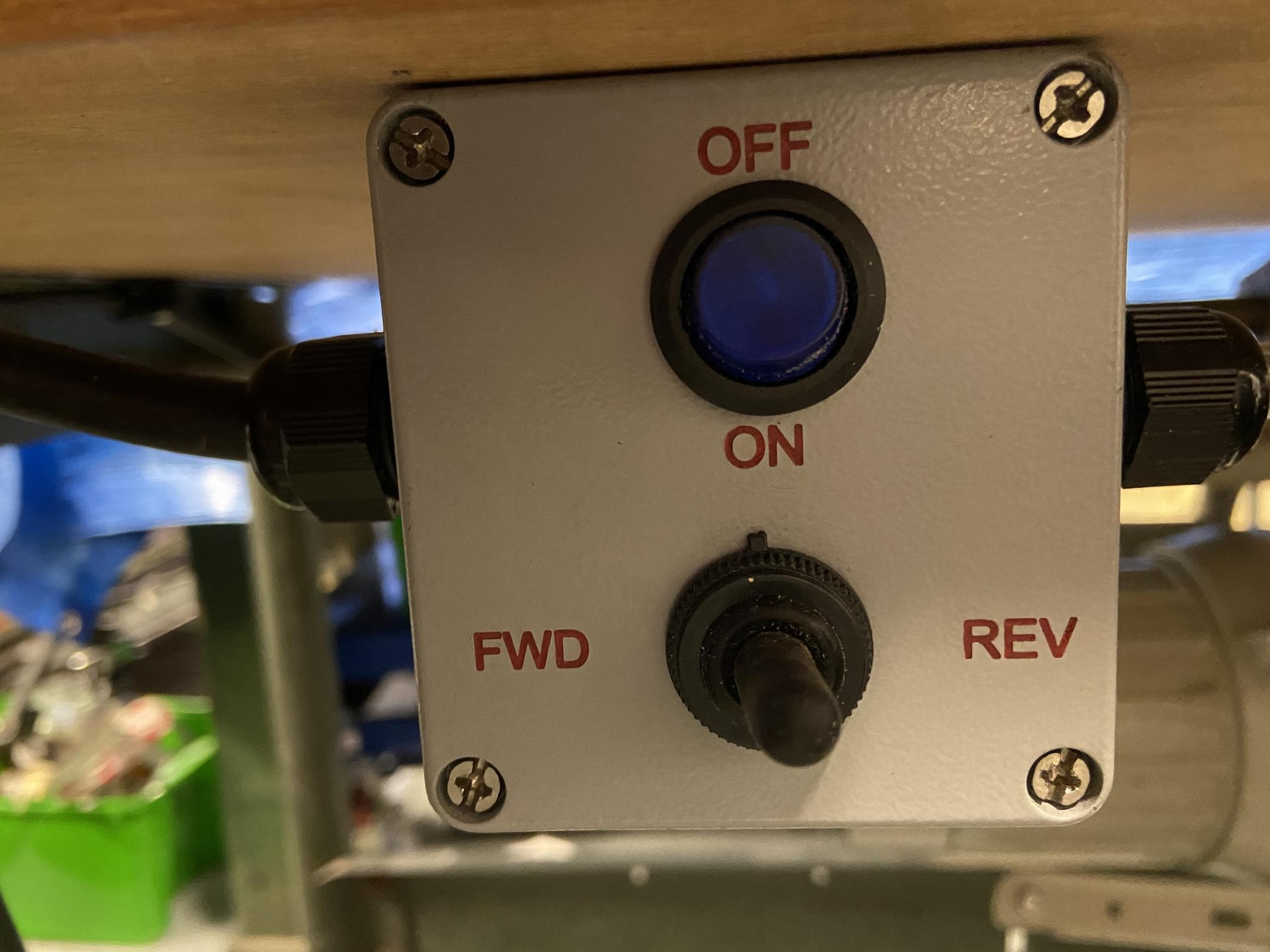

Attachment 33152
Switch engraved rocker switch ON/OFF and toggle switch for direction

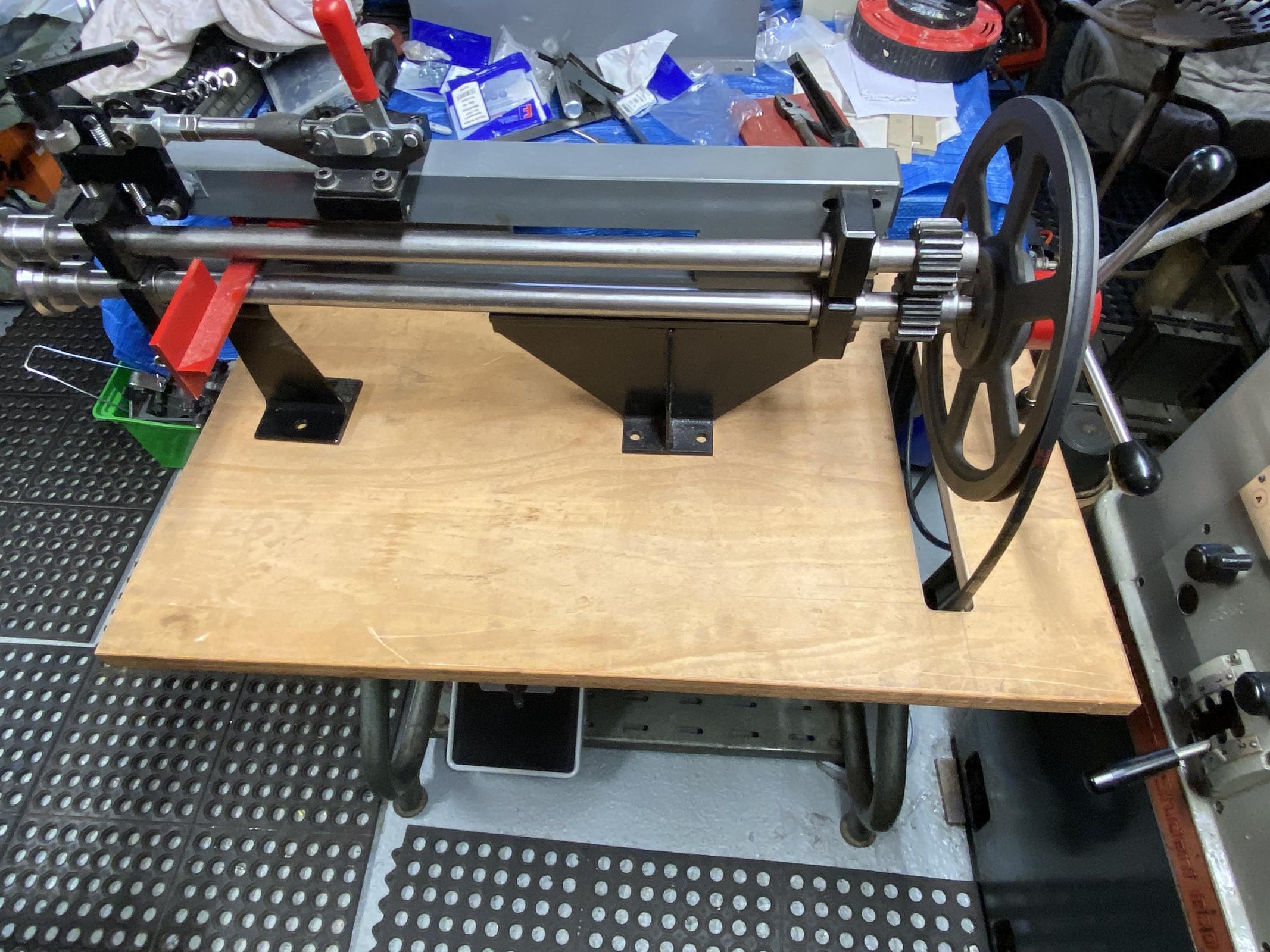

Attachment 33153
Bead roller just placed in position to show vee belt coming up from bottom drive. (on going) The tooling will be bolted to the table top via 8mm Prong tee-nuts.
