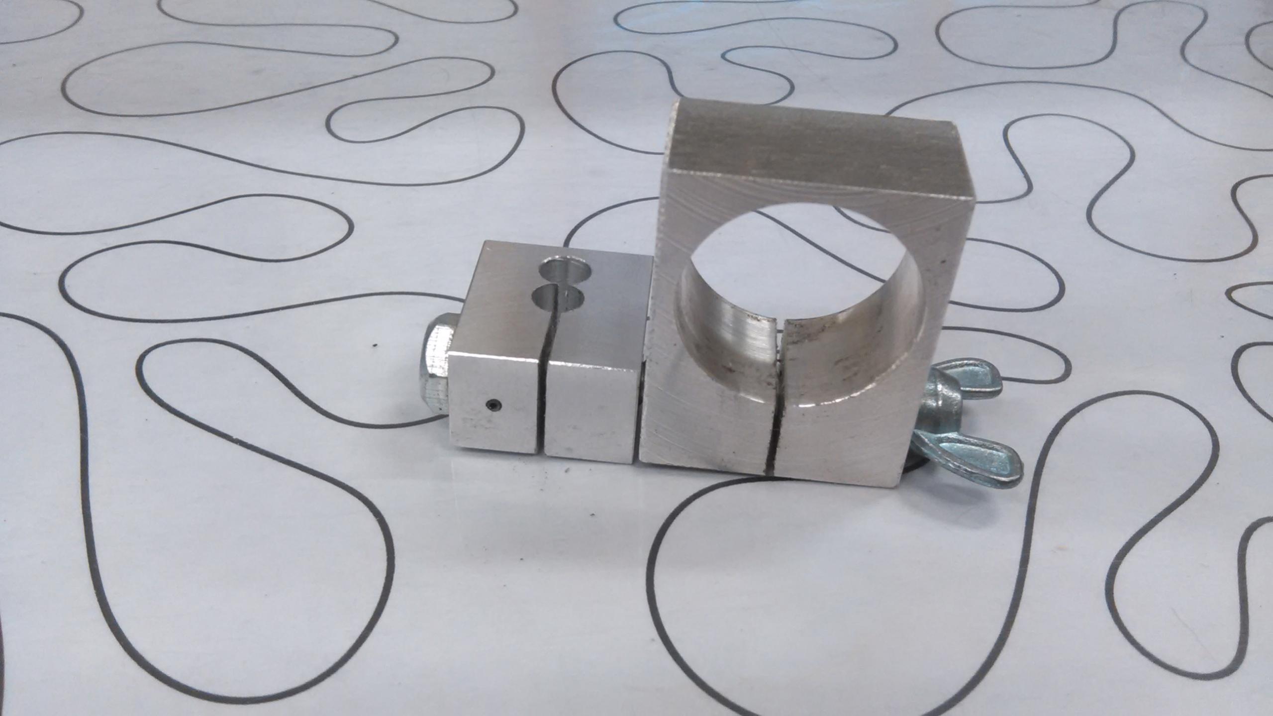

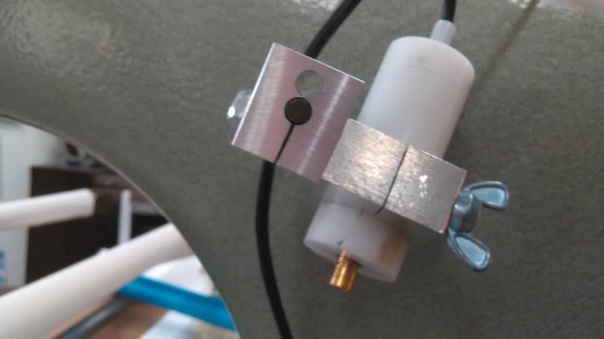

for clamping onto cylindrical forms. Effective for light loading but not the best solution to resist twisting torque in more stressful applications.
A much more effective clamp is the "split cotter". This pdf...
https://madmodder.net/index.php?acti....0;attach=7950
shows two styles of cotter clamps. The one labeled "B" is the more effective and the one that most folks envision when they hear the term "split cotter".
