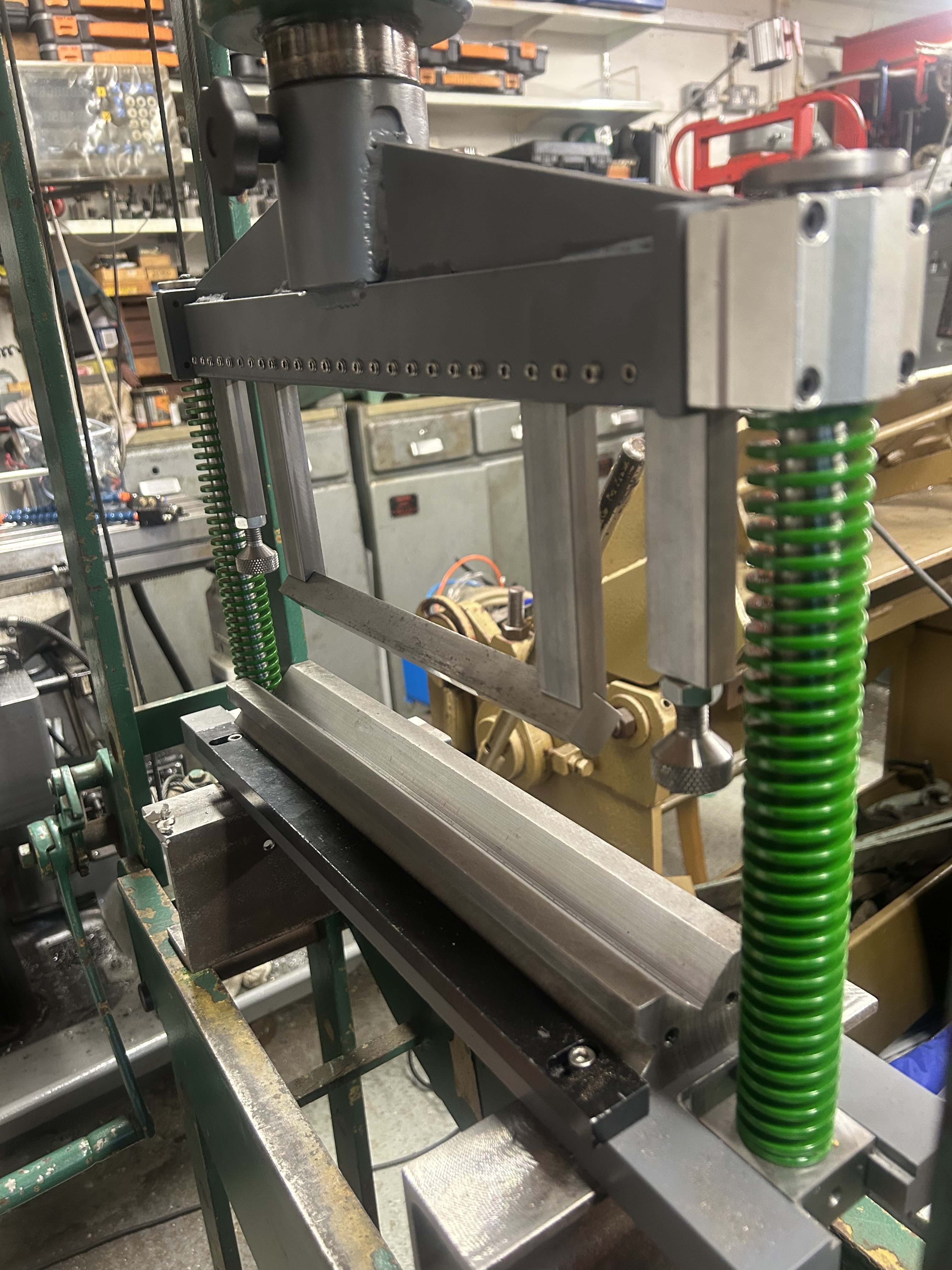

Hi All

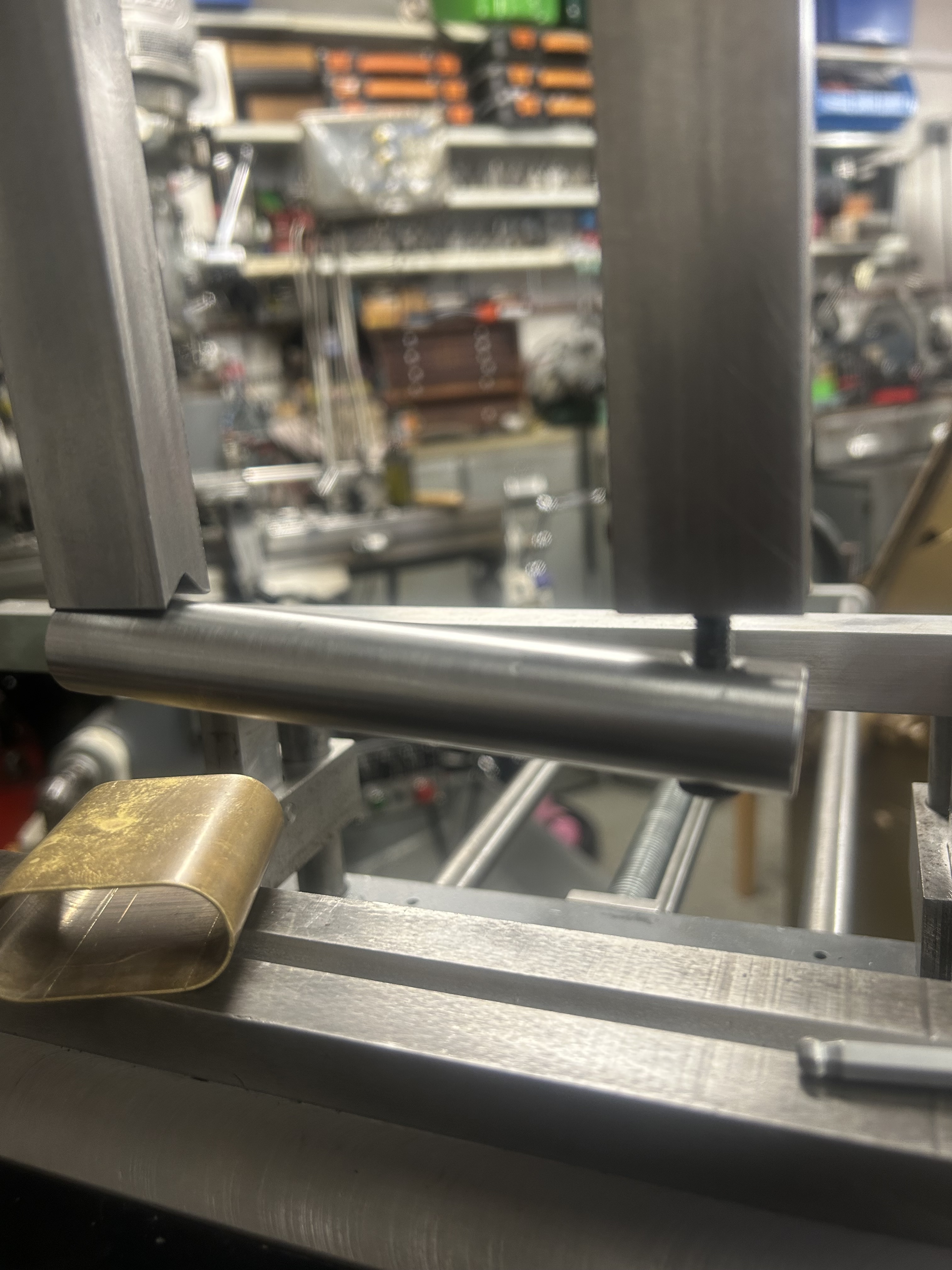

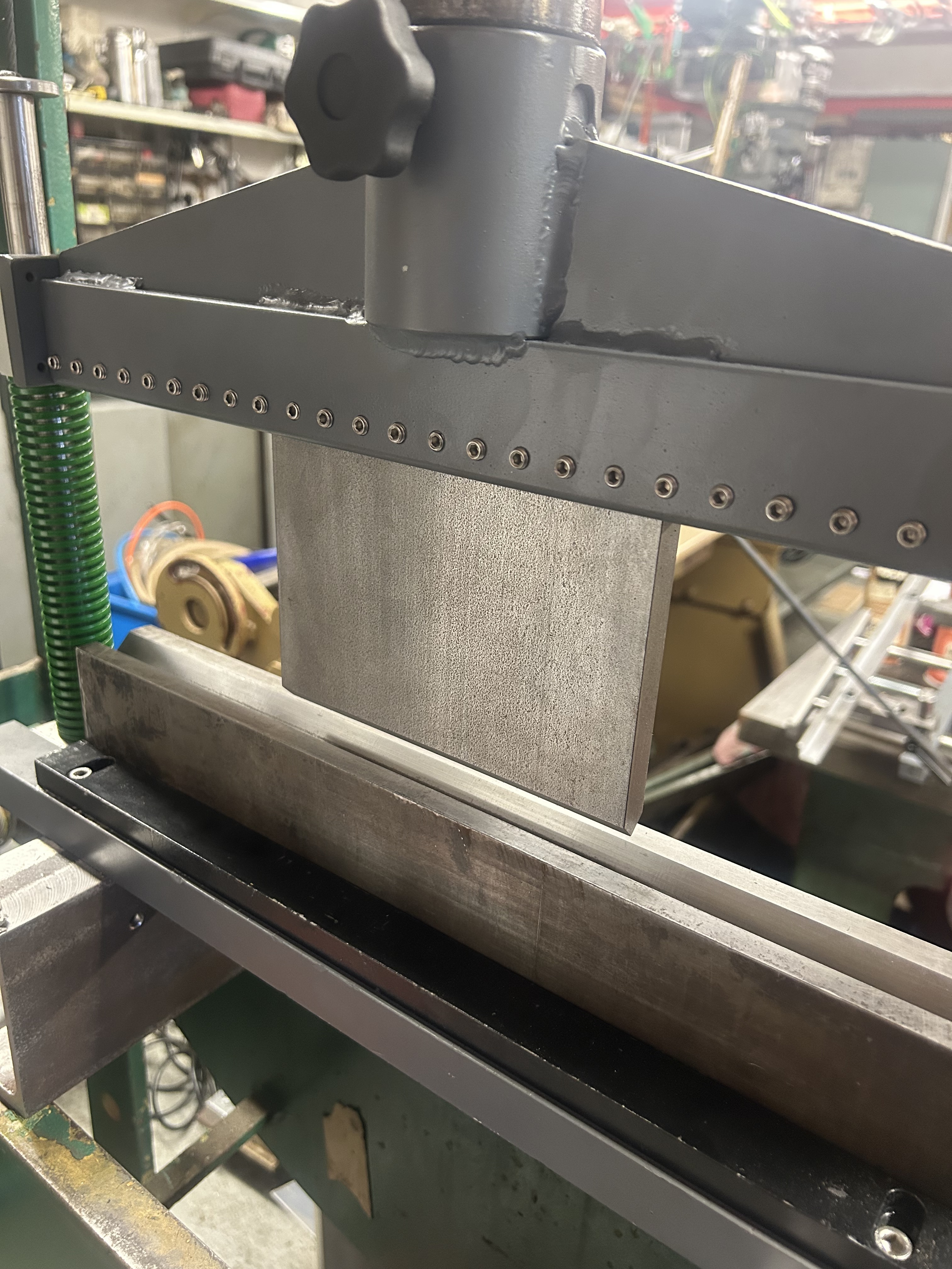

I decided to make a press brake to help bend, fold and form sheet metal parts for my Foden Steam Wagon and any other jobs that need forming in the future.
Initially in my head it started as a quick and simple build, trying to utilise materials that I had already around the shop. The further I got into the thought process I realised this was not going to be the case. If I was going to future proof the design and have something I would be happy with and do all the things I wanted. I didn’t have all the materials I needed. A couple of hundred pounds later, delivery of the parts and stock needed to get started.

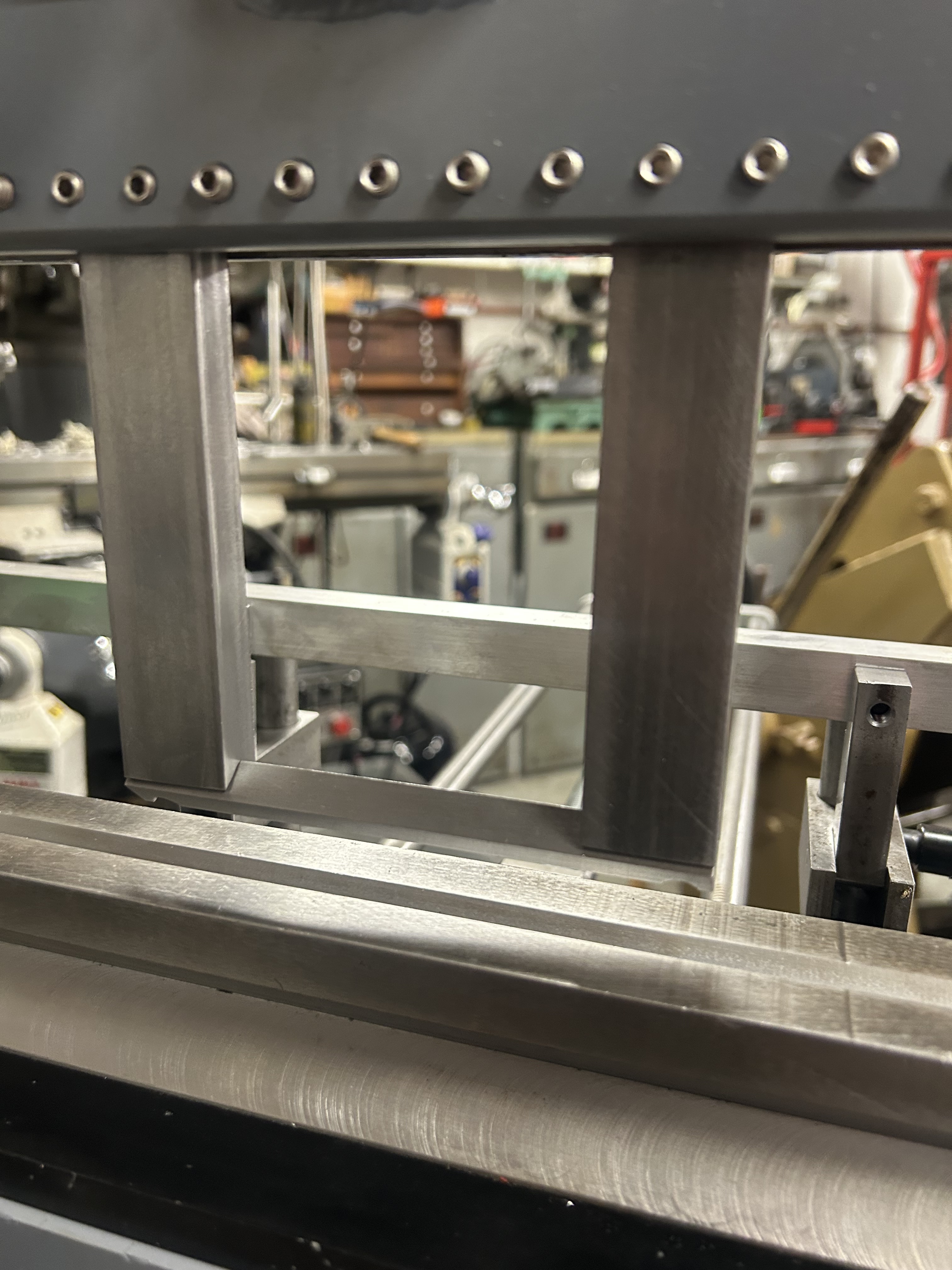

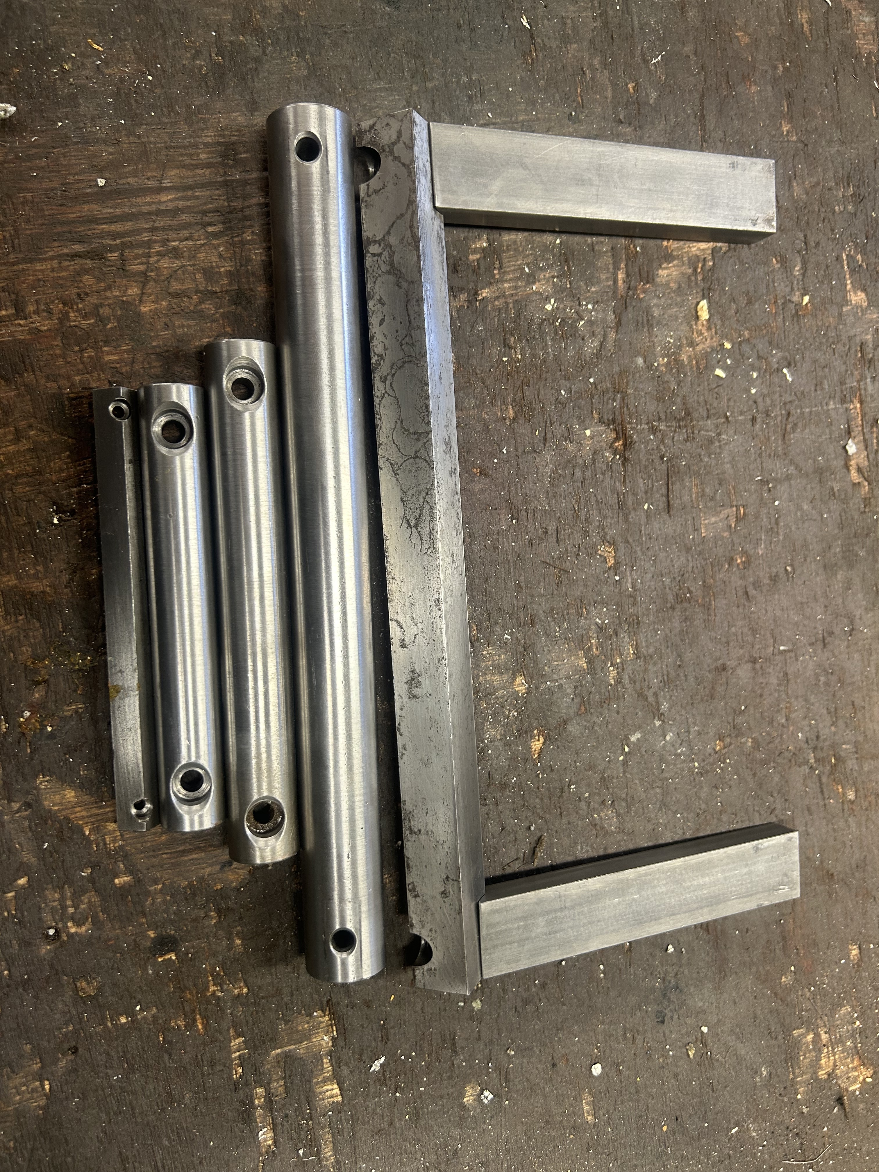

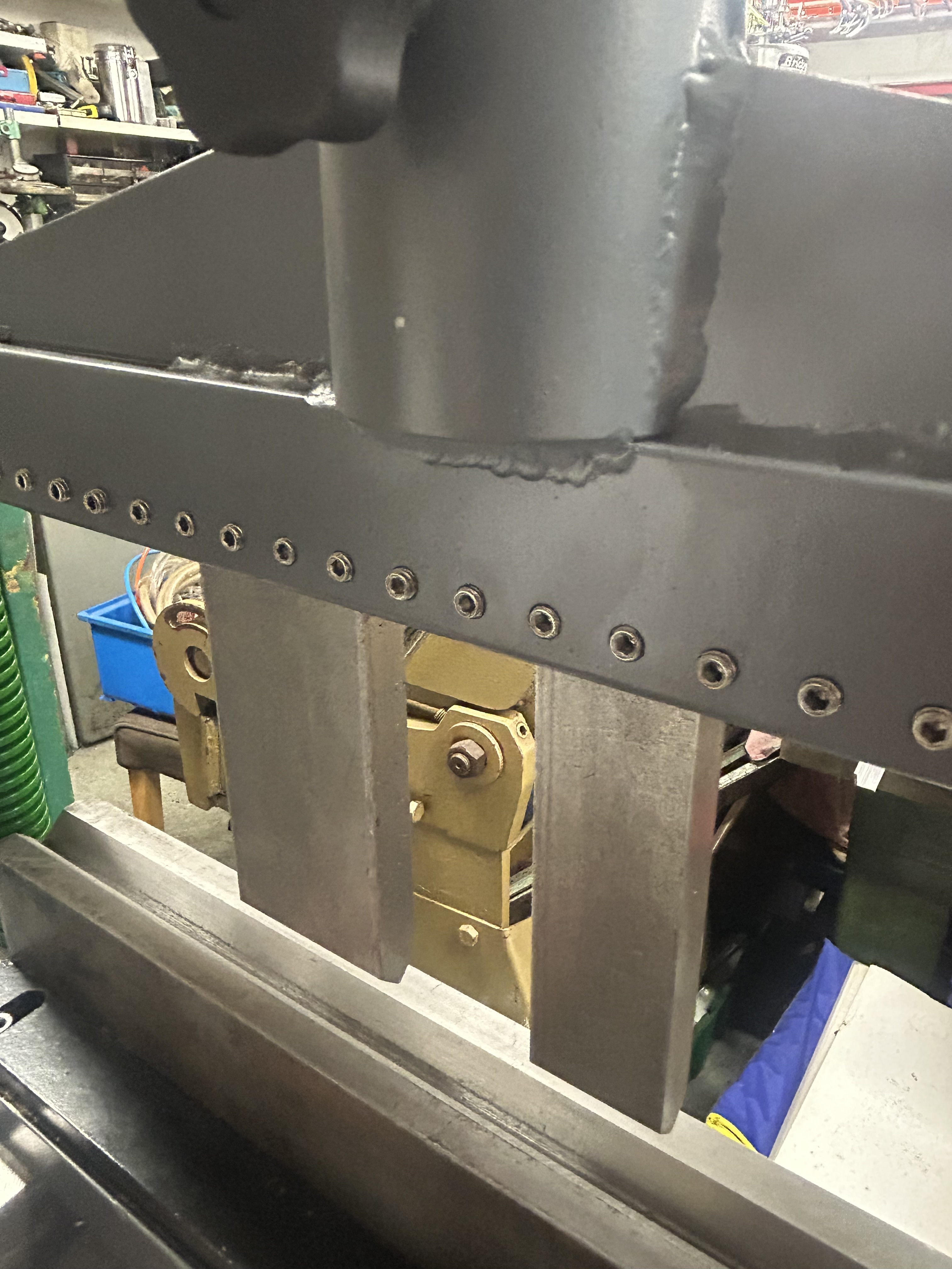

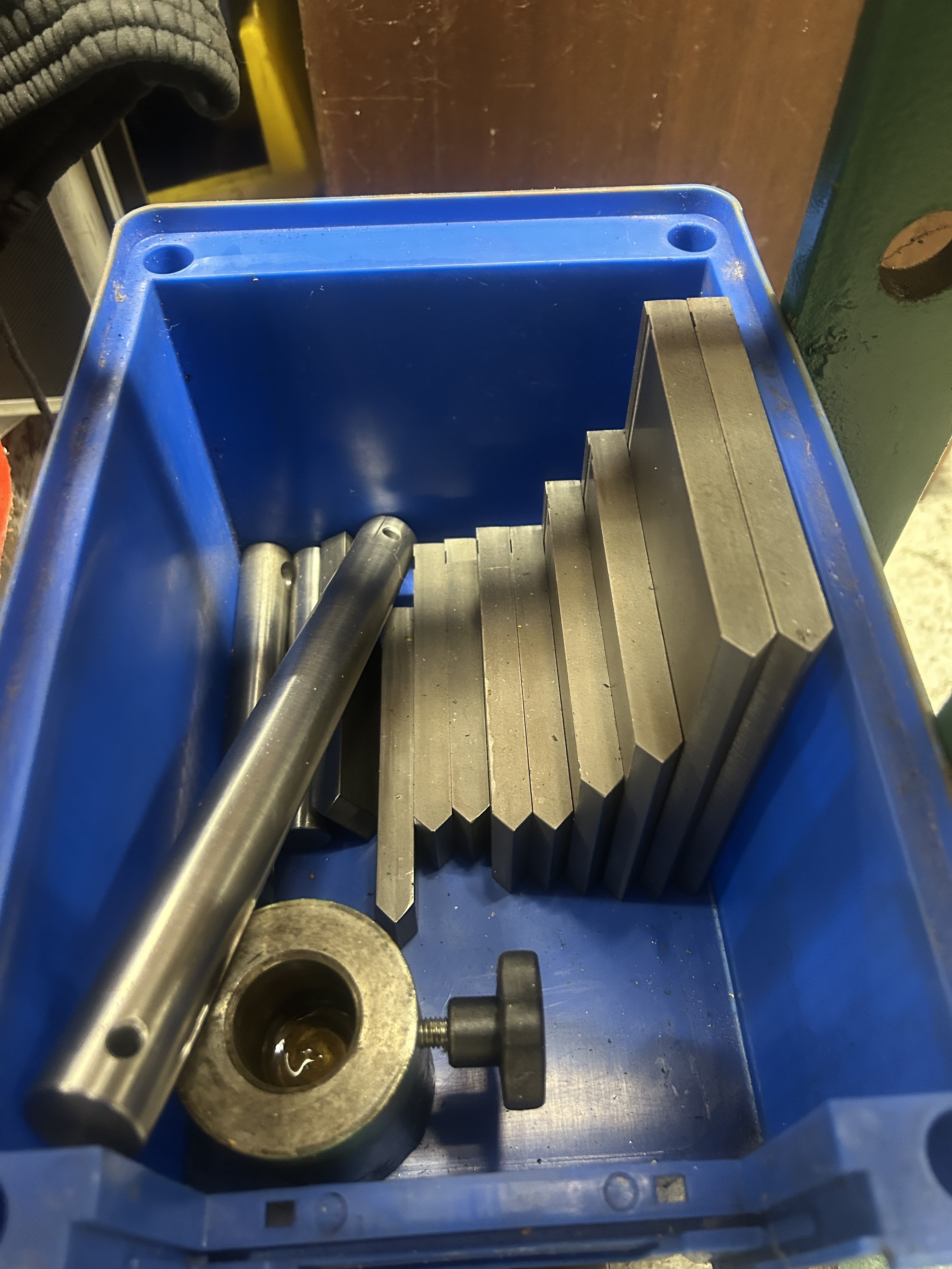

The basic frame of the machine is standard like most other builds, with a base plate, two guide shafts and a bridge piece to hold the press tooling. The tooling is 1/2” plate different widths. Also a few form tools for larger radius’s which also double up as a bump tool for extra large radius’s and shapes.

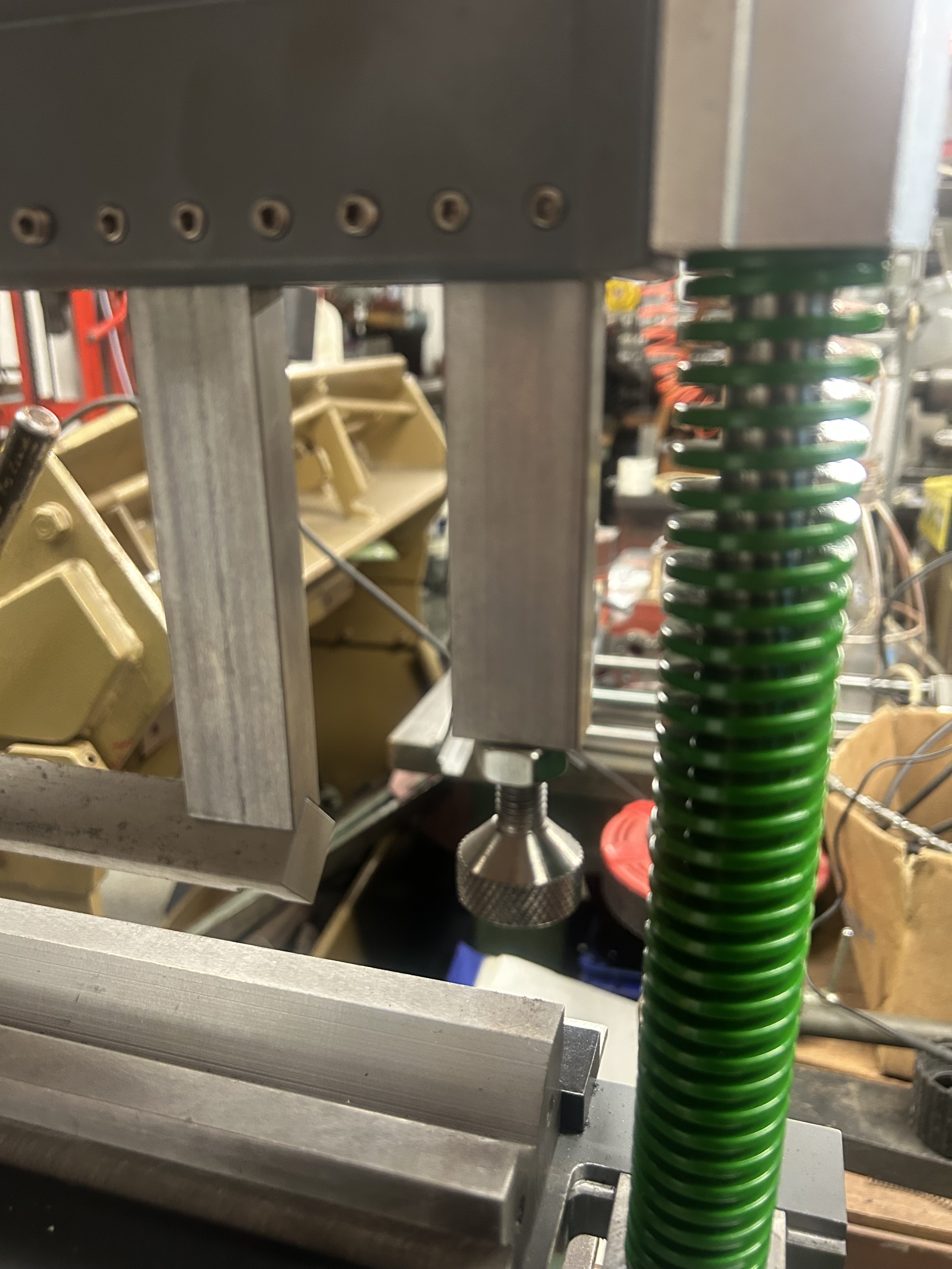

As it is difficult to use a standard hydraulic press when bumping a large radius as the same depth/pressure is needed to be applied for a consistent form two adjustable stops were made to control the travel of the ram.
The other additional part is an adjustable back stop which I will do a separate post on.
The photos below show the completed brake press and it being used.
Attachment 50634 Attachment 50635 Attachment 50636Brake press with different tooling
Attachment 50641Adjustable bump stop to set constant depth of bump tool.

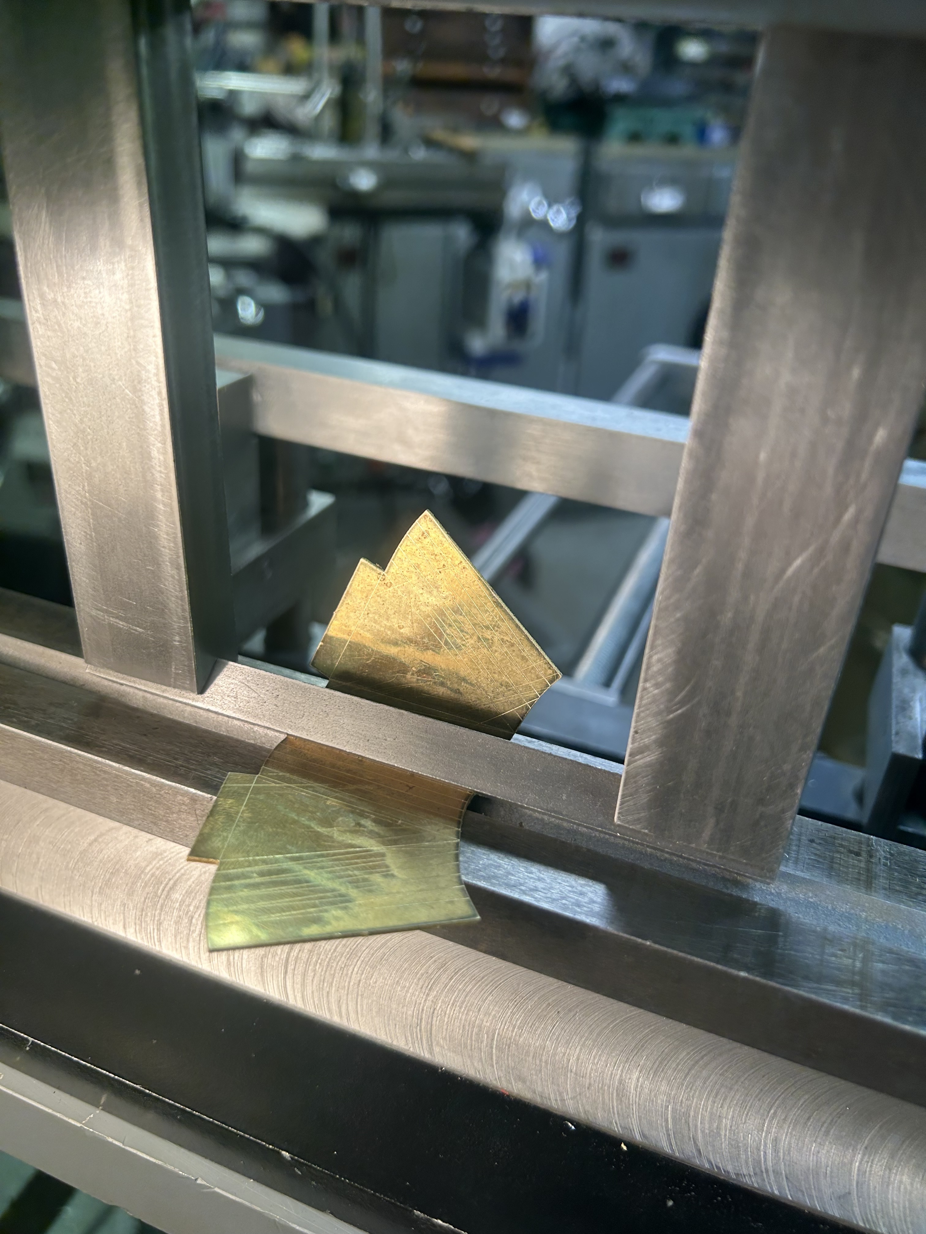

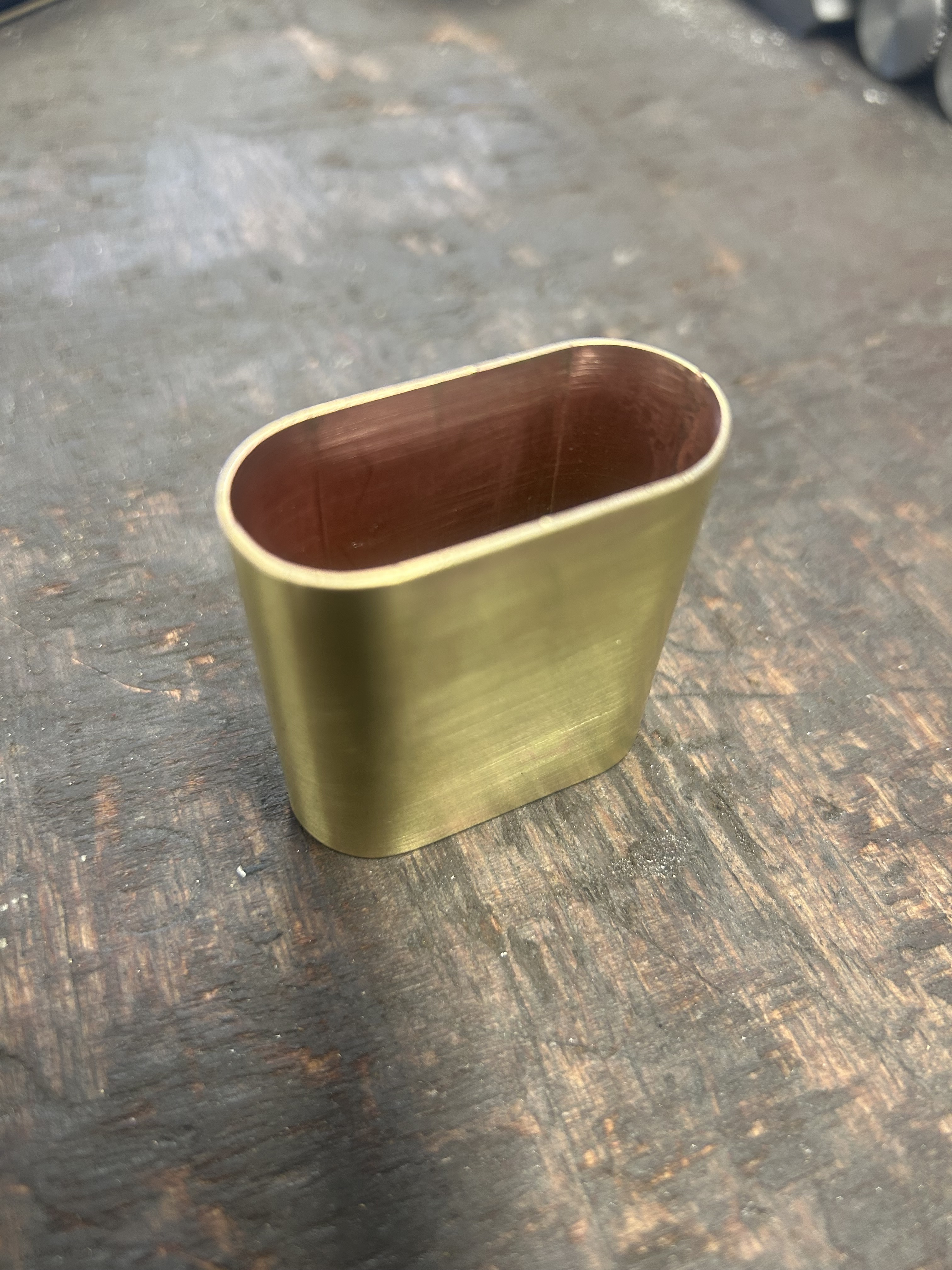

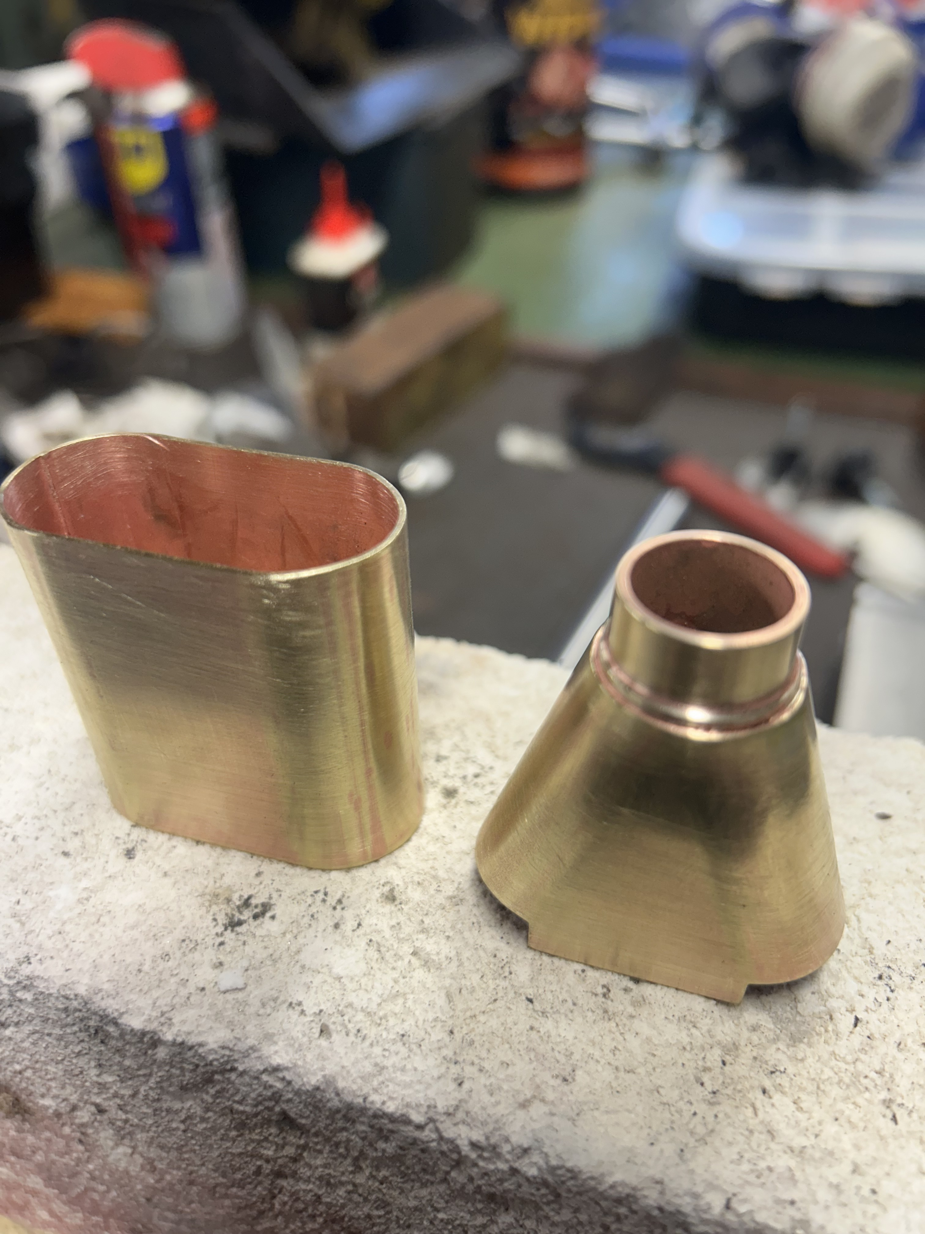

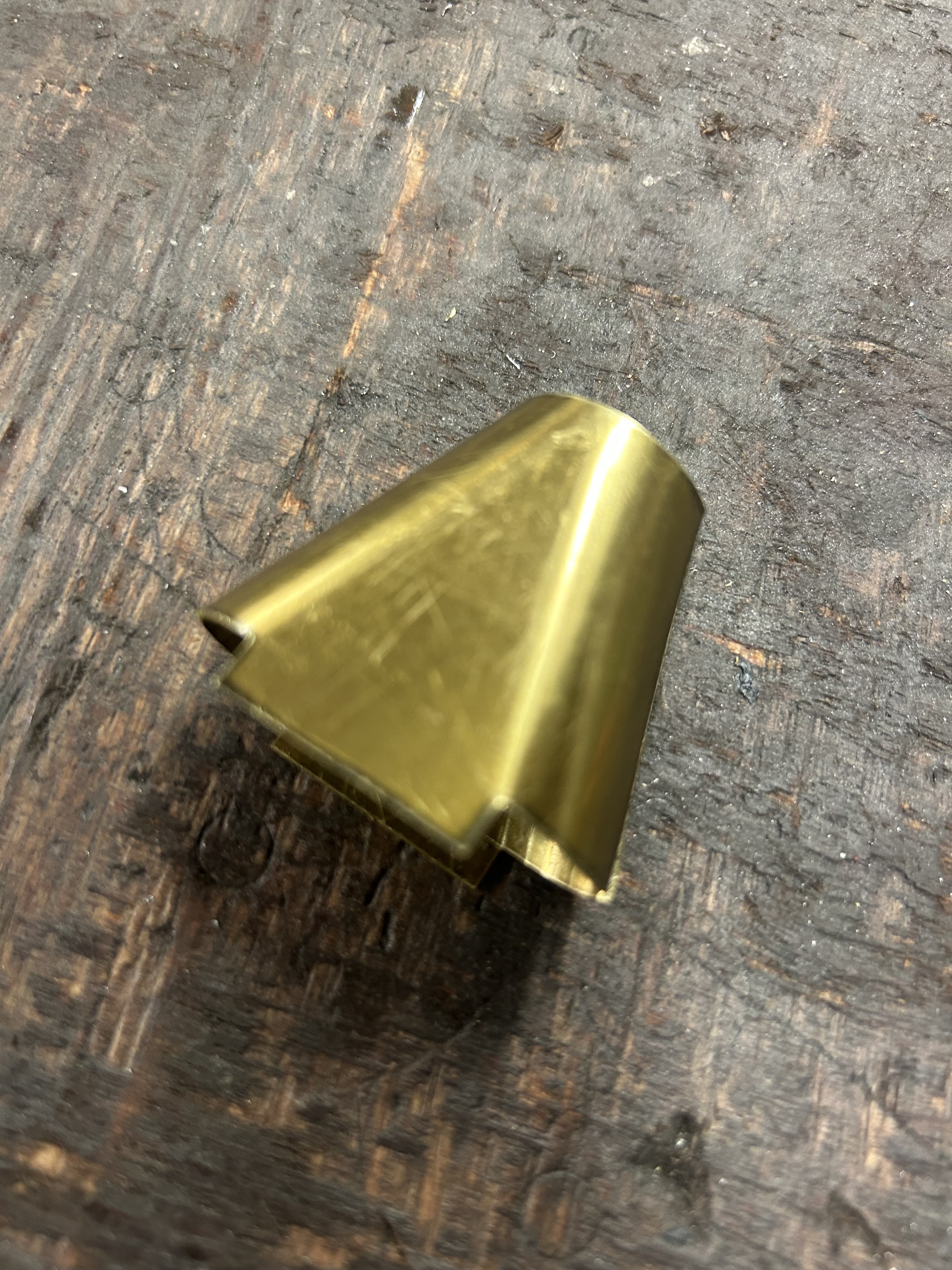

Attachment 50639 Attachment 50637 Attachment 50638 Attachment 50640 Bump tool used to form an oval to round funnel shape.

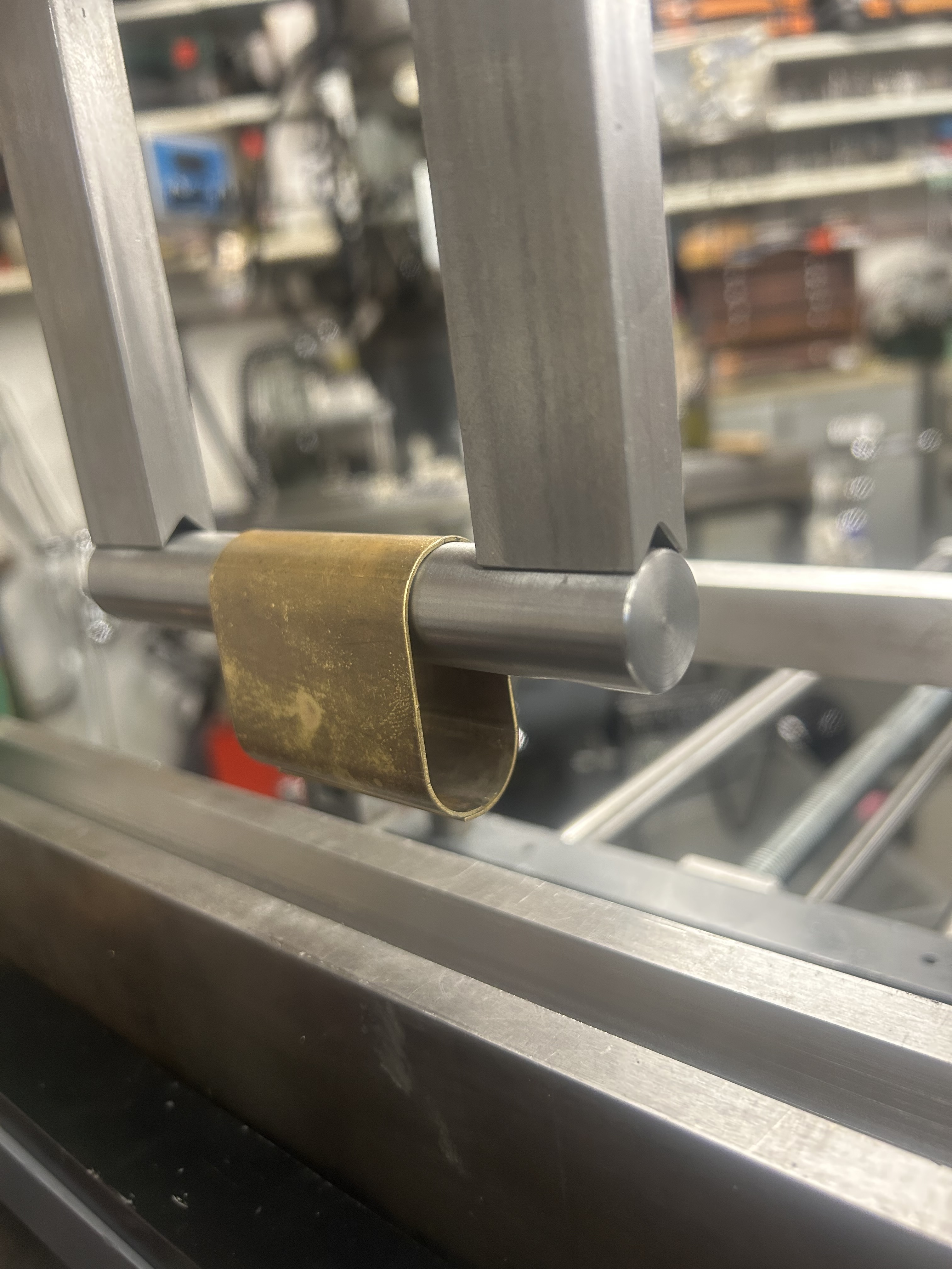

Attachment 50642 Attachment 50651Bump tooling and form tooling

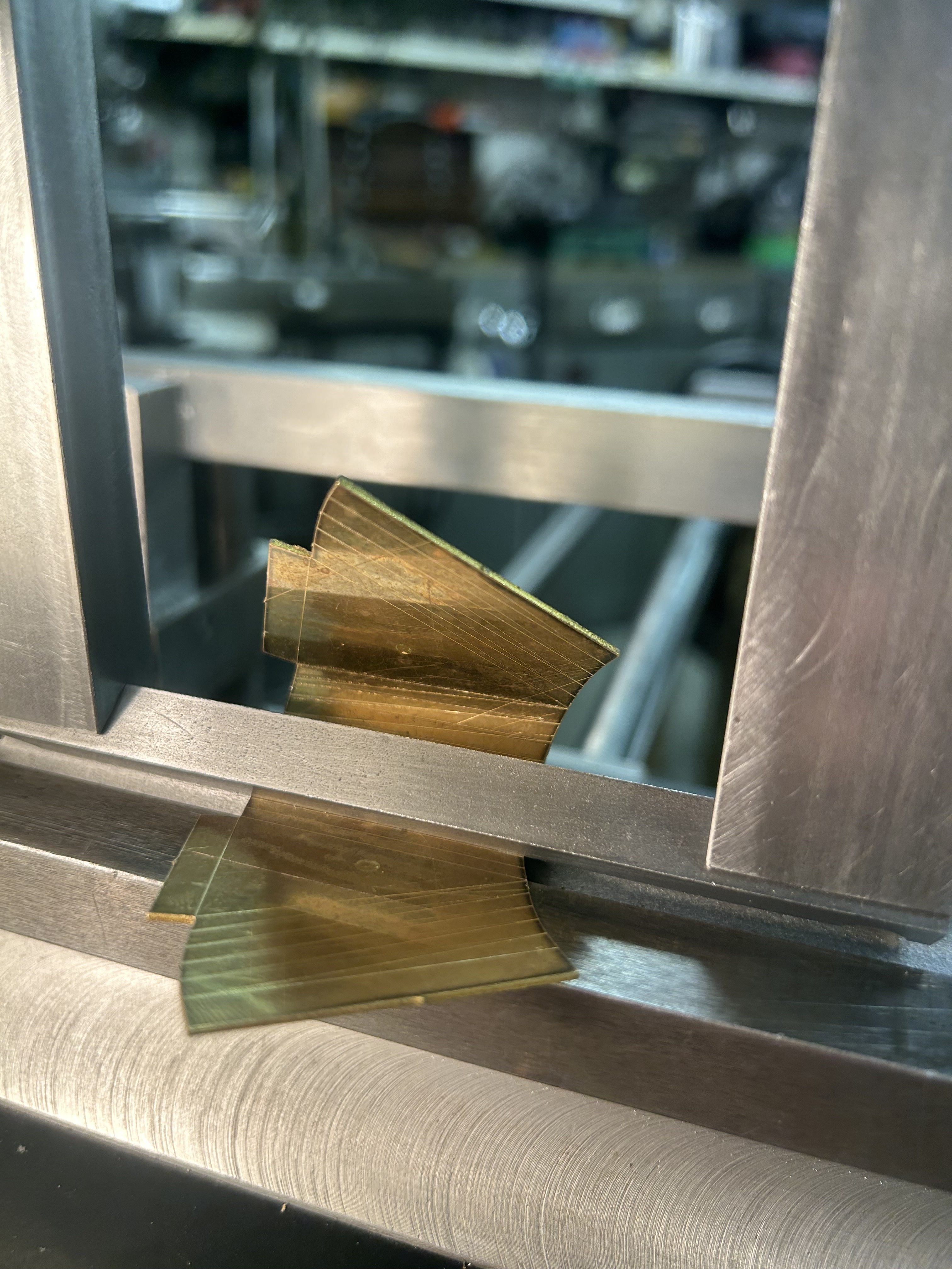

Attachment 50643 Attachment 50644 Attachment 50645Form tooling creating oval shape.

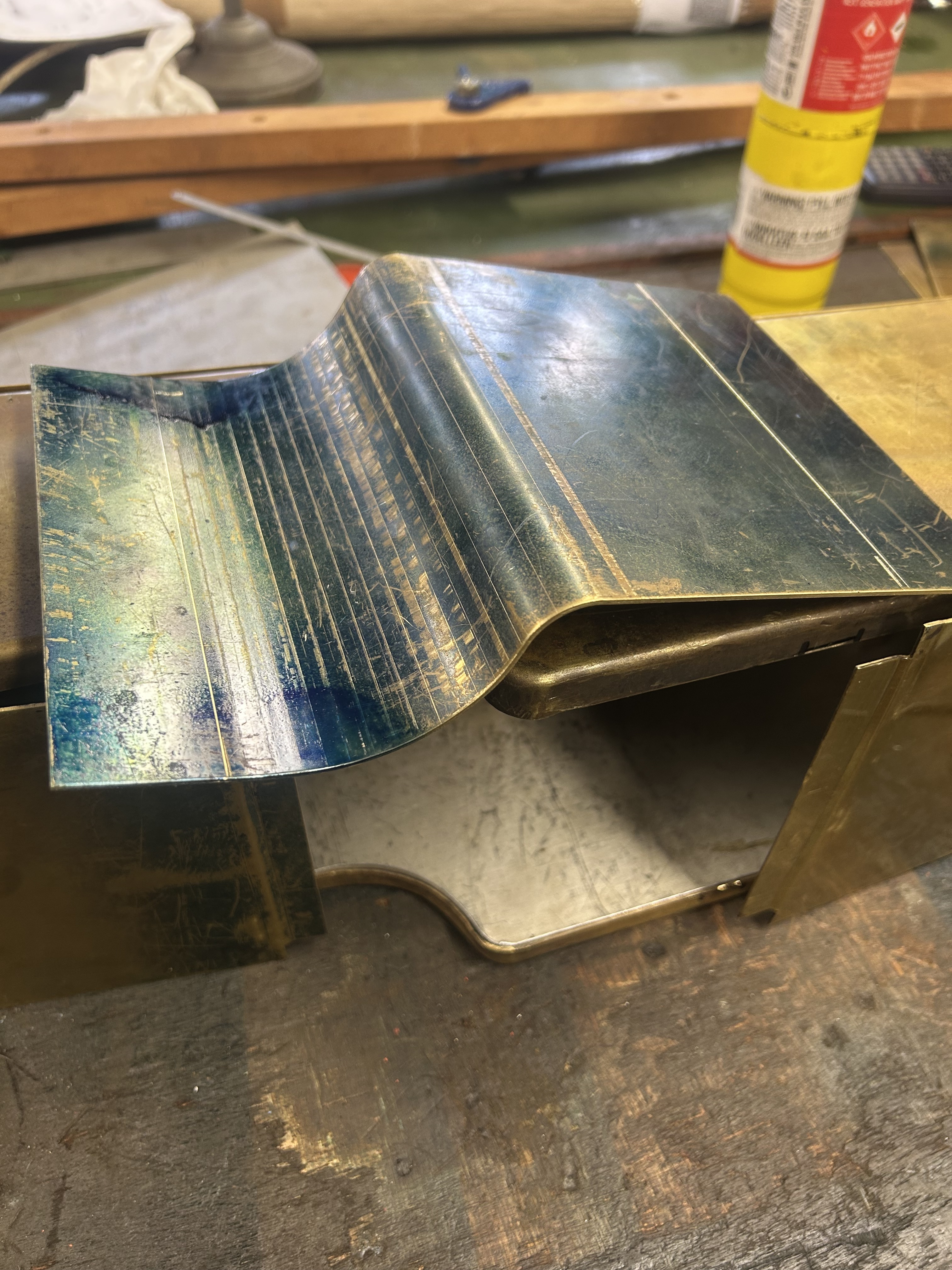

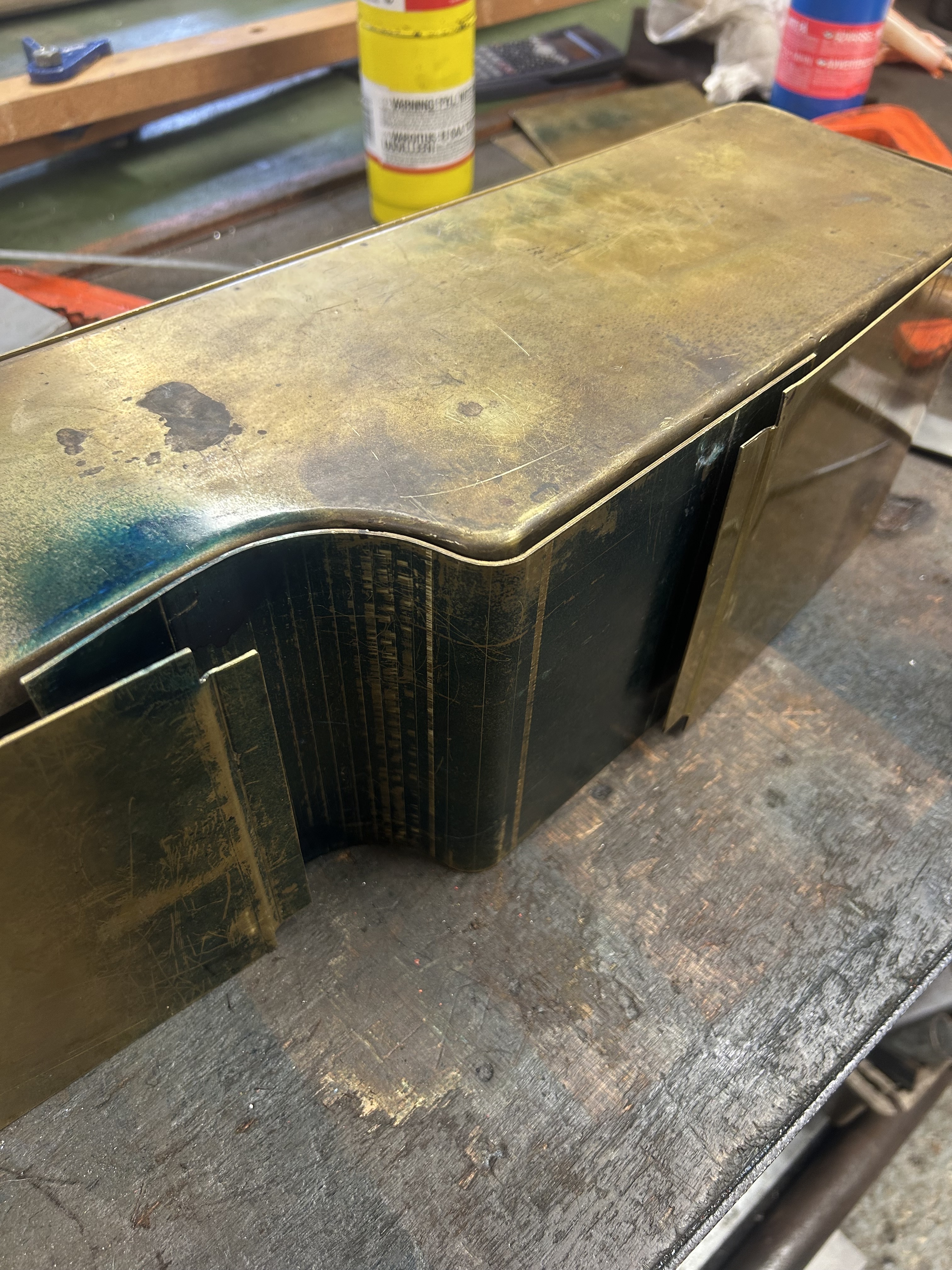

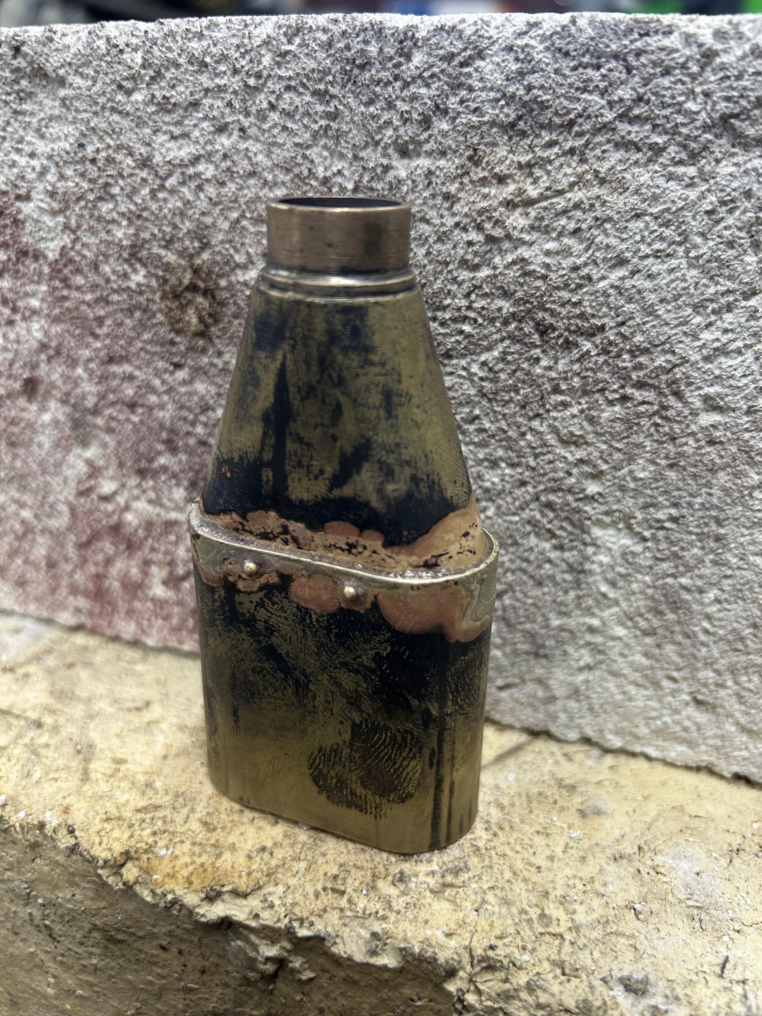

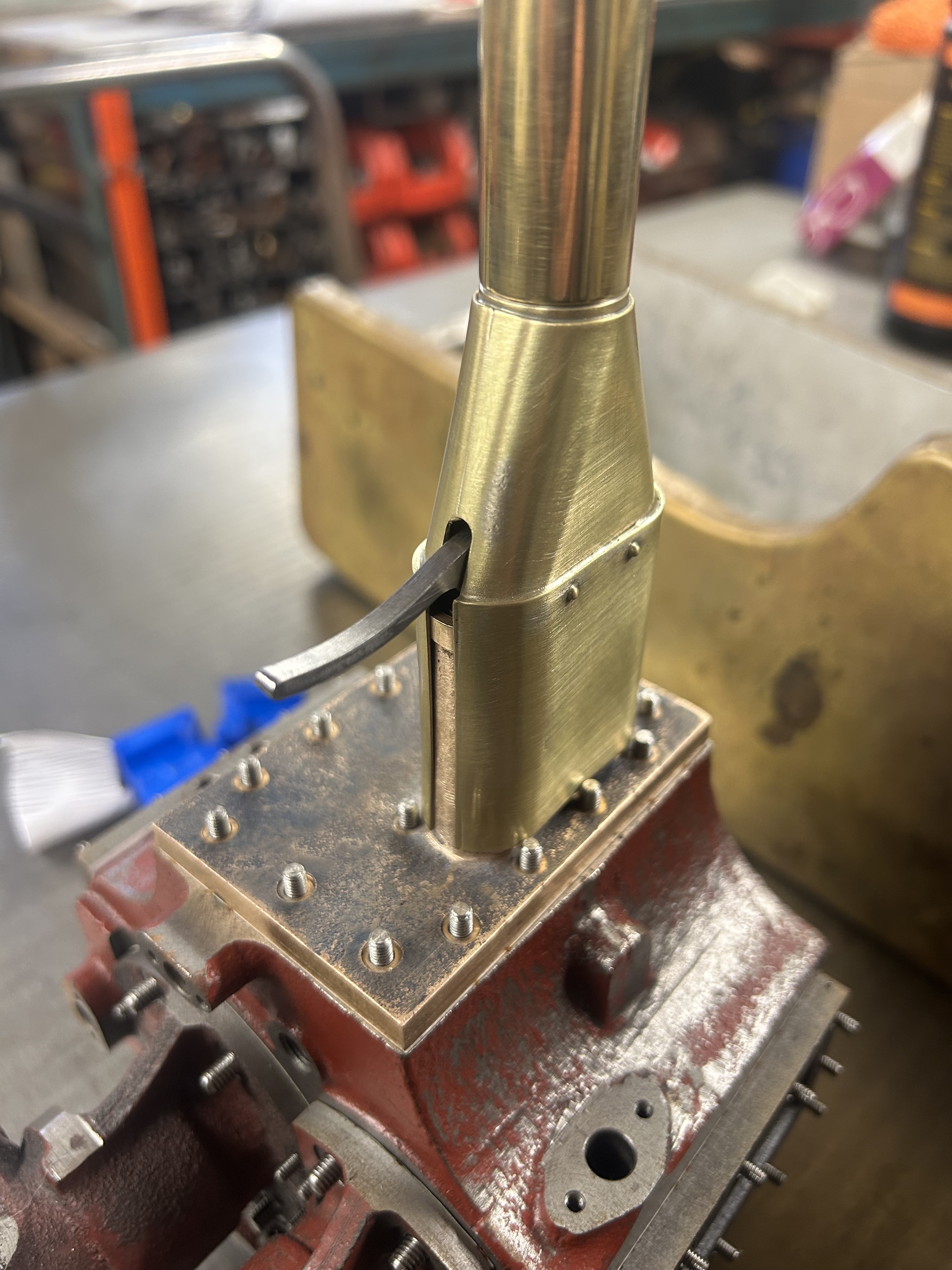

Attachment 50646 Attachment 50647 Attachment 50648Completed safety valve cover.
Attachment 50649 Attachment 50650Both form tooling and bumping tool was used to create this part of the Foden water tank.
