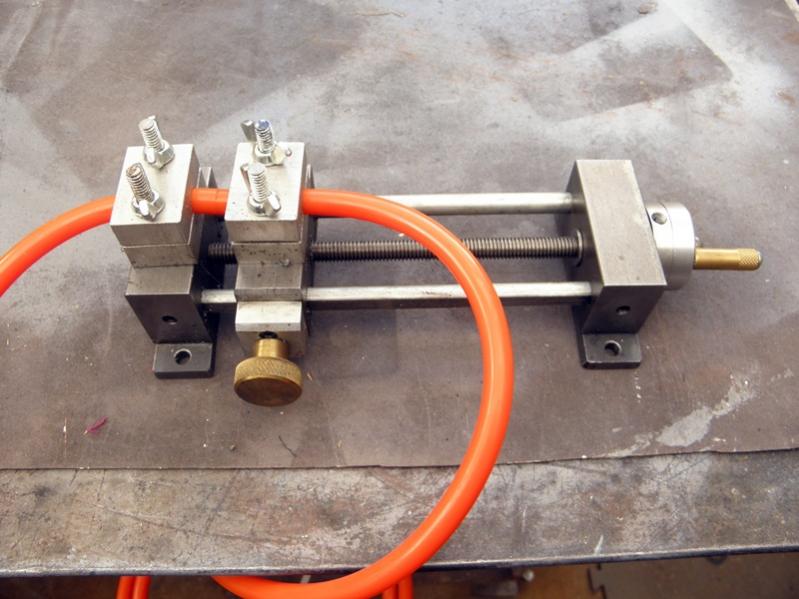

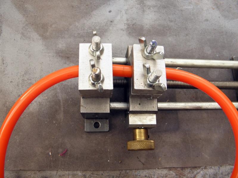

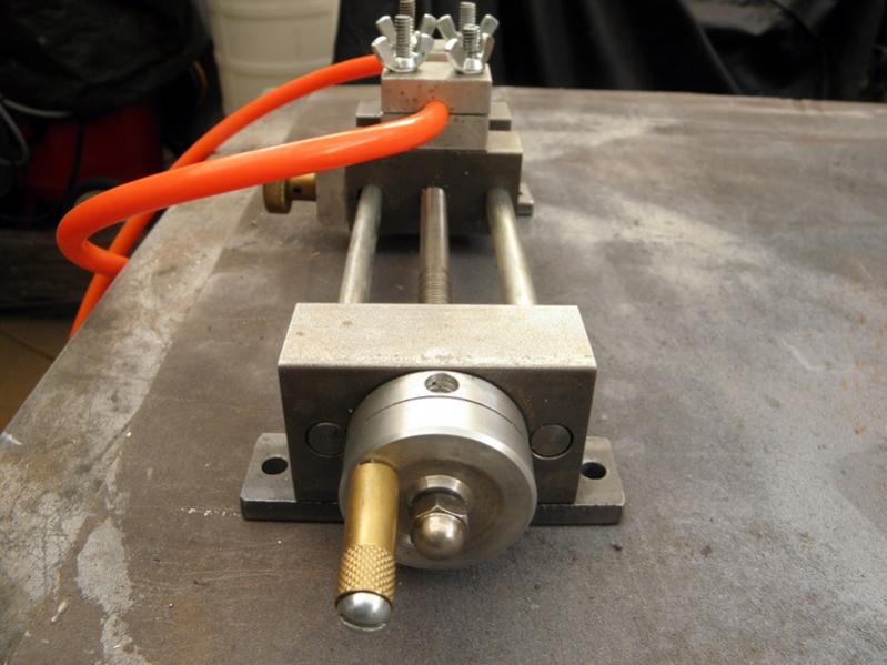

Fan Belt Welding Jig Holder. This is a jig that holds the belt material so both ends are centered on each other,
then the belt ends are moved apart and heated with a soldering gun special tip,and the jig then closes the two half's together and thus forms the weld.
