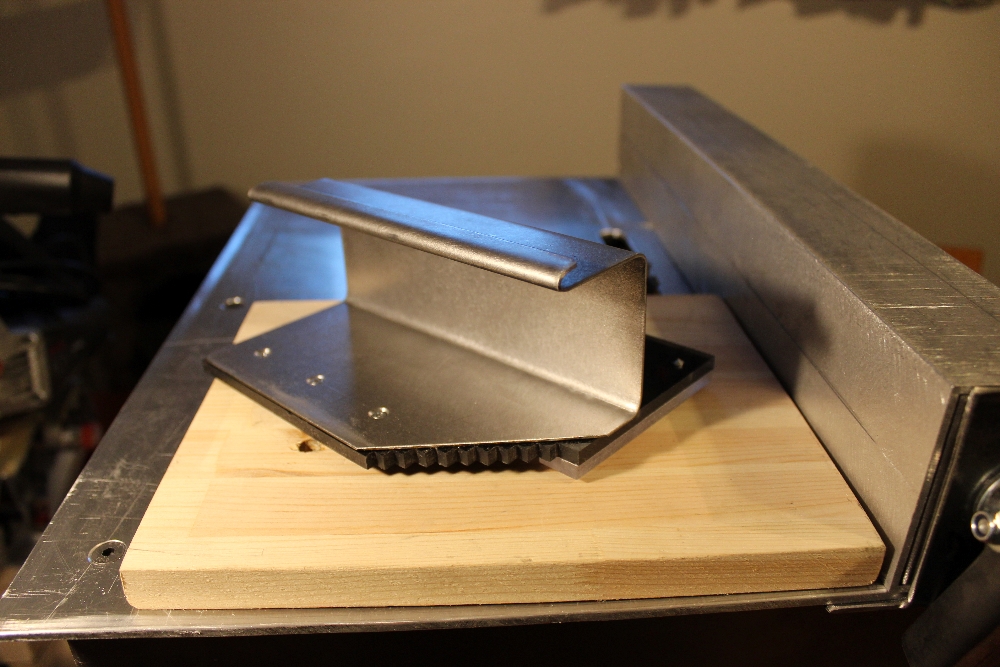

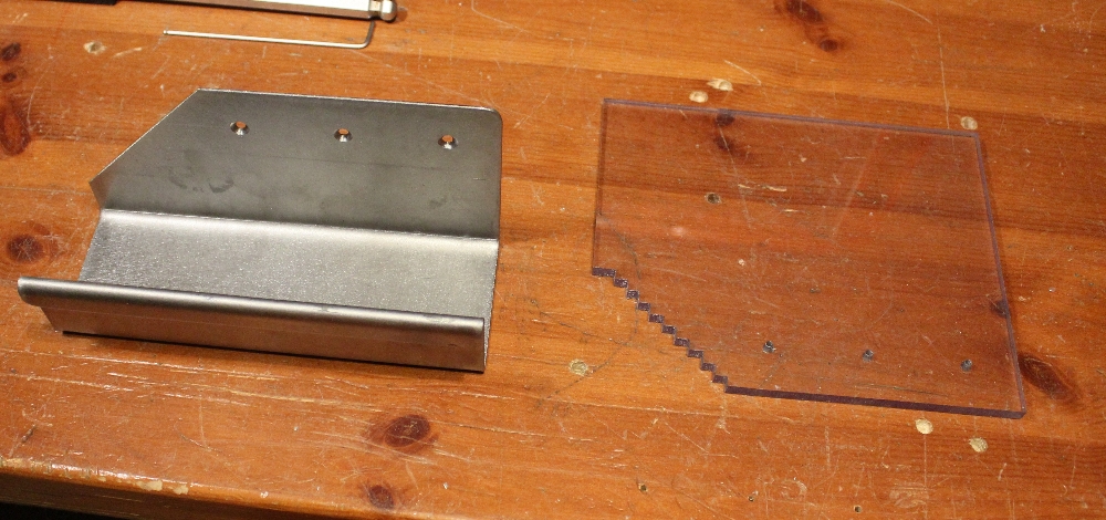

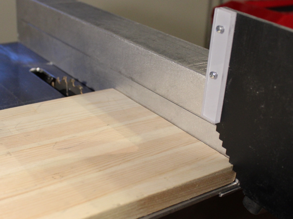

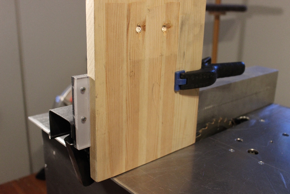

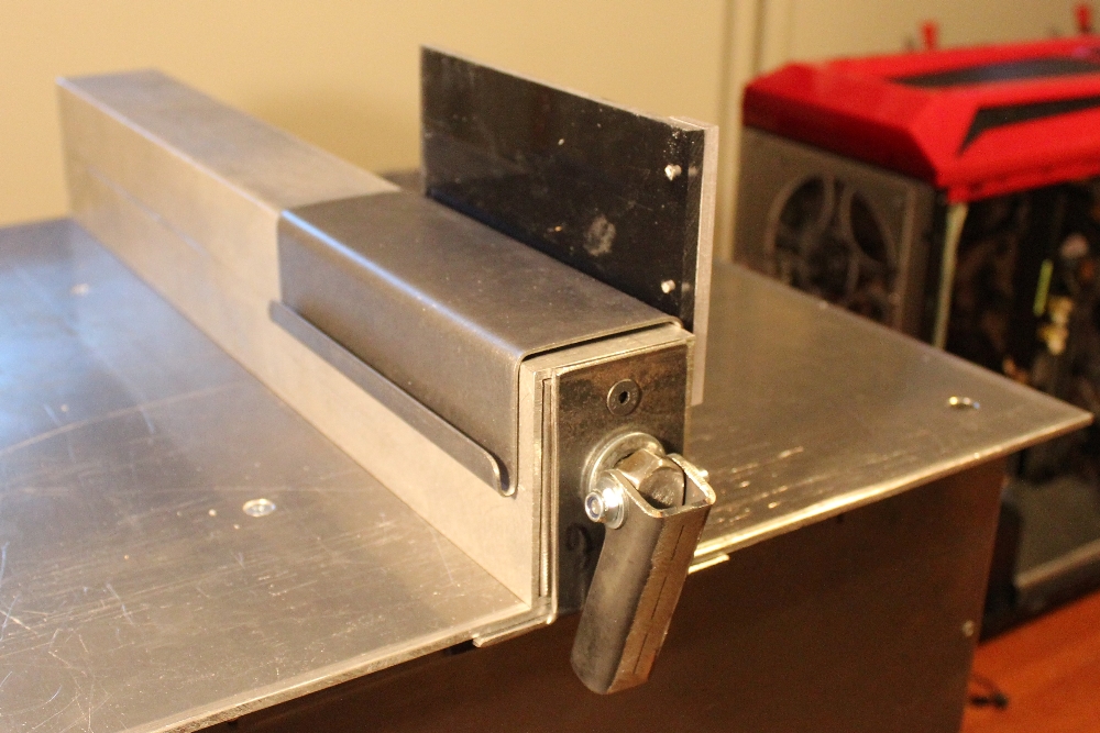

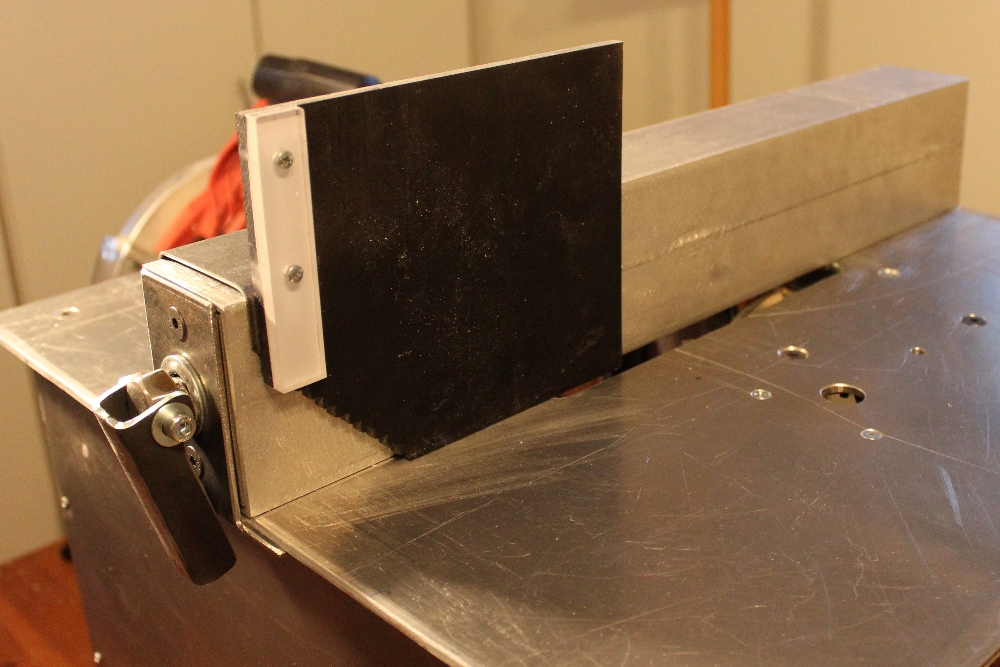

Hi
I made this simple push block to my table saw.
Material is steel and polycarbonate.
I think the idea can be seen from the pictures.

What a fine idea Toumas! I like that it's close to the fence and slides on the fence itself. What increments did you make your steps in the acrylic? They look to be about 1/4" (6mm)?? Thanks, Nice add on to your fine saw build! ~PJ
