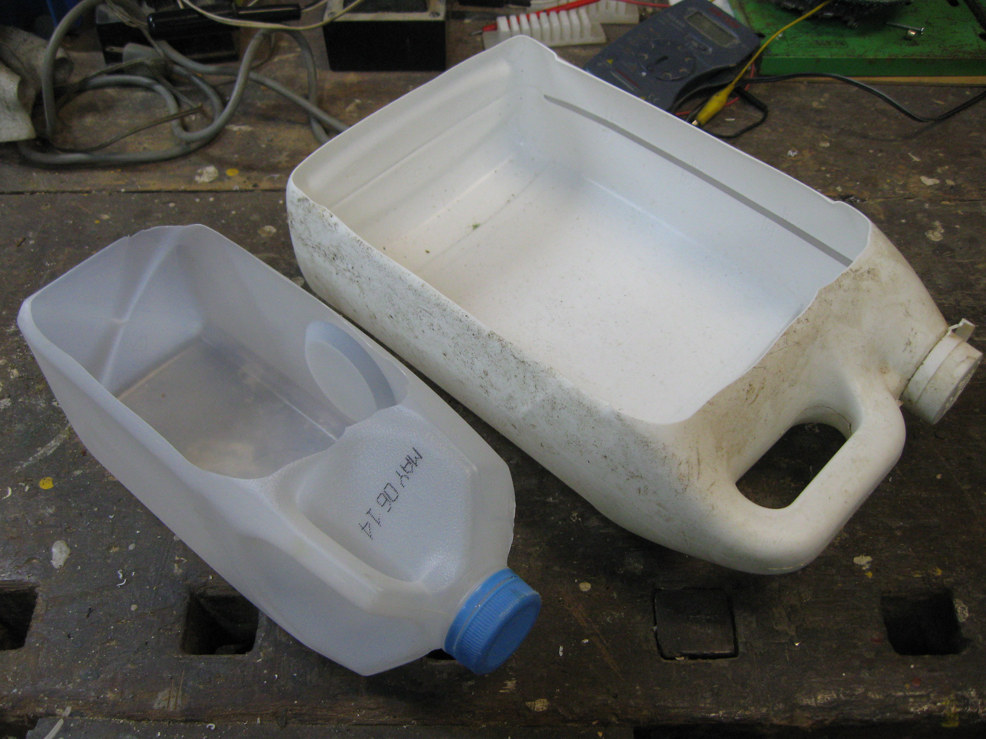

Hi Gang: For half gallon and full gallon drawers I use milk jugs and anti-freeze jugs:
Attachment 49791Attachment 49792

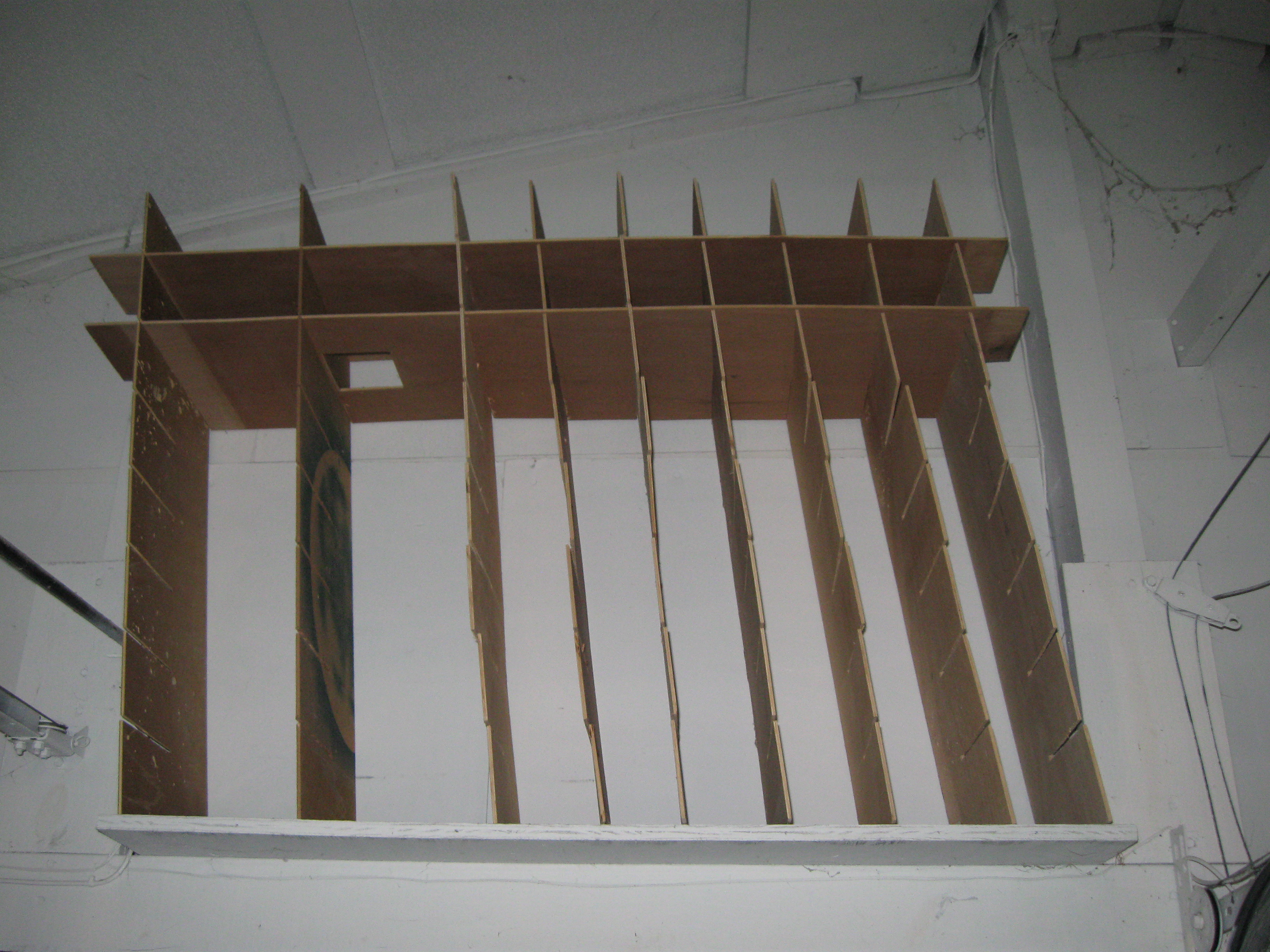

I make the shelves with slots, but have never needed glue. Fairly quick to make overall. Some shelves I've had over 40 years. Replacement drawers are easy too.
Good luck and be safe. Carl.
