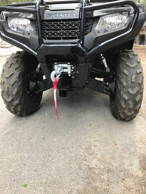

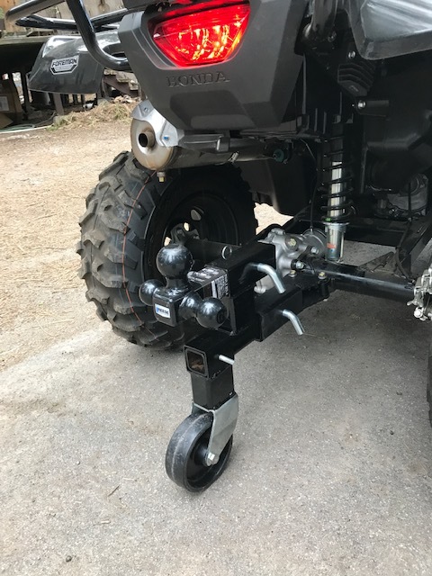

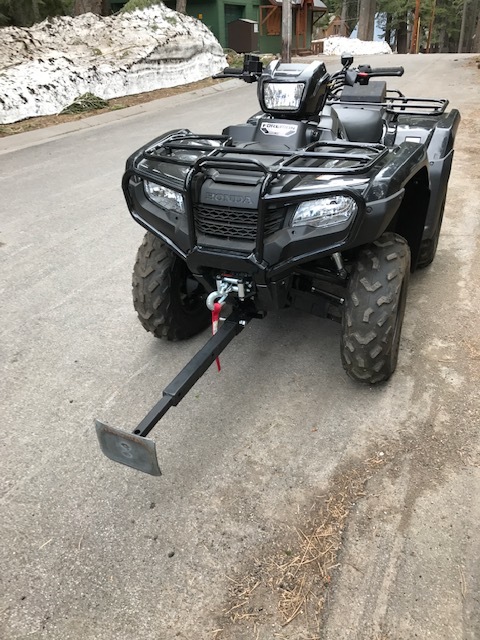

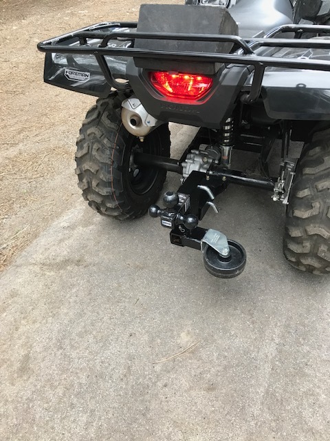

I have a client that has several boats and one trailer. He has a drive through boat house with a beam down the middle and two three ton hoists. The trailer can handle a boat up to 33 feet. The boats are lifted off the trailer and put on carts. To move the trailer around without using the Suburban or the crew cab pickup we use a Honda Quad. With a boat on the trailer the tongue weight is more than the quad can handle so I built a hitch extension with a wheel to keep the front wheels on the ground. I also added a pusher to the front to move the carts...
