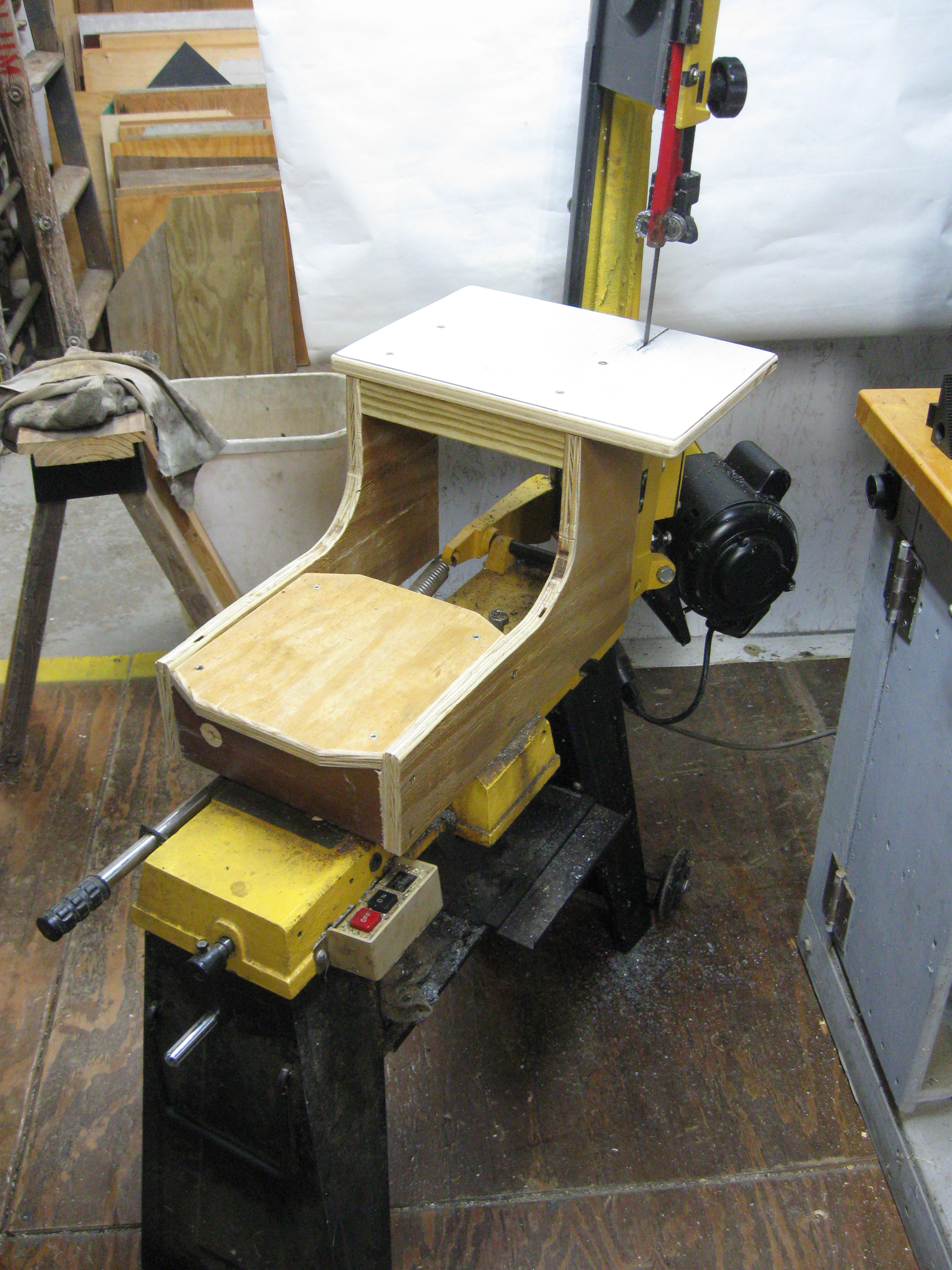

    G'day tool users, well I finally got equipped with a bandsaw. I think people are sick of watching my hacksaw antics, hehe. I searched the net for ideas for a quick change table but didn't find any so figured out my own, enjoy
    Regards stevoh

    I like it.
    The slit in the deck of my bandsaw leads the blade. It's a pain. Burrs off of material catch and stop the material being able to be pushed through. A trailing slit from the blade would solve this.

    Hi Gang:
    Here is the table I made for my bandsaw:
    https://www.instructables.com/Vertical-Bandsaw-Table/
    The bandsaw vise clamps it, so it is quick to set up.
    Carl.
