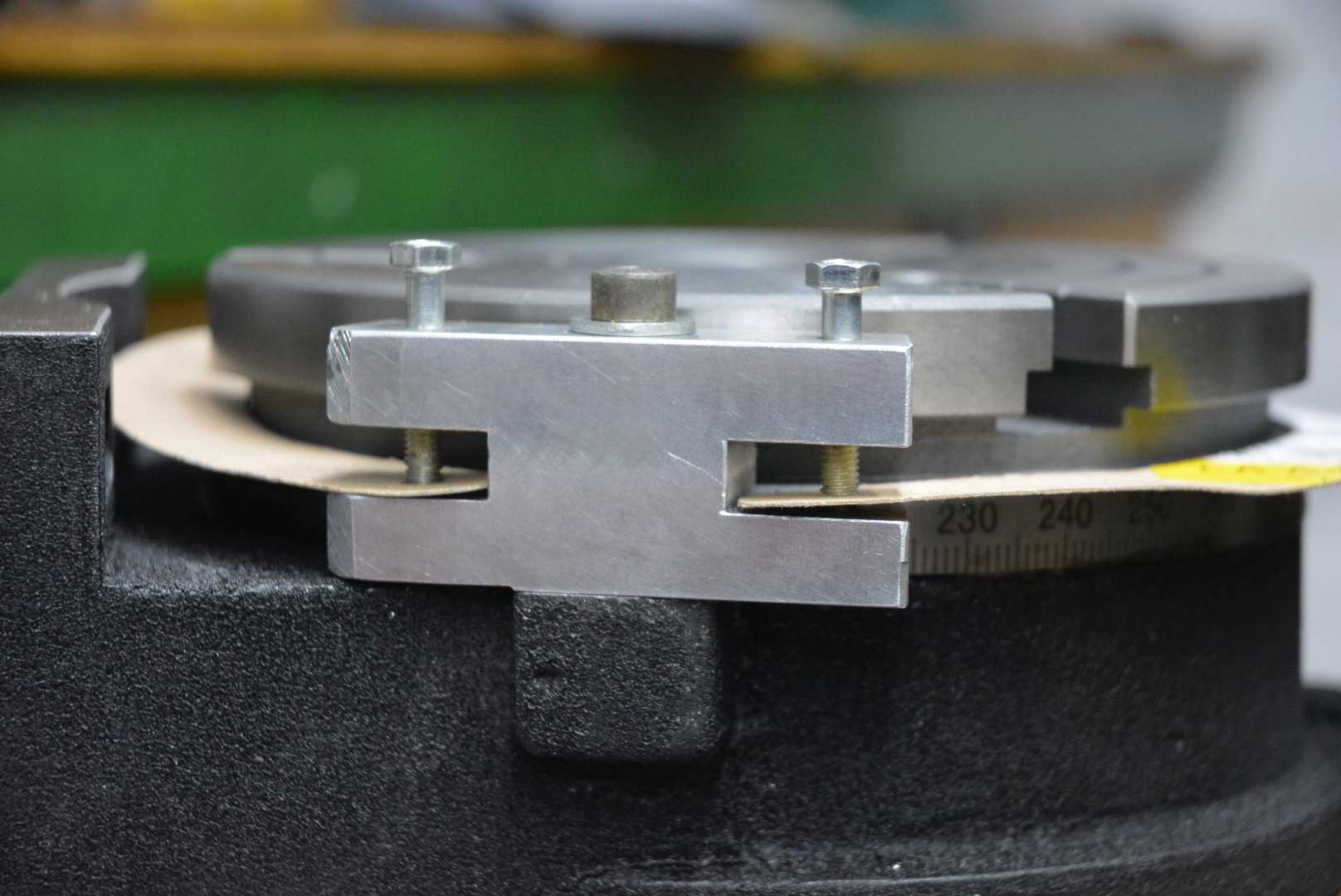

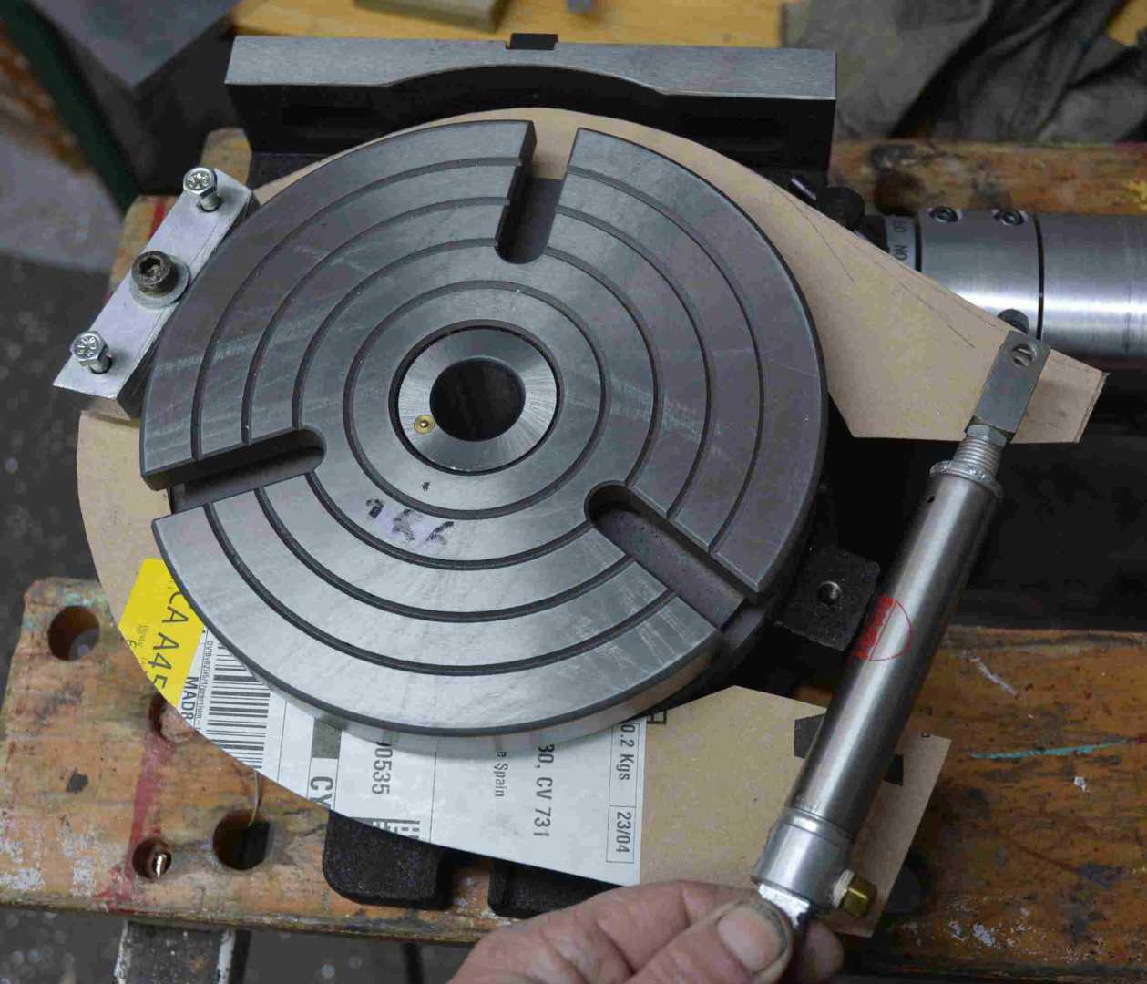

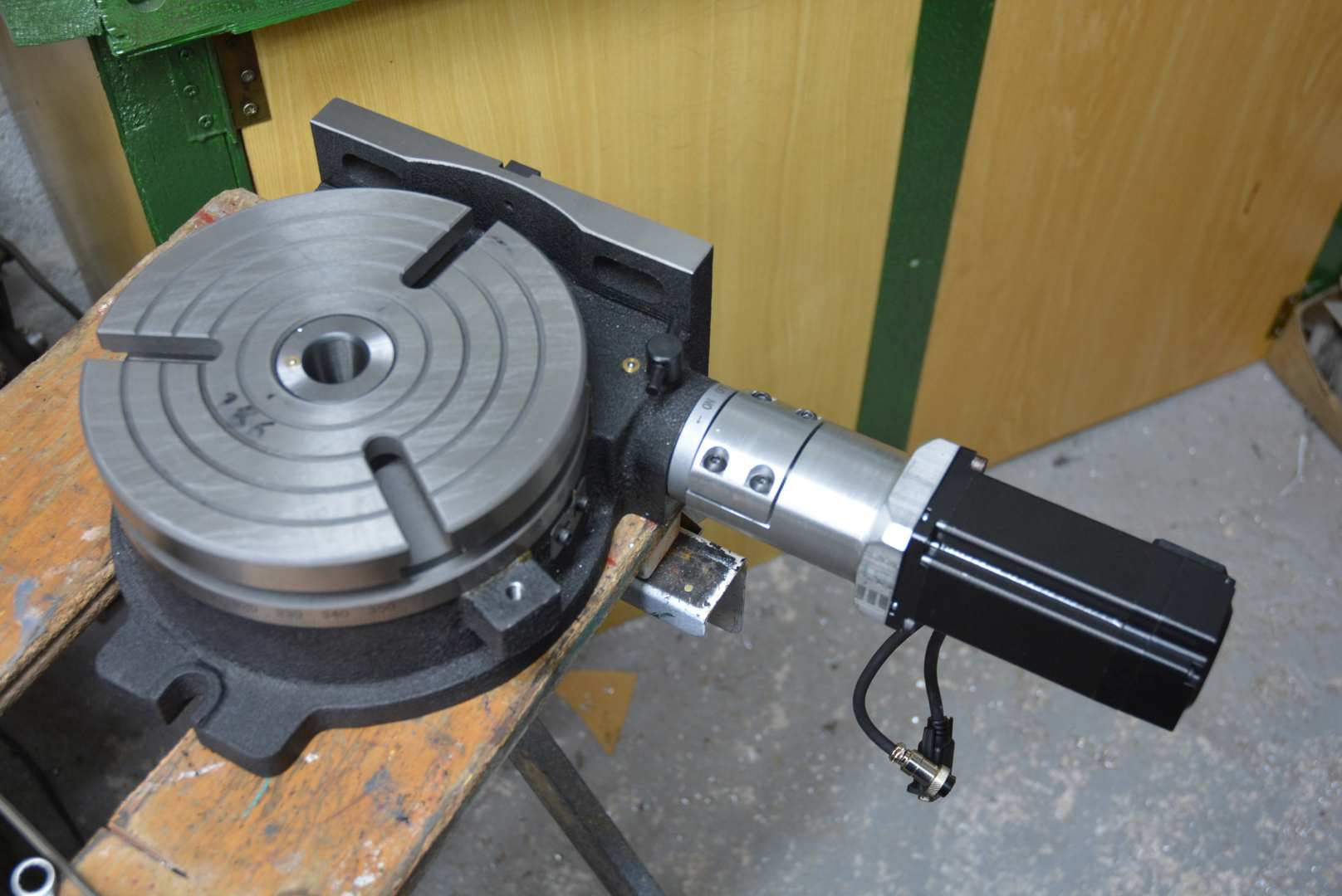

I recently bought a 200 mm rotary table to fit up with a motor as a 4th axis on my CNC mill. I wanted to largely automate making clutch centres with my pneumatic slotter previously posted here https://www.homemadetools.net/forum/...709#post182779 , and also as a camshaft holding and rotating headstock for a planned CNC cam grinding machine.
Attachment 44747 Click images for full size.

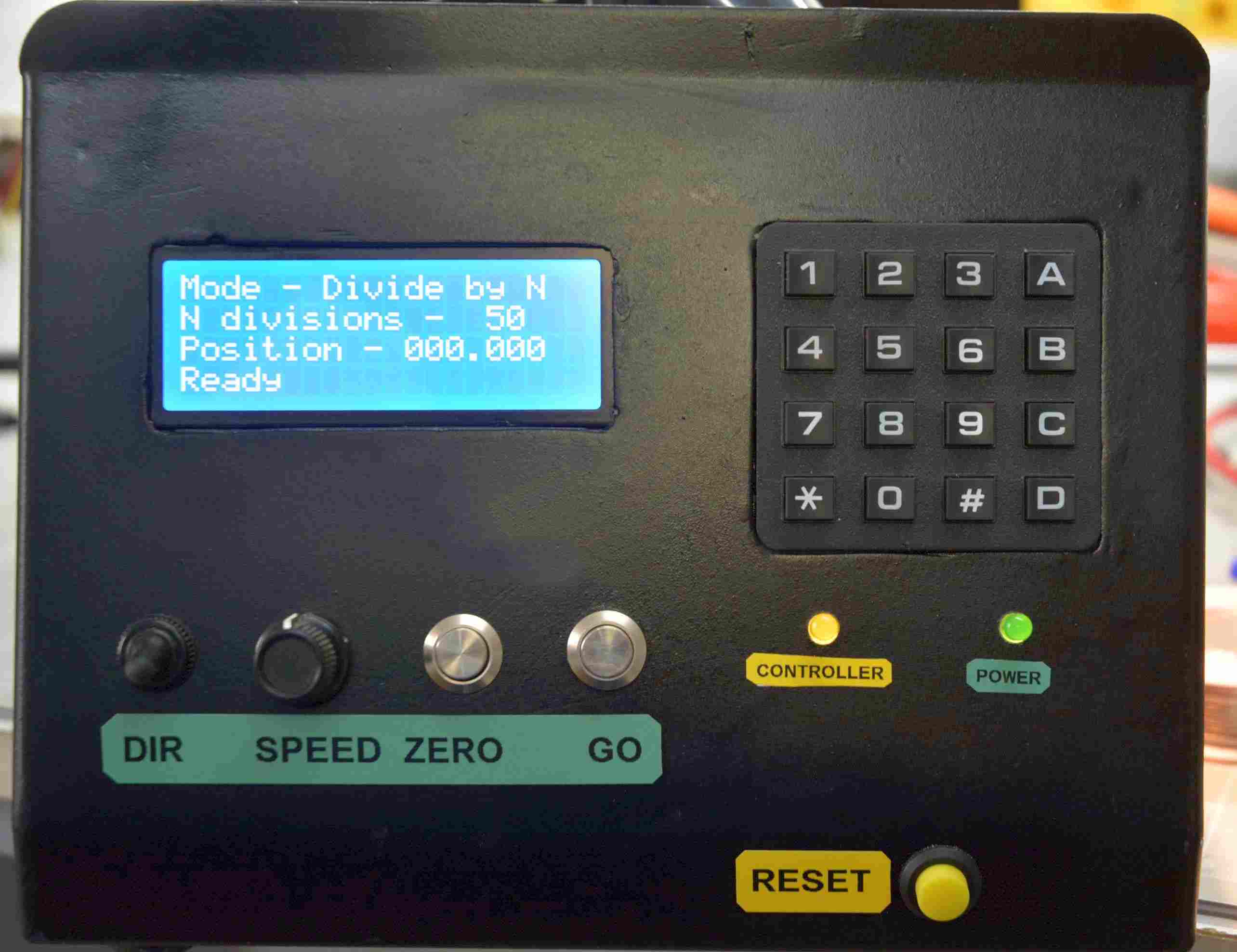

In addition to being purely CNC driven I wanted to have a manual control with some useful automatic features. So I built a suitable control box with three operational modes. Viz:
1. Jogging. The table rotates as long as I hold a button down. Speed is variable between dead slow to plenty fast enough.
2. Indexing. I enter a number of divisions in a circle and each time I press the GO button it indexes around to the next division.
3. Go To. I enter an angle and press GO. It then moves to the angle at the set speed.
Attachment 44748

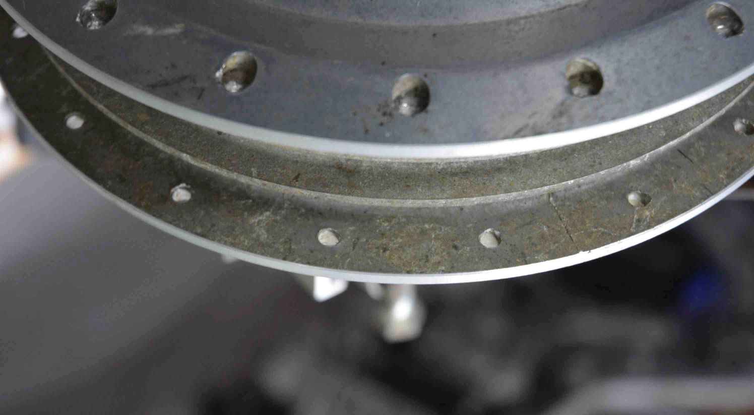

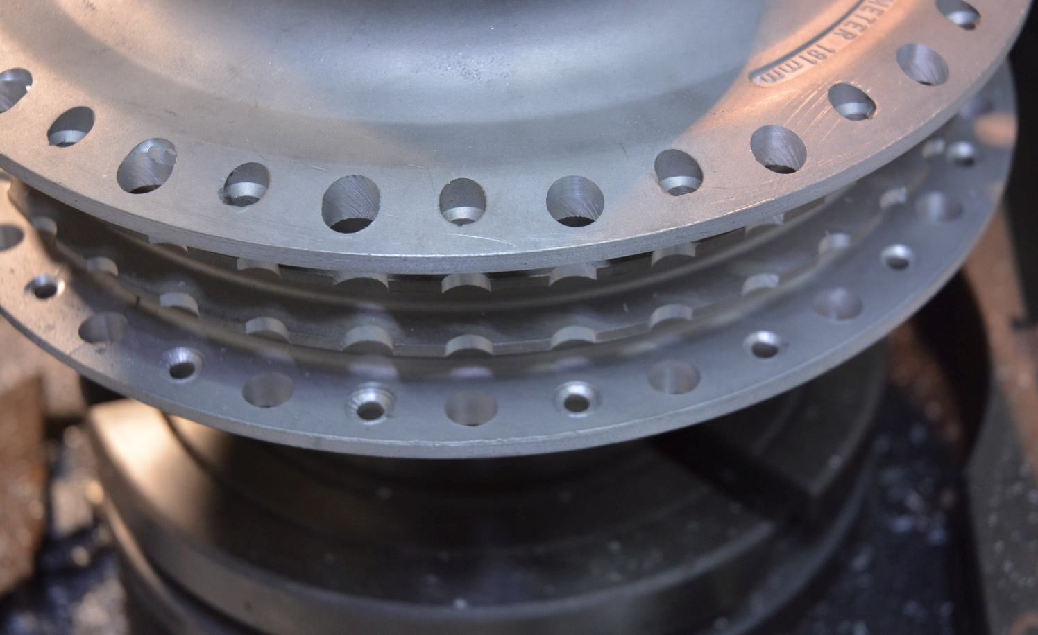

A couple of days back I needed to do some indexed milling and drilling on some motorcycle brake hubs for my race bike. This was the first job for the device and it was a great time saver. These are the BEFORE and AFTER pix.
Attachment 44749 Attachment 44750
