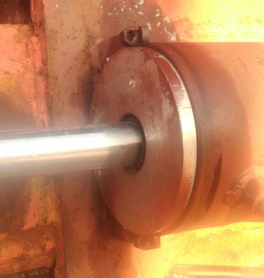

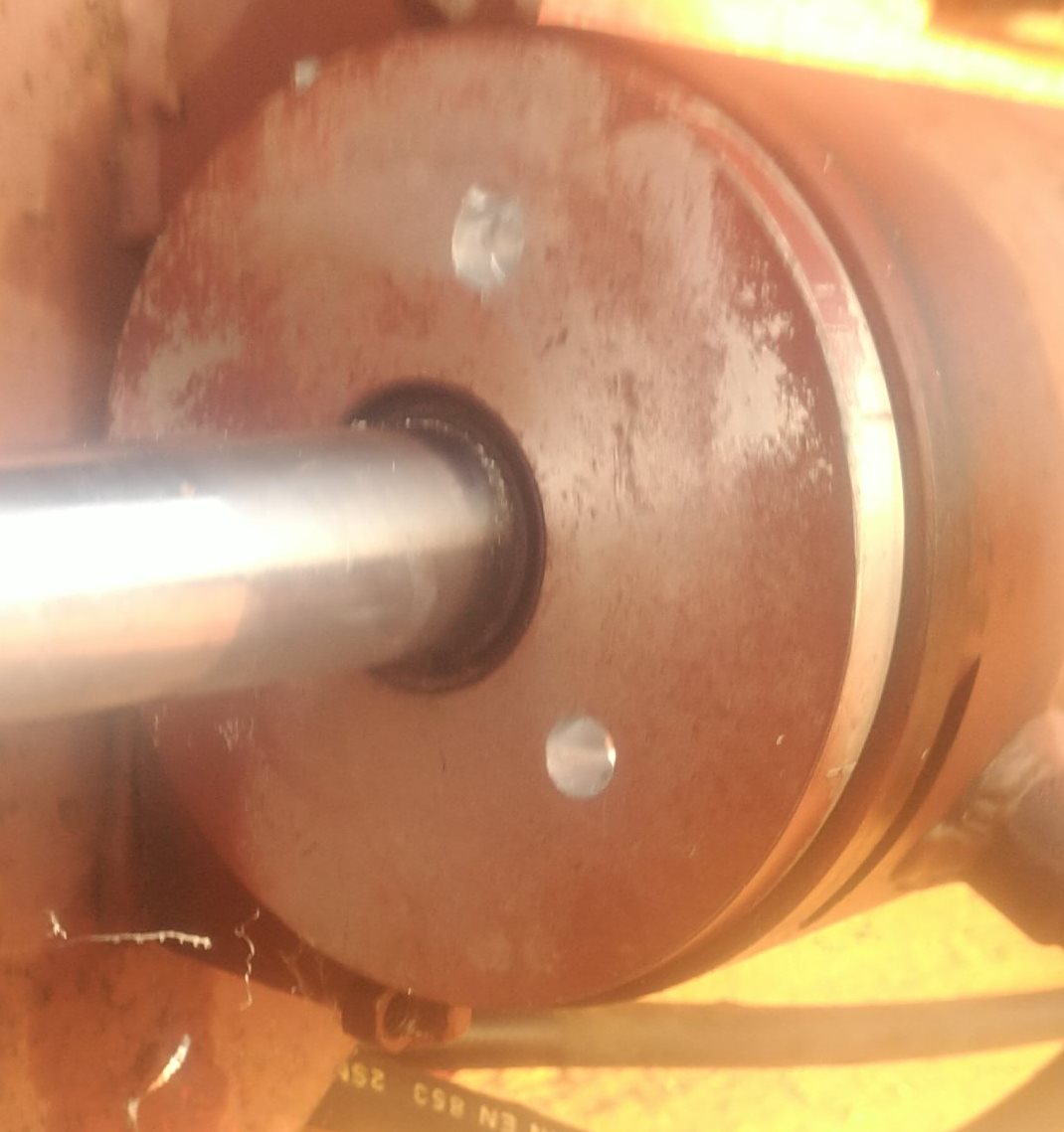

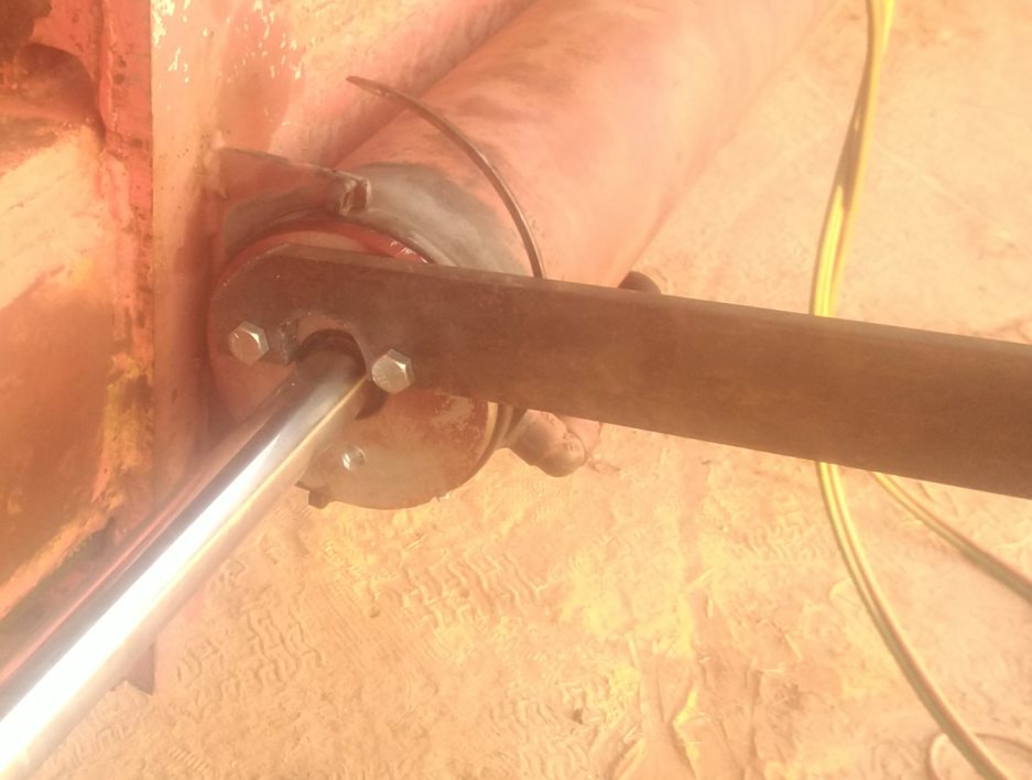

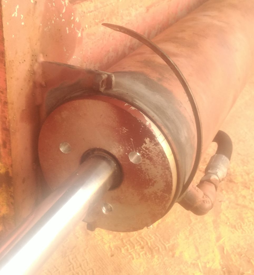

I have a hyd cylinder on my brick crane that needs rebuilding the only thing is the gland was not made with spanner holes so there was no good way to remove it. I drilled 3 1/2" holes 3/4" deep then notched and drilled 2 1/2inch holes in a piece of 1/2 x 3 flat bar
