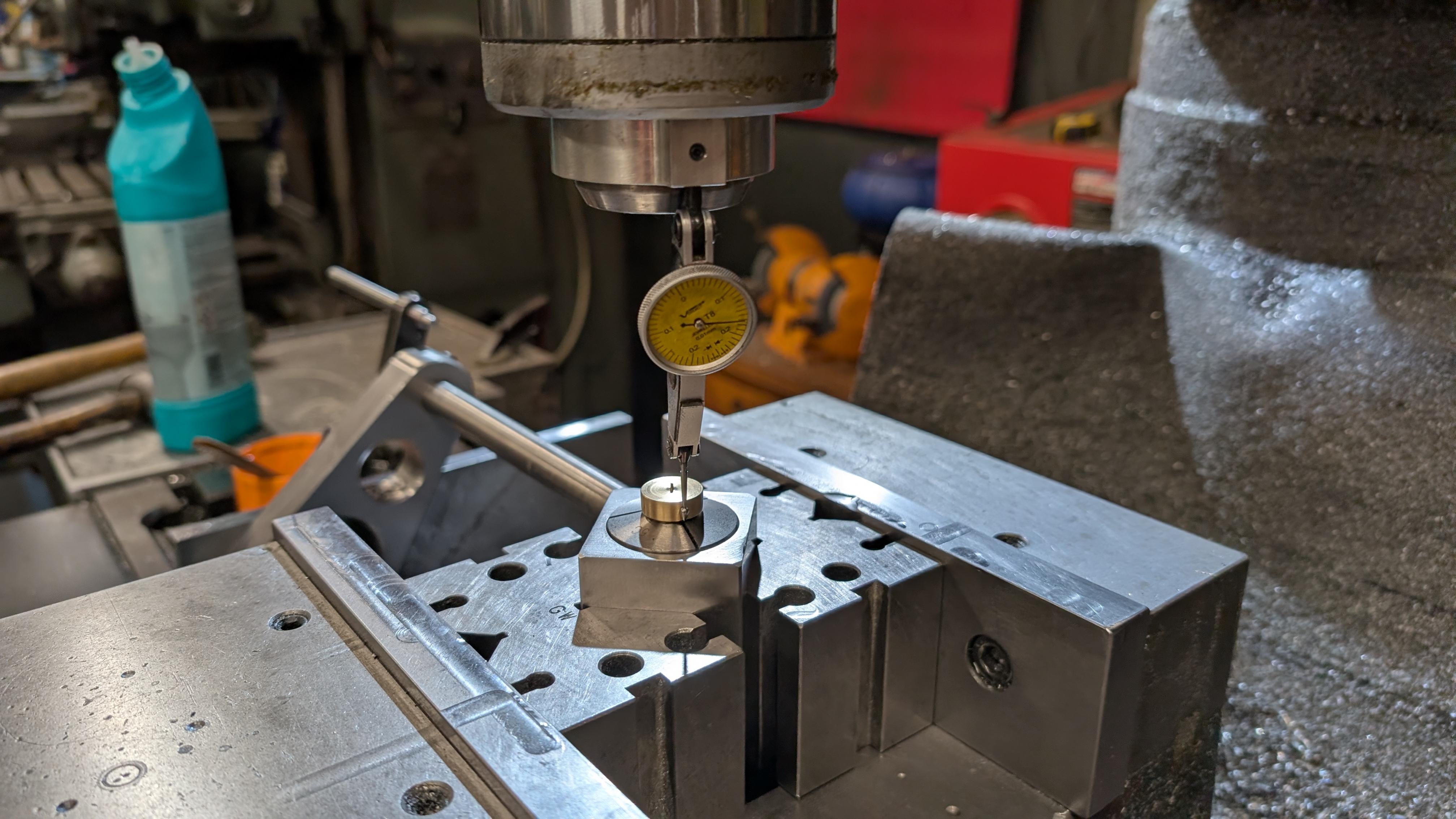

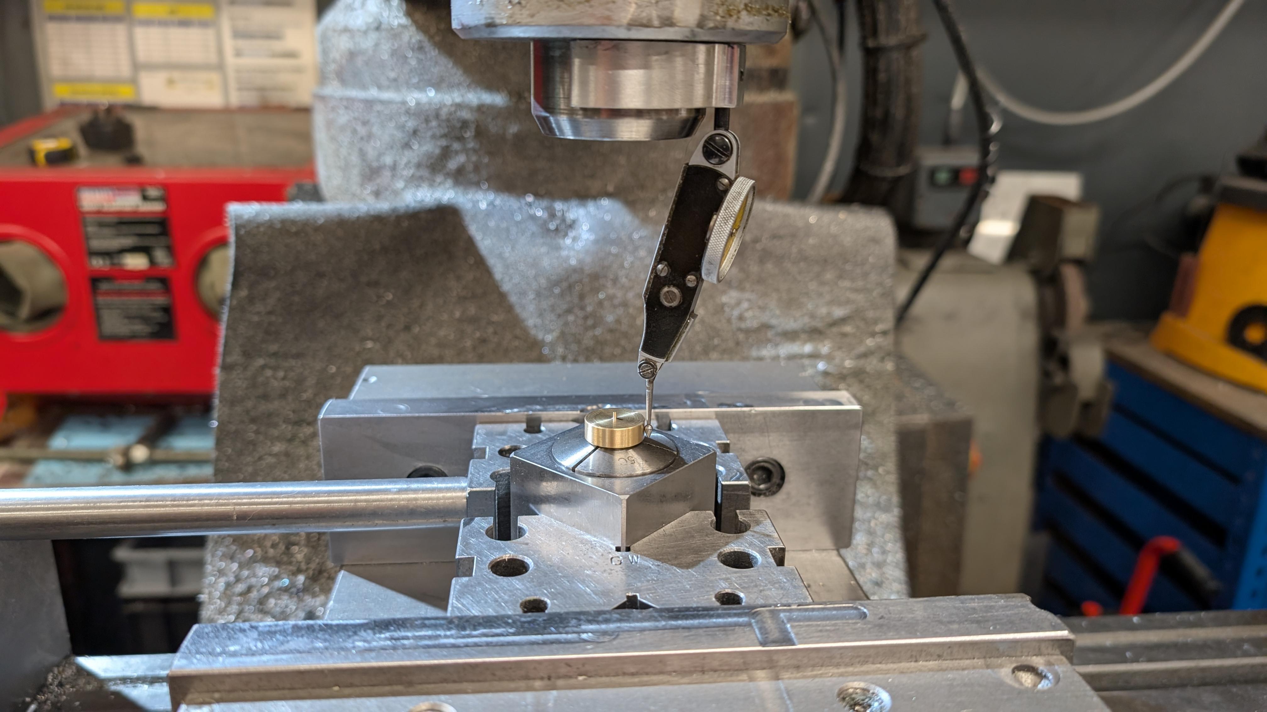

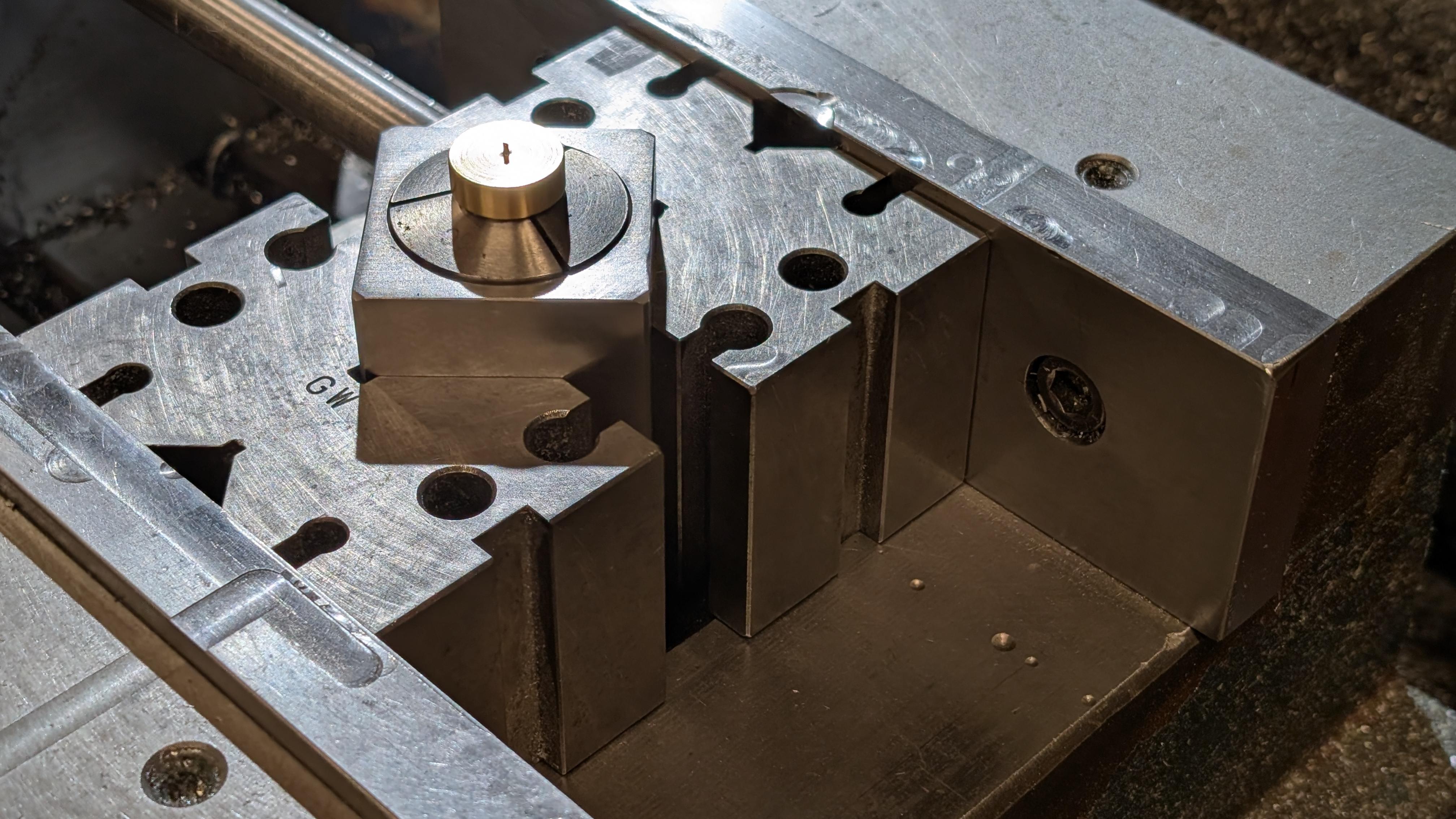

The base of this 5C collet block has a nut that is not accurate enough to sit the block upright, so I used Vee blocks to square up all 4 faces.

Here is a similar set of tips showing how to locate the loaded block on it's end plus a dedicated end stop to locate a hex block.
