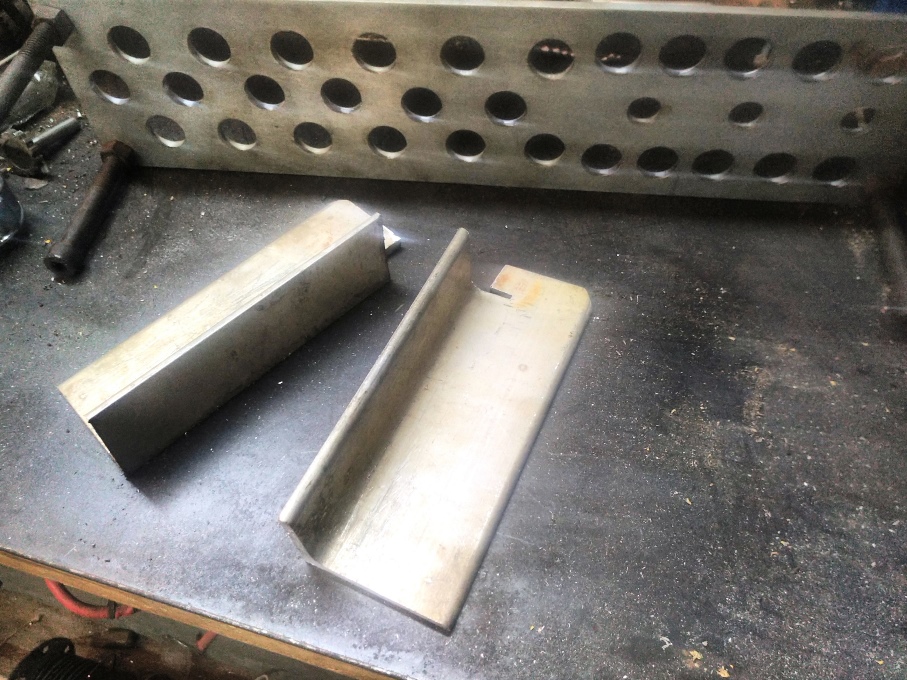

This is what I did, First I cut a pair of angle pieces out of aluminum and notched them to fit in the "E" track slots on the wall
then drilled and tapped through the heads of the 1/2" socket head bolts to 5/16"-18 TPI.

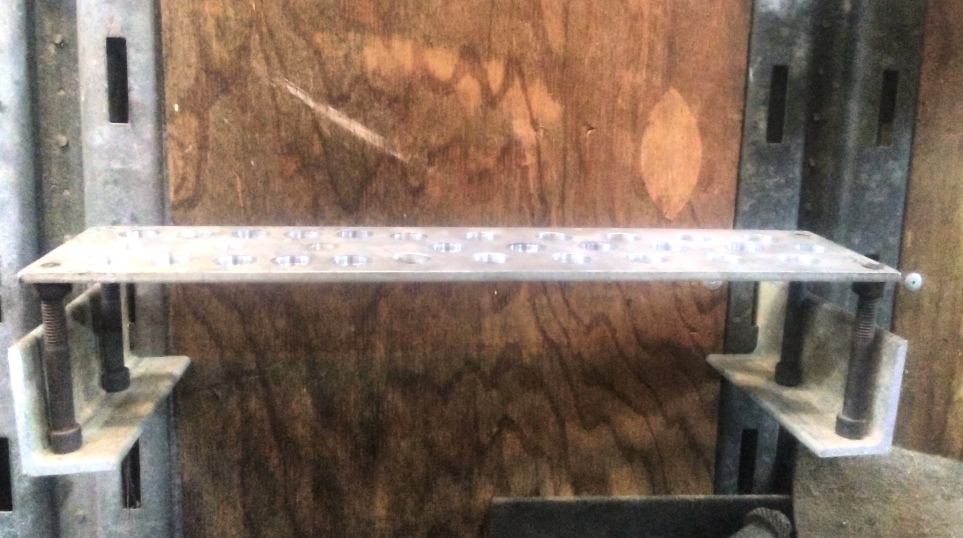

then just a simple slapping it on the wall was all that was required
Attachment 45645
Attachment 45646

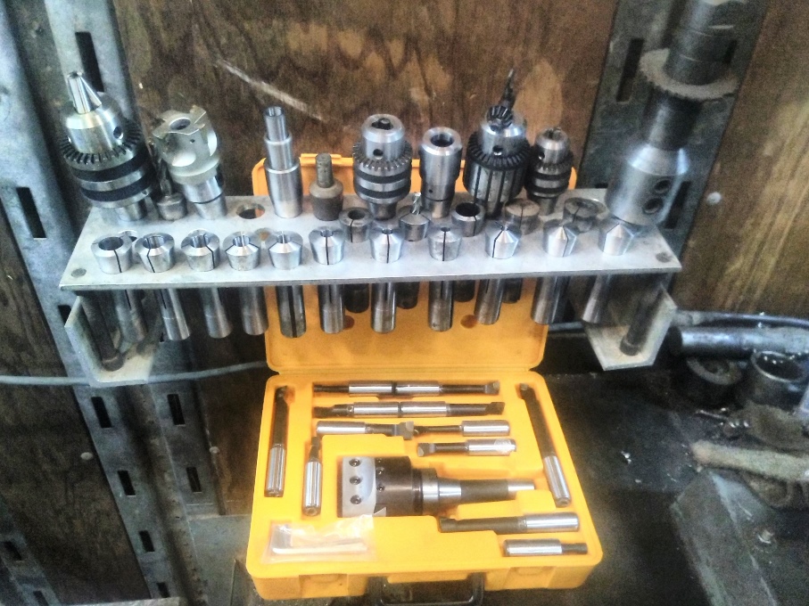

nice and orderly but obviously the boring head kit will not find this as a permanent parking place, it is only there for display purposes.
Attachment 45647
