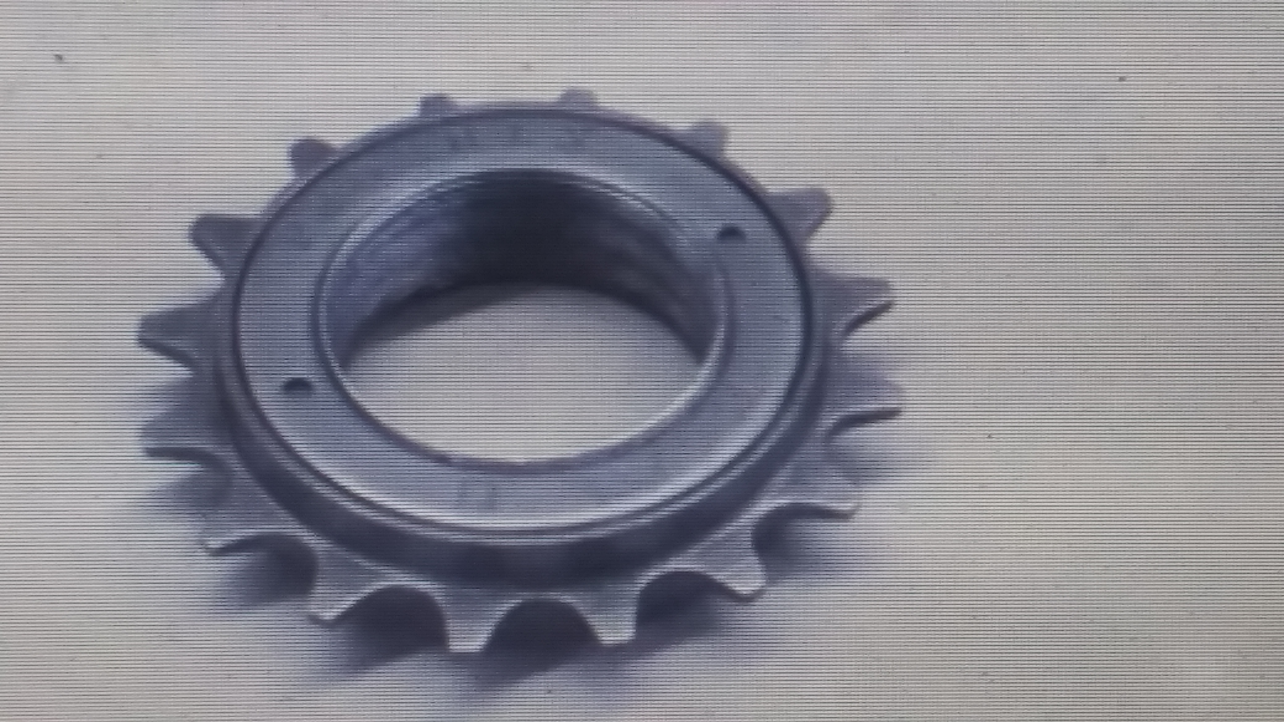

Where did he find that backstop clutch?

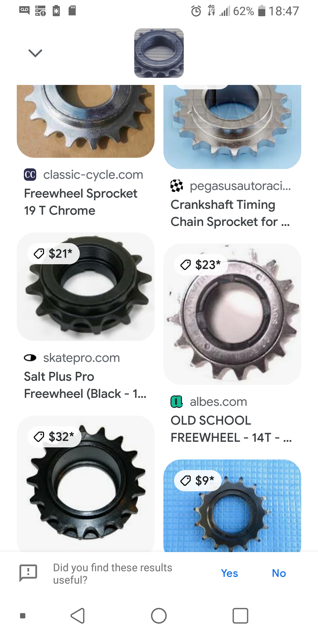

Agreed about the roller clutch, especially being tied to a drive sprocket. Suggesting to run Google Lens on a still shot of it.

Attachment 45282
Bicycle drive gear!
Attachment 45283
Admittedly, hate phone version of internet; however there are a couple compensations, to make up lack of tangible keyboard.
This time used both.
