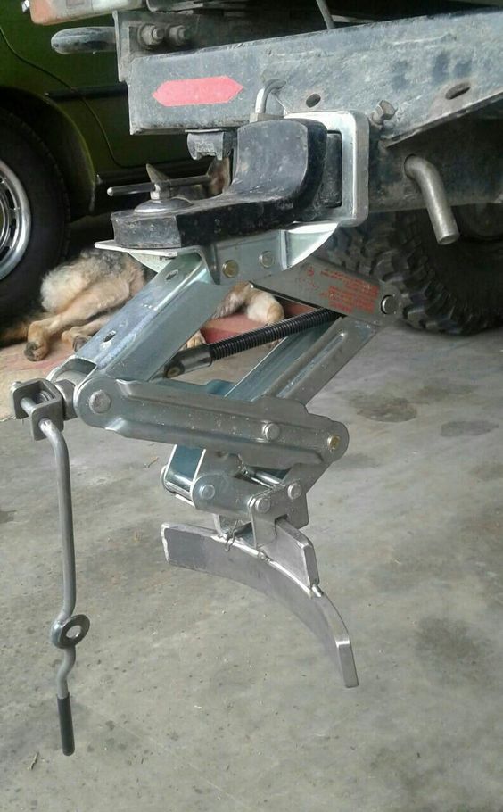

I found this in the automotive mechanic's Facebook group and thought it an excellent idea to share here. It's a car screw jack mounted on square tube to fit in a receiver hitch mount with a slightly curved blade added so you can use it as a tire bead breaker.
