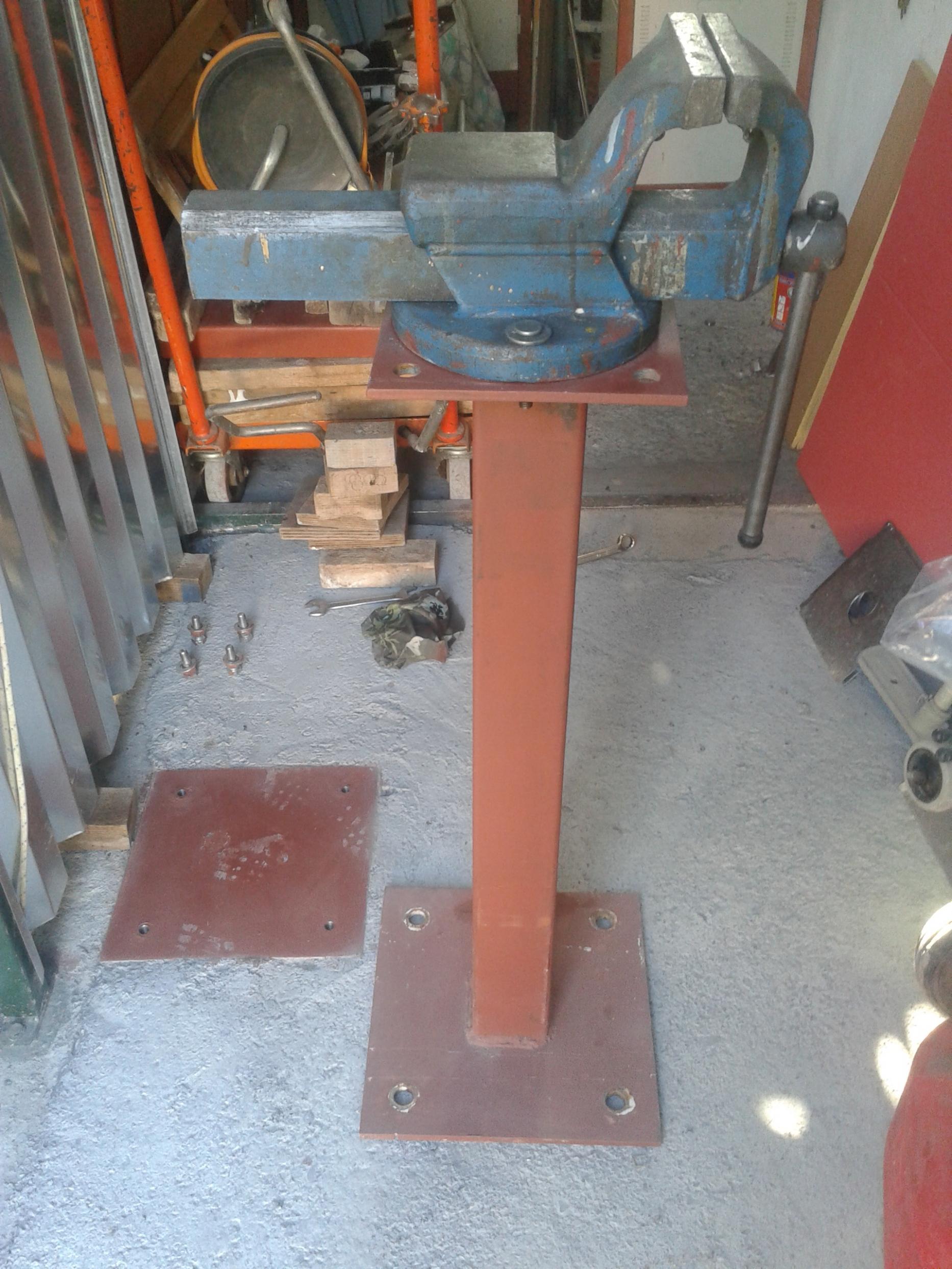

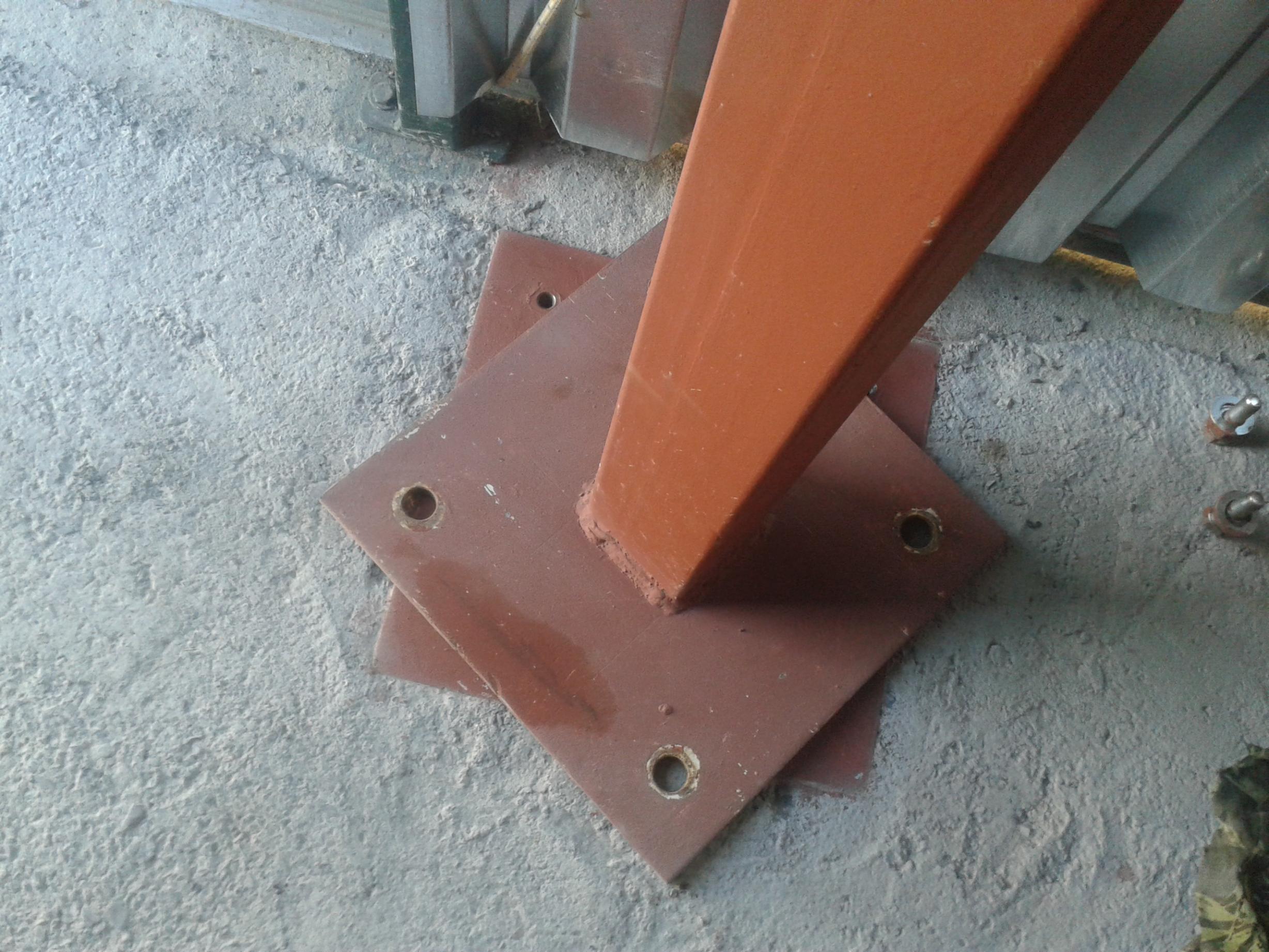

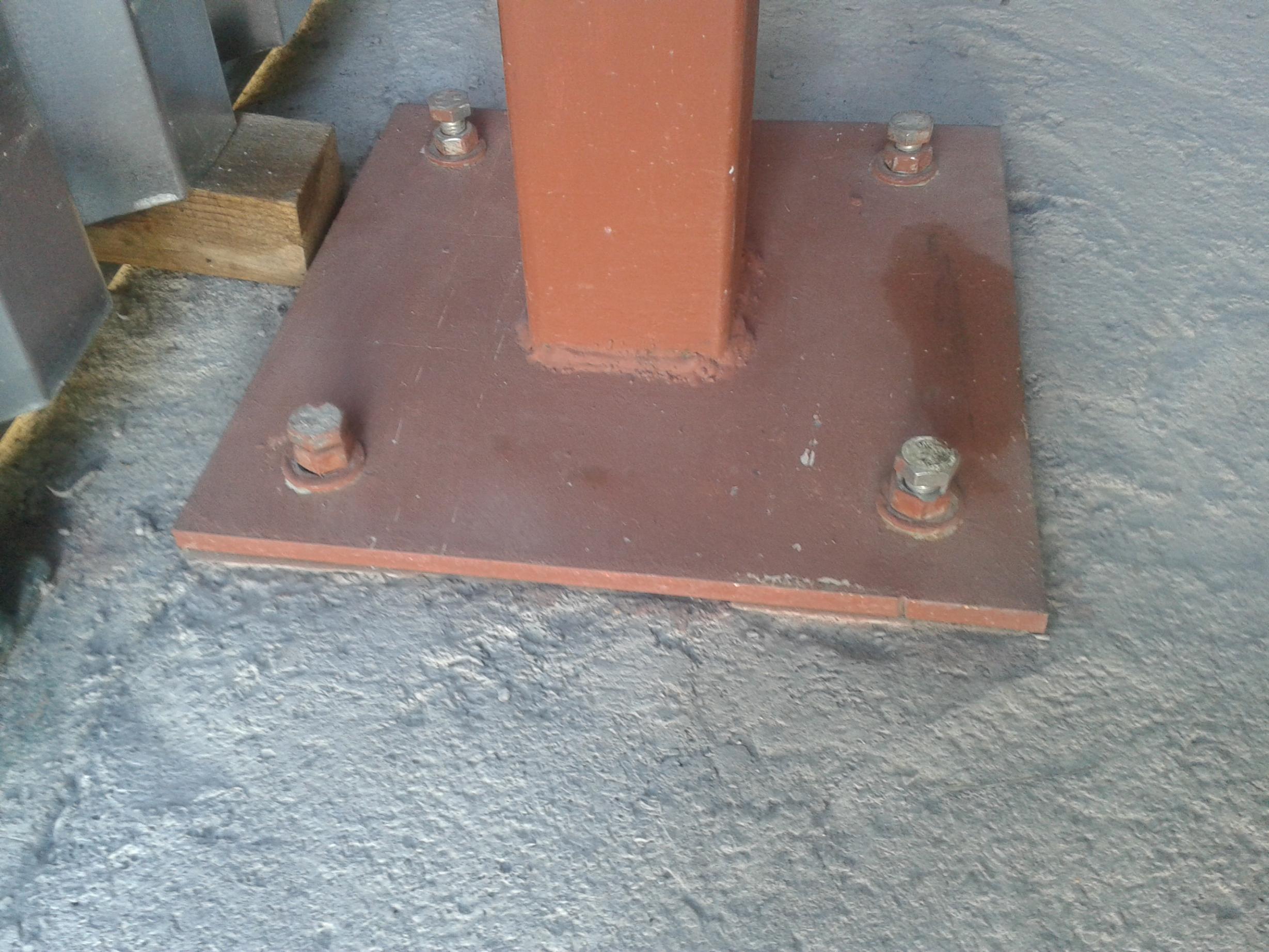

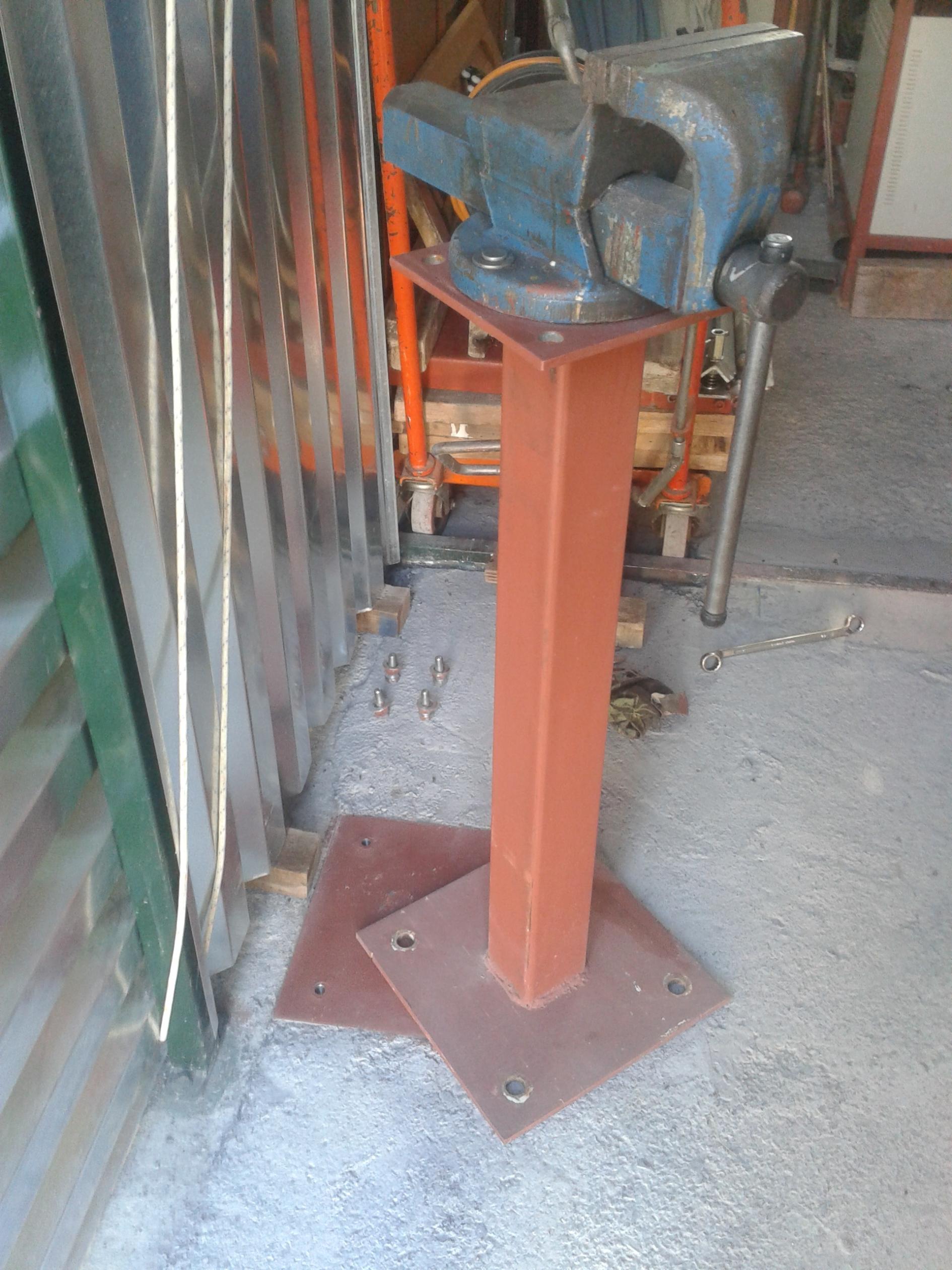

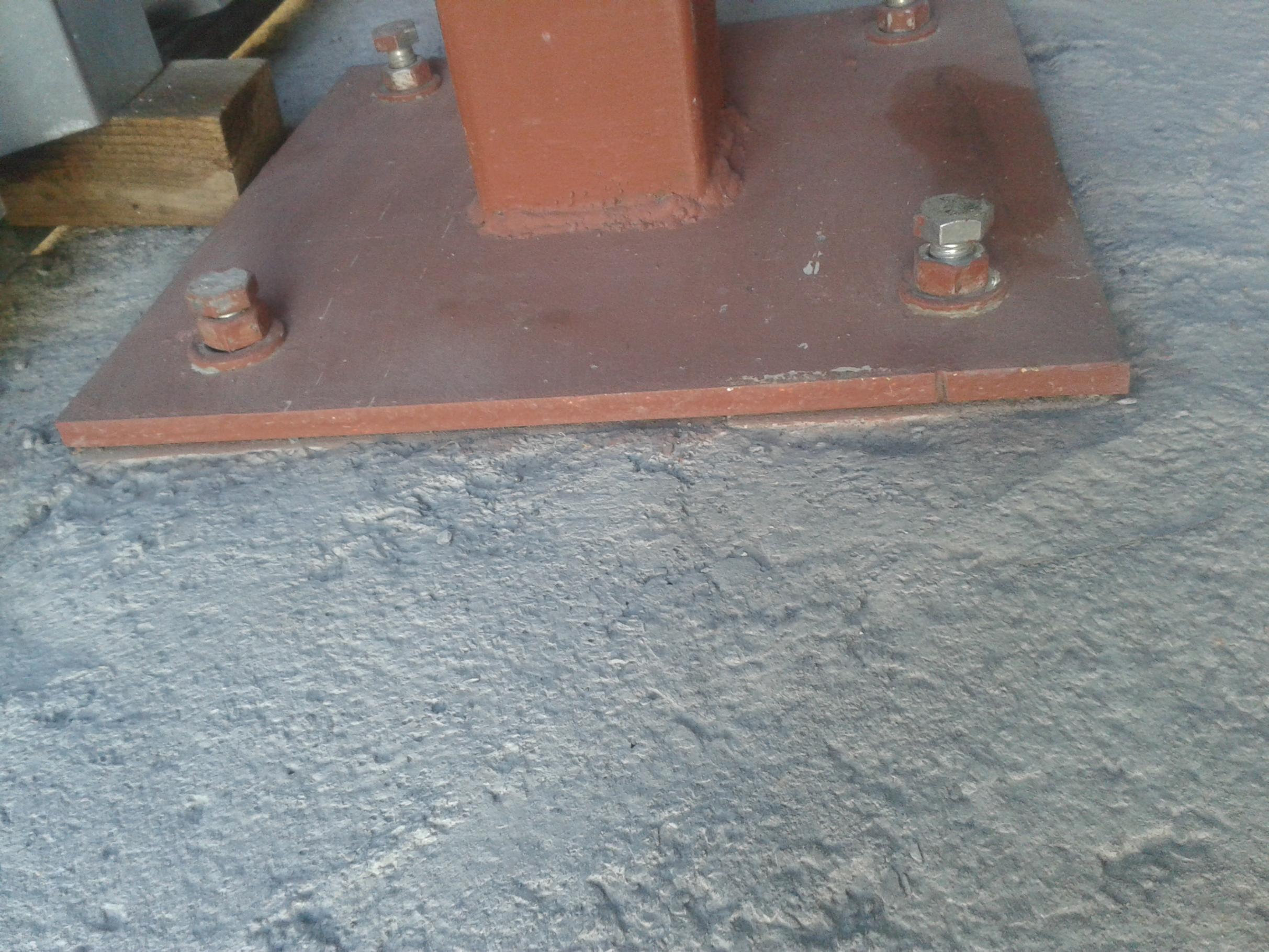

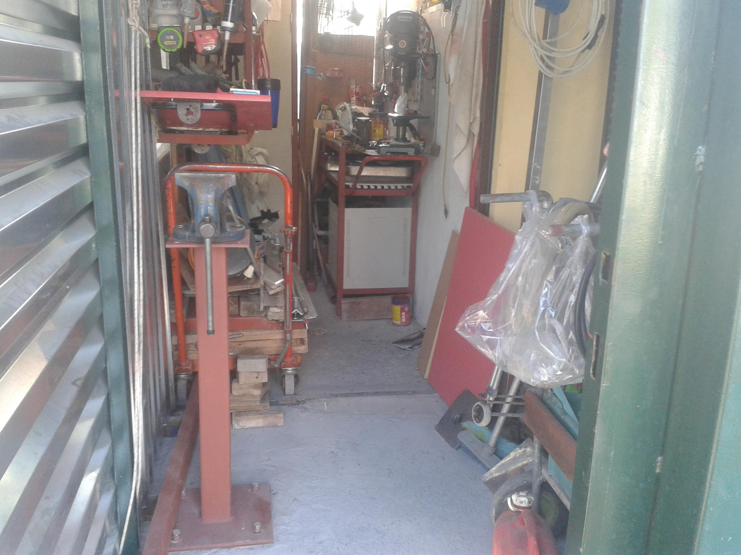

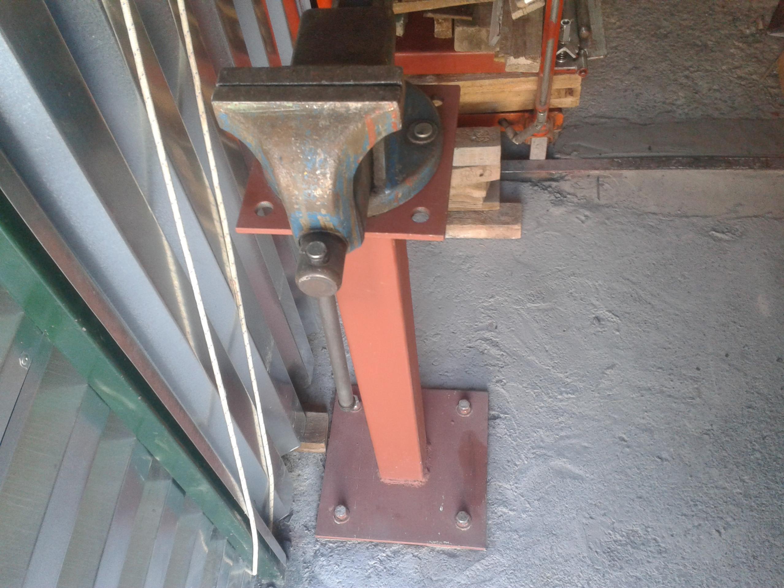

Removable pole stands vise base made it from steel plates, round bar & tube
Also can be mount at three pos left/right/front.
Materials
steel plates:.2pcs 300x300x10mm 1pcs 200x200x8mm
round bar ø18mm : 4pcs 150mm
bolts/nuts M12 4pcs
tube 80x80x3 mm 800mm
