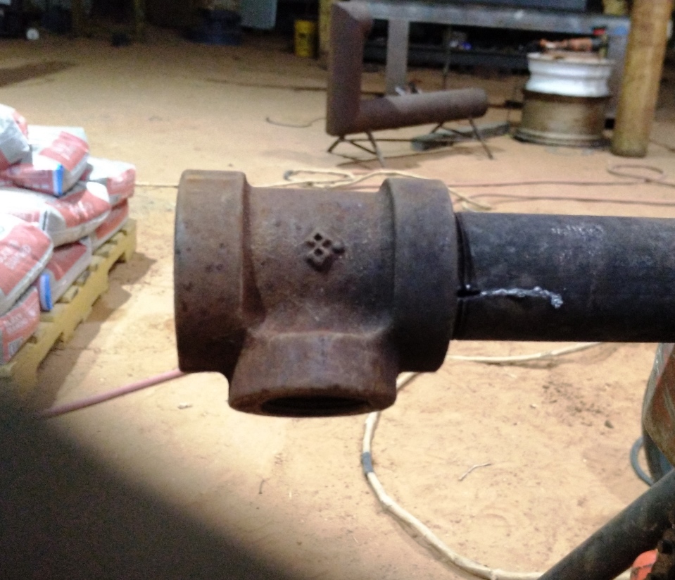

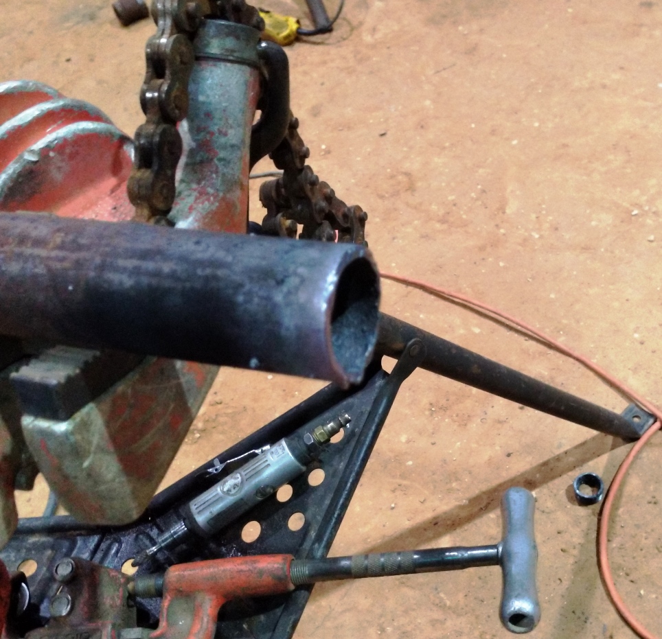

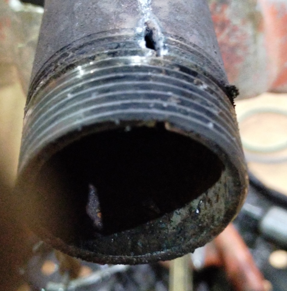

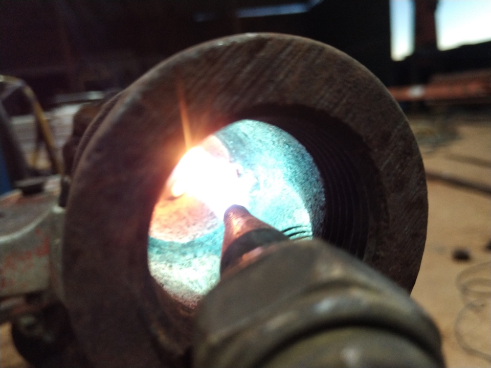

I did what I normally do in these instances, I grabbed my torch and made a small cut inside the pipe through the fitting then I could break them loose with an `8" pipe wrench and screw them off by hand
Attachment 41374
Attachment 41375
Attachment 41376
a quick touch up with a grinder and the pipe will be ready for welding
