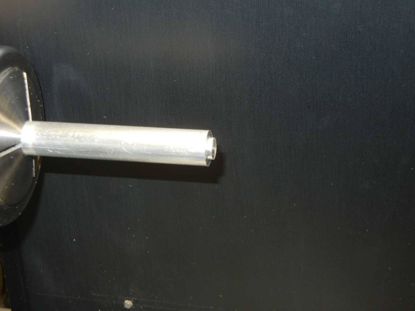

Attachment 34275
Starting with 3/8" aluminum stock, turn the end 0.236 x 0.052

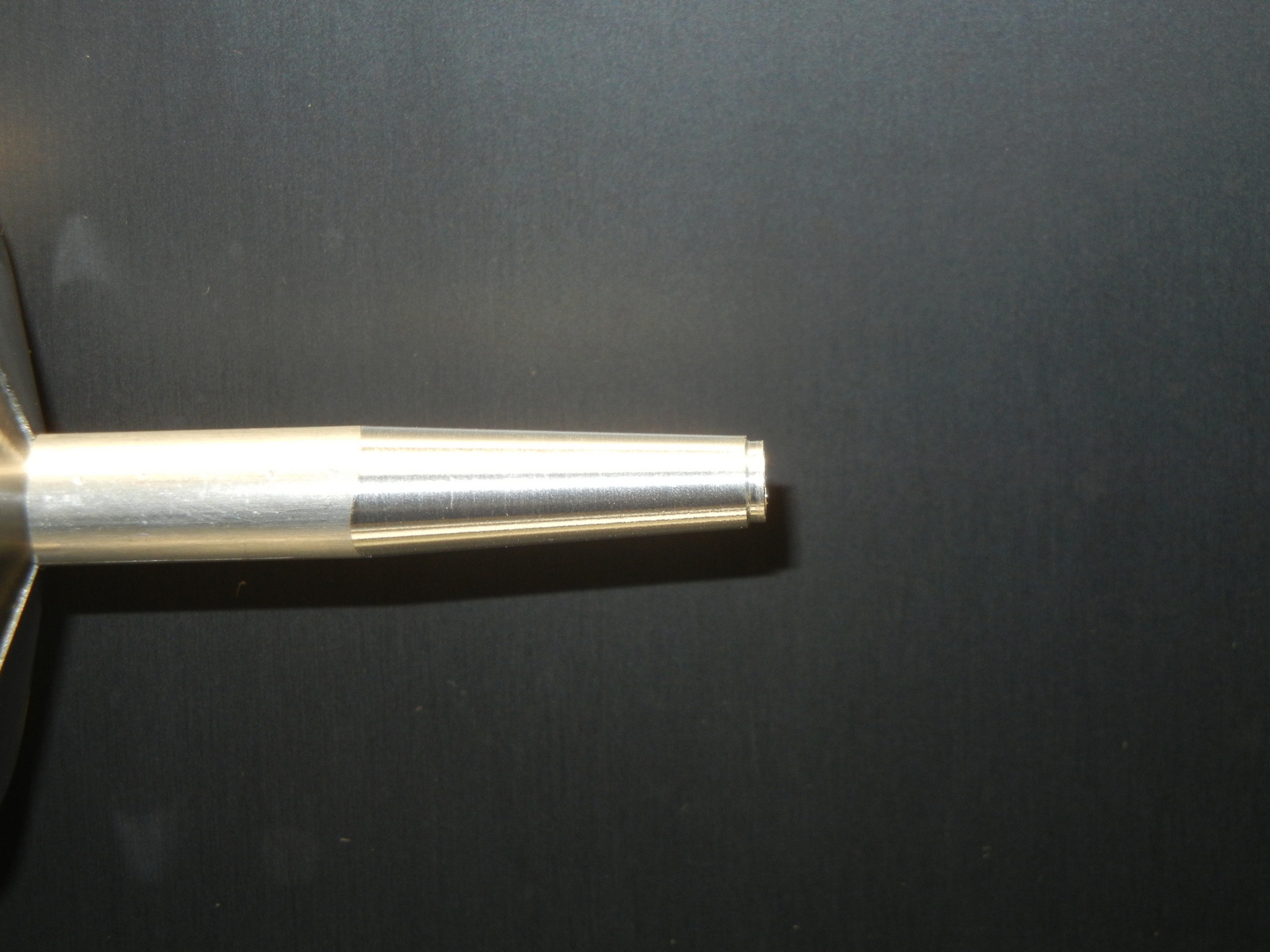

Attachment 34276
Drill a #21 bit 1" deep. Turn approx. 2 1/2 degree taper.

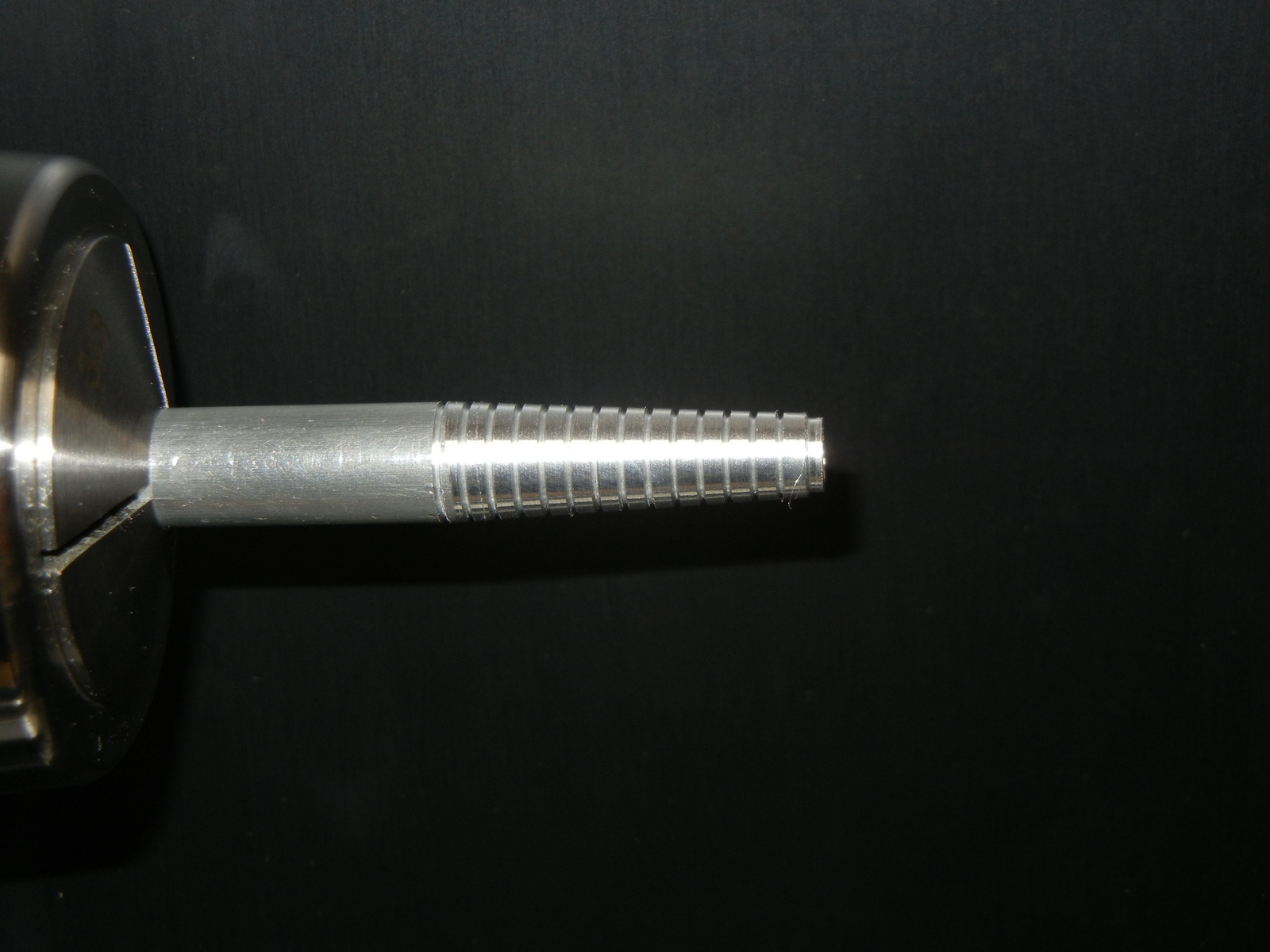

Attachment 34277
Cut grooves for a better grip or just for looks. I used a 60 degree threading tool spaced every 0.080" x 0.020" deep.

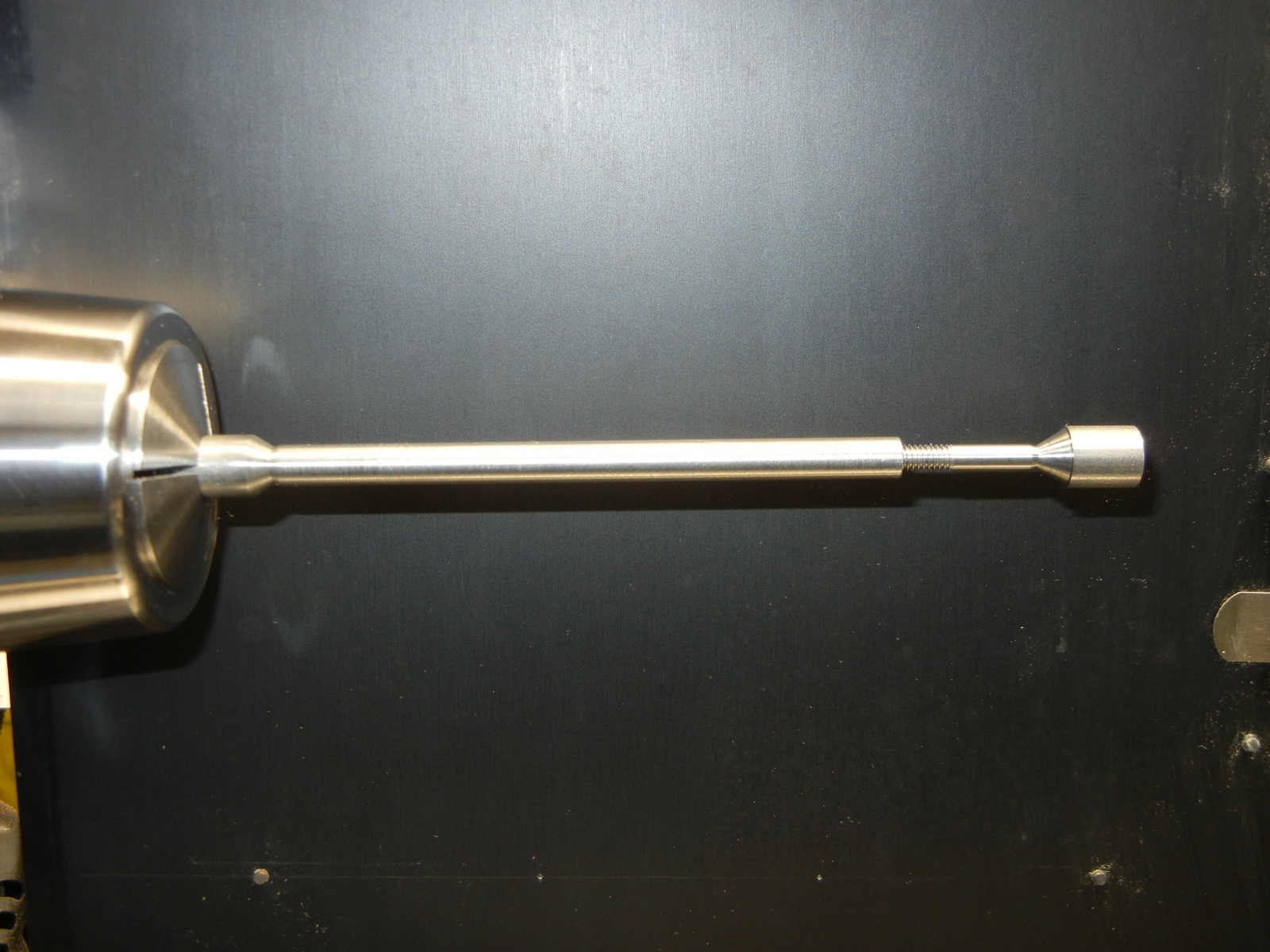

Attachment 34278
Mandrel I built from 12L14 to hold pencil sleeve while finishing the outside.

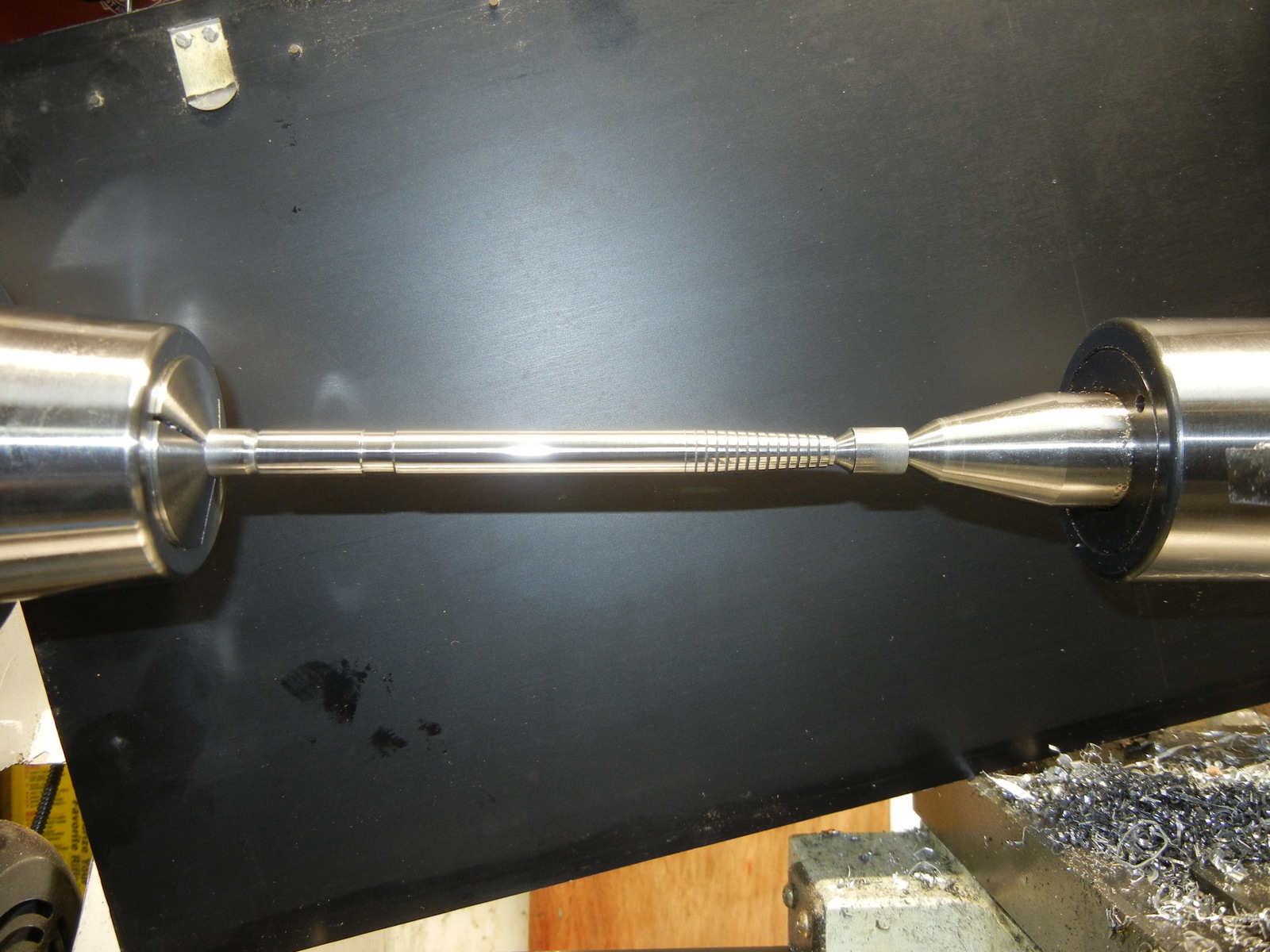

Attachment 34279
Turn down sleeve surface to 0.361 to eliminate imperfections in the surface. Turn pocket clip recess 0.80" from end, 0.015 deep by 1/4" long.

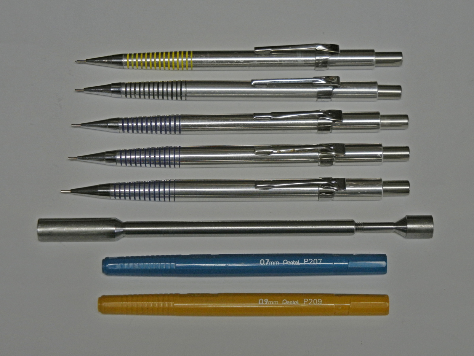

Attachment 34280
The top yellow pencil survived building a house, the bottom two blues ones are brand new. I build them now to give as gifts.
