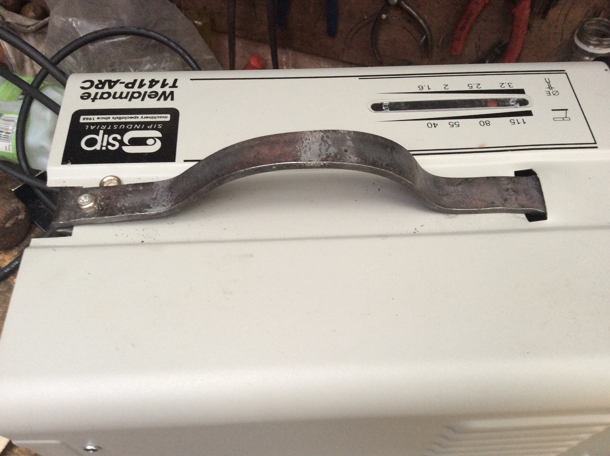

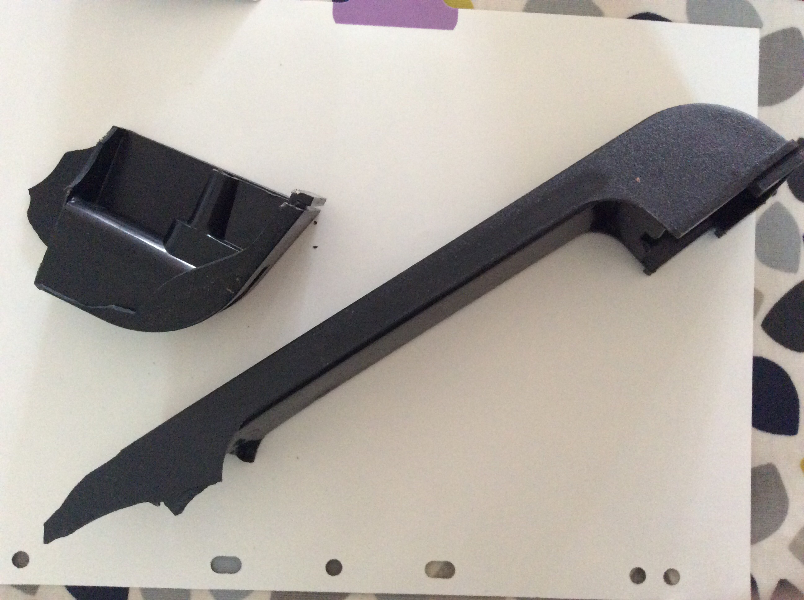

    This pathetic piece of brittle plastic is supposed to bear the weight of a 15kg portable arc welder. It arrived broken, so I have made a replacement in steel.Replacement handle (forged) for plastic handle (broken) on new welder-b90f239b-4946-4fe1-813e-3cae8b6f08bf.jpeg
    I count myself very fortunate that I have the facility to do this. I do not know another way of making one. What would you do?

    Plumber's tape and a piece of whittled or sabersawn wood would also do. Your way is more elegant, and is actually what I'd have done, though it might be cold forged instead of hot.

    Piece of old seat belt?

    Thank you Bill. There is a hook at o e end and a tongue at the other.

    I understood that. It's very similar to the one on my HF fluxcore welder. Possibly identical. I have a stack of modifications I want to do to it, and replacing the rather flimsy handle is only one of them. AFTER I get all the machine tools running. Been a long while already, probably an unreasonably longer time to go. Once upon a time it was readily accessible. Not quite so now.
