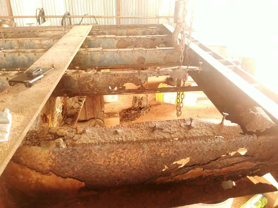

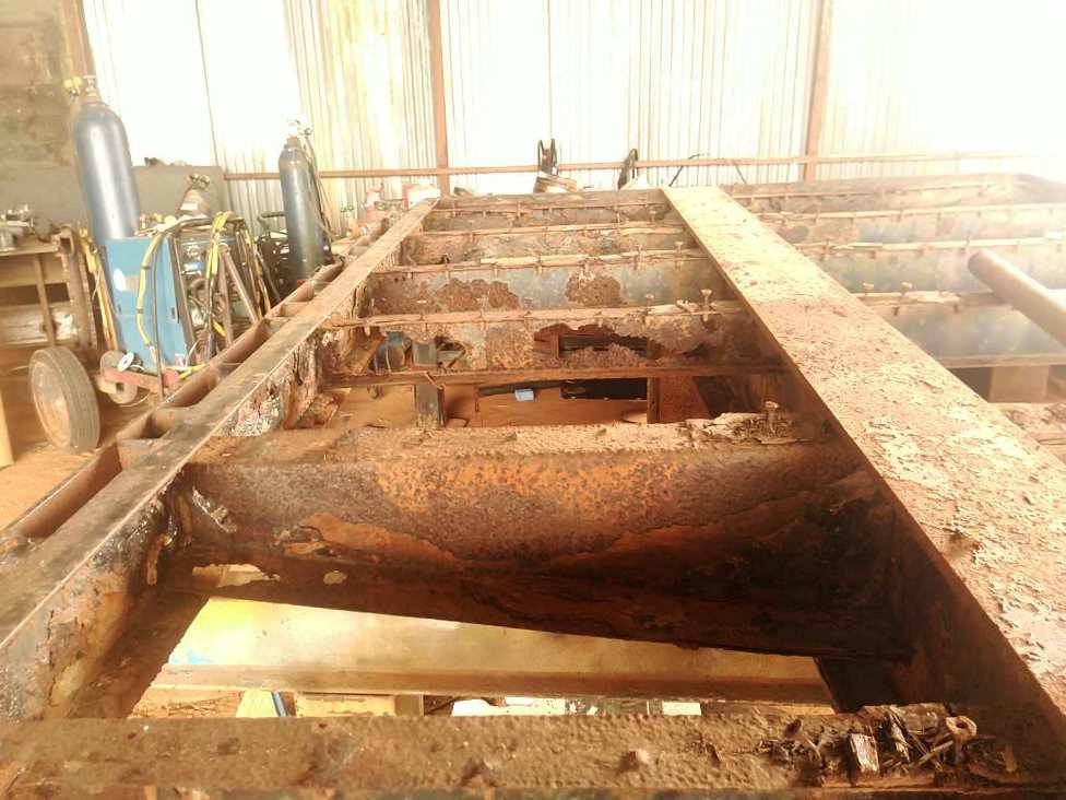

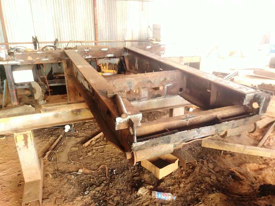

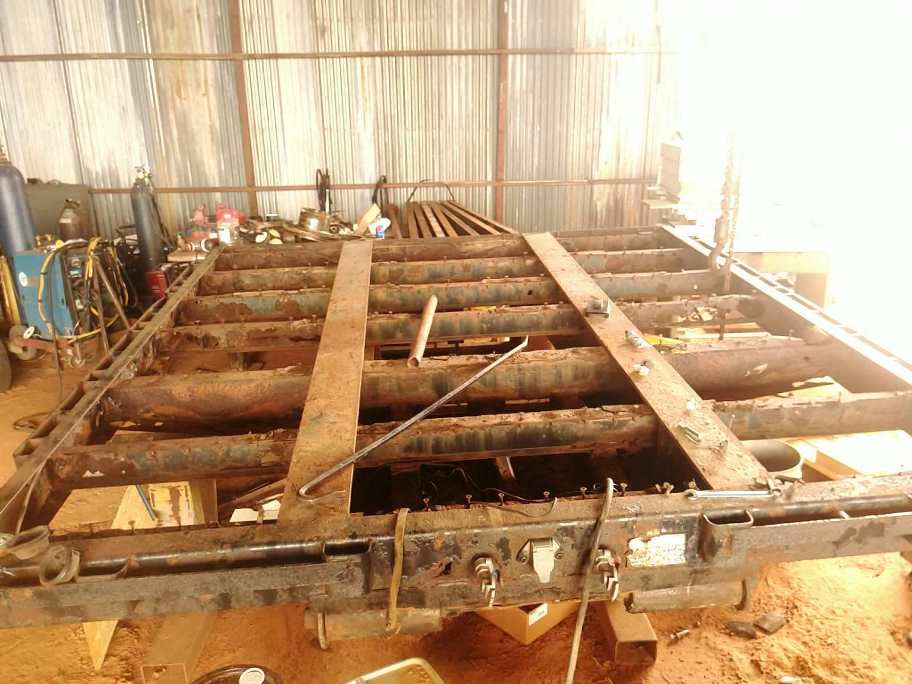

Me and a friend of mine bought a 2 axle RGN trailer with a 3rd flip axle about a year ago then sold the flip axle for nearly as much as we paid for the trailer. So it came down to either scrap it for about as much as we sold the flip axle for or rebuild the neck then determine how much we want to spend on the trailer itself
What it started out as
Attachment 40505
Attachment 40506
Attachment 40507

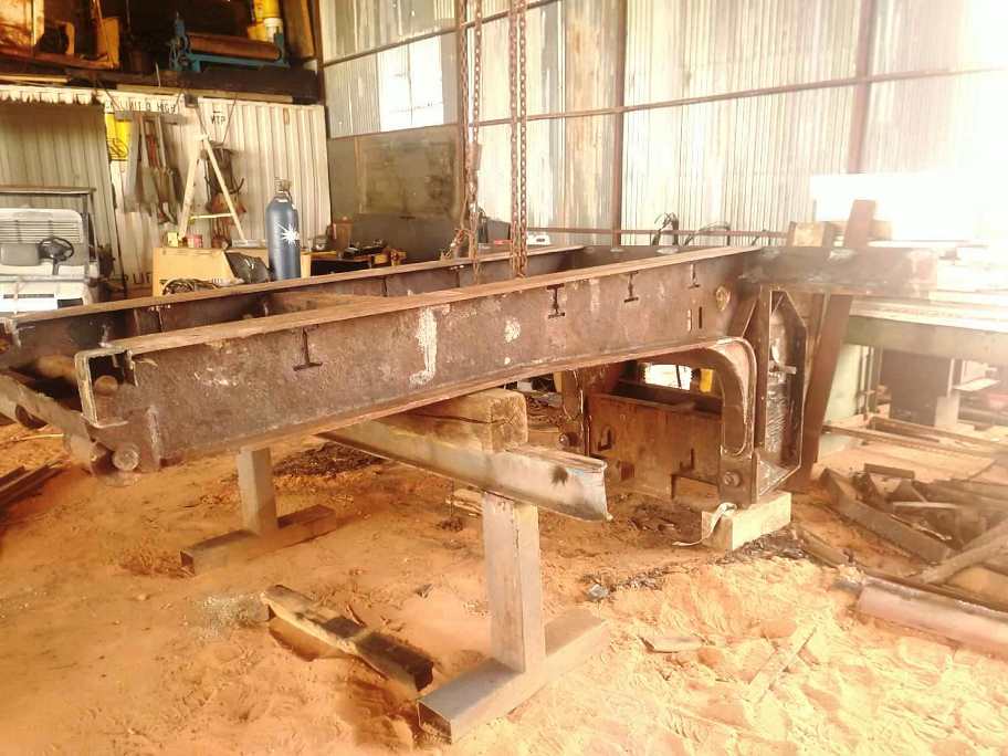

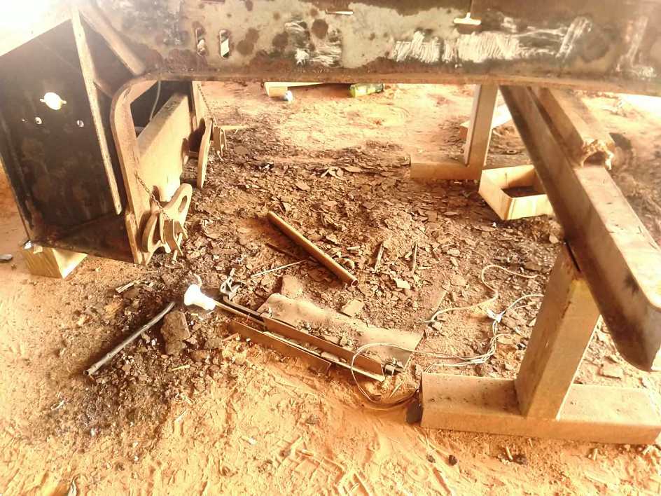

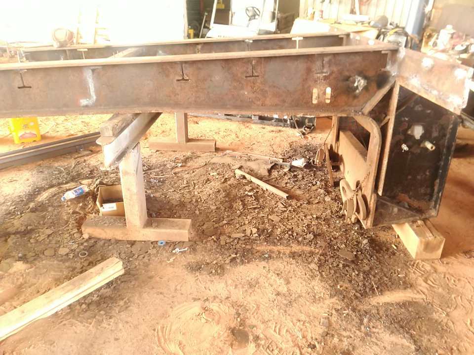

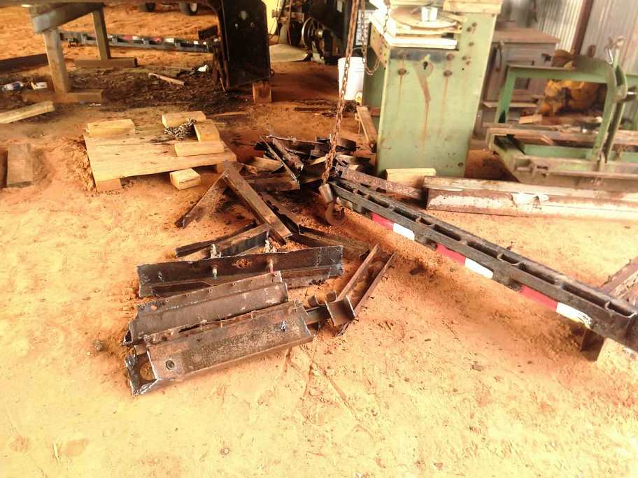

some of the scrap removed
Attachment 40508
Attachment 40509
Attachment 40510
nearly 400 lbs of rust was beat off with a needle gun
Attachment 40511
Attachment 40512

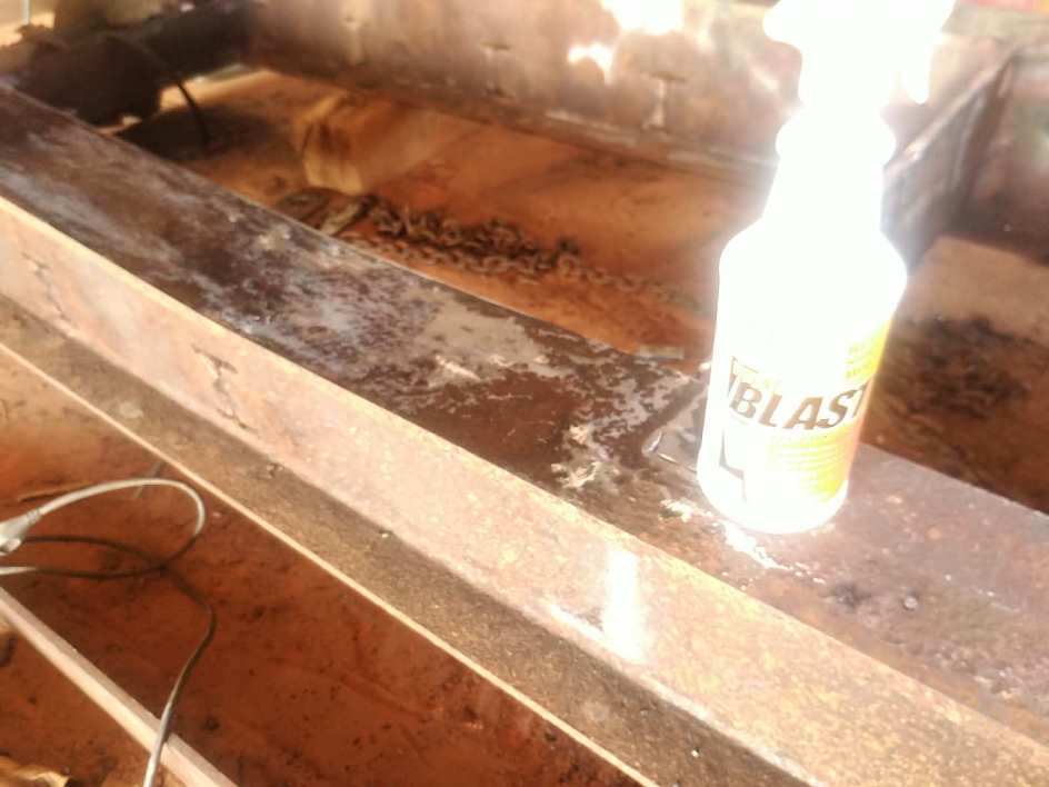

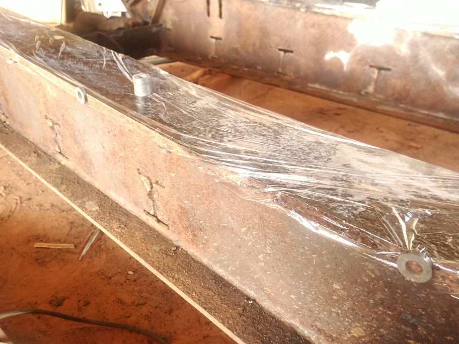

more rust removed chemically
Attachment 40513
wrapped in plastic to allow the chemical to work over night
Attachment 40514

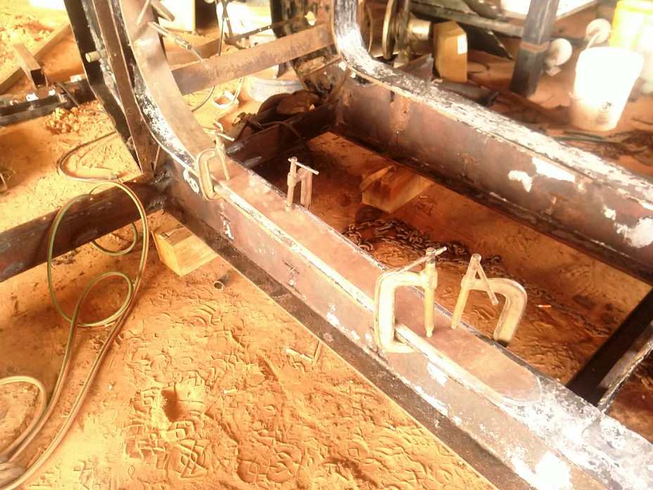

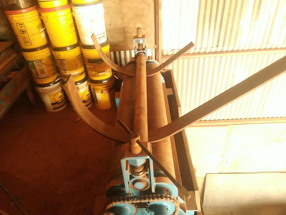

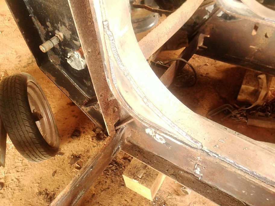

rolling 2 pieces of 3/8x 4 1/2 T1 steel in my homemade plate roll
Attachment 40515

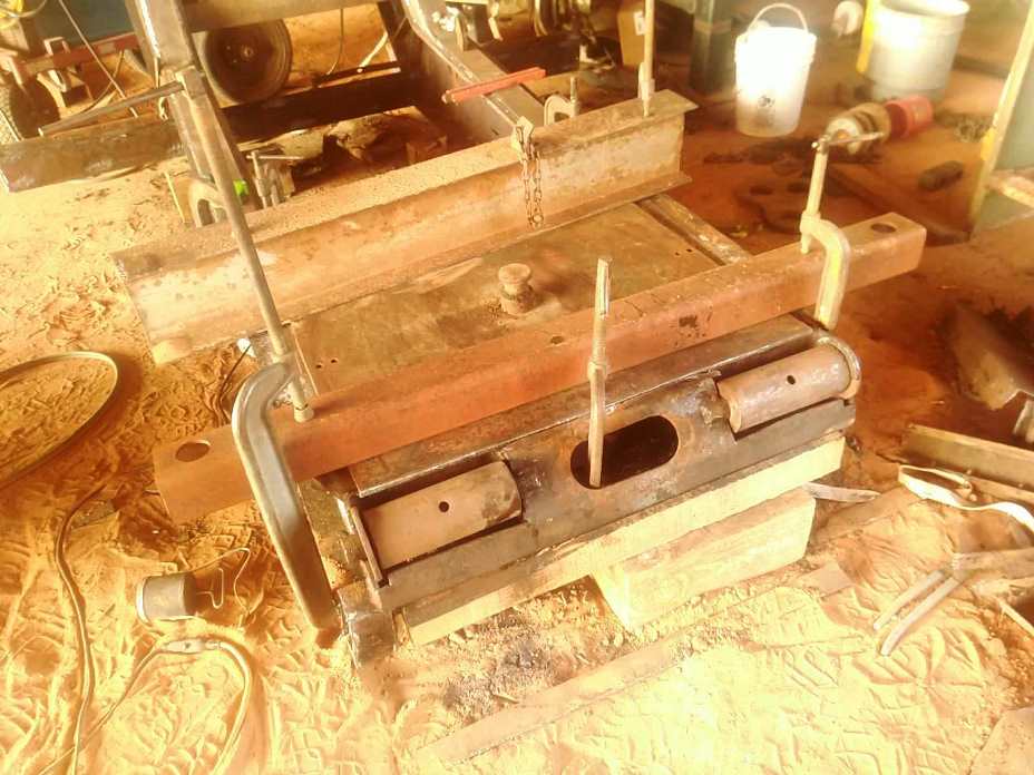

strapping the neck
Attachment 40516

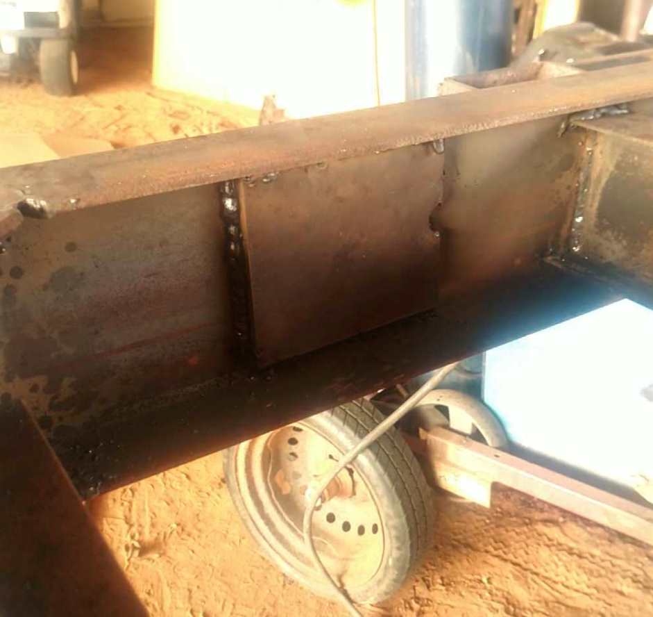

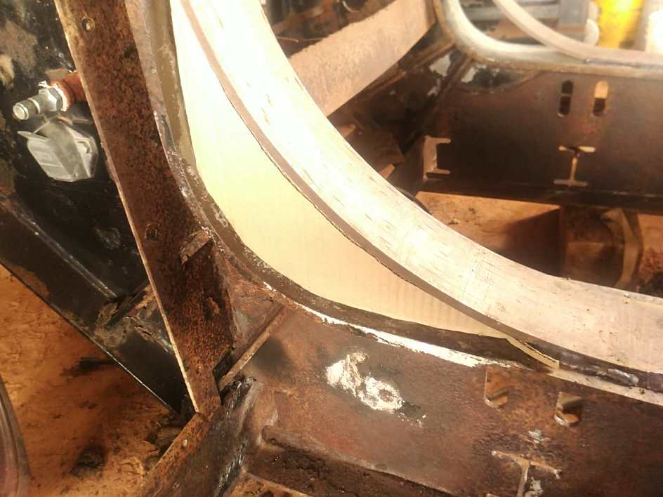

Making cardboard patterns for the webs
Attachment 40517
webs welded in place
Attachment 40518

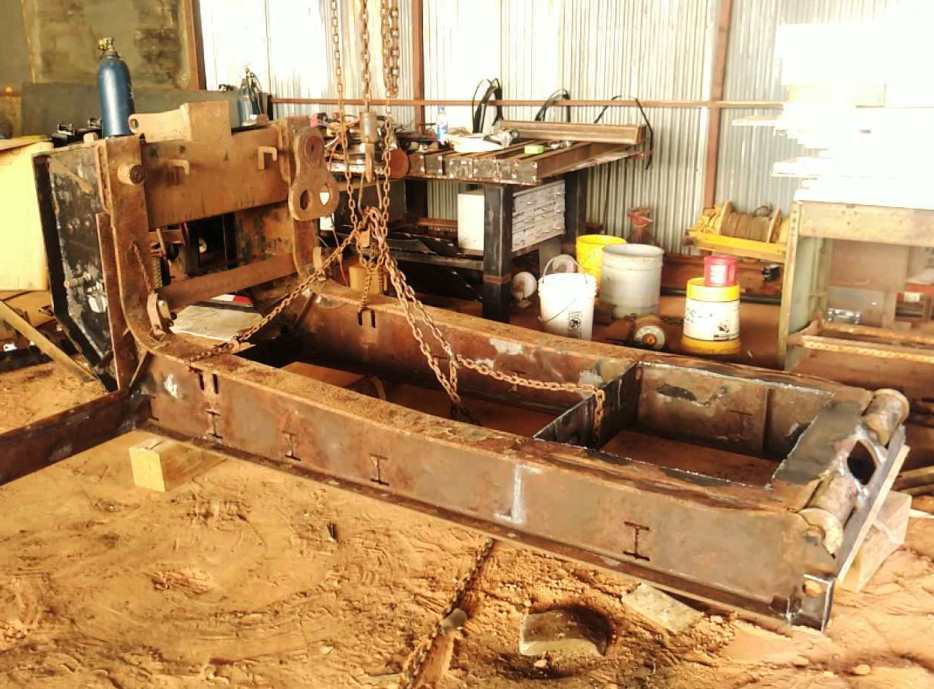

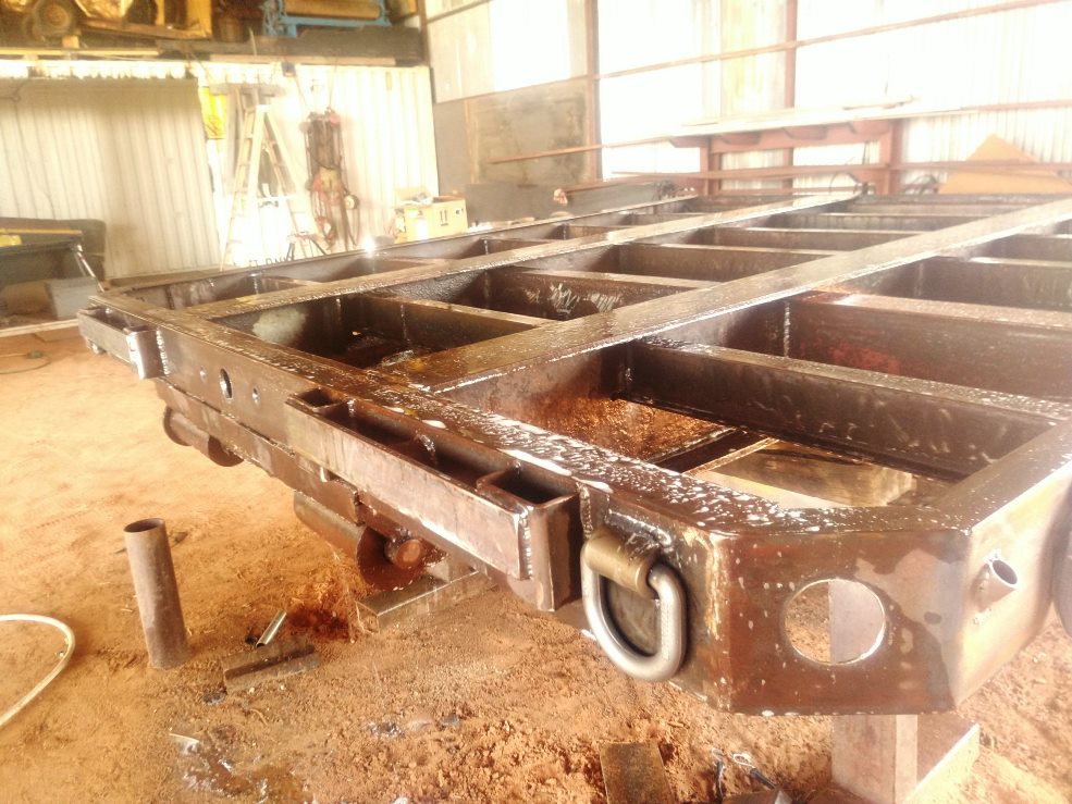

installing replacement king pin and plate
Attachment 40521
ready to go back together
Attachment 40519

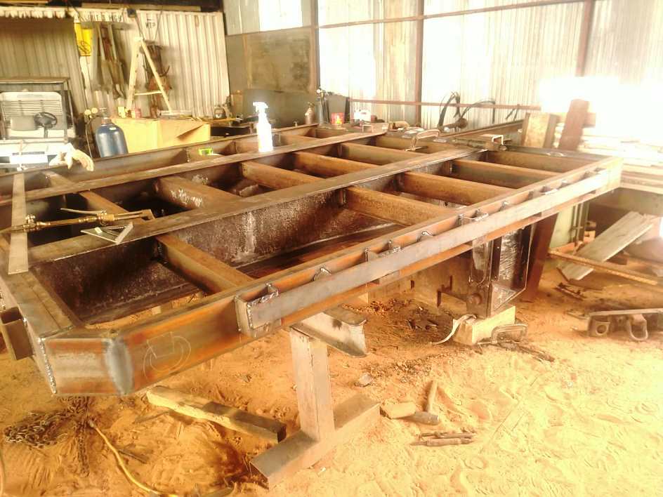

new cross members and side rails
Attachment 40520

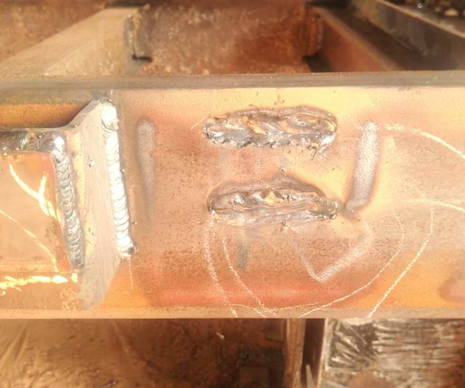

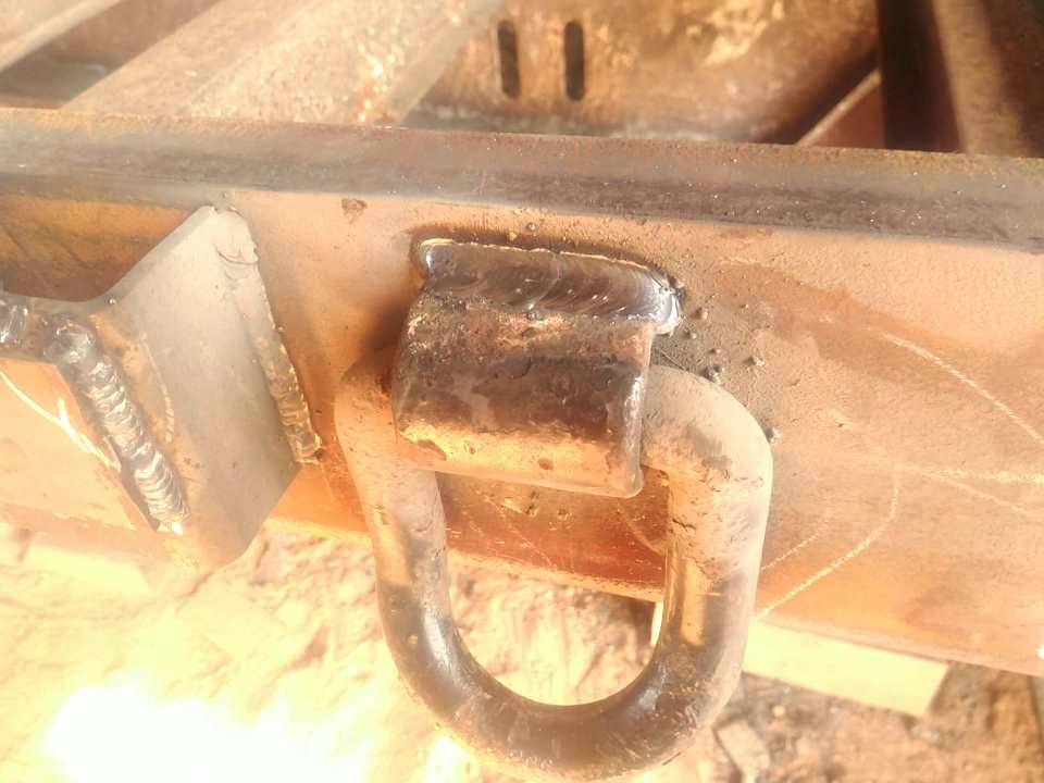

web stiffeners for D rings
Attachment 40522
Welds in slots cut through side rails
Attachment 40523
D ring mounts welded over slot welds tying the loop to the stiffener
Attachment 40524

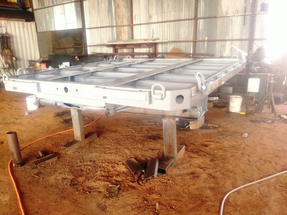

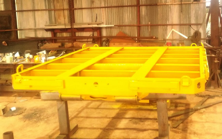

ground sanded washed with a solution ready for rinsing drying and painting
Attachment 40525
first coat of paint after being dusted with an etching primer for the hard to reach areas is could not sand very well
Attachment 40526
